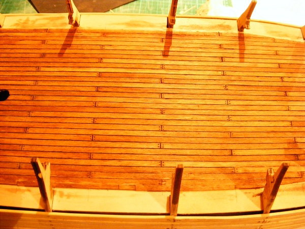

Well, this is the final installment on the deck rescue.... Coat of Danish Oil has now been applied and my over riding opinion is.... considering where we were after that first awful staining, I think it has turned out quite well indeed.... another technique learned and to be banked for future use..... Not going to do any more, the deck is as it is.....Cool Cool

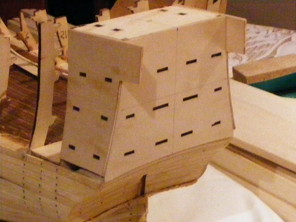

#633 Posted : 27 March 2013 22:36:31

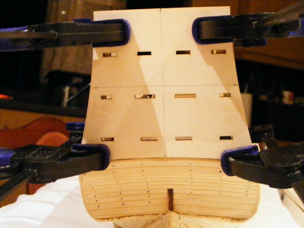

Due to other demands on my time I didn't get too much done this evening...Glare Glare . Did however make a start on fitting the gallery section... Started with the stern piece by lightly sanding off the black ash, did a test dry fit and all looked good.... Glued in place and clamped to ensure a good fix... BigGrin BigGrin
#634 Posted : 27 March 2013 22:39:47

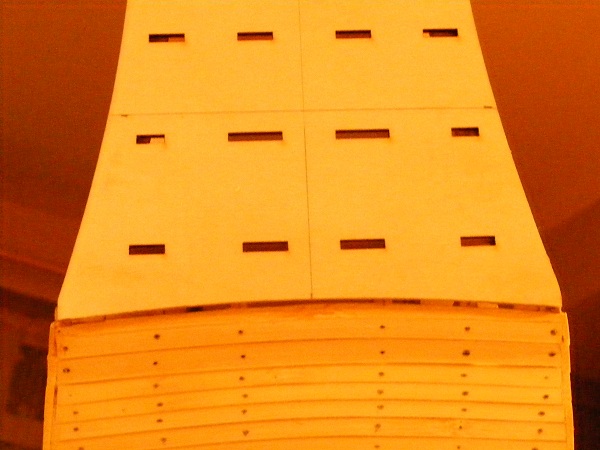

Removed the clamps when dry and was very happy with the fit, nothing out of alignment... So much so I found I have very little overhang at the sides so tomorrow it should only take a few minutes to sand everything level before fitting the side sections.....Cool Cool

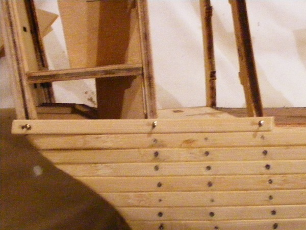

Continued tonight working on fitting the gallery pieces... Started by giving the edges of the stern piece I fitted last night a sanding with an emery board, ensuring everything was flush and also ensuring I didn't alter the profile at all....
On dry fitting the side panels I wanted to ensure a good fit taking into consideration there is a length of plank to fit under the side panel piece. Using some offcuts of bamboo I pinned a plank in place as a temporary measure.

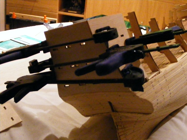

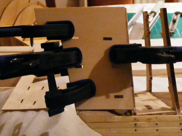

Glued and fitted the gallery side piece and clamped in position, then removed the temporary plank as I didn't want that sticking to the gallery. Left to dry before continuing....

Once I was confident everything had set and was secure I removed the clamps... Happy to say everything was sitting flush....BigGrin BigGrin
#638 Posted : 29 March 2013 23:55:22
Nicely done there Alan! There's so many complicated compound curves on her stern it even makes the Victory look simple!
Well done indeed! Cool
