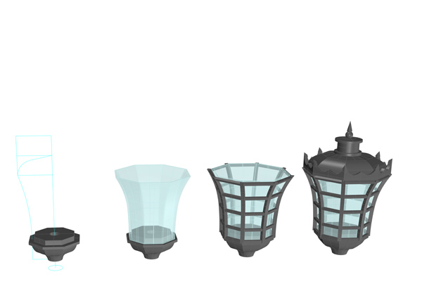

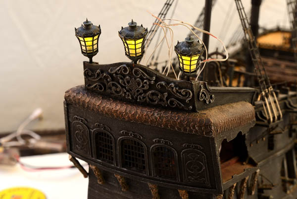

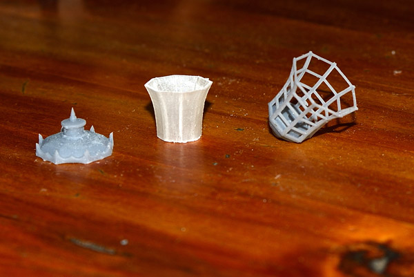

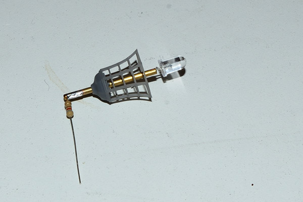

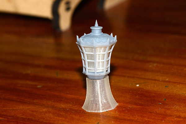

I am going to interrupt the rigging at this stage and fit the stern lanterns. I have left them off until now as they are fairly delicate, and I really don’t want to damage them.

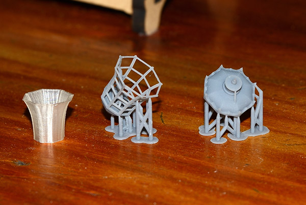

The lanterns supplied with the kit are obviously a generic stock item and do not look anything like the lanterns in the movies. Bored Some time spent with our beloved Rhino software and I had a lantern that closely resembles the ones on the Pearl.
Thanks, again, to Mark, the owner of our company, for the opportunity to 3D print a set of lanterns. The bottom, cage section and top were resin printed and the ‘glass’ was filament printed using clear material.

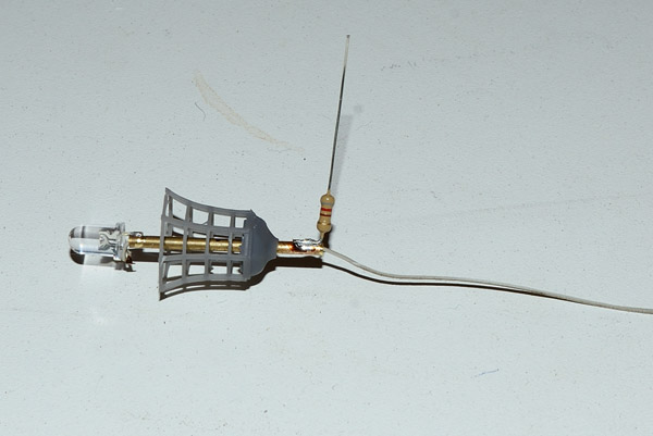

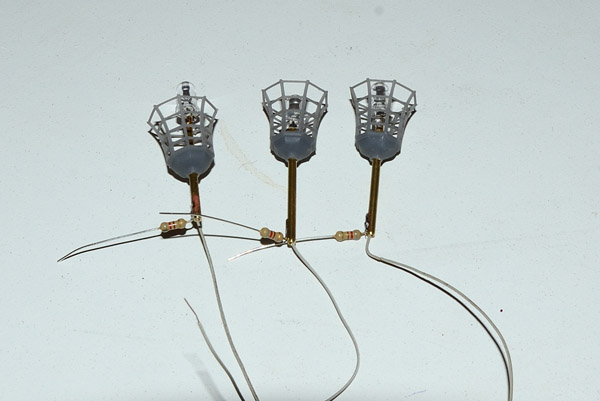

To light them I used a 5mm LED. I had some Ø2mm brass tube and as luck would have it, I couldn’t get both wires through. So, I soldered one leg of the LED to the brass tube – sorted!!!

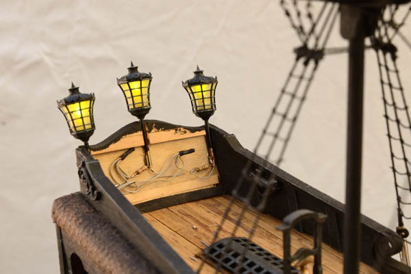

When I wired the cabin, I laid the wires for the lanterns.
I glued the lanterns in and connected up the wires. I could only get white LED’s, so I gave them a couple of coats of GW Yellow ink. A pity they don’t match the rest of the lanterns.
While everything was still loose, I painted the lantern using my standard recipe. Matt black followed by light grey dry brushing.

#667 Posted : 23 September 2020 13:57:57
those lights look fantastic
#668 Posted : 24 September 2020 08:23:08
Posts: 7,373
Points: 22,426
Well done, those lights look fantastic.Love Love Love

Hi Garth,
fantastic stuff with the lights.

You are so skilled.
Those lanterns look brilliant how you have designed them.

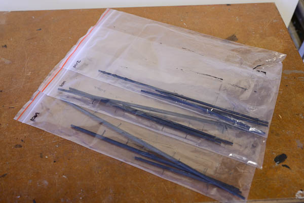

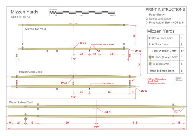

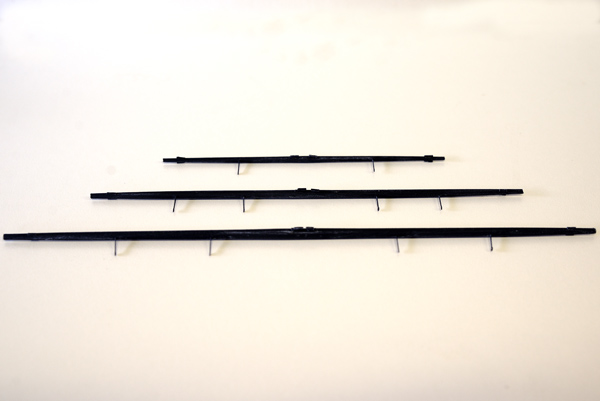

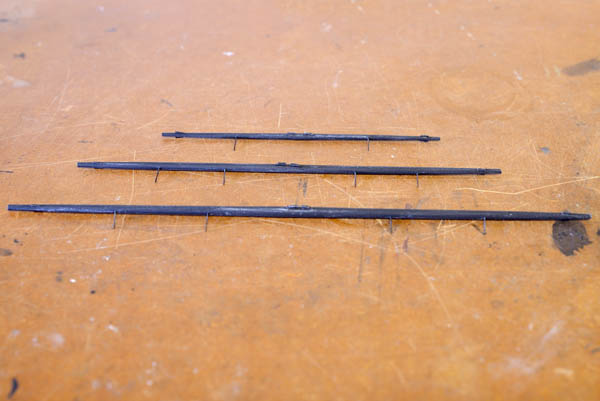

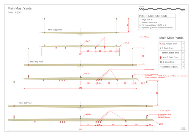

Part 09 The Yards
Making up the yards is prety much as per the instructions. Once again the mini lathe was invaluble when turning down the ends.
I painted them using the same recipe as for the rest of the model. Matt black folowed by a dry brush of greys.
One suggestion though, I packed each set in separate plastic bag and marked them Foremast, Mainmast & Mizzen.
If you are going to use my sails, then add the blocks as per my drawings.
Remember, only download the _Large drawings if you are going to use them as a reference to build from – no point in wasting data.
Kind regards,
Garth
07 Fore Mast Yards_Large.jpg (1,910kb) downloaded 47 time(s).
08 Main Mast Yards_Large.jpg (1,850kb) downloaded 50 time(s).
09 Main Mizzen Yards_Large.jpg (1,203kb) downloaded 50 time(s).

Impressive lathe work Garth.
Always good to see someone that can use one of these to get both ends of the spar nice and even.
My attempts in the past have never been ideal.
Tony
