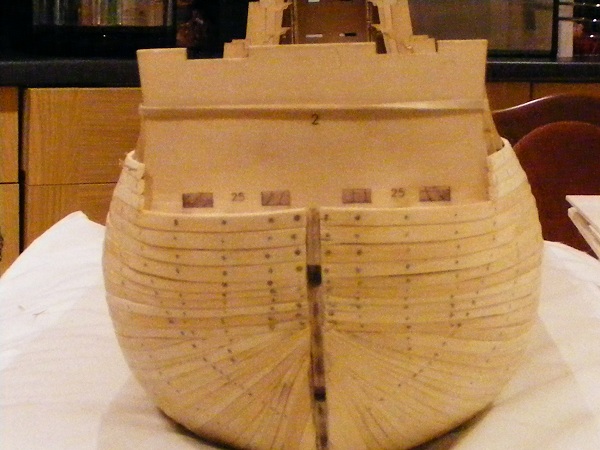

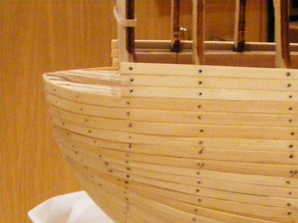

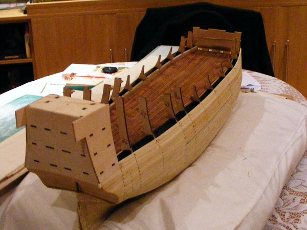

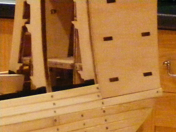

Now finished the planking up to issue 31... Wasn't too happy with the pictures I posted last night, too dark and rather blurry. Retaken and posted again, these are a lot better... Now going back to work on the San Fran II and hopefully will have the infills completed before issue 32 comes out on Wednesday..... BigGrin BigGrin

Good work AlanBigGrin nice and uniform, top job Kind regards Mike

Lovely planking job there Alan, as said by MWG, really nice and uniform. The SOTS has beautiful graceful lines about her hull and you've captured them perfectly. Cool
She really does look like a warship of her time,the link between the Elizabethan galleons and the Georgian first rates! She'll be a stunning model! Drool
Well done!
