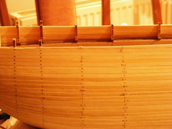

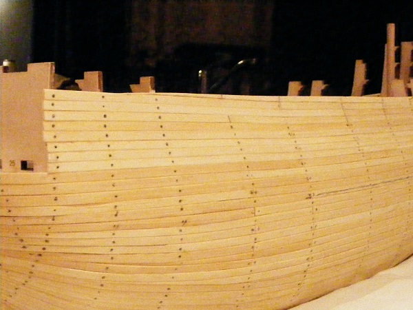

No work done last night due to other demands on my time...Cursing . Started tonight by laying 2 layers of planks on either side of the upper hull. BigGrin For the third layer I first fitted the plank running from rib 16 to the stern, then cut a length to run from midway between ribs 5 & 6 to 16, tapered the plank ensuring the taper run the full length of the strake... Glued in position and when dry blended the taper to run onto the previous plank... Hopefully tomorrow will fit the third layer to the other side and finish planking up to issue 33..Cool Cool

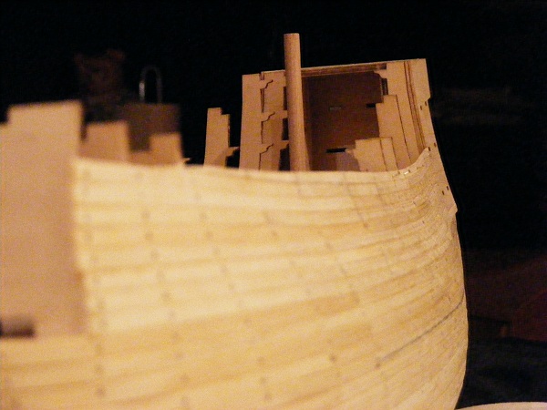

Finished the planking as per issue 33 and moved onto to sealing the gap between the gallery and the stern planking... Cut a section of bamboo to fit and using steam from the kettle induced a bend in the plank to fit the curvature of the gallery....
Using a sanding block, removed the rounded edge of the bamboo to ensure a snug fit with the gallery profile.... When happy with the fit glued and pinned in place.... final shaping and sanding to be done tomorrow...
Finally trimmed the planking overhanging the stern.. BigGrin BigGrin Happy building all....
