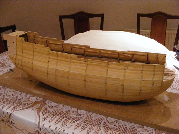

Yesterday evening I gave the hull a coat of sanding sealer, left overnight to dry. Also picked up issue 35 from the newsagents and spent some time studying the marking out process for the top of the hull and of course the gun ports.... Wanted to make sure all of my measurements were carried out following the curvature of the hull so to assist in the process I used a 5 x 0.5mm plank, this I found followed the curves nicely... Got all the heights marked out ready for cutting... BigGrin BigGrin

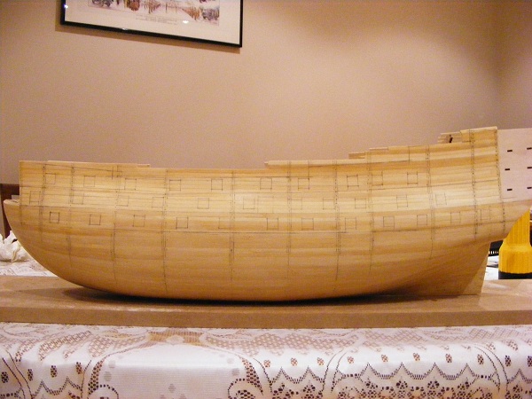

#764 Posted : 02 May 2013 23:56:24
Having got both sides marked out to this stage I made a start on marking out the gun ports and have completed one side, the other side hopefully will be complete tomorrow.... Will ensure the bottom edge of the ports run parallel with the water line and not follow the curvature of the deck and will square each port off by the use of a 12 x 13mm jig, will carry this out on each port just prior to starting to cut them out... Cool Cool .. Won't be doing any cutting until Mr T publishes his diary for this issue, want to make sure I've got everything right before any cutting is done.... BigGrin BigGrin

I am a bit puzzled by your comments on the lower gunport heights - even though I am months away from that stage myself!
If they were ON the waterline, would that not lead to one side or the other letting in water unless the ship was dead level in a calm sea?
Then also, the guns would be mounted on the lower deck itself, so their heights above the waterline would follow any rise in the deck?
If you set the gunports anywhere other than exactly between the lower and middle decks, you would have to create new lining boxes in the hull for the dummy guns to mount into?
Maybe I am missing something Confused

Hi David and thanks for your comments... Am afraid you are missing something, I did say the lower edge of the gunports are to run parallel to the waterline, not on the waterline. The heights of the gunports will be above the waterline... Hope this clears up your query....Cool Cool .. Thanks again...

Looking good Alan.You may have noticed already but just check the gunport upper deck third from stern looks a little twisted on the photo.If you chock the hull level fore aft and side to side you can double check your bottom cills are horizontal using a short spirit level.When you come to sizing the ports I recommend sticking abrasive paper to some scrap wood.If you use say 10mm square strip and glue the abrasive paper you can rest the smooth side against one finished edge whilst sanding the adjacent edge,this helps a great deal in keeping the ports square.I used to use needle files but they soon loose their edge doing gunports unless you use permagrit ones.
Kind Regards
Nigel
