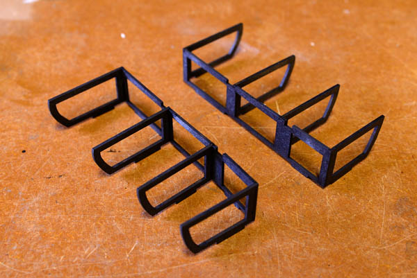

Painted the cell sub-assemblies black.
I felt that the photo etched bars provided for the cells was a little too thick. Fortunately, we have CNC engraving machines at our office, so I was able to cut out a new set with thinner bars. The next step is to fit and weather them. Really looking forward to that.

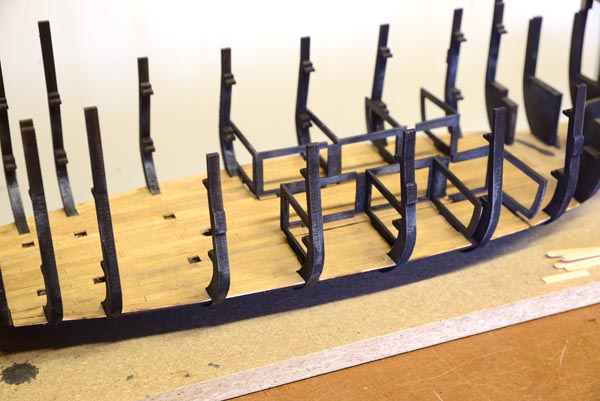

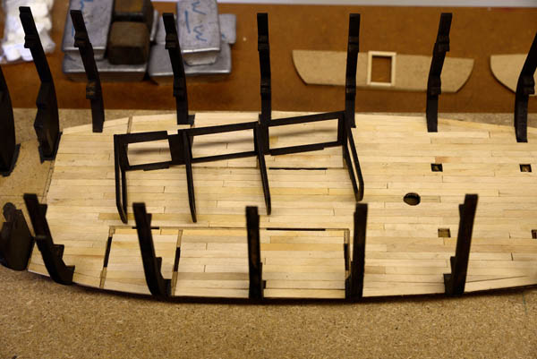

The ratlines on my Victory have been taking their toll. To maintain some form of sanity, I’ve spent some time on the Pearls decking.
Got all the planks glued down. Just a point to remember, if you decide not to use the printed decks, the cells and upper deck support columns need to be compensated for. They can either be cut short, or as I have done, left grooves between the planks for them to fit in.
Next step – staining.

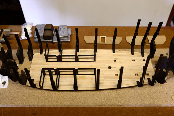

Applied my first coat of stain. I think that it will be fairly dark on the lower decks, so I will try to keep the colors fairly light.

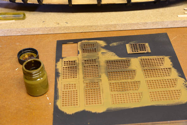

I have never been successful painting rust in the past. But recently I have been doing a lot looking at rusted things (Don’t worry, my wife is a therapist and she knows about this) and breaking rust down into its components and colours. Its really a combination of texture, various shades of reddy browns and orangy stripes where the water has run off.
Now to recreate this on my model.
I made actual rust paint by soaking steel wool in a 1:3 mixture of bleach and white vinegar. Once the steel wool had formed a rusty paste, I bottled it and added about ¼ matt medium to the mix. This was painted onto the pre-sprayed black bars. I was hoping that the rust process would continue and produce those reddy browns all by them selves. After 3 weeks, the colour remained exactly as I painted it. So, I’m not sure the Real Rust is that successful. What does work though, is that it has produced a great texture.
Next I stippled Tamiya Dark Brown & Hull Red randomly over the bars using an old paint brush with stiff bristles. Once dry I glued them onto the wooden frames.
Last I dry brushed some GW Boltgun Metal & Chain Mail. Yes I still have the old paints & they still work. As with the other parts, I will give them another round of weathering when they are installed. I have been looking at some techniques of making washes using Artist ink & Future polish??? Defiantly going to give it a go.
