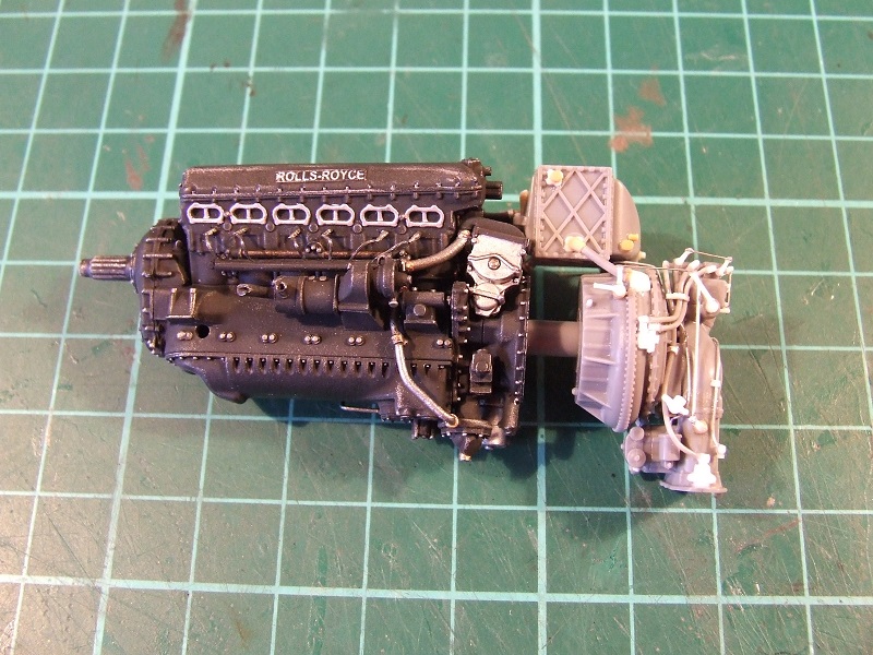

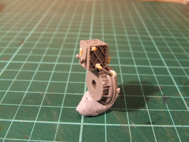

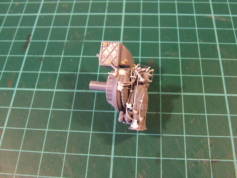

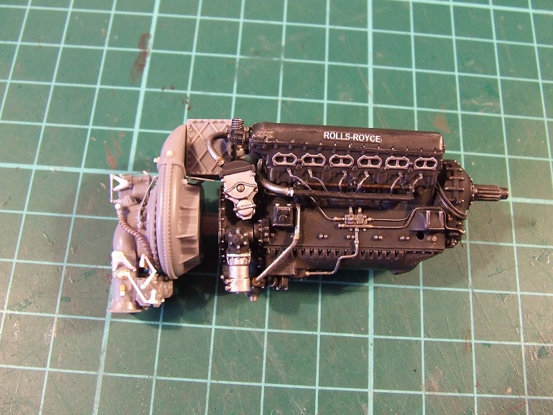

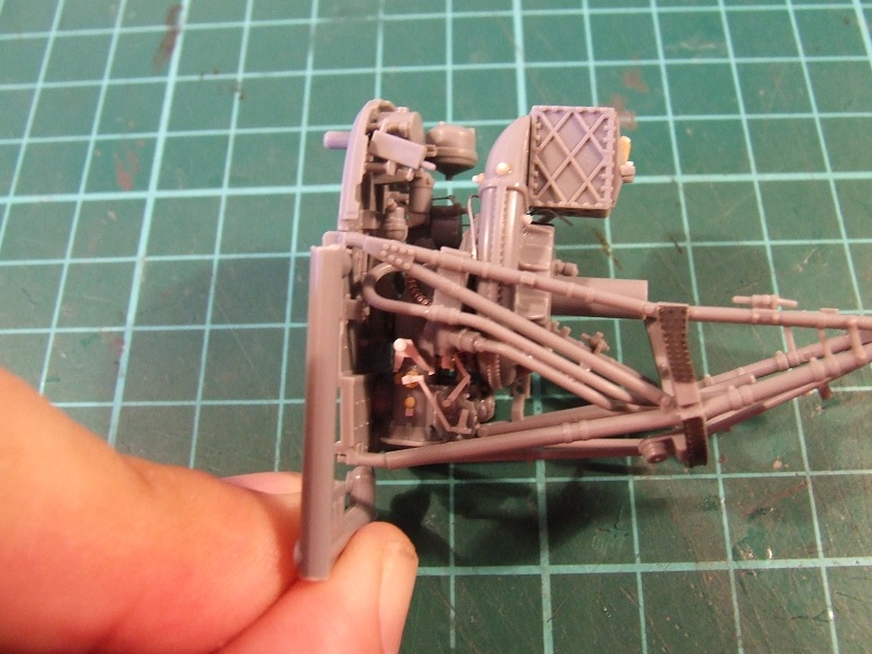

Anyway, on with the build and as promised at the end of the last update, I’ve been concentrating on adding a lot of scratchbuilt details to the rear half of the engine assembly, namely to the wheelhousing, supercharger and carburettor assemblies. I’m not going to go into detail about how I made each part, except to say that it is all made from plastic card, plastic strip and some stretched sprue along with a bit of copper wire around the corrugated pipework and some stiff floristry wire for the throttle linkage rods. There is STILL even more pipework to be added to what you see below, but I need to mate and glue the two halves of the engine together before I can connect them up as they are fuel and oil lines which run between the two and the length needs to accurate between the connections? I have also made a start on the engine bearer assembly and the firewall as can be seen below and both of these will be getting extra pipe and cable details added further down the assembly line.
The first two photos below show the rear half of the engine assembly as it was in my last update, and the next four photos show how it is now with a ton of extra scratchbuilt details added. It looks a million miles from the standard kit offering!! The thin grey pipes running from bottom to top of the port-side carburettor trunking in the second photo are all made from stretched sprue.
In the next two photos I have just loosely joined the two halves of the engine together to give an idea of where this is going detail wise and it already looks very busy without the remaining oil, coolant and fuel pipes and yet to be added. I am hoping to make this one of the most detailed 1:32 Spitfire engine bays out there!!

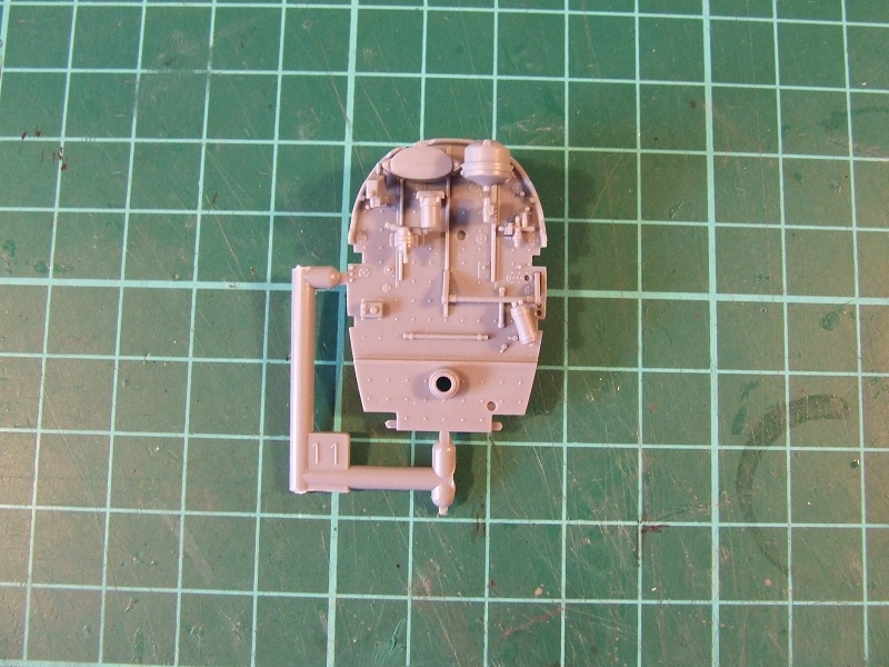

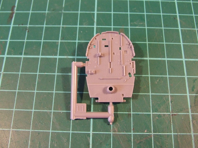

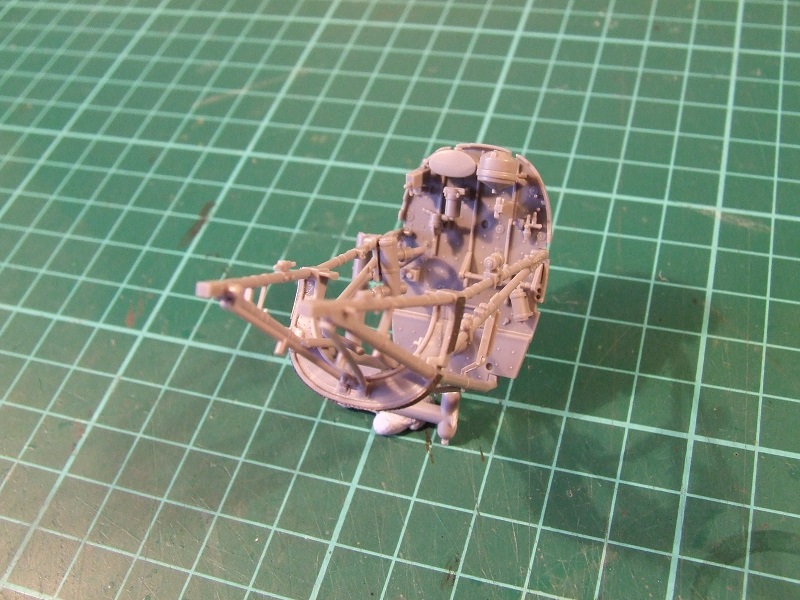

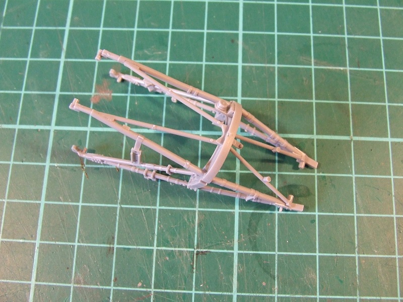

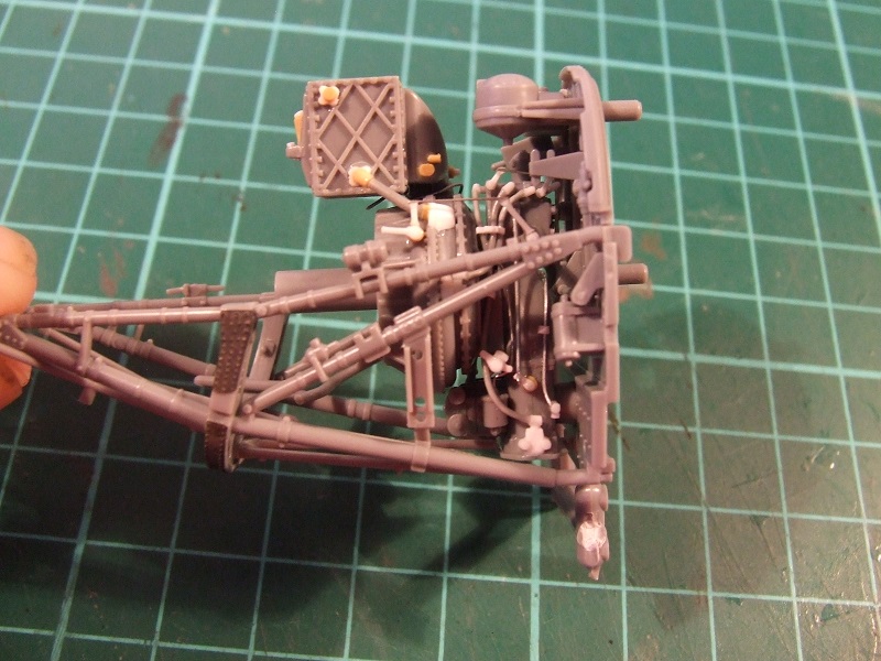

Next up was the start of the assembly of the engine bearer framework and the engine firewall. In the photos below, all you see is the basic kit parts and I have yet to add various hydraulic pipes, coolant and oil pipes to these which will be done for the next update. I have scribed and shaped a missing join line down each side of the pressed steel bracket that holds the Supercharger Oil Reservoir to the firewall and drilled the two lightening holes to a bigger size as they didn't look right according to my reference photos. One other alteration I have made was to the engine starter connector, which is the round item in the middle of the engine bearer in the second photo below. The kit part, which is integrally moulded with the starboard engine bearer frame is in the correct location (on the side) for a late Mk. IX, but Johnnie Johnsons’ Spitfire was an early Mk.IX , which had the starter connection fitted centrally below the engine, which is provided as a separate part in the kit and can be seen fitted to the main engine bearer in the third photo below. The original side-mounted item had to be removed with a scalpel and sanding. I have left part of the sprue attached to the firewall to make it easier to hold and paint this assembly without having to handle the plastic too much. Once removed the sprue connection point will be totally hidden within the starboard fuselage half. The only non-standard parts added so far here are some Eduard etched brass strips around the main bearer frame, which contain some missing bolt detail. The two forward most tips of the V-strut which is located underneath the bearer framework aren't yet permanently glued to allow me some leeway and to be able to ease open the framework when I come to fit the engine to the bearer framework.

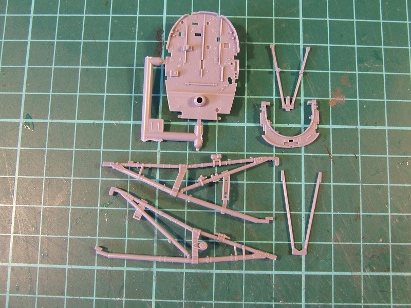

The photos below show the engine bearer/firewall parts as provided in the kit, the starter connection as provided in the kit (round item in centre) and the new part fitted underneath, starboard of the centreline and just behind the main bearer.
The standard kit part for the engine firewall is shown in the next photo, then the same shown with the various tanks, reservoirs and hydraulic fittings added.
The firewall was then attached (temporarily without glue) to the engine bearer framework and the Eduard etched brass parts fitted to the main engine bearer. There is a small steel plate beneath the brass parts on the two sides which align with some small neo-magnets that are to be fitted inside the engine side covers to allow removal of them to view the engine, but you can’t really see the plates in the photos.
Eventually, the completed engine is to be fixed to the firewall/engine bearer assemblies by means of a steel screw and a nut which has already been fitted and is hidden inside the rear of the carburettor ducting to hold it all securely to the fuselage and take the weight. I thought it would be interesting to see what all my extra scratchbuilt detail looks like when sitting inside the engine bay behind the bearer framework, so I screwed it all together temporarily to have a look? I'm pleased to say that it all fits very snugly, with none of my scratch-built parts fouling the kit parts and it all looks suitably busy behind there? I will be adding a throttle connection through the firewall to the control linkages when it comes to the point of final fixing.
You can see from the size of my fingers in some of the photos how small some of this detail work is and my eyes are still in the process of becoming uncrossed?! Blink Blink
That’s all for this update, next one should see all of the engine assembly painted, joined and final pipework added and hopefully some more scratchbuilding work done to the firewall and engine bearer assemblies. My busy work period looks to be slowing down a bit now so I’ll be hoping to start pushing forward more on this build in the next few weeks as time is ticking and I want to get onto starting the cockpit area and hopefully some work on the 1:9 resin figure soon, so next update will hopefully not be too long coming, or at least not as long as it has been since my last one?!
Thanks for looking and all comments and criticisms welcomed as always.

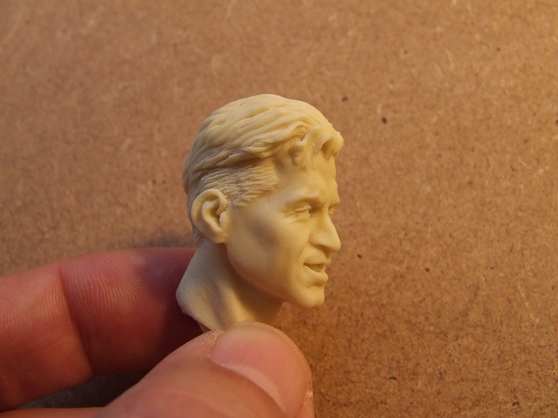

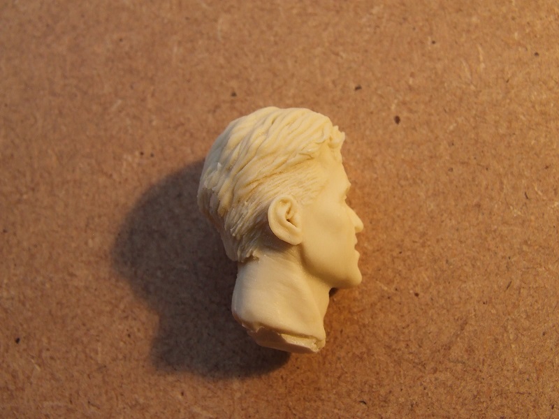

I have just received a couple of new items from the postman which I will be making use of in this build, the first being a very nice little resin casting of a 1:32 WWII RAF Parachute, which I will have laying either on the port wing near the cockpit entry door, or on the ground by the wing when I come to build the diorama?:
The second item I’ve bought is going to save me a fair amount of work!! You may recall I said earlier in this build that I was going to re-sculpt the face on the head that comes with the 200mm (1:9) RAF Fighter Pilot figure that has an anonymous face which I wanted to make look like ‘Johnnie’ Johnson, since this is a tribute to the great man and which will be displayed alongside the diorama on a split level? I bought my figure from ‘Mitches Military Models’ and luckily for me, in the interim since I bought it, he has released a ‘V’ bust of ‘Johnnie’ Johnson along with several other WWII pilots in the same scale, and which can be seen below as a set of three (available individually as well at £19.99 each) and included in the set is Johnnie Johnson (RAF), Joe Foss (USMC) and Adolf Galland (Luftwaffe):
http://www.ebay.co.uk/it...Luftwaffe-/291638102168
.... but better still he has also released a set of three heads from those figures for just £9.99 with free p&p, which I’ve bought and which will now mean I can just substitute the standard head from my figure for that of ‘JJ’ without the need for any time consuming sculpting – now that’s what I call a result and a very timely one indeed!! The only thing that I will have to sculpt now will be a flying helmet which I intend to have in ‘JJ’s left hand and I will be able to carefully remove the necessary fittings from the flying helmet on the standard head to add to my putty sculpted part which will make life a lot easier as well?
The ‘Johnnie’ Johnson head can be seen in more detail below, along with a photo of the great man which shows just how accurately the resin head has been sculpted – a very good likeness I think you will agree?
