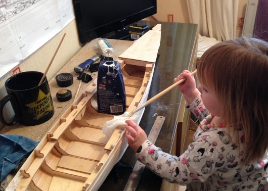

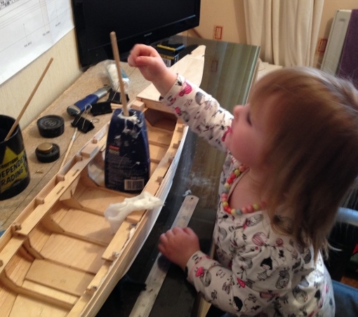

BigGrin Hi Folks mentioned in earlier post "bored with gauzing the inside of the hull"
Cool Decided to designate the task
budgie attached the following image(s):

#69 Posted : 08 May 2015 22:09:09
Wow Stuart, you've been busy. The change from the last pics to these. Its coming along at a quick pace. Looking great.
Regards Chris
#70 Posted : 08 May 2015 23:03:33
Love it, start them of young LOL LOL

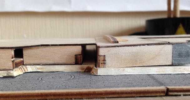

#71 Posted : 09 May 2015 11:18:51
Joined: 20/03/2010
Posts: 1,199
Points: 3,473
Location: Glenrothes

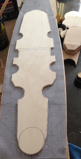

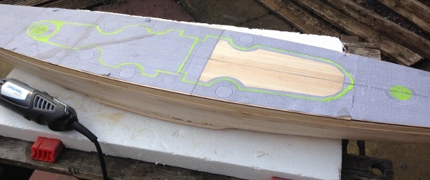

BigGrin Good Mornin' Folks
Cool Finished gauzing the inside of the hull
Cool I have temporarily screwed the deck down (will countersink the screws later)
Cool Photocopied the deck templates and stuck them to the deck using Elmers rubber cement (anti wrinkle on paper and should peel off quite easily once done)
Cool This will allow me to roughly cut out areas under the fwd/aft superstructure and barbettes for access once the deck is permanately fixed for access to running gear etc
Usualy a coaming protrudes up from the deck into the superstructure to hold it in place
But as the superstructure is not hollow i think i will have to put a ledge on the underside of the deck and build a base on the superstructures equal to the deck thickness
Confused Only issue i have been pondering over is access to the rudder area
Crying There is no superstructure to hide the cutout lines
This is the area where there is a swastika painted on the deck
My painting abilities are naff and i do not know if i could purchase a transfer to help disguise the cutaway part
Which brings me to my thoughts......why would a ship in time of war be displaying great big swastikas on the deck.....if it was purely ship to ship battles maybe... but in days of aviation with spotter planes,bombers etc... you would not need to bother getting out your ship recognition hand book
Blink Then i had a moment of inspiration .....when at sea did the swastikas get covered with some kind of cover such as tarpaulin.....this would satisfy my curiosity Cool and more importantly cover my cut out lines....
Cool if anyone can point me in the right direction for this i will be most grateful
As you can see in photos there is still a bit of work to be done to edges where deck joins the hull....nothing a bit of sanding or adding a thin veneer along the edge which will be addressed once deck permanately secured
Thanks for lookin'

Titanic5972
#72 Posted : 09 May 2015 21:51:09
Joined: 09/12/2014
Posts: 75
Points: 224
Location: Timaru, New Zealand
From memory, before sailing on her only mission, all of her camouflage livery was painted over, save for the bow and stern false waves, and the swastikas were painted over as well. The red area surrounding them was as well. The same colour as the hull I think. I have chosen to have it in the earlier half camo, where only the hull had the camo paint and not the super structure, and the full swastikas on both bow and stern.

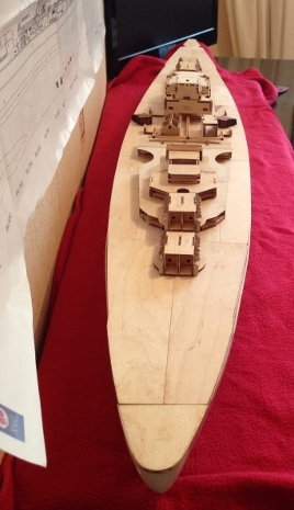

budgie

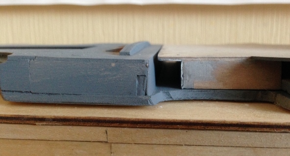

BigGrin Evenin' Folks.....not got as much done as i would have liked this week
Crying Too much humming and hawing over which paint to use..and getting nowhere fast
There are 2 bulkheads that face each other on the fwd and aft superstructure
There is no brass covering for those....expect it is coz no one can see much of that area.....but there is 9 brass bulkhead doors to go there which needs to be done now while i have access to the area before they are glued to the removeable base and a couple of plastic bits at the edges which can be glued further into the build
Cool As the doors are glued up off the deck i can slide the planking detail in there later
Blink Anyhoos
I sanded and sealed the bulkheads with diluted cellulose dope and it felt really smooth but when i sprayed them (Halfords grey primer) it looked like a minefieldLOL
I decided to rub back down and using a bit of filler i was still not happy when sprayed
Decided to rub back down yet again and cover the bulkheads in thin styrene which when sprayed i was content with apart from the shade of grey
The main colours used are supposed to be RAL7000 Rat with Tail(squirrel) grey for the hull and for the superstructure RAL7001 silver grey
These do not seem to equate exactly to other makes of paint?
Thought about using a light grey but which one? too much too choose from
Crying head hurtingBored Plus what format... brush, spray can or tinlets... which would require a crash course on using a spray gun
Nearly made up my mind when looking on line.. but looking at the colour on a pc doesn't neccessarily mean it will be the shade i like in reality
An Italian company does the RAL paint i require in spray cans but i thought it was a bit expensive.... until i compared with an alternative make...works out about the same price as when you get to the checkout there is the usual VAT, postage but a charge for hazardous goods as wellCursing
I have roughly cut out the area on the main deck for the removeable superstructure to sit in...now back to thinking of what paint????LOL
