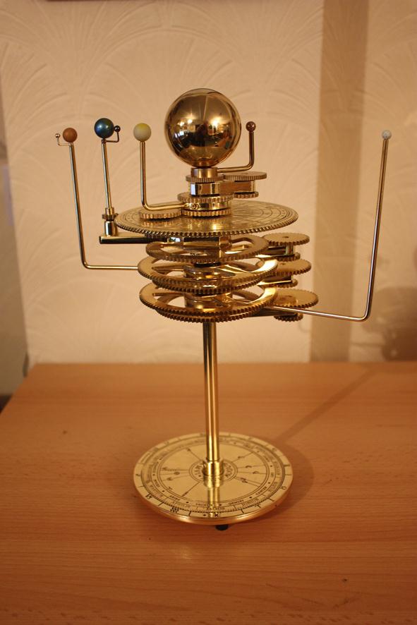

Advised by CS that issue 20 is part of the next delivery so I will have to wait 4 weeks before I can complete the next phase of the build.
Seems odd as I would have expected to receive all the necessary components to complete a phase of the build in the same delivery
Confused Confused Confused Confused Confused Confused Confused
MMMmmmmm I could always start my Redbull RB7 build. At present the complete kit is sat in a large box in the corner.

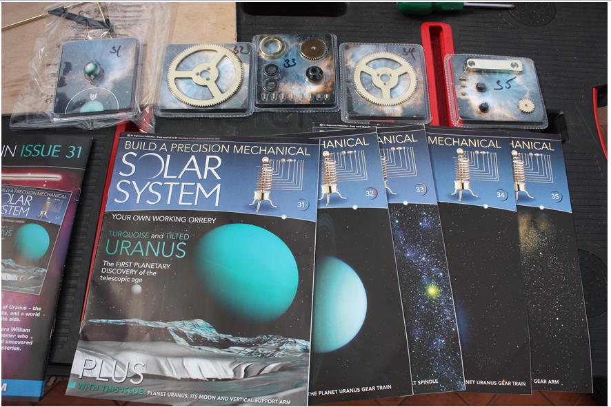

#63 Posted : 12 January 2016 11:03:36
Joined: 10/10/2010
Posts: 691
Points: 2,136
Location: Dorset
Issues 20-23 arrived today. Issue 20 is required to complete the installation of Ceres. Issues 21 - 23 need to be stored until the next delivery of parts before I can add Saturn to the display.
I am happy with the quality of the components and the build instructions are clear but it is one of those rush and wait builds. Still gives me time to complete the Arab Dhow and I have started on my RB7 build, up to issue 40 out of 100. No waiting here as I purchased the complete kit
Pictures attached

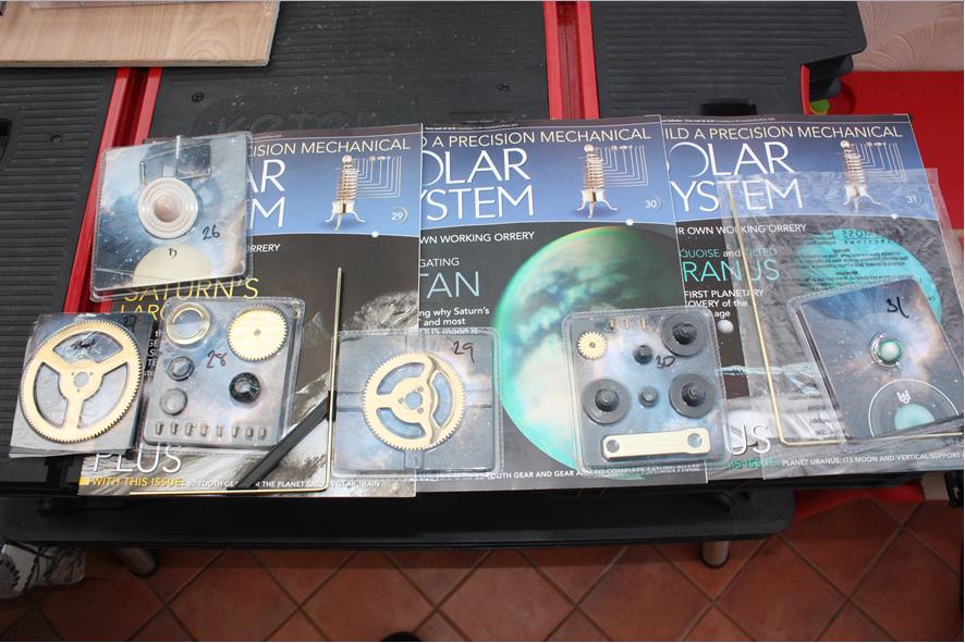

GilShapley

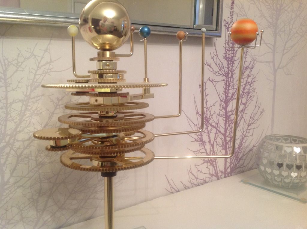

#67 Posted : 06 March 2016 16:54:32
Joined: 10/10/2010
Posts: 691
Points: 2,136
Location: Dorset
Now up to issue 31 although I am missing isssue 28 from my last delivery. Another phone call to CS who have ordered a copy for me but this will take up to 4 weeks. Oddly the parts for the issue where included with my package ??????!!!!! so I have not been delayed in the next stage of construction, but it will be nice to have the full set of magazines
Construction of the Saturn gearing and arm are as before. Just have to be careful to install the completed gears and support arm the right way up. As always RTQ.
Have had to file down some of the plastic parts (70 and 71) as the fit seemed too loose which allowed the gears to move too much.
I have yet to glue any of the planets in place as I like to remove them at each stage of the construction to avoid any damage. This kit is getting top heavy now and I was glad to see that Eaglemoss have provided replacement feet for the base to provide additional support
Pictures attached
Current Build:-

Hi Gil!
Coming along nicely now. The motor is surprisingly strong for its size, I found a drop of thin oil helped a lot on any sticky sections and the motor coped fine. The biggest problem I encountered was stripping threads on some grub screws during assembly but fortunately managed to extricate the damaged ones and replaced with spares.
By the time you come to Eris on the longest arm you'll find the sheer weight of the brass arm itself tends to droop it down a bit. I've had to tighten up that arm a couple of times. My Eris is 'Lost in Space' at the moment - She vanished about 18 months ago then reappeared just before Christmas. I really wish I'd glued her in then 'cos she's gone again!Blushing
Keep them coming!
Robin.

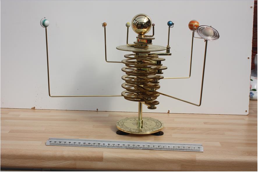

#76 Posted : 01 April 2016 15:45:54
Joined: 10/10/2010
Posts: 691
Points: 2,136
Location: Dorset
The next phase of this build is now complete. The planet Uranus (Please keep the jokes to yourselves) has now been added to my Solar System only Neptune Pluto and Eris to go.
At the rate the parts arrive that will be about another three months. Seems to be a Planet/Dwarf Planet each month.
The Ruler in the picture is to give some ides of the size of this model and it is getting heavy.
Pictures attached
Current Build:-

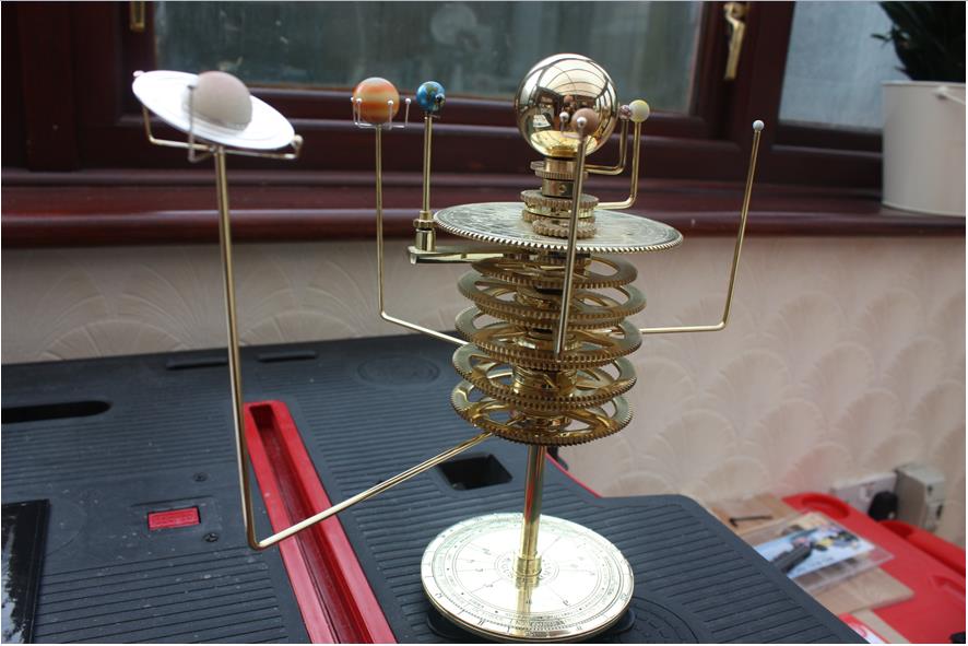

#79 Posted : 01 April 2016 20:59:16

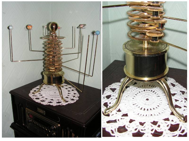

Posts: 2,090
Points: 6,265
Looking great there Gil, really taking shape now but if you think it's getting heavy now - wait till the base goes on!!BigGrin BigGrin
Derek and Tony, you do indeed get a set of very elegant legs for the base as shown below (hope you don't mind Gill)! There isn't any dust cover provided (it would need to be huge!) but you do get a couple of dusting brushes in the tool set, similar to the things photographers use on their lenses. As for keeping it shiny, mine was the first edition from a few years ago and the brass is just as shiny today as when it went together, it comes with a really good lacquer finish.
Unfortunately as you can see, Eris never showed up again! I'll be getting a map pin soon and painting it up as a replacement!Crying
Great job Gil!Cool
Robin.
