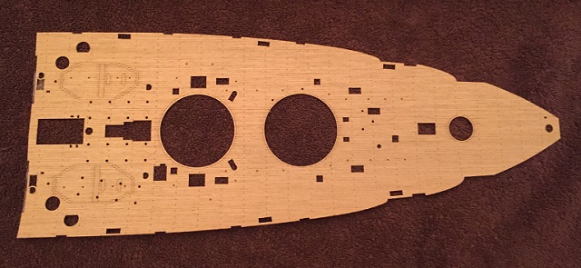

Now on to the decks.The detail set came with printed "wooden" decks with an adhesive backing.I have read nightmares about getting these decks to stick so it was with some trepidation that I started this.The first job was to remove all of the cut outs on the deck for the deck furniture. I then peeled off the adhesive backing cover and slowly stuck the deck down.I had to us a toothpick to make the deck lay flat around the raised deck details, but it went pretty smoothly and it looks really good. The next step is to put the main deck piece on.I am doing a bit of weathering on the holes for the anchors first and then I will apply the deck and add the MANY small details on the deck.
#67 Posted : 16 August 2016 19:26:02
There a beggar to put on right and you have done a fine job
#68 Posted : 16 August 2016 19:37:24
Lovely. Those wood decks are so thin they are "scarey" but you have done a top job with this one.

I used the MK1 on my Yamato, I've just had a look and it's still all stuck down nicely, it was applied as is with no other glue.
I have read of a method of neaturilising the glue on the deck, I forget the method for this, then sticking the to the model using artists medium as the glue. I'll see if I can find it again.

hopefully it wont start peeling up like some people have seen.The glue backing is really sticky-it was quite a job to remove the backing paper.The gun turrets really help to lock in the alignment.

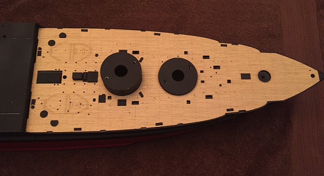

So the forward portion of the deck is now applied.This was a bit trickier than the aft section because of the anchor chain races.I had to go really slowly to prevent the deck from breaking as I was applying the decking around the anchor chain races.This decking material is actually a bit stronger than it looks.I am now in the process of painting the deck details (tons of them) and I have started work on the main turrets.

Excellent work with that decking, looks great.

It's definitely a nerve racking process getting the deck on but as you can see the end result is really worth it. She looks awesome.
