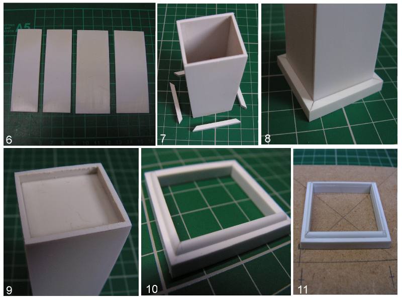

The main part of the plinth / base is shown in Photo 1, this is a 4 inch square pre-shaped base in MDF. This one I bought on Ebay, and at only £2.45, trying to router one myself is pointless in both costs and time! (I’ve also sent for another one, 4 inches by 6 inches for the Cook 250 competition for only £2.75.) These bases are machined from an MDF ‘plank’ which means the top and bottom are nice and smooth but, as can be seen in Photo 2, the routered or shaped sides, in this instance ‘Ogee’ shaped are much rougher as the router bit ‘fluffs up’ the fibres. The solution to this is to repeatedly varnish, let dry and then sand down the edges until the varnish has filled in the texture and the sanding has made it smooth. The result of four applications of a water based acrylic varnish together with sanding down with a foam block sander is shown in Photo 3. You can also see the pencilled in lines to mark out the centre location for the upright pedestal in this shot. My intention was to glue a raised block in the centre shown by the impression in Photo 4. This would then form a locating lug for the pedestal to fit over on the final resin casting. The construction of the pedestal is illustrated in Diagram 5 – the parts are cut from a sheet of 1.5mm plasticard with a decorative border composed of a surrounding frame of 0.125 x 0.156mm Evergreen StripStyrene topped with a Plastruct 1.5mm Quarter Round (or Quadrant) with a small top border of just the Quadrant. There would be a false bottom inside the pedestal corresponding to the height of the locating lug and a solid top to fit the finished bust onto. The front face of the pedestal has three holes drilled through, blanked off on the inside to create locating pits for a plaque and campaign insignia. Hopefully you can follow what I’m describing here, if so – well done you! Now you can disregard all that because I changed it all in mid build!BigGrin
Photo 6 shows the start of the actual construction. Here we have the four sides of the pedestal in the 1.5mm plasticard – that bit hasn’t changed! You might notice some yellowy discolouration in the plastic, this sheet is over forty years old, rescued from the old garage workroom last year but still perfectly good condition despite the rain water leaks and mice! The sides are not mirror copies though, the pedestal is a slightly stretched rectangle and not a true square. The first sections of the lower decorative border are shown in Photo 7, and this is where the changes occurred. I had already glued the pedestal sides together and fitted in the false bottom and was trying to decide whether to make the locating lug out of square section plastic rod or a solid piece of plywood. Whilst making my mind up I began the border as seen here and suddenly realised I didn’t need an inner locator at all – by not gluing the border to the pedestal, but gluing it instead to the base, that was the locator! So in Photo 8 the plastic sections were test fitted to ensure they gave a tight joint and were then glued corner to corner, two at a time and carefully pressed up against the pedestal ensuring the Liquid Poly did NOT attach them to the uprights. This meant that the false bottom, which was no longer needed, now became a false top! The pedestal was turned upside down as shown in Photo 9 to become the locating valley into which a protruding plug now to be added to the bottom of the bust will fit. Sometimes the best solutions aren’t planned at all – they just evolve along the way!Blink The Plastruct quadrants were then cut to size and glued on the top of the border, butting up against the pedestal sides with the same precautions against accidental adhesion. Once all four sections were in place as in Photo 10, the finished border was super glued into position on the MDF base as seen in Photo 11. In the foreground are yet more pencil lines – these mark the position of the nameplate for the base and the positions of the two holes to be drilled in to take the nameplate’s locators.

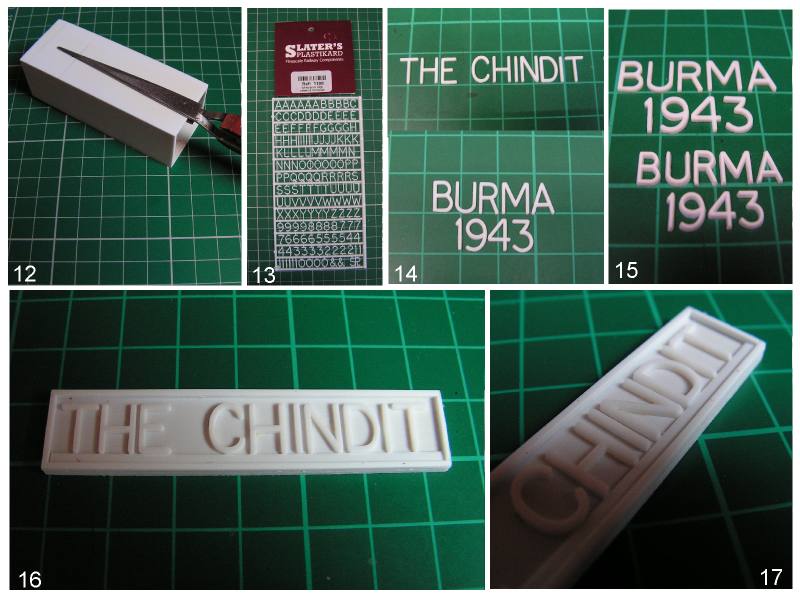

Photo 12 shows the spring tweezers placed inside the now completed four sided pedestal ‘box’. What you can’t see here is the small rectangle of 1mm plasticard being held tight against the inside face of the box as the liquid poly glue dries. Two such pieces were glued inside under the position of the twin name plate holes together with another two under the insignia locator hole, finally giving a thickness of 3mm to the pedestal at those points. Once the inserts were set in place the locator holes were drilled out with a 2.5mm bit to match the 2.5mm styrene rod I would later be using to form the studs on the rear of the nameplates. The actual lettering for the plates will be made up from the excellent ‘Slaters Plastikard Letters’ as shown in Photo 13. These are primarily designed for the model railway fraternity and are intended to create the old style cast-iron railway station nameplates. They come in a variety of sizes from (I think) 2mm and upwards. This particular set is the 8mm size although as you’ll see below, I also had to send off for a 6mm set afterwards. Some of the letters require a little cleaning up for flash along the sides but that’s fairly easy to do and the first set of letters were cut out to form the base title plate “The Chindit” and the pedestal plate “Burma 1943” as illustrated in Photo 14. This is where the little problem came in – The Chindit was fine, but Burma 1943 was fractionally too big to fit across the front face of the pedestal! Off went the order for a set of 6mm replacements, the difference in their sizes can be seen in Photo 15. These, allowing for the actual plate and the frame on which they sit were just the right size. Photos 16 and 17 show the main nameplate with the larger 8mm letters glued down. Note along the bottom there is a 1mm strip of flat styrene. This isn’t glued down but just placed into the recess of the plate and is there to provide a straight edge to align the bottom of the letters along. Once the wording is complete and stuck in place it will be removed before making the rubber mould. In the best traditions of penny-pinching modelling, the letters themselves are only ‘just’ glued down themselves. Each letter was given just three tiny dots of Deluxe Card Glue on the rear face before carefully placing it in position with precision tweezers. The letters only have to remain in place until the silicone mould is made. Those letters still attached to the plate after removal from the rubber mould will be removed by placing the plate in warm water to soften the pva glue. This means I can save the cost of replacing the frets of letters by re-using the same letters over and over (tight huh!)Flapper
The spacer strip is shown removed from the plate in Photo 18. The smaller pedestal plate with the 6mm lettering is pictured in Photo 19. This one had two strip spacers, one at the bottom as in the larger nameplate which spaced the ‘1943’ and one at the top to which ‘BURMA’ was lined up against. The little moulding box for the pedestal plate is seen in Photo 20. As you can see by the alignment holes in the plasticene, this little mould is a two parter just like its bigger brother, this is to cast in the two locating pins on the rear of the plate which drop into the moulded pits on the pedestal. The last item to be included on the base is a representation of the campaign medal which all Chindits would have received – the Burma Star. There are actual authentic Burma Stars available on Ebay, sadly probably from house clearances or whatever but I didn’t feel comfortable with using someone else’s hard won award for this project and so the medal and ribbon shown in Photo 21 is actually a reproduction, also available on Ebay to replace lost originals or for collectors (or me!)BigGrin This was also made up into a two part mould as shown in Photo 22, the resin version will have a single locating pin on the rear face to fix into the pedestal. Photo 23 illustrates the first half of the rubber mould with the Star still in place and with the styrene rod pin card-glued onto the centre (found by pencilling a line from opposite star points.
