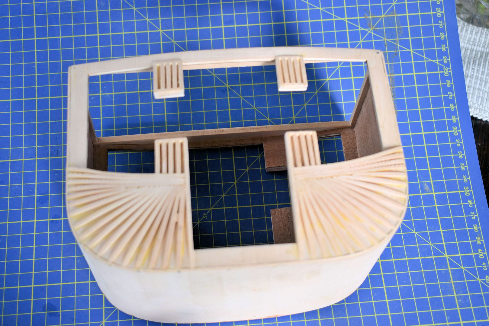

Looks like a lot of work to get the outside shape, but will be worth the effort.
WTG Cool Cool Cool
#62 Posted : 13 February 2019 20:03:56
Your right there Derek about the work,the main thing with this was to try and keep the same curve all round,and that can only be achieved by sanding down to a knife edge and continuous checking.Thanks for turning the pages.
Trev.
#63 Posted : 13 February 2019 21:10:53
A lovely clean job TrevBigGrin nice work.
#64 Posted : 15 February 2019 08:00:14
Thanks for looking Al, had a problem when assembling the length beams when cutting clefts on the two suspension stabilizers, I slipped and ran off chipping the wood,so I have had to scratch build three more to match.
Trev

#69 Posted : 03 March 2019 19:12:24
Hi Kev,
Thanks for looking in,added skins to the build, glued them as close as possible which will help with the final finish more soon.
Trev
#70 Posted : 03 March 2019 19:40:01
Hi all,
Just a quick update on progress I have finished fitting 1x5mm outer beams and shaping, also removing the sharp edges this will give a bulging effect ready for the dark outer wood more soon.
Thanks for looking
Trev.

#76 Posted : 17 March 2019 22:06:38
update:17.3.19
With the dark wood 1.5 mm I have added back and front following the fitting order as shown in my photo above,then to sand down with a fine grain sand paper until the surface is smooth and uniform.
Then cut pieces from 0.6x30 sheet to line the exterior part of the curved wall, I used a brush to spread the glue over the entire walls, once the glue had dried I cut away all the surplus edges and sanded down leaving entire surface smooth and even,having reached this point I intend to polish the wood.
Trev.
