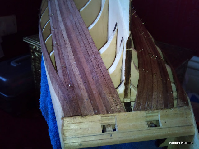

#61 Posted : 11 September 2010 10:10:23

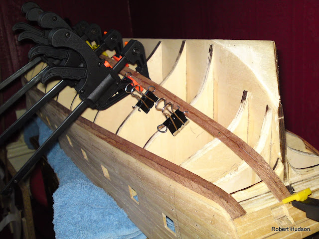

Hi Robert.
Looking good.
The Sapele is like the Mahogany on my san francisco 2, To get it to bend easily I left the plank in boiling water for a couple of minutes, then if you have an elecy plank bender get the bend with that, if you don't have one I used my wife's iron to do it. It works a treat and saves on breakages of the wood. ( the ends with a major bend like the first 2 planks at the rear just soak for 15 minutes will allow you to bend and twist them..BigGrin
Hope you don't think I'm interfering..
Cheers Chris..

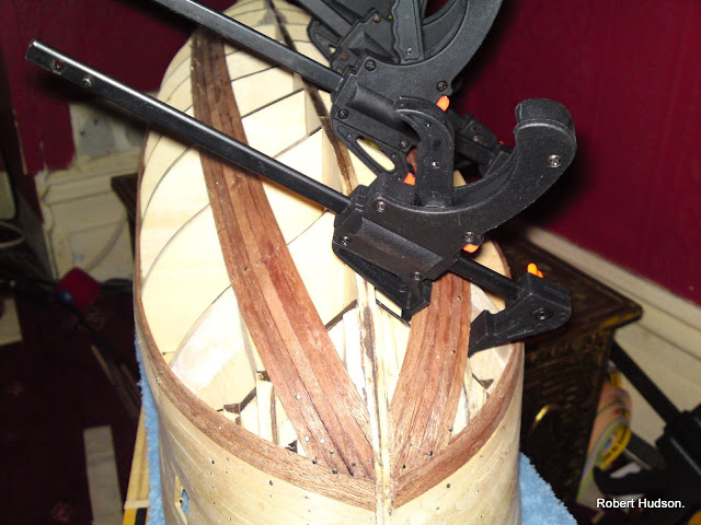

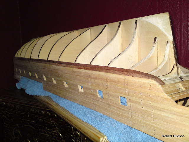

Well that's the first two Sapele planks done now for the hard part lol

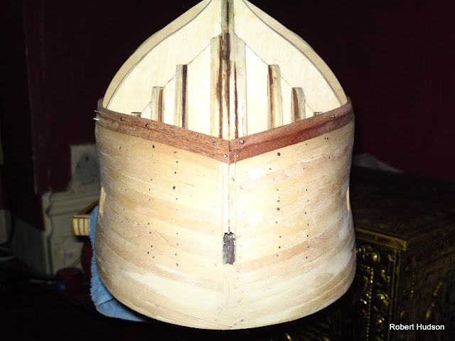

This where I am Determining where the fist of the Sapele planks should start.

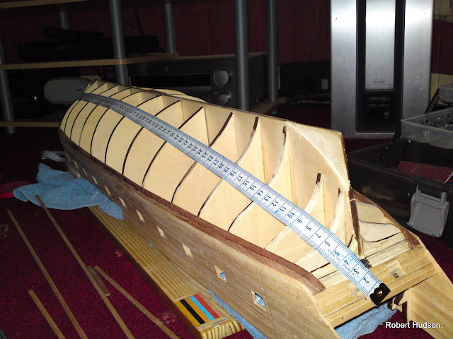

Surprise is looking absolutely great...what will be the exact length of it? Looking for a second build...Love

#74 Posted : 30 September 2010 15:21:21
Joined: 25/01/2010
Posts: 459
Points: 1,367

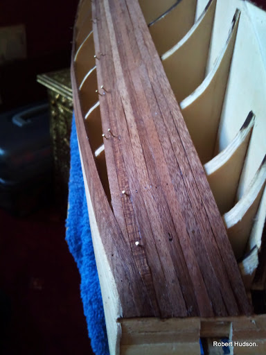

Location: Bridlington
Rob
Bridlington.

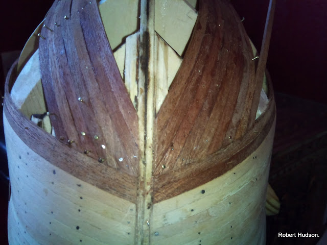

#75 Posted : 30 September 2010 15:26:47
Hi Robert,
Looking good there now with the planks going in place. The sapele is less forgiving than the limewood isn't it.BigGrin.
I am ordering the walnut planks for mine next week so I can crack on with the hull.
Thanks Chris..

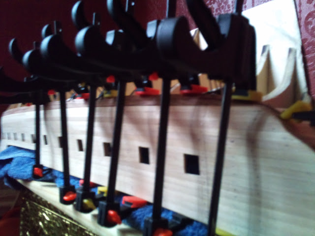

Yes the planks do look nice, will post pics later. todayBigGrin
