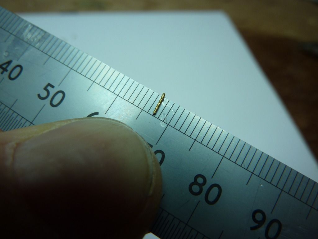

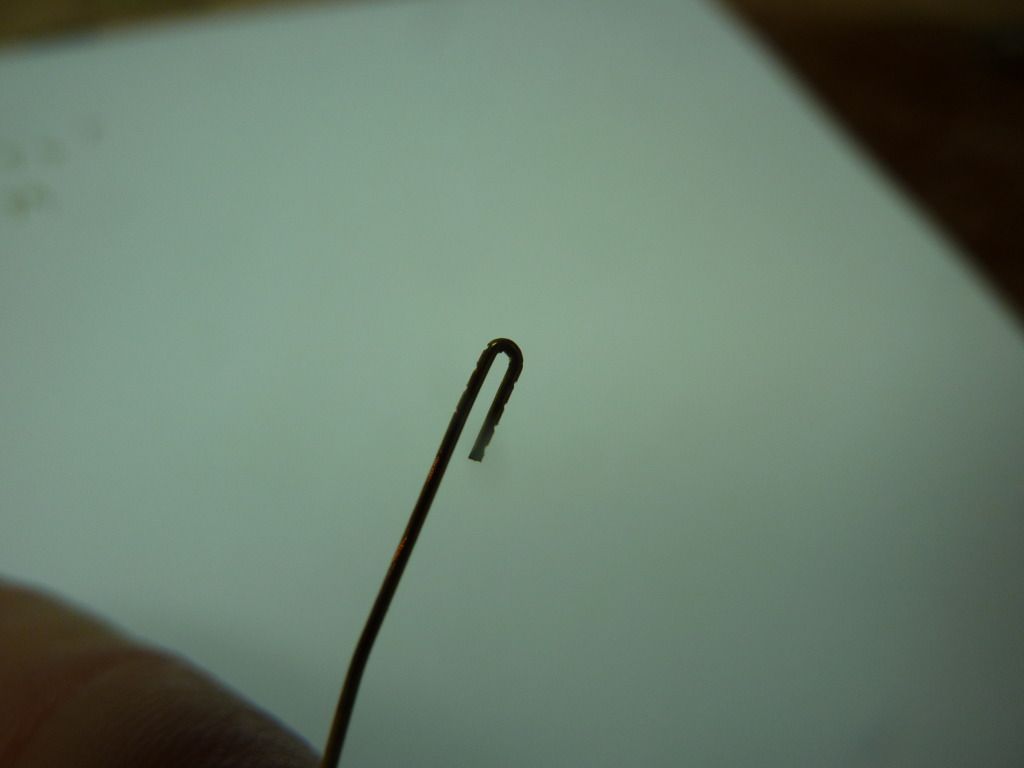

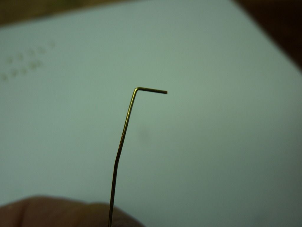

Here are a few pictures showing how I make the hooks for the blocks.
First I bent a piece of wire through 90 degree's.
I then bent it over my rule and crimped it with the pliers
The tail here is to long, so I nipped it with my nip's
Hook formed, just cut to length now,

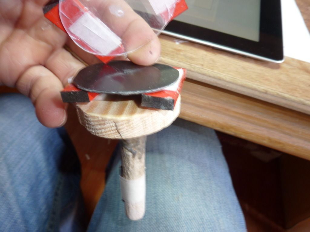

This is tyhe contraption I used to make my coil's
I got the idea of another site, works ok, but a bit of work making the jig.

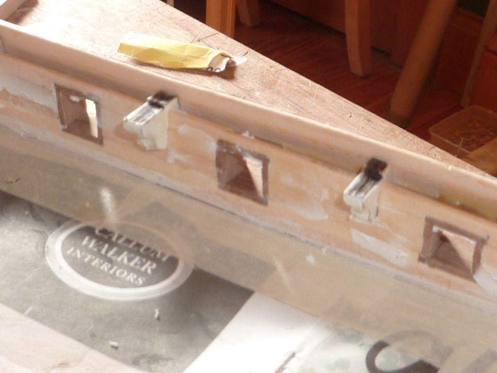

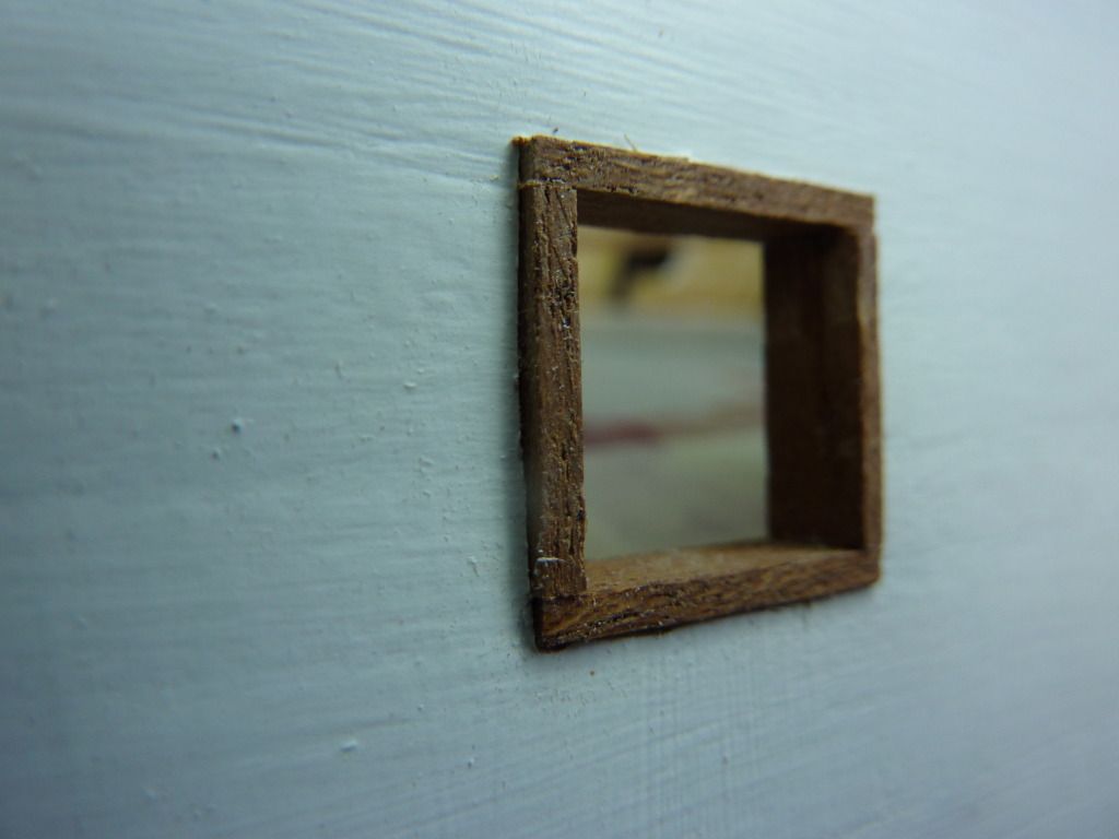

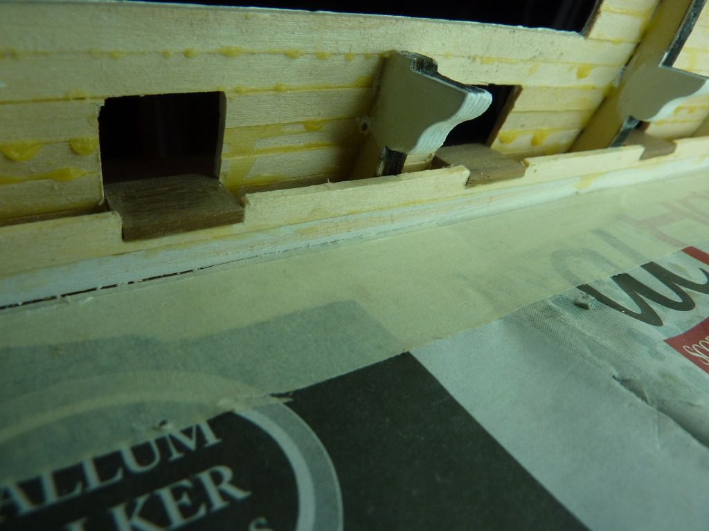

I am now doing the liners to the gun ports.

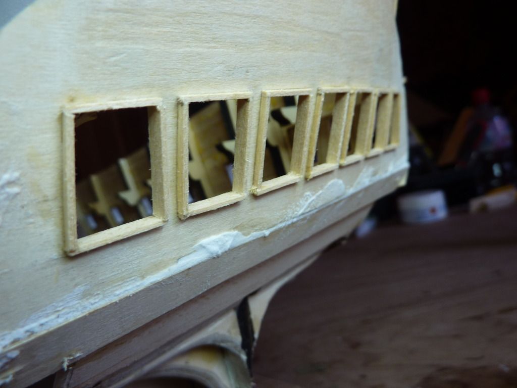

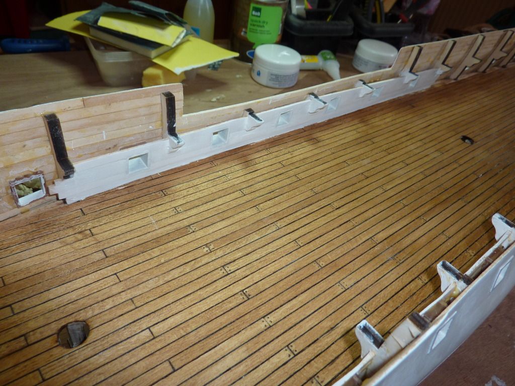

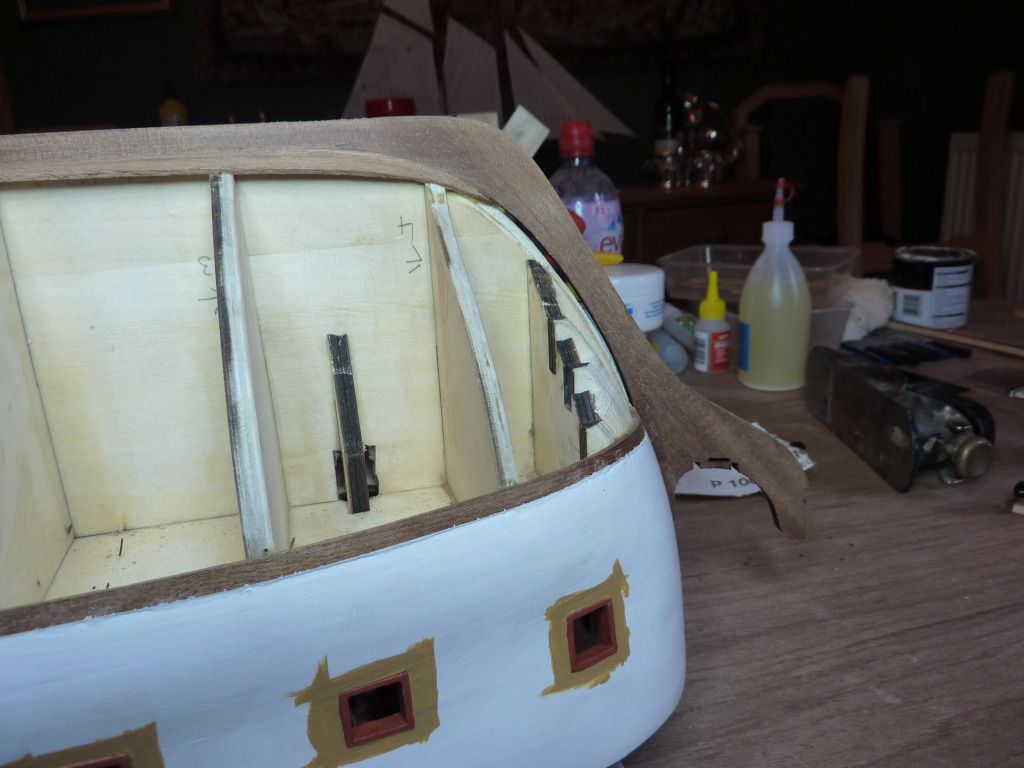

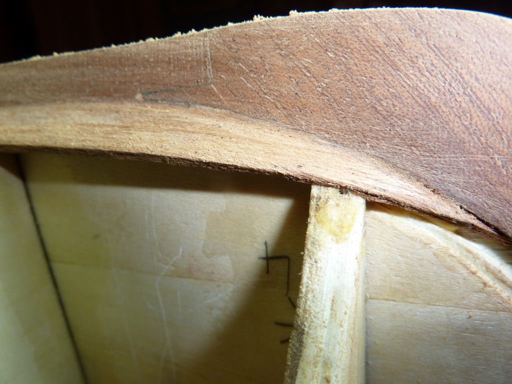

The instructions say to line the ports with 4 or 5mm walnut, but the gunports within the bulwarks ( is that the term ) they use a wider walnut piece, the instruction say to do the bulwarks only to 7 frames,
If I were to do it again I would do the bulwarks to all the frames, as you can see the differance of the timber sizes from the outside.
As for the gunport liners, I have done one side, I put the bottom piece in first, then the top and put the verticle pieces in last, On the other side I will be putting in the verticle pieces first then the horizontals, It will be a lot easier that way.
The completed bulwarks, filled ready to sand and prime. This has been the hardest job so far.

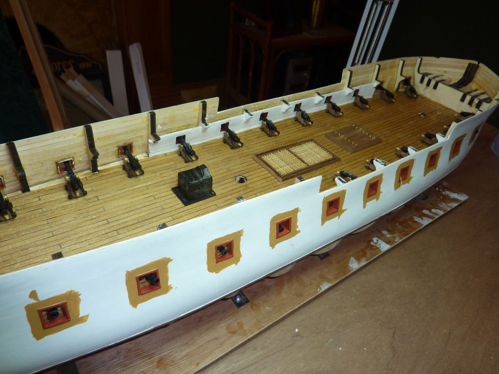

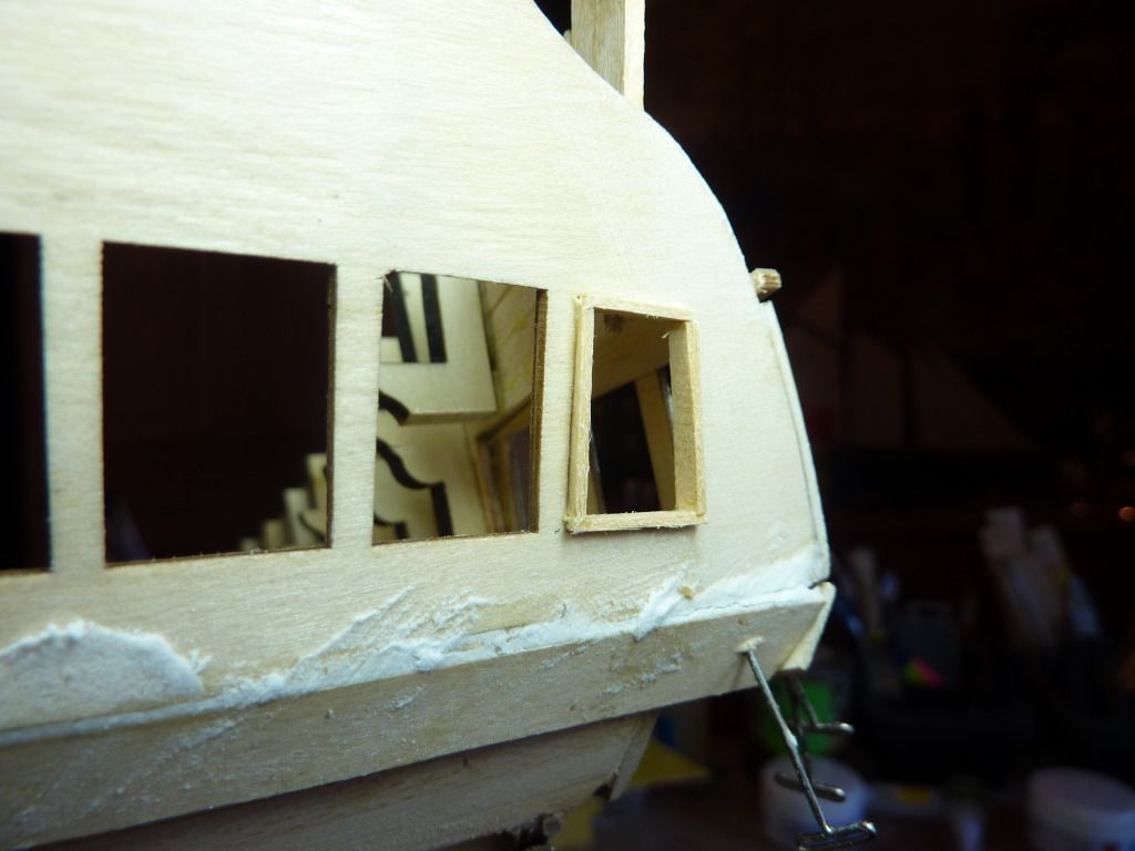

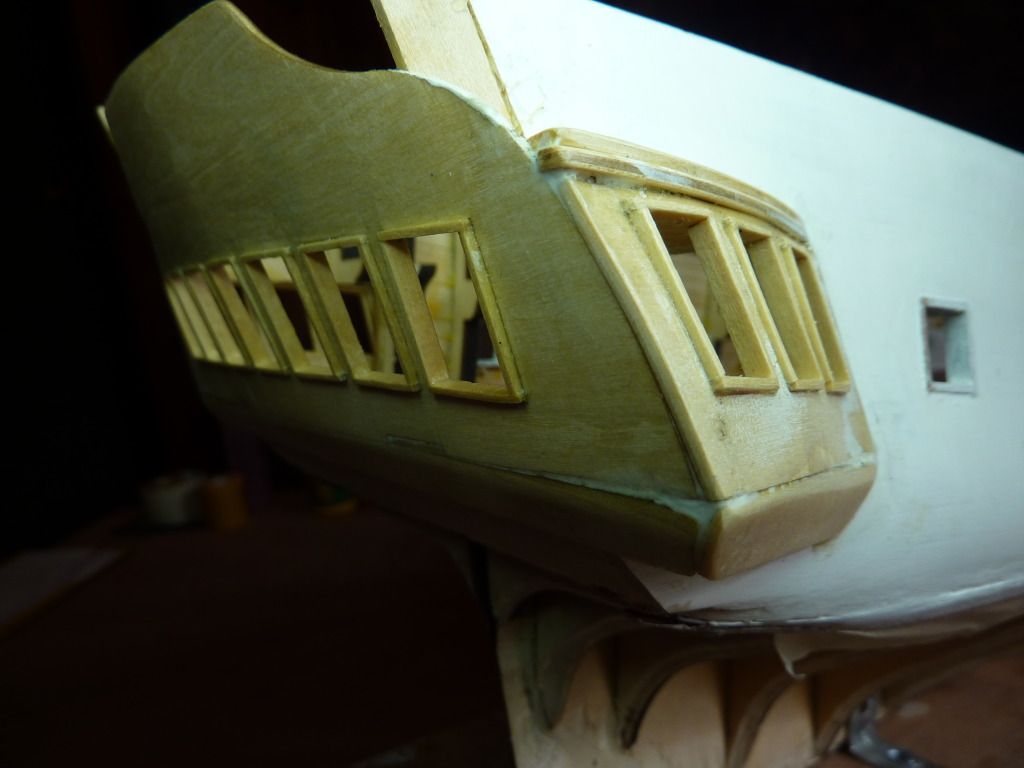

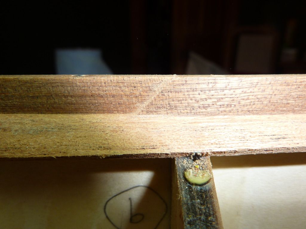

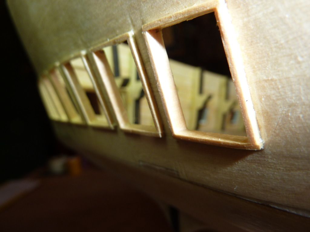

Well its been Work Work Busy Busy Chop Chop Bamg Bank again in the boatyard, I have been tidying up the Captains Quarters area, I have fitted all the window beads, and fitted the first two sections to the side window roofs,
I filled asnd sanded and gave them a coat of sealer before painting them.I am quite happy with the way the window beads have turned out.Its great what a bit of sandpaper can turn out.
This is the finished Bulwarks, Again happy enough with this. I know some of the boards are uneven and twisted but I think this is quite authentic, as the real ships have a lot of warped and twisted boards. ( thats my excuse and I am sticking to it. )
I have now also painted the inside of the gun ports, I am trying to add a bit of colour to my model to cheer myself up a bit. Its probabally a bit out of secuence but who cares. I am avoiding the bottom planking like the plague, But it will come soon enough.

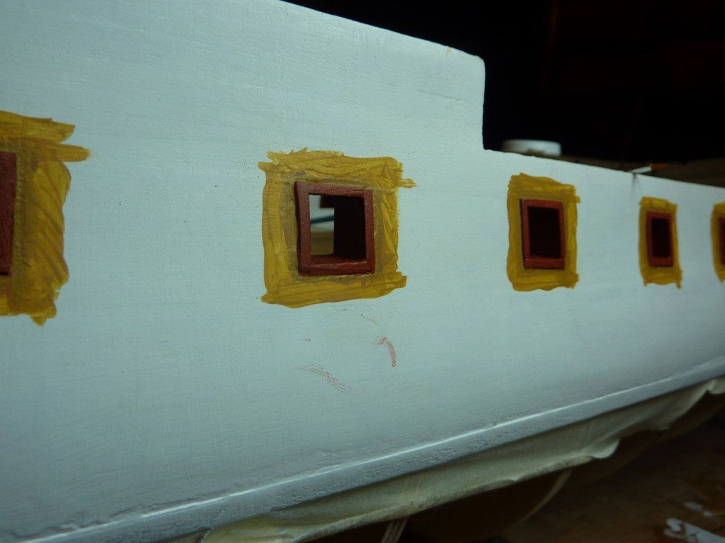

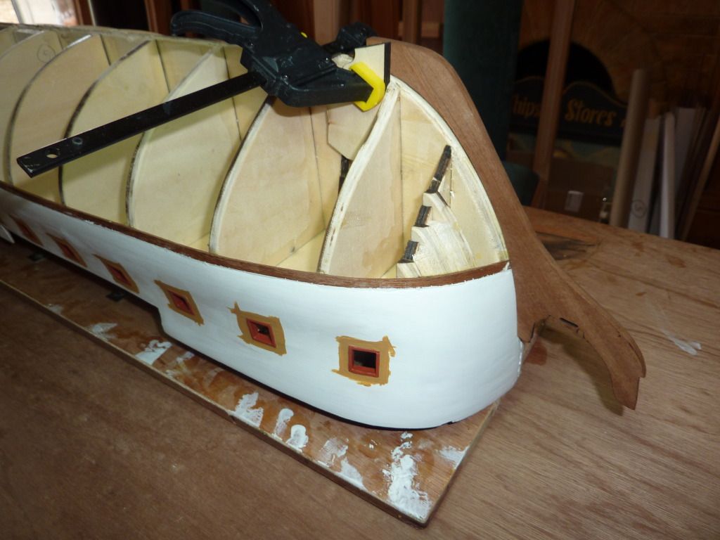

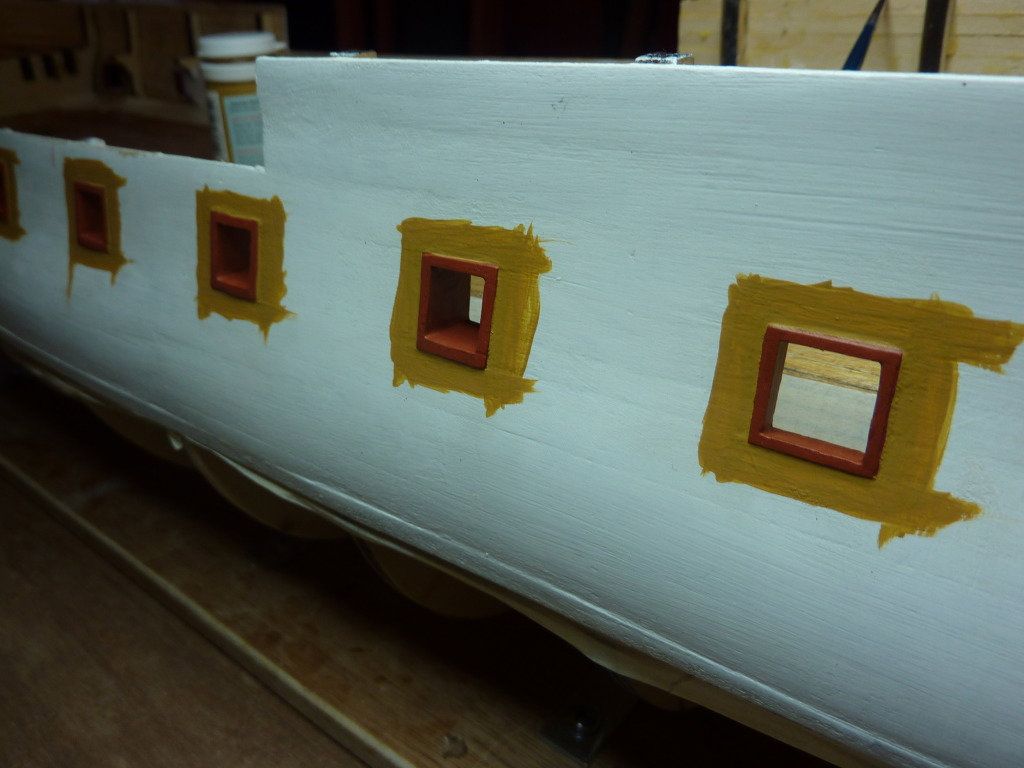

I have now painted the gunport liners Ochre Red, and I am now cutting in around the liners to tidy them up, with Yellow Ochre It taking 3 coats to get a reasonable result,

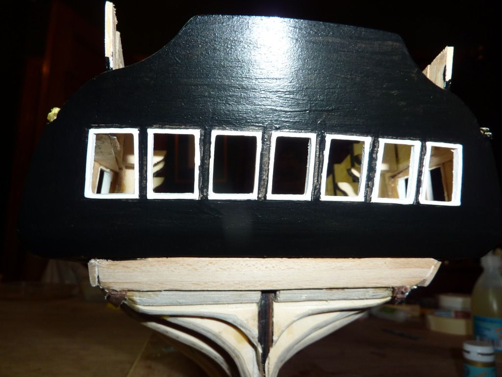

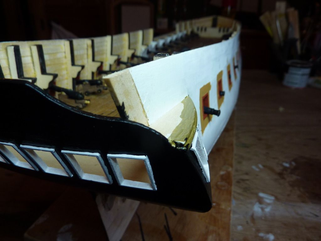

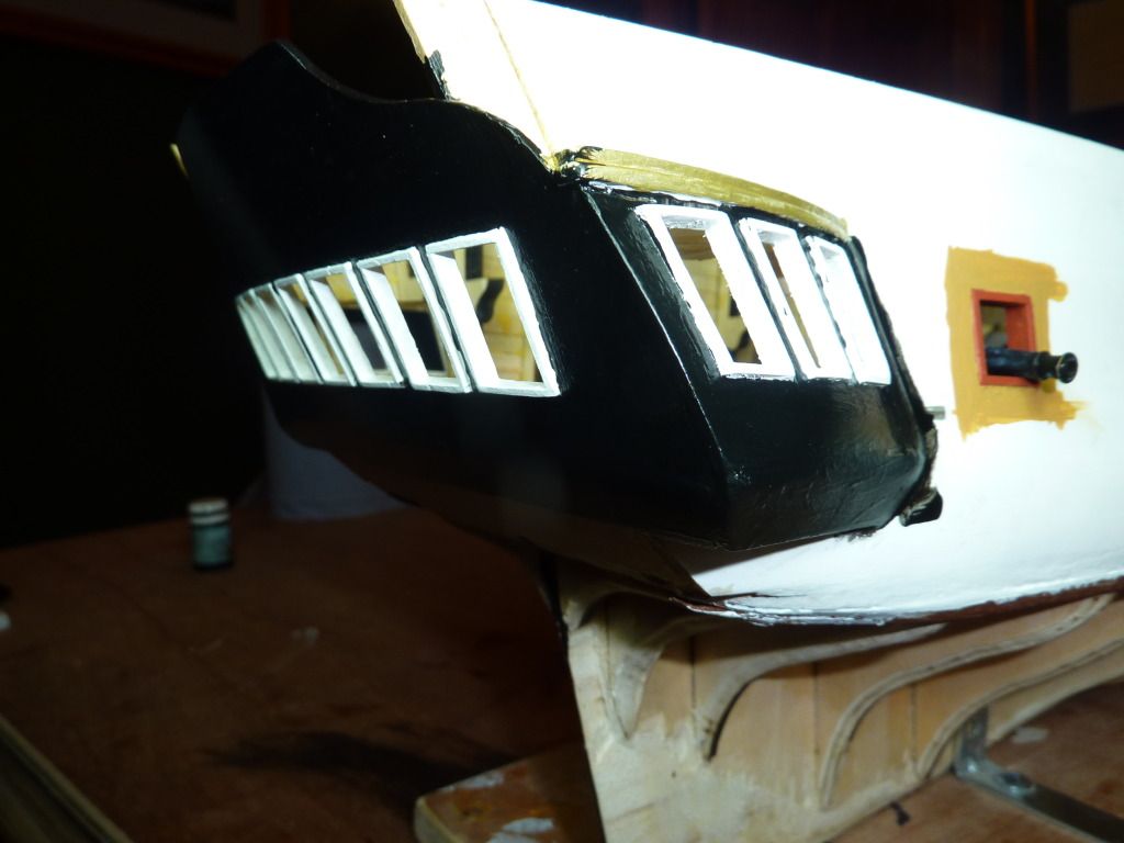

Another update of progress, I have decieded to paint the captains Quarters the classic black and white. I have given the woon a coat of sealer and a couple of coats of paint, Not finished yet but will tidy up later, was really just seeing how I would get on at the painting, I need to get a couple of smaller brushes. But all in all quite happy.
I find these close up pictures make every flaw 10x worse than it really is, all in all it looks not to bad to the naked eye.

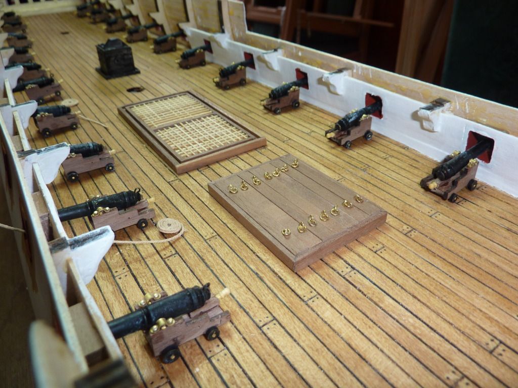

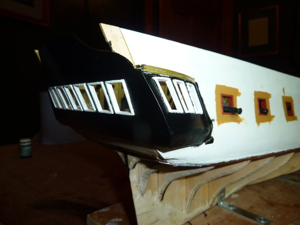

I am now waiting for a couple of 10mm Garland (is that the term )planks to start the bottom planking, been putting this off for ages, Before I turn the boat over I thought I would put the cannons in place with the other bits and bobs I have made to see how it looks.

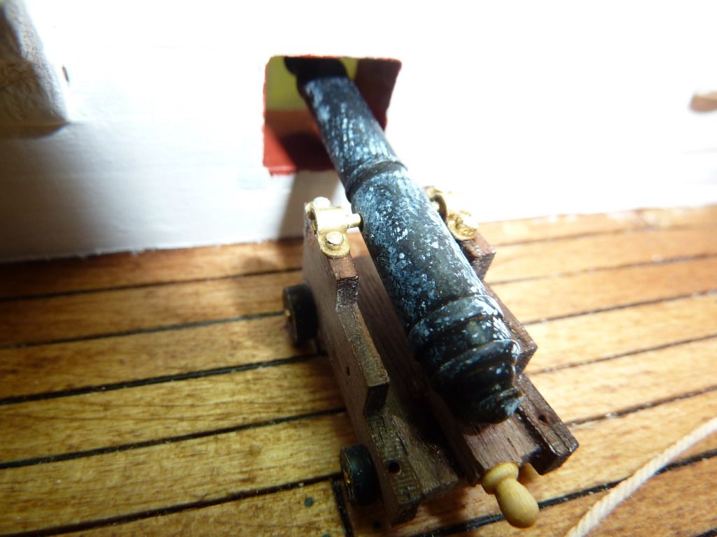

In this last picture you will see a problem I have with the cannons, I am getting white residue from somewhere, I can only imagine its from the brass blackening solution, but after I did the treatment I washed everything very well, perhaps not well enough, any help or advice from anyone on this.

the white residue is wipeing off with a quick rub of the fingers

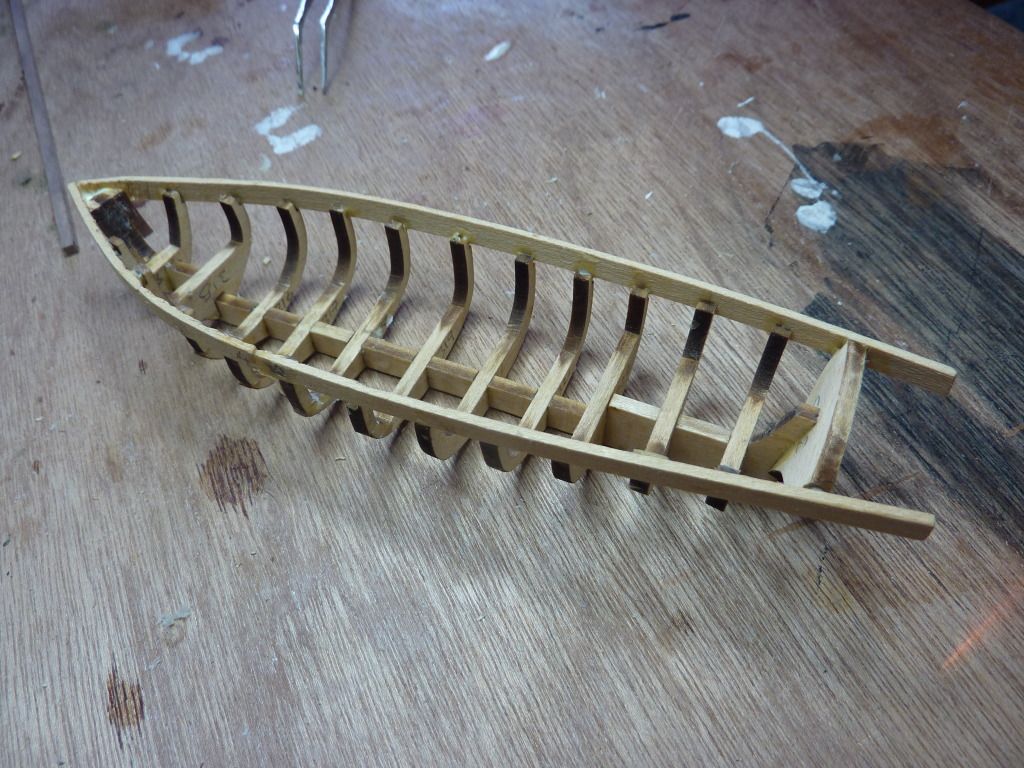

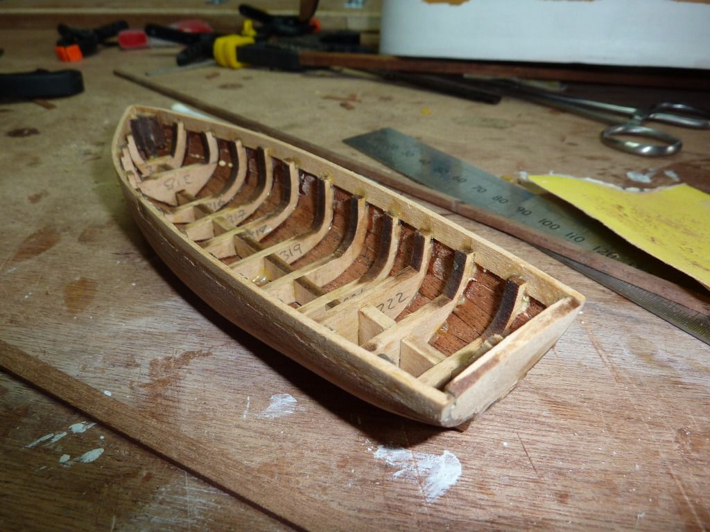

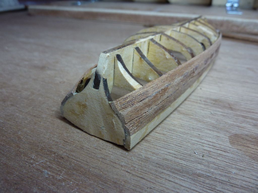

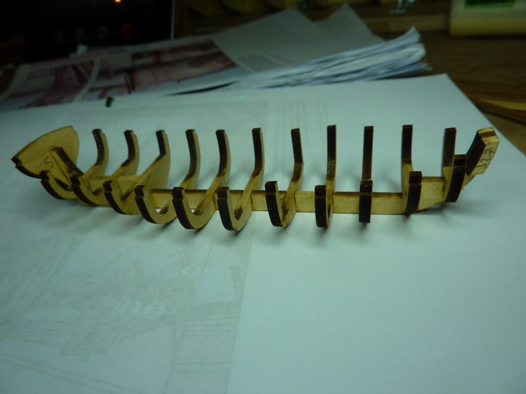

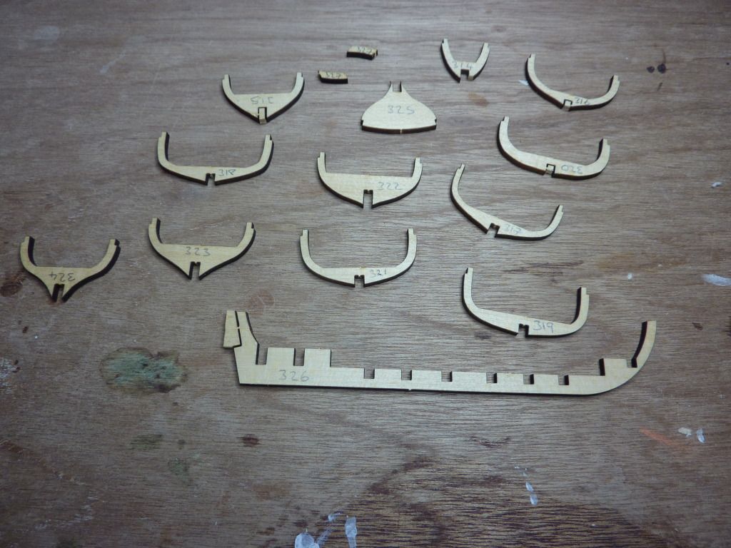

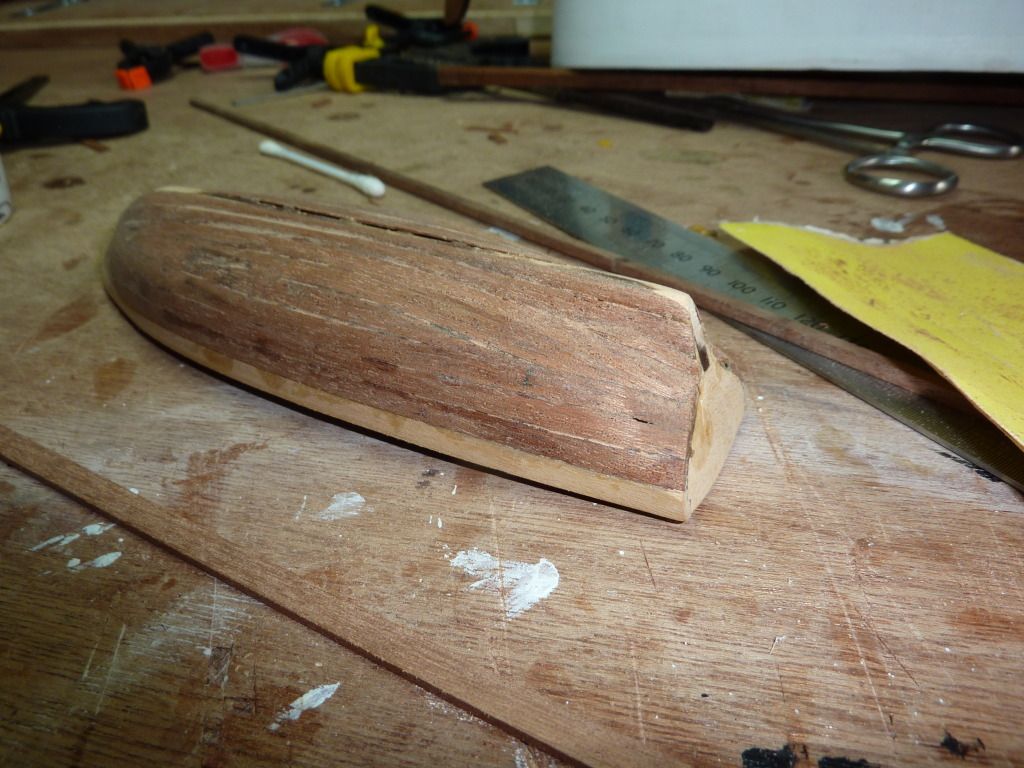

And now on to the launch, The frames for this are made out of timber, very very easy to break, It would have been better bif they were made from plywood. I broke a couple of them trying to get the planking bent to the shape of the hull, The launch is to be double planked, I am quite happy with the outcome so far, I still have to do the 2nd planking, I will takle this later, it should be easy to do , as the planking is very thin.
The keel of the launch is 3 x 3 walnut, but the curved bit of the keel that comes up the front of the launch, supplied with the kit is not the right shape for my build, That is because I have not got the planking tight enought to the frames supplied, I will get a sheet of walnut and cut and fit one at a later date.

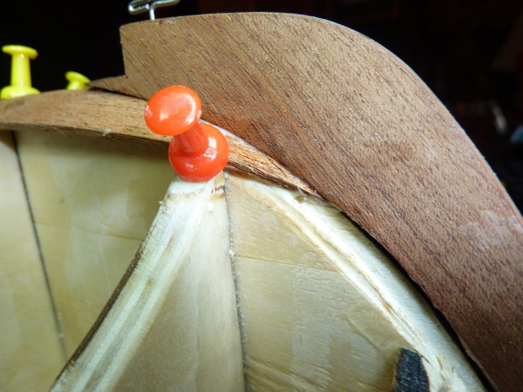

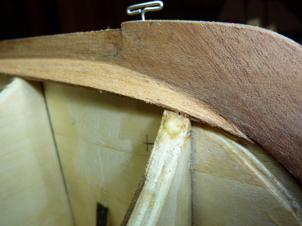

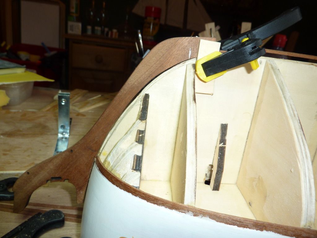

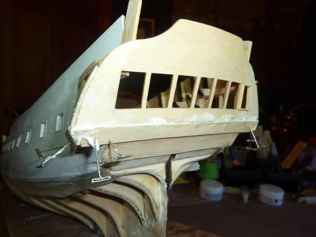

I have eventully upturned the hull to do the bottom planking, I have read all the stuff I can find about it, and I have read the build logs on the site, but to be honest I still don't fully understand it,
I have fixed the bow keel thingie on.
I chose to take a rebate out of the plywood keel, rather than take a rebate out of the walnut keel itself, I then glued on my garland planks and let set, before sanding flush with the plywood keel, I then pinned on my walnut keel tight on to the garland planks itself.
I also put a scarf joint in the keel, as the timber supplied is not long enough to span the hull in one.
