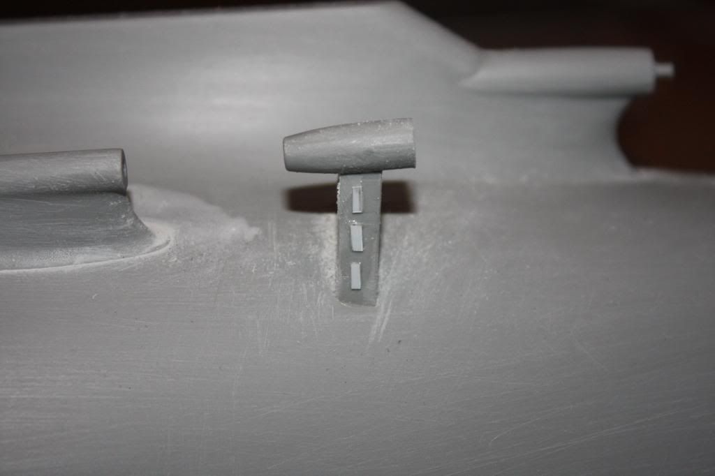

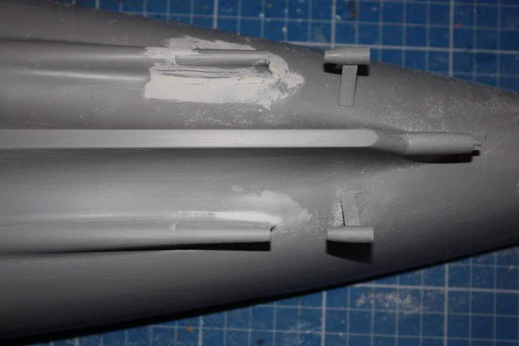

Prepping the Hull Continued.
Total build hours 7.5
I have fixed all the lower hull items on with the exception of the propellas i am hopfull of adding some brass ones but been unable to source any so far. I have filled all the gaps and started the proces of sanding wich will remove the eyebrows and hand irons that i will be replacing with etch.
The little rectangilar strips on the rudders are zinc strips, there should also be three on the propeller shaft support (see link for wreck reference pic)
http://www.bismarck-clas...k/bismarck_wreck_5.html

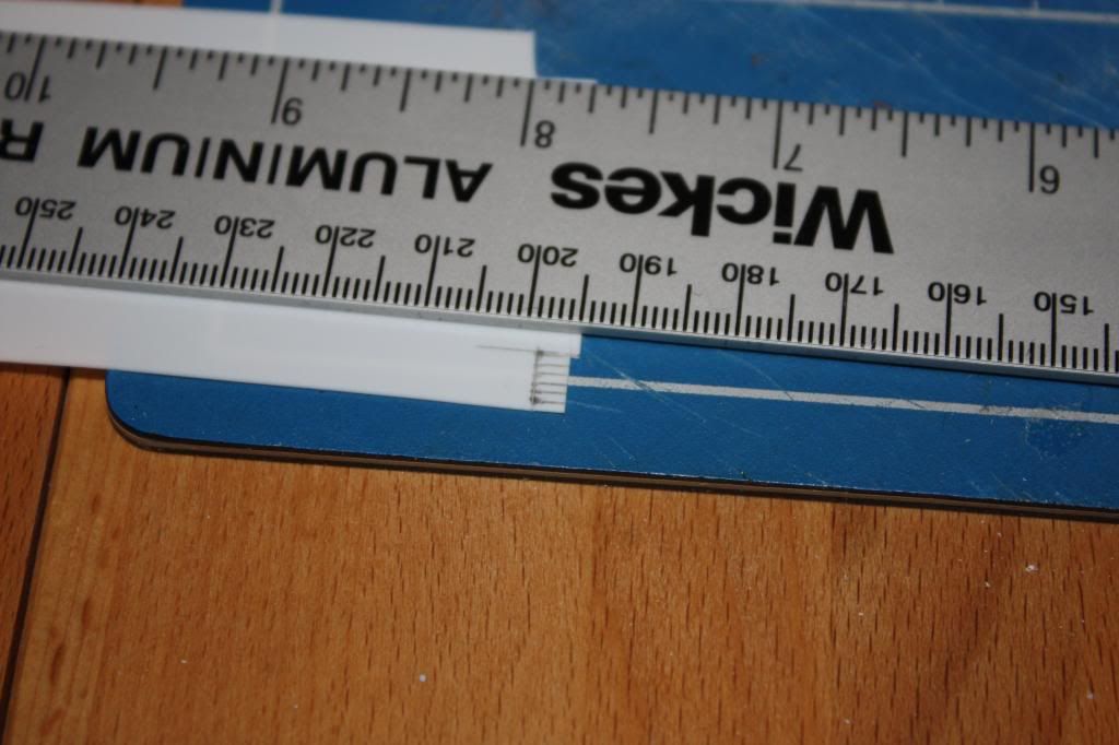

I have added these scratch built from plastic card they are 3mm x 1mm.

I've seen these on another build, but only 2, been trying to find out what they were. Are they sacrificial anodes, to avoid screw corrosion? My other question is are they on both arms of the support or only the outer arm?

I think they are just on the outer leg that is what I will be doing. Defiantly three not two as the if you follow the link and scroll to the bottom you will see a pic of the wreck with the three visible. Also these are not hull red they are white. Interestingly the Tirpitz had a slightly different arrangement

Sorry Jase, I read through too fast and missed the linkBlushing.
You are quite correct there are 3.
They are Sacrificial Anodes (or Galvanic Anodes) these are used when Metals are in corrosive environments, that is buried or in this case in Sea Water. The process is to use a metal which corrodes more readily than the Metal you want to protect (because of it's higher Electrochemical Potential) usually Magnesium, Aluminium or Zinc (Zinc was a preferred option in Sea Water). What happens, is that these blocks corrode first rather than the valuable parts, in this case I think it's the Propellers/Screws, which are of course bare metal. These Blocks would have needed replacing regularly, as they 'took the hit' and 'rotted' away. I'm surprised that anything is left as the corrosion would have continued at the bottom of the Ocean. Maybe it's just a mounting left? Although I suppose the Props would've no longer been moving and therefore continually scoured, so would've formed a protective oxide. As to colour they would have been Bare Zinc Metal, as Paint would defeat their purpose.
[/quote]
Thanks Andy, so colour would be silver grey?

I guess a Dullish Silver Grey would be about right, the same colour as Galvanized Steel which is a Zinc Coating.

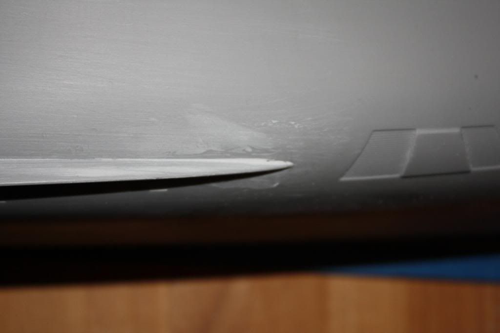

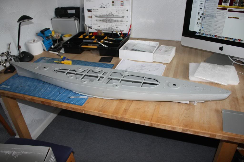

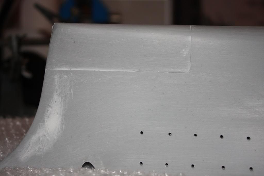

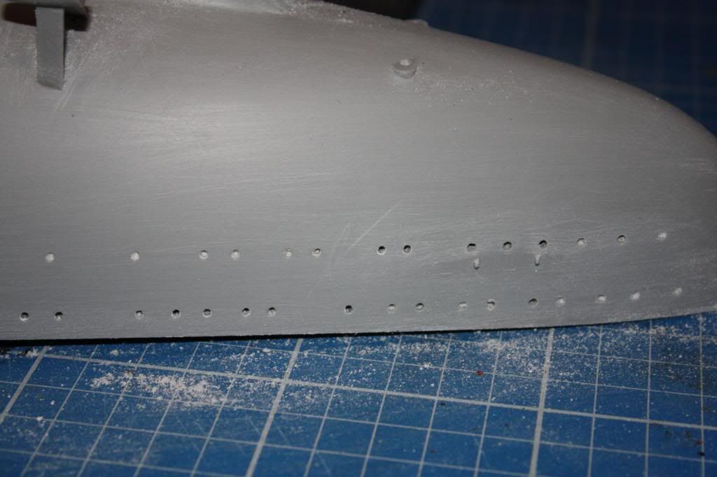

Prepping the Hull Continued...
Total build time 10.5 hours

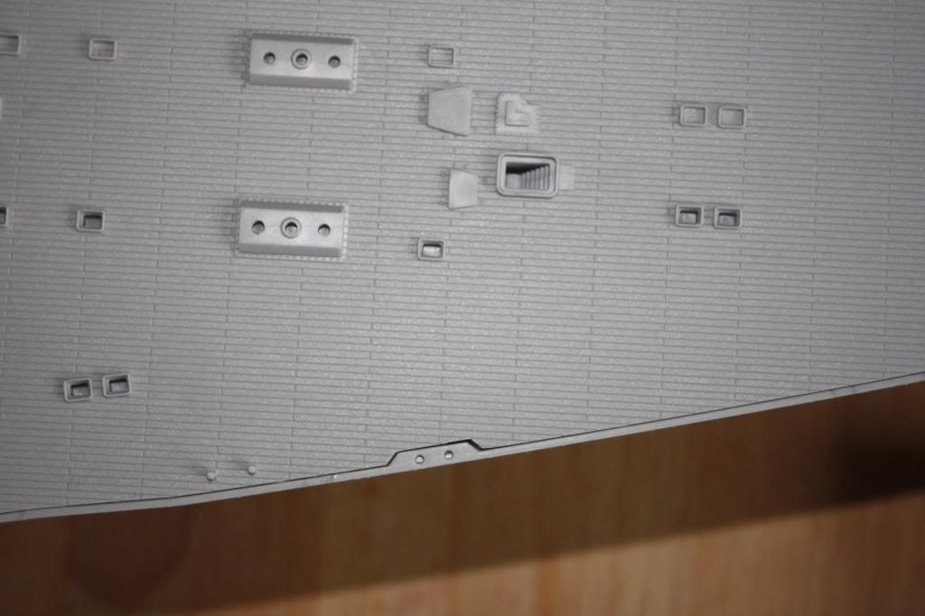

I have now completed the initial sanding of the hull. The sink points have sanded out ok I only really needed to fill at the bow. All the hand irons and eybrows have gone, I also removed the little molded on brackets as i will be replacing these.
Next job was to fit the deck to allow me to make a couple of further modifications to the hull. The deck goes in snugly with only some very minor gaps to fill.
As always any comments warmly received Thanks

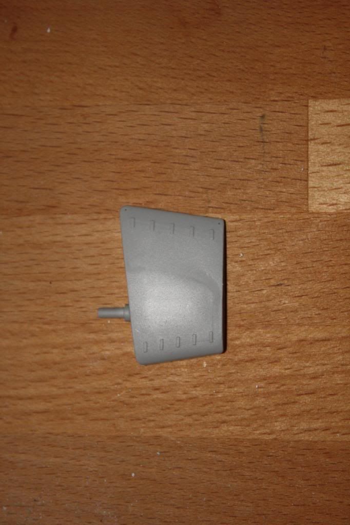

I've just noticed that there are Sacrificial Anodes on the Rudders as well 10 on each side of each Rudder. Trumpeter have thankfully added them. So these will need painting Zinc too.
#76 Posted : 14 March 2013 20:37:21
court orchard wrote:
Hi Jase,
Yes if you look at my pis above you will see that kit provides the rudders with them already on and in the correct positions.Cool
