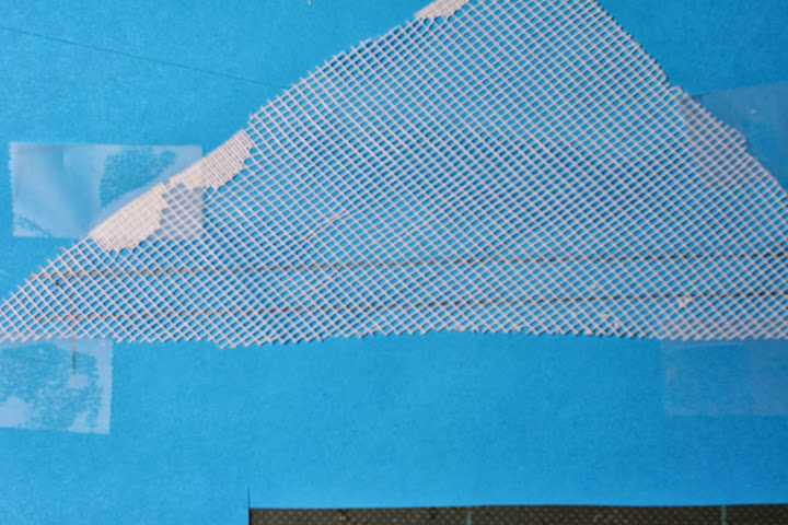

Next I did the netting using net curtaining as before.
The first thing was to make a paper template of the size from the fitted cranes, then draw that shape onto some coloured paper, (white paper would probably do but the netting would be harder to see.
The netting was then positioned over the marked lines and a smaller piece cut off to work with.
My netting has the correct size (about 1mm squares at my 1/100 scale)pattern on it but is in a "square" format as apposed to "triangular", which means I have to turn it, and that means more waste material, I think I have enough to finish all the netting on the ship if I don't make too many mistakesBlink
Next I threaded some small white rigging cord through the netting following the lines beneath, weaving in and out of the squares.
The ends of the thread are then pulled tight and clamped at each end, I used my keel clamp for this (thanks Jase for reminding me I had oneThumpUp), when I did the poop deck set, I struggled with mini clamps fixed into vices Cursing
Whilst held in the clamps I ran a small bead of glue along the threads using the point of a cocktail stick. Once the glue has dried, you can trim along the outside edges without it fraying.
This is repeated four times to make the set of nets for this section. The netting pieces are then fixed to the inside edges of the hammock cranes working from inboard to outboard sides.
