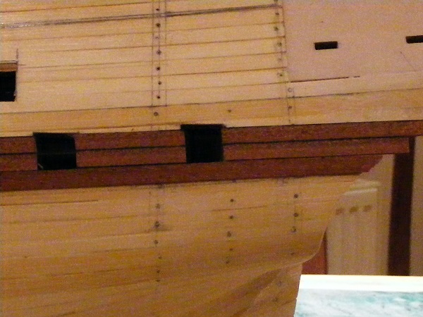

Tonight I finished moving the port on the other side of the hull, trimmed down the upper bullworks and am now ready to move forward....
Did some experimentation with the second planking, Sapele and Walnut plus treenailing.... Think I have now come to a landing on how it should look and am pretty happy with the results..... Cool Cool

Looks great. Is that done with a hole & filler, or are you putting something else in the holes? I have seen some posts that use fishing line, then others with cocktail sticks stuck in and sawn off.

Hi Dave, thanks for the supportive comment...BigGrin BigGrin What I did here was to mark where the holes will be, drilled a .5mm hole then inserted cocktail sticks.... Once dry, carefully cut using a very sharp modellers knife, I used a new blade. Blink Blink Sanded smooth with very fine sandpaper, cleaned with white spirit then finally gave a coat of matt clear varnish....Cool The pattern shown was just experimental and will be different on the actual build.... Long long process and will definately slow me down but the results hopefully will be well worth the effort on the finished build.... BigGrin BigGrin
Hope this answers your question..

Treenailing looks good Alan looks like a few of us are going to end up with a repetitive stress injuryLOL LOL LOL LOL LOL

This looks so good, I am changing my mind about painting the hull.
It may depend on how good my top planking looks - this is my first build.
I will have to eat my way through a lot of canapés to get all those sticks Laugh

Am pleased you like it David, it will slow down the progress of the build of that there is no doubt but I really like the look of it....

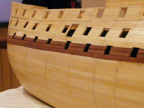

Hit a bit of a hitch tonight but think I have resolved it... will find out when I take a closer look tomorrow....Mad Mad .. It would appear I have prepared the hull by sanding, filling and applying a coat of sanding sealer to give me such a smooth finish, so smooth in fact the Sapele strips are not adhering very well, in fact hardly adhering at all....Mad Mad .. Have tried PVA, Alphatic, Really Serious glue, Sugerglue gel and nothing took a good grip.... Tried sanding an area with fine sandpaper just to see if I could give the adhesive a key to adhere to... so far so good... Cool Cool .. If tomorrow when I return to her I find it still has a good bond then it looks as if I will have to sand the whole hull to give me the key that I need....Blink Blink .. Will post how it goes... small set back but no disaster, just a pain in the *****.... BigGrin BigGrin... Anybody come across this problem before with other builds?????

lovely work alan, thats going to look great for sureBigGrin , i had a similar problem where i had painted the lower hull grey, they stuck but would come off easily so i've just scratched up the hull so the glue can get some kind of grip

I don't use Sanding Sealer unless I'm Painting, so I've never tried Gluing to it, but I guess it does what it says on the tin and removes the porosity from the Wood which is what gives the keying for the Glue. But I'm surprised the Super-Glue didn't workConfused perhaps the surface was too damp by then, it can be a bit temperamental in the presence of too much moisture. I'm sure a bit of roughening up will sort you outLOL LOL

Keying the surface should sort it Alan and try a gel or thick C/A. I also tend not to seal unless painting.

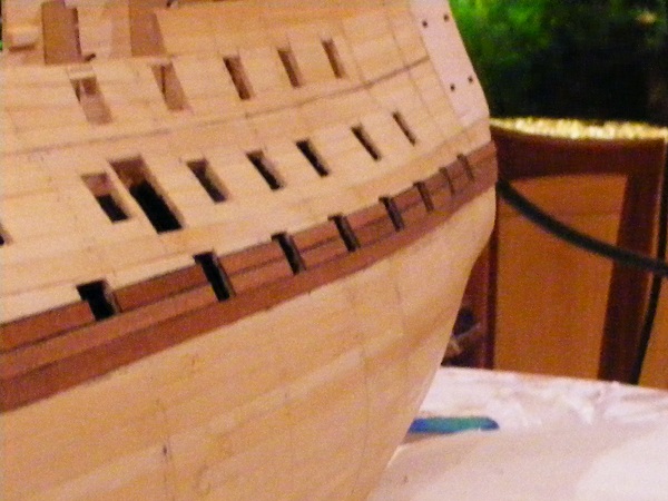

Thanks for the very nice comments Andy.... I really like the look of it and know it can be improved yet.... Itching to really see how it is going to look on the upper hull but must be patient and not rush....BigGrin BigGrin .. More experimentation done but this time with caulking between the planks... Cool Cool

Well tonight I know for sure the problem has been resolved.... Gave the area I am working on a sanding with very fine sandpaper and what a difference in the grip.... Sanding sealer may be good but have found out that gluing to it can be problematic....Cool Cool
Started in earnest with the second planking tonight and also decided I wanted to caulk between the planks too.... This was done using a permanent marker but first gave the plank edges a fine sand, this I found helped a lot to stop any bleeding.....BigGrin BigGrin BigGrin ... Obviously I still have to tidy up the ports this will be left until the weekend when I will also be adding the treenails.....BigGrin BigGrin BigGrin .. I really like how it is starting to look..... Cool Cool
