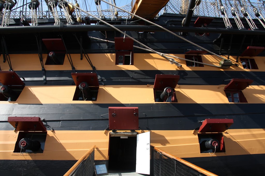

I found a pick that shows the gunports have a recess allowing the covers to fit flush in the hull as a sort of seal. Might be wrong and this is how its done now not then!!BigGrin BigGrin
That is correct Jack Sparrow, the only ones to my knowledge without the rabbit are the ones without gun port lids

Sorry guys this is the pic I looked at for the ports... Which shows none but looking better its bad lighting.... Ah well I will make a new mock up now....lol

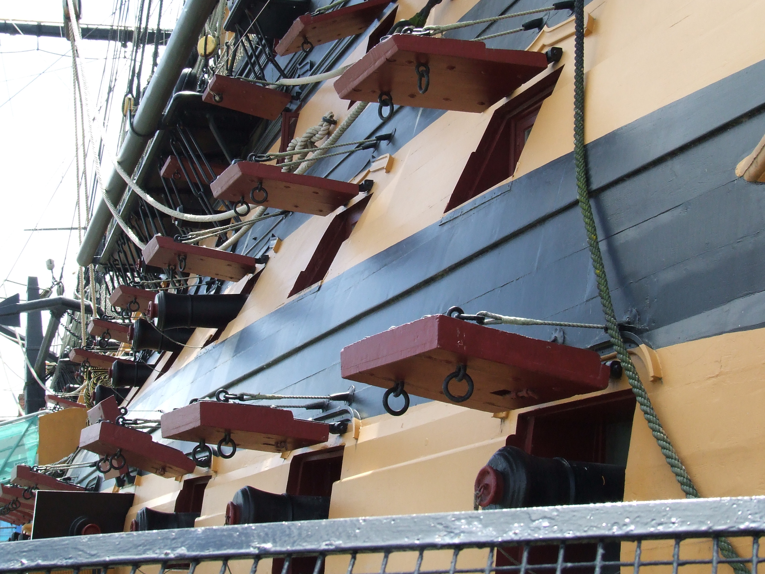

Does this pic help for the gun port rabbets or whatever there called
