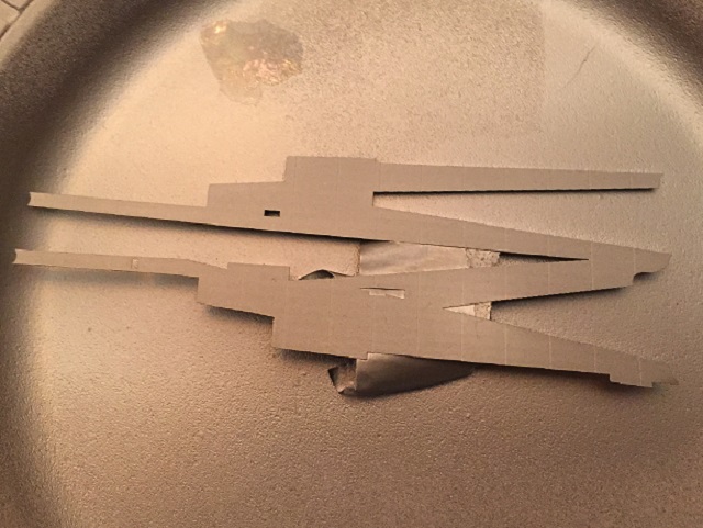

So I said I will be doing minimal weathering on the ship, but the anchor races will need some weathering.I decided to use the salt weathering technique.
Here is the technique.
Step 1 prime the part and then spray it steel colored. There is a photetch part that replaces the kits anchor races so it makes it easy to do the weathering without having to mask off the deck.
#82 Posted : 31 August 2016 17:17:49

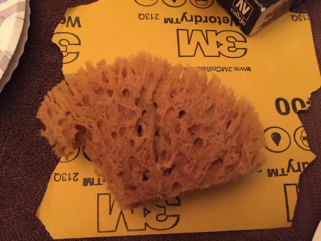

The next step is to get a sponge and cut off a small pieces of it.This will be used to apply the rust paint.I use Vallejos rust and steel weathering set.It has a couple of different colors of rust.

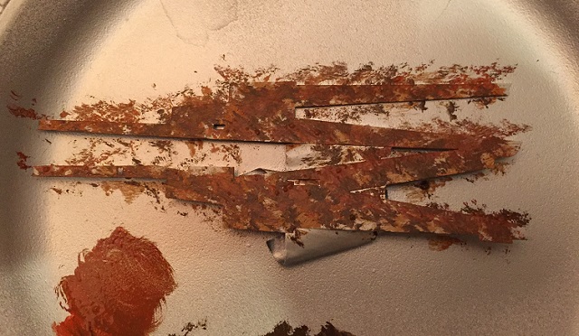

using the sponge I applied the first rust color randomly over the part.

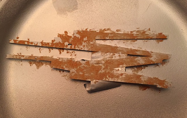

#83 Posted : 31 August 2016 17:19:58
Salt weathering Step 3
Once the first layer of rust paint has dried I repeated the process using a different rust color.Once this layer had dried I mixed the 2 colors to make a third rust color and dabbed it over the part with the sponge.

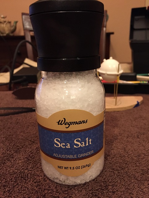

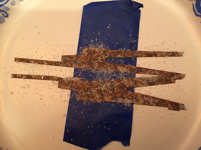

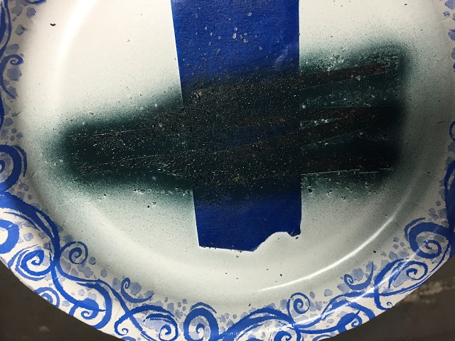

Once the paint has dried we will be applying the salt.I used rock salt.This comes with a grinder in the cap so you can make different sizes of salt granules.I made various sized pieces of salt with the grinder and then wet down the part with water and sprinkled the salt over the part.I tried to concentrate on placing the salt where I wanted the rust to show through.
Once the water had dried ( a few minutes) I sprayed the hull color over the part and once this had dried I gently scraped the salt off the part to reveal the rust.
#85 Posted : 31 August 2016 17:28:11
Salt weathering
Here is the finished part once the salt was scraped off.If gives a nice natural looking weathered effect.

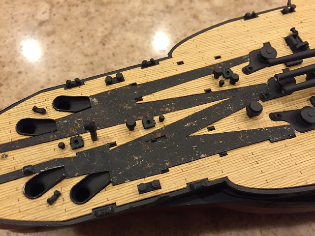

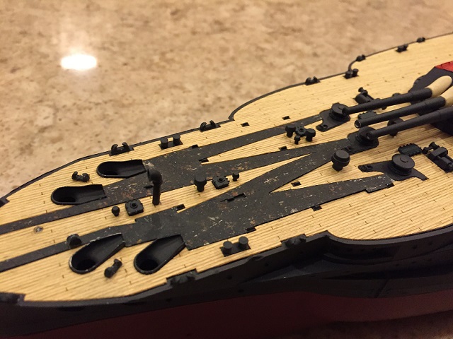

#86 Posted : 31 August 2016 17:30:13

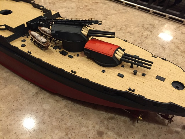

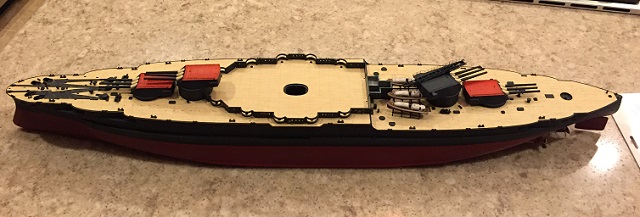

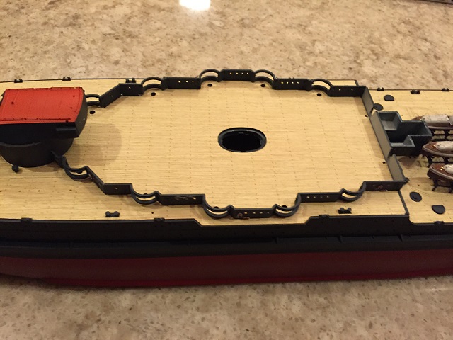

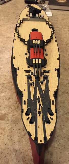

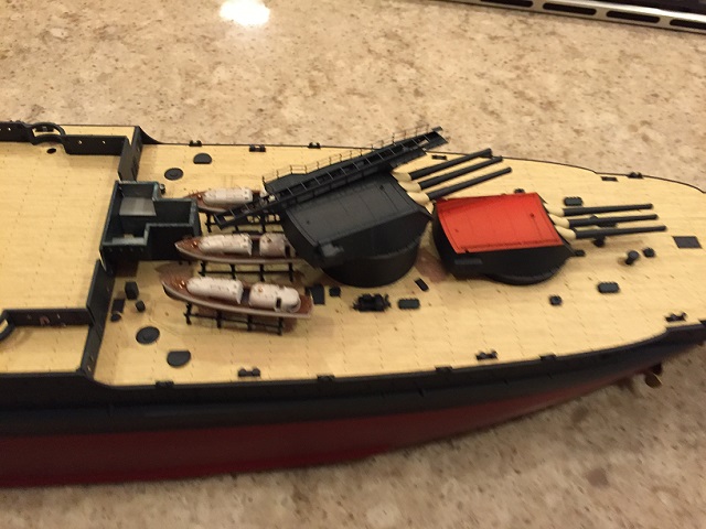

Most of the deck pieces have now been added and I test fitted the main guns and motorboats.

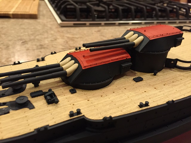

I always wondered why they would paint the tops of he turrets in bright colours, it always seemed to me like it was painting a target on them

The turrets were painted for identification purposes for the spotter planes.Each battle group had a designated color so when the spotter planes came back from a mission they knew which ship to land next to.Arizona battle group had red as their color
