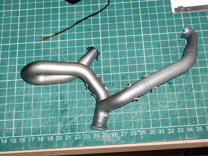

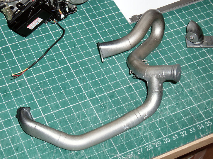

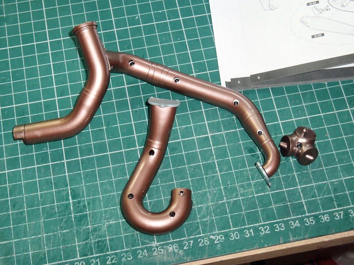

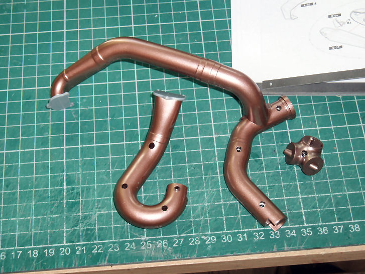

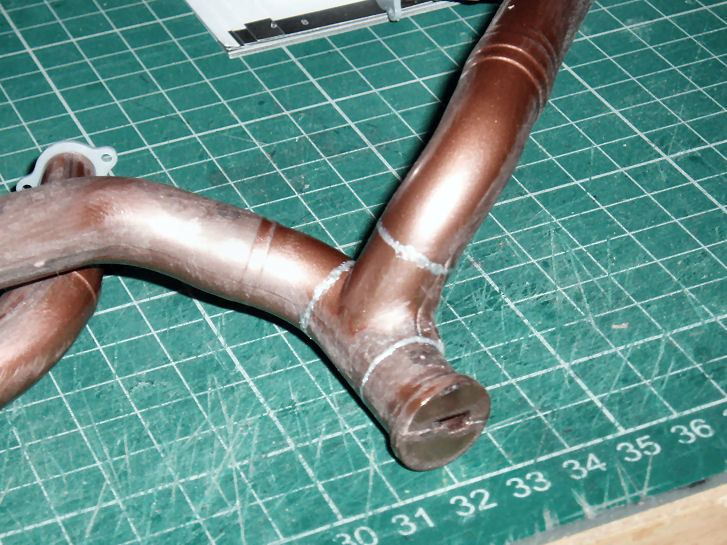

OK - exhaust section.
This is probably the poorest part of the kit.
Everything else is well engineered and very detailed.
The exhaust parts are like something from an old Airfix kit.

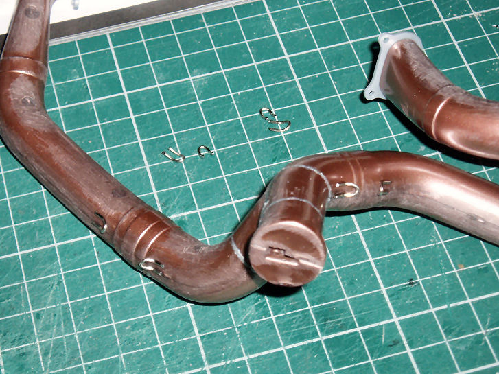

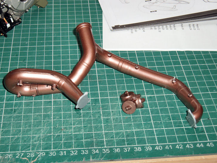

The bits meet where they touch, gaps, poor seams and horrible great big fixing screw holes.
I used cyano glue on all joins as well as the screws, and clamped the areas where the parts didn't quite meet.
Next, the screw holes were filled with bits of sprue glued in. These bits were filed down and along with all the seams and joins, filler was added where needed and then sanded back.
I wasn't worried about spoiling the paint as it's some silly bright copper colour and I haven't seen any pics of real Ducs with shiny copper exhausts so it's all being repainted anyway.

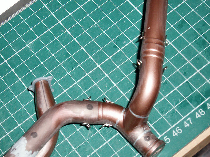

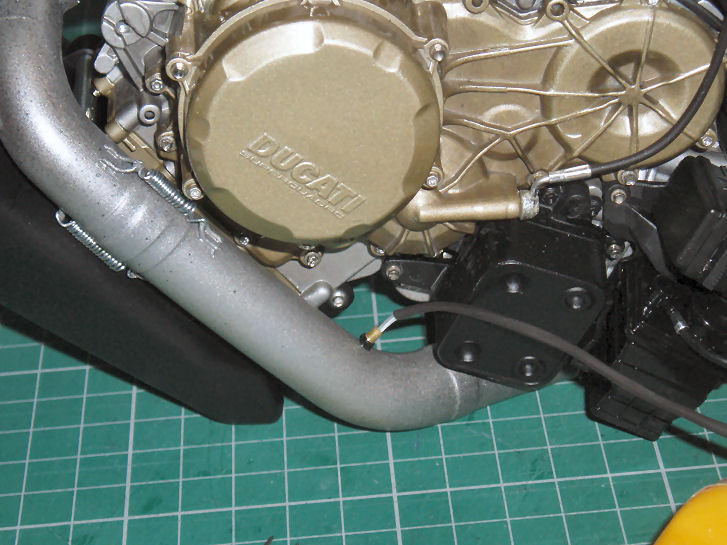

The fixing springs will be added - missing from the kit.
The tiny brackets were made from paper clip wire, glued in place and weld lines added with a stained glass window pen.
Further welds were added at the 'tee' joint and around the manifold flanges, as per real Duc's.
The whole caboodle was primed and then sprayed a mix of champagne gold, ally, and magnesium.
All the different areas of toning were done freehand just using rattle cans.
I think I'm going to put this kit to bed when the exhaust is sorted and get on with my big C Type for a while...

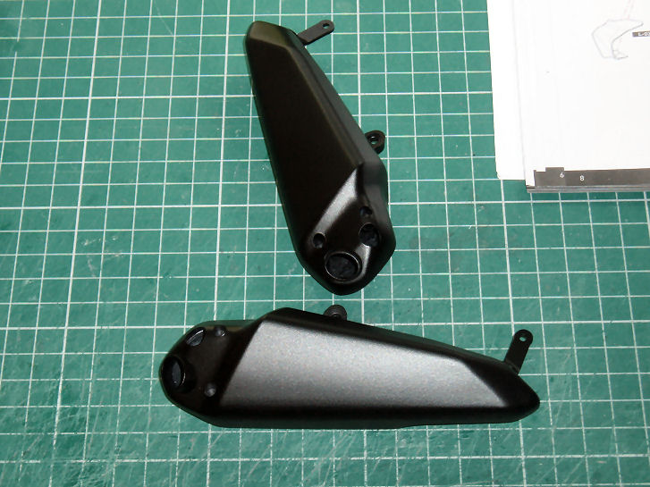

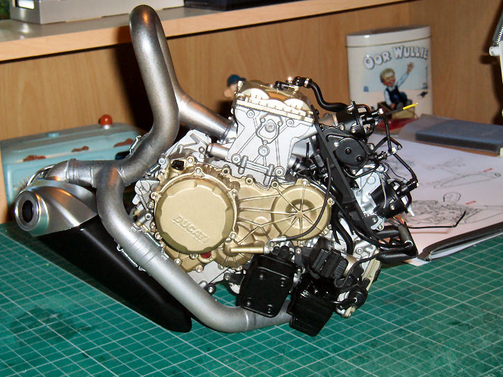

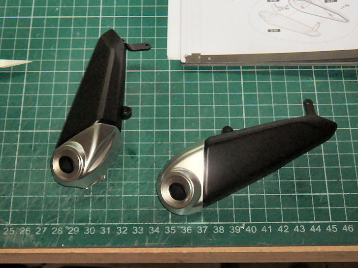

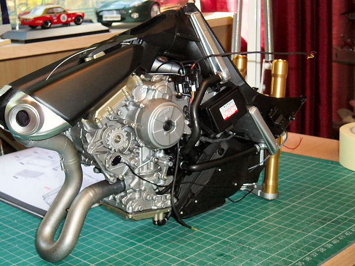

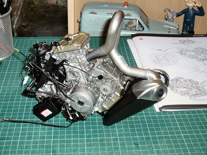

The exhaust is now sorted and fitted.
The mufflers needed join lines filling, sanding and eventually repainting.
They were fitted with little bother, as was the exhaust assembly.
All credit to Pocher engineering.
A serious problem though, is that the lump is now very precarious however you stand it up.
Padded mat will be coming out...

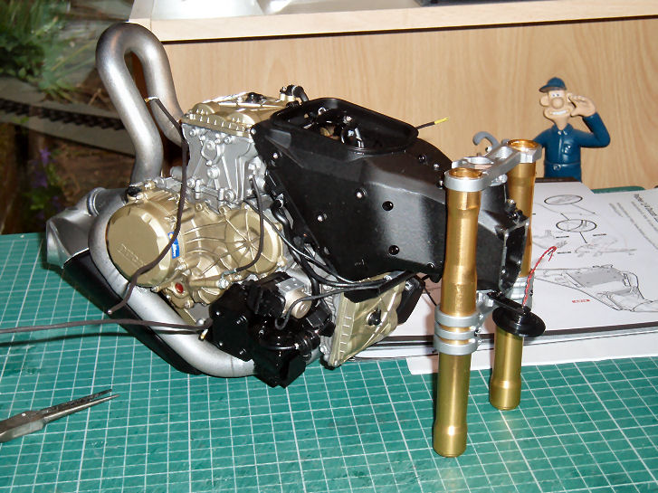

#91 Posted : 18 May 2017 13:49:10
Posts: 5,707
Points: 17,273
Well, 10 days since I touched the big Duc.

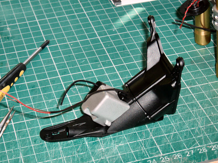

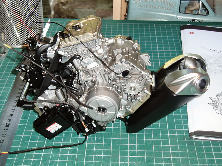

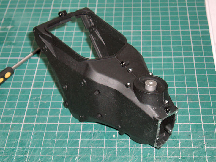

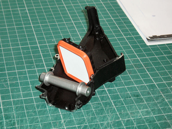

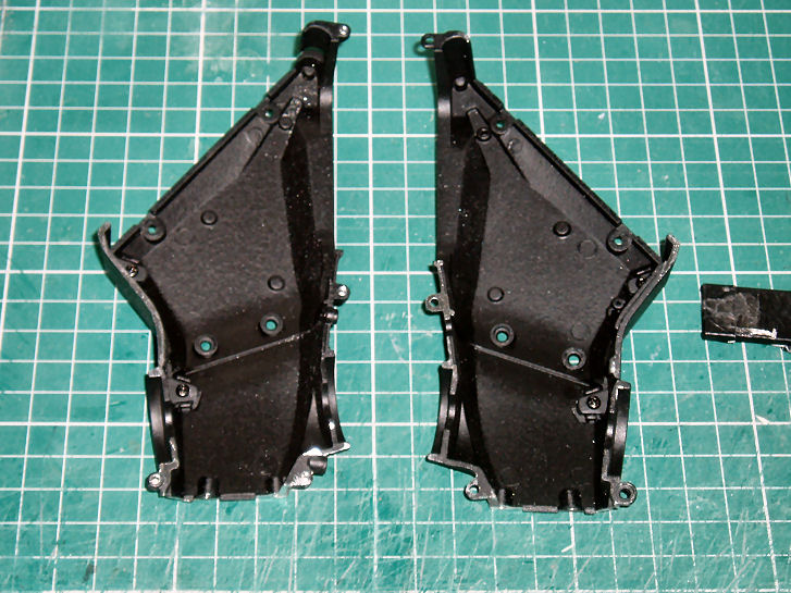

I've scratched the exhaust oxygen sensors and added them, fiddled about with the airbox, filter and front upper forks.
Everything went together as it should although the two airbox halves needed a fair bit of filing flat along the mating faces to get the parts together without any gaps.
Worth the effort.
Ive test-fitted the assembly to the engine but it isn't fixed yet.
More wiring and added gubbins first...
Roy.

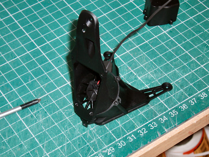

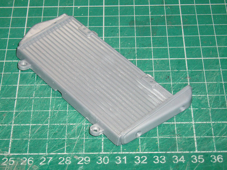

Anyway - radiators are built although I ditched the 'screw' method and glued the parts together, then filled the horrible screw holes all over the place that would have shown everywhere.
Lots of wiring has been added and the rad assembly has now been fitted.
This thing is a MONSTER.
It's also now very awkward to handle and work on. The only way it will stand is upside down.
There's a ton of extra detailing - which is fun. It's quite surprising just how much wiring, relays and pipework Pocher have left off the kit.

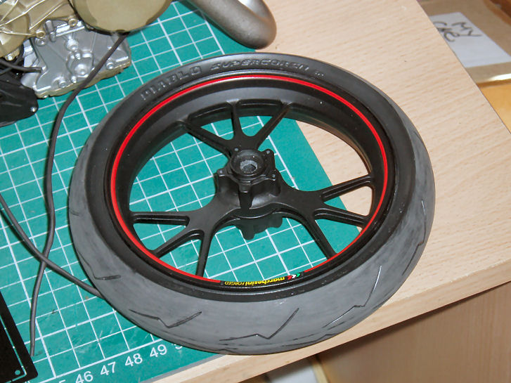

Anyway... Front wheel assembled. The tyre needed heavy sanding on the tread area but it went onto the rim quite easily despite the 'rumours' it's difficult.
The pics make the tread look quite grey, but in reality, it isn't. Camera's don't get it right all of the time.
Front forks built up and fitted to the wheel/axle.
The brake discs - don't even go there!!!
A total PITA to build.
They really are made up using rivets, washers and circlips!
However, once done, they look great.
The forks are fitted and the whole lot test fitted.
Whatever anyone else may say, you can't fault Pocher on their engineering.
EVERYTHING fits exactly as it should.
Brake calipers and loads of other stuff still to go.
If you're tempted, BUY this kit. You'll love it.
The last pic show the kit so far, with a 1/43 model next to it to give an idea of size.
Pics just don't show it but this thing is ENORMOUS!
