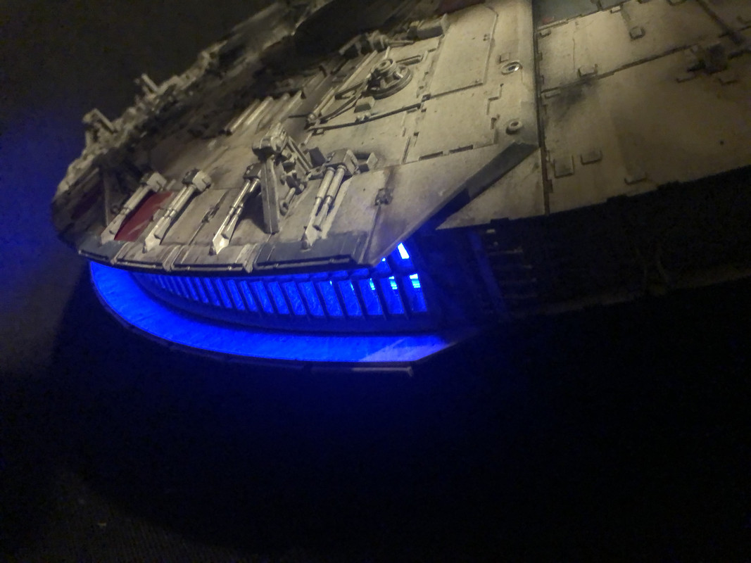

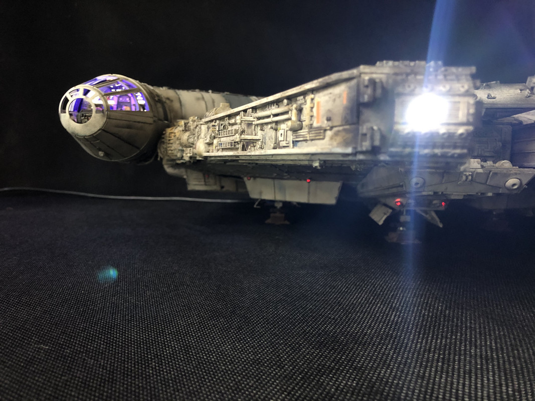

Anyhow silver-linings and all, 8 weeks sick leave has allowed me to get some much needed and overdue me time and chance to get back onto the falcon... So what have I achieved over these weeks, my last post I had completed the lower hull and its lighting so first things first lets ensure it all still works as it should  after being moved from room to room again and again.
Initial signs were good with only one undercarriage door having been knocked loose, an easy fix. I decided with the lower hull and hold/corridor lighting done I better face mounting the Arduino and my circuit board so 30 mins in Tinkercad I knocked up a mount to fit the Arduino and my board in the stock circuit board position.
So after adding some black paint to aid in light blocking the mound and board fitted sweetly ensuring none of the boards underneath solder points connected with any of the Falcon's metal skeletal frame.
With the boards mounted it was time to mount the cargo hold, corridors and engine lightings, fingers crossed none of my mods prevented fitment!  Success, probably more luck than judgement :)
Now came the moment of truth.... 18 months of being moved from one bedroom to another time to ensure the electronics still held up to previous tests..... DAMN! A pop, a puff of smoke and the unmistakable smell of a blown component, something had popped.  A bit of fault finding and I found the 12V DC buck converter board had blown maybe due to damp or static discharge, anyhow I ordered another through amazon and awaited its delivery.  A day later I mounter the new converter turned it on and BANG! What the hell.... arggghhh another blow and this time visible damage to my falcon boards 12V track so now I also need to solder a whole new board :( This time deducing the only reason the 12V line could have burnt would be due to a huge current draw from its load via the ULN2803A chips that control the current demand so this time I changed both 2803As along with the converter and my new Falcon board, I held my breath and............................... hoorah! everything worked, cause an effect I believe the fault was down to a broken 2803A which drew excess current blowing the original buck converter and subsequently by Falcon board, oh well got there in the end.

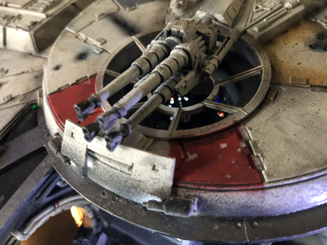

Continuing on the lower turret was added, again without pictures, it had been so long I was getting carried away :lol: but I did record a small video of the upper cannon which was one of my shapeways buys, and there really isn't much room through those support arms to feed wire through there was more than one curse word used but we got there in the end, not perfect but I'll be damned if I'm going through that again fitting two leds, wiring and fibre optics in such a small space.

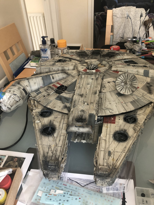

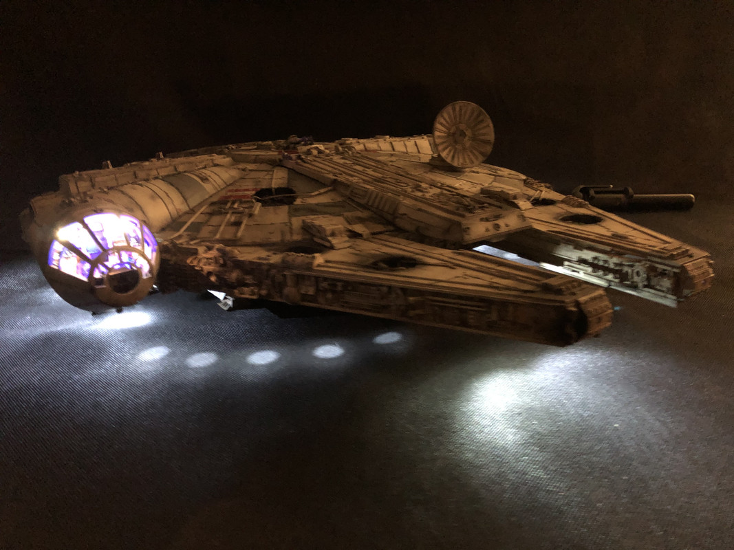

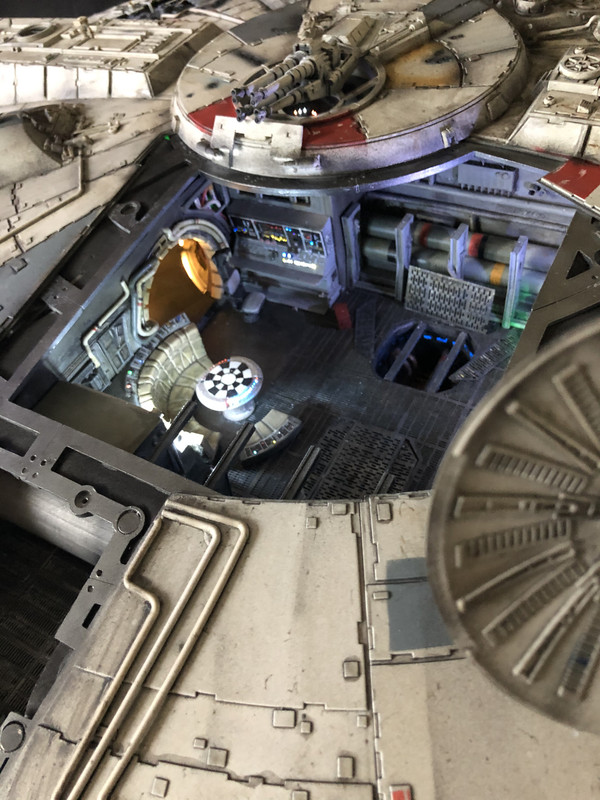

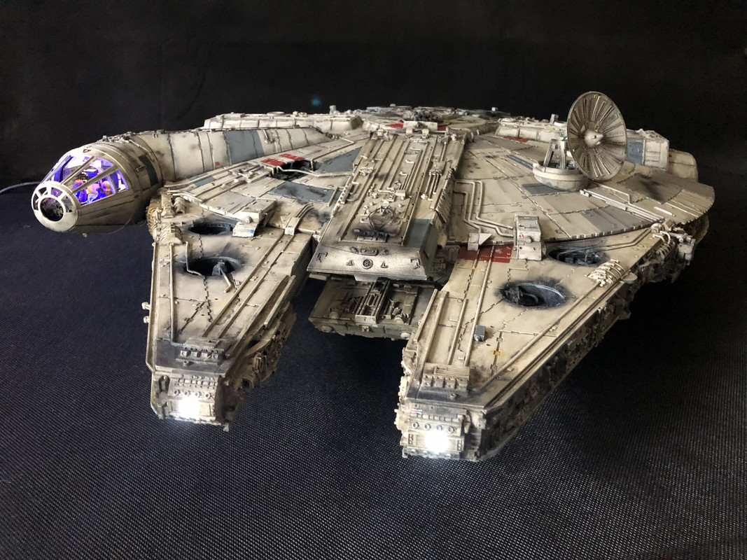

Moving swiftly on, the upper hull has all been constructed and main panel painting completed without any issues and a quick test run of the engine :)
https://www.youtube.com/watch?v=sIs68R-FAHs

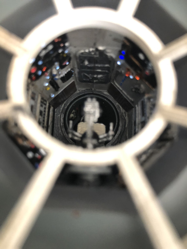

All greeblies have been added and the hull now awaits weathering, but surely there was something I forgot?!? Ahhh of course since my first post I never completed the cockpit rear wall, I didn't like the standard sticker but wasn't going to pay £££s on a shapeways cockpit so I decided to give photoetch a go, yes I'd done the hold floor and corridors but this involved folding! :D Having not done this before I was dubious I'd be able to pull it off but taking time and following the instructions I made the back wall and with a few tamiya clear colours I was pretty happy.  I had also neglected to wire up the cockpits main monitor for the flicker, but with already owning some printable waterslide papers (great for decals for Star Wars helmets (X-Wing etc) ) so I decide to add a little something to the screen.... see if you can spot it :)
https://www.youtube.com/watch?v=eqFYdbIe7Oo
Of course it doesn't fit in with the ESB replica but hey this is mine and artistic licence is allowed :)

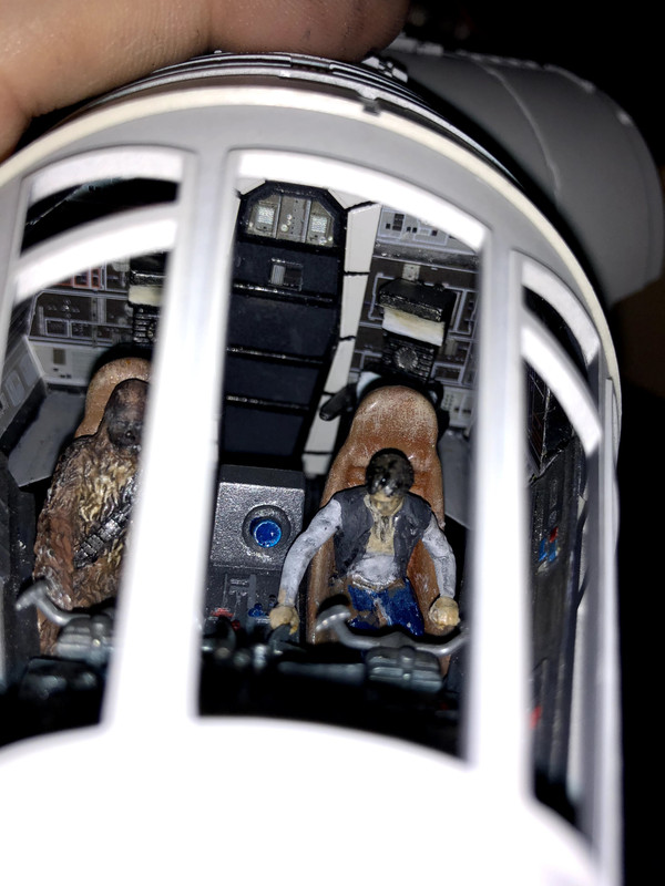

But the Falcon needs a crew if she's going to fly, now I know I'm not the best modeller and I'll make excuses of my neck injury and nerve damage but honestly figures I am terrible at but I'll give it a go...
So that's where I'm up to the upper hull all constructed awaiting weathering, a bit of a jump in one single post so apologies to anyone who actually reads this, and for those who have been messaging me about my boards please be patient with me I don't want to give any false info until I have completely soak tested all the electronics together which will consist of at least several hours constant playing :lol: plus I need to iron out a bug in the software where pressing any buttons before the guns finish firing locks up the system.
So almost there, and for the sharp eyed amongst you yes I have added some of the decals that graced the first Falcon model from A New Hope, the 5 footer.  I know this is not strictly correct with the ESB replica but as already said this is mine and I'm doing it in the spirit of the original I feel they just bring the original quirkiness of the original Falcon.  As you can see there's still quite a few I need to add, it took me an age to find a source for these so if you're considering doing the same I got these from Jim at https://www.jbot.ca/

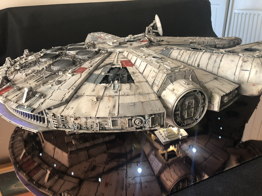

I have almost finished my falcon but was waiting to mount it in the coffee table before sharing my last pics and video, however I am increasingly struggling to find a suitable table and the quotes I’ve been getting have been ludicrous. I am shortly due to move with work, so at the moment I’m unsure if we’ll have the room in our next place which has made me start looking at alternate mounting options.
I have the falcon currently mounted on a bronzed mirror base with the power lead going through the rear starboard leg:
I am currently contemplating mounting the falcon and the mirror base at a 50 - 60 degree angle with a perspex contoured bracket taking the main weight at the port docking ring, so it will be against the metal frame at this point, 2 other contoured brackets would be fashioned for positioning at the port mandible and towards the port rear of the falcon to prevent any lateral movement. This would allow me to have the falcon in standard glass display cabinet making its footprint far smaller, has anyone already been down this route and have any tips?

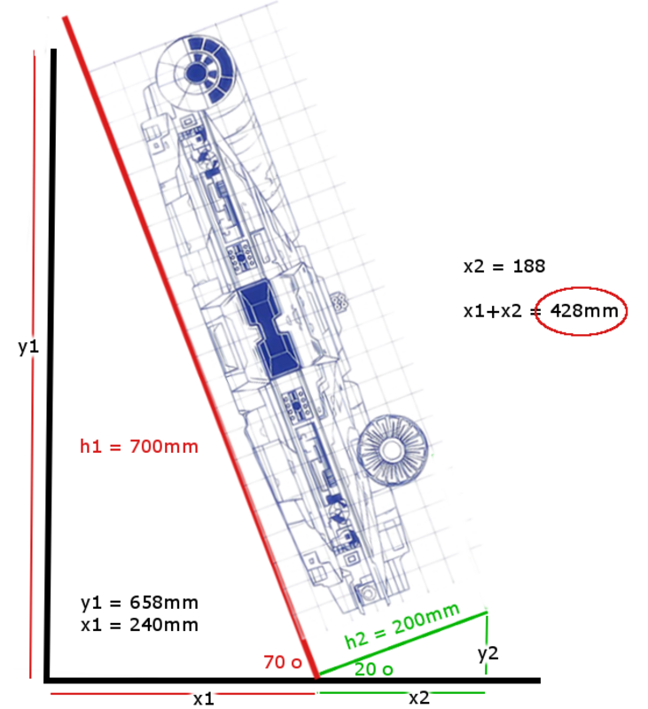

My initial guess of a 50 to 60 degrees was a tad off, a little trig later and I'm looking more about 70 degrees to fit within a deep glass display cabinet.
Still waiting on one last table quote to come in but if that's way too high I'll move ahead with this angled display, cabinet I'm looking at to display this along with some Star Wars helmets, lightsabers and blasters is coming in far cheaper than what I'm being quoted for a coffee table:
Glass Display Cabinet
Chip
#88 Posted : 05 January 2021 11:22:49
Joined: 15/03/2017
Posts: 46
Points: 138
Location: Outer reaches of the galaxy .... West Midlands
Doh! realised an error in my trig as the peak height of the falcon is 21cm in from nearest edge of its base, so that would bring the final x value to 356mm so I can indeed bring the angle down, time for a bit more maths.....
Ok so looks like original guesstimate of 55-60 degrees would be within the cabinets depth capacity.

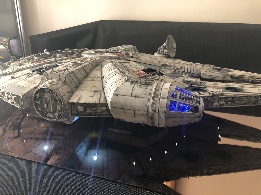

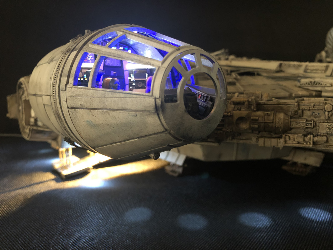

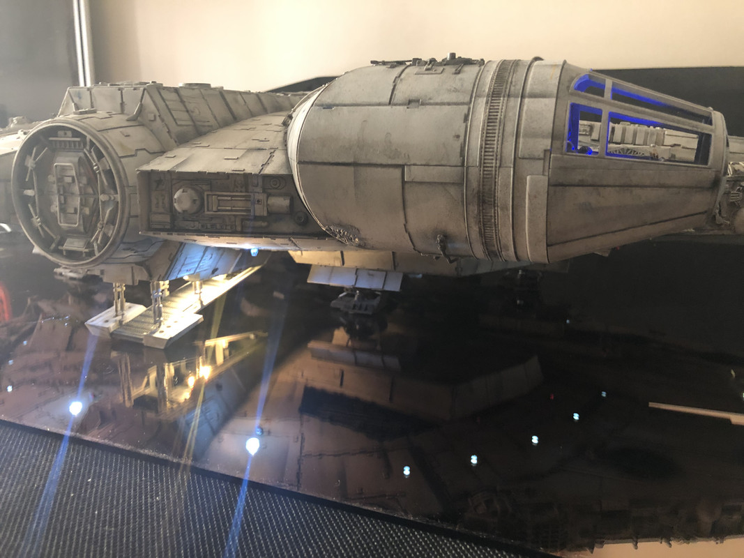

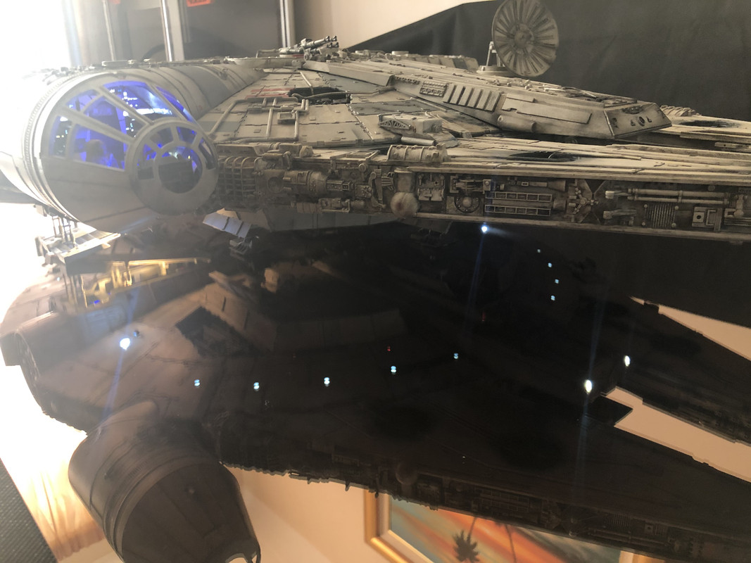

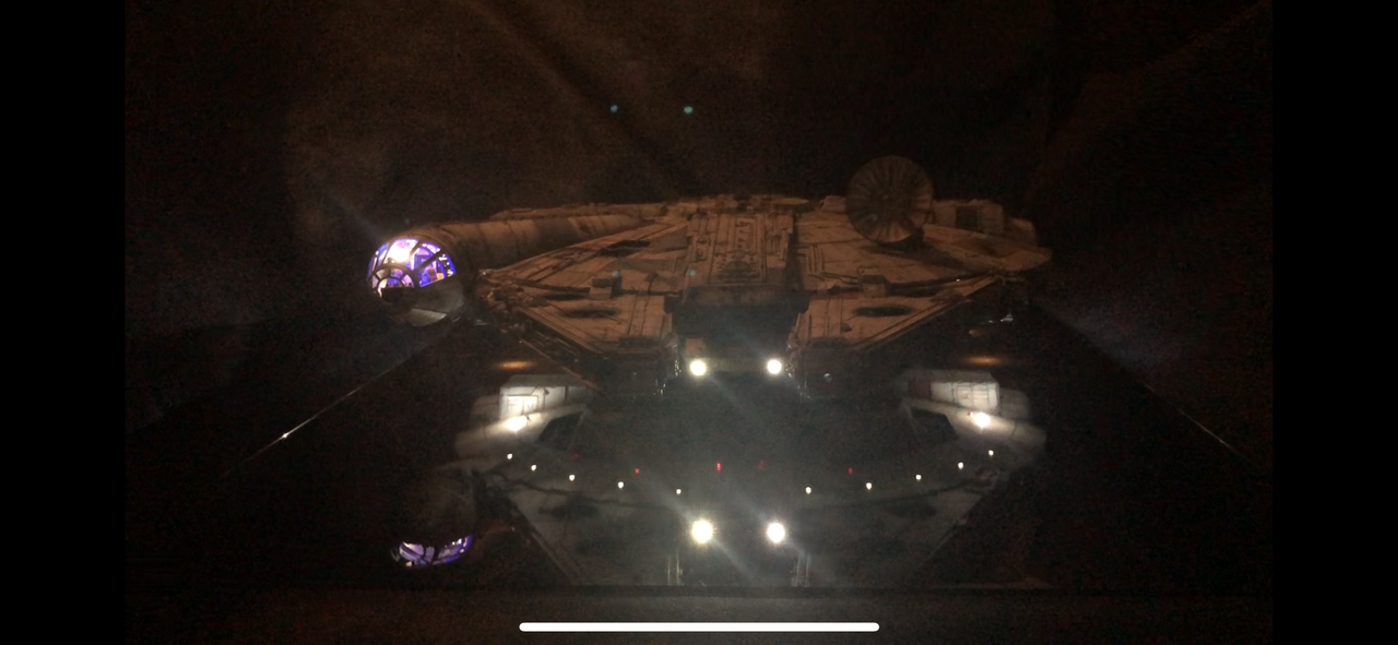

Ok to hide my mistake here’s a few pics, have taken some video showcasing the lights, sounds etc but still need to edit it together will post that in due course:
