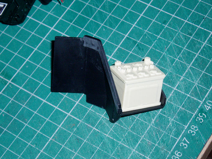

I've painted the front mud shields (after removing the large mould seams) as they are in reality part of the bodywork and should be the same colour.
I've also made my own battery and that has been fitted to the relevant panel.
There's some detailing to do on the panels before they are fitted.

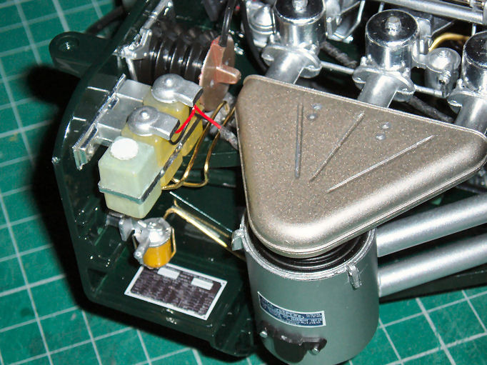

I've also now made the brake master cylinder mechanism and it's in place.
Two of the brake pipes have been added but there should be another four.
Two come from the front fittings but in fact I won't add them as they will be invisible eventually, and almost impossible to add when the engine is in place.
The other two pipes go to the fluid reservoirs so will be added when the engine/bulkhead is fixed together.
In the meantime, I've removed the fuel filter to repaint, and I'm also going to add my own fuel lines.
The kit actually has them back to front.
The line from the fuel tank should be on the left, and to the carbs, on the right.
The kit has them the other way round...

Another little bit...
Fuel filter repainted and the fuel line to the carbs is fitted.
Roy.

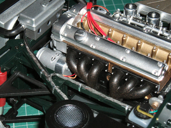

All of the wiring has been attached to the frame and joined up.
It will eventually be attached to the voltage regulator.
Also, brake and clutch pipes added to the fluid reservoirs.
Still a bit more to add.
As yet, the fuel filter and carbs aren't connected...
Roy.

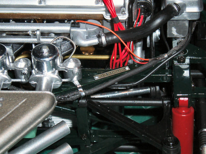

Just looking at this again and i think one of the things thatvreally makes it stand out are all the placards and markings you have used - really very good. Especially like the "made in england" one.
#88 Posted : 14 November 2017 23:13:11
Posts: 5,838
Points: 17,666
Thanks Tony.
The 'Made in England' plate really was on the cars in this position.
Mind you, now that I look, I see I've missed the little fixing rivets - now attended to.
Roy.

I think the engine area is pretty much sorted now - unless I think of something else...
Fuel filter connected, splash panels are now matt black with the body areas in green.
Voltage regulator wired up and in place, battery in and connected.
Time to put this lump to one side and see what's next...
Roy.
