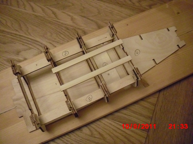

to me screwing it down to a board through the keel is more holes to plug to stop water getting in if sailing , fixing to board buy other ways screwed clamps out side of keel etc is the way i am going
#82 Posted : 10 September 2011 19:50:06
Willie,We build the Hull under this false keel this part does not go near the water,when we have built all thr ribs we unscrew it off the board, and plank a hull underneathCool

#87 Posted : 10 September 2011 22:42:20
ISSUE 2
Just thought you would like to see the Hood in its Dry Dock:-
#88 Posted : 10 September 2011 22:44:13
You will see the tops of the ribs come off cleanly as they should:-
#89 Posted : 10 September 2011 22:46:35
And finally for this session WOW SHE IS GOING TO BE BIG!!!!!!Blink

Can I just chip in that a pine build board is probably the worst material to use, pine is prone to warp amd movement.
A minimum 12mm melamine/conti or MDF board avoids this risk.
Also its not wise to store a wooden model of any description in an outdoore shed, the changes in interior atmospherices from day to day be it sun one day and rain the next, can do all sorts of nasty things to the wooden framework of as model.
#96 Posted : 11 September 2011 19:01:59
Thanks MR T, This board was the one I used for the Victory,its well cured, and I keep all my Models in the House, but as usual your advice is correct I appreciate your input.Cool
