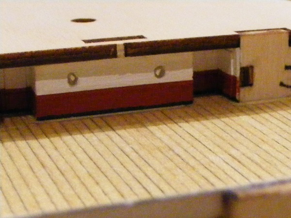

Finished planking the aft well deck and this I have to say with the size of the planks was a very time consuming process.. once again edged the deck with 2mm edging... And again, used a pencil lightly down one edge of the planks to give a little more definition....Cool Cool .. Sanded the deck with fine grade sandpaper and have given it the first coat of natural Danish oil.... Started the cladding on the bow well deck, cut the pieces to fit, gave them a coat of primer followed by a few coats of titanium white.... Also cut 4 of the etched doors off the fret and stuck them down onto masking tape before giving them a coat of metal primer......Cool Cool .. More soon.....

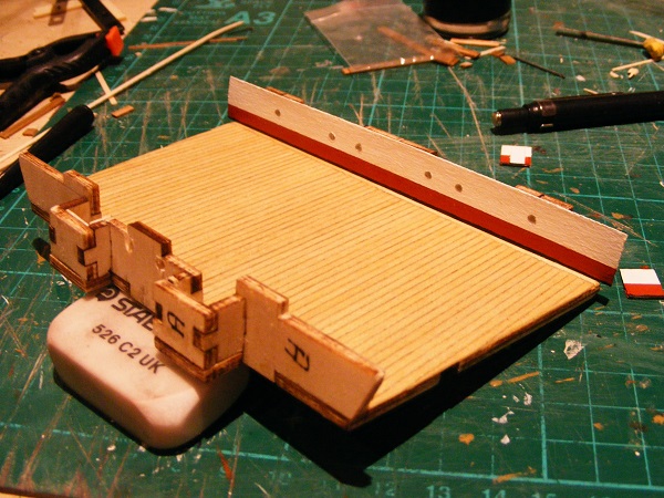

Little progress but very very slow going.... been working on the rear bulkhead of the bow well deck.... After painting was fully dried, glued the maple strip on the bulkhead and got down to measuring where the windows would be... Stuck a strip of masking tape onto the bulkhead and marked out where the window would go... drilled the windows out using a 2.1mm drill bit and cleaned out the holes...Cool Cool .. As I intend to light this kit I used Krystal Clear to give the appearance of glass.... When all done, glued the bulkhead to the aft deck ensuring all was square...Cool Cool .. Two smaller windows to drill yet at each end but can't do them until the well deck is fitted as I have to drill into the ribs... None of the detail being shown is in the instructions it is all additional modification.... Blink Blink Now working on the bow bulkhead which again is going to take some time.... Happy building all....

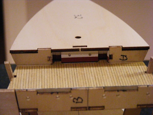

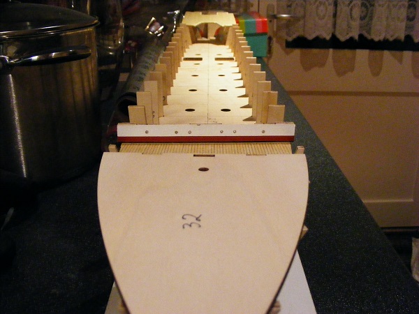

Moved forward a little and have now done as much as I can at this stage on the bow well deck... Sanded the tops of the bow ribs during the process of dry fitting the well deck and the bow deck as per the instructions. This is all dry fitted as yet and its my intention not to fit any decks fully until I have sorted out wiring runs etc.... Cool Cool .. There are still two light fitting to be added to the rear bulkhead, will be using fibre optics for this but still have to come up with a way fitting light shades rather than just leaving the end of a simple fibre optic bare.... thinking cap is on....Blink Blink .. Now going to start fitting the bulkheads on the aft well deck....
