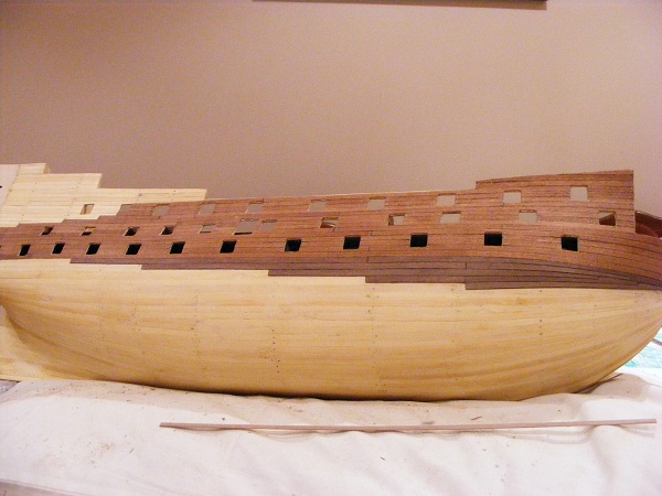

Lower hull planking continues and to be truthful I am finding it a lot trickier than I thought...Blushing Blushing . Still running with my instincts here but am sticking to a couple of golden rules namely, allowing the planks to run where they want to lie, no forcing into place and only tapering to half a plank width maximum...Cool Cool .
Getting round the bow has shown it to be a very sharp curve really forcing the plank to rise quite sharply.... more droppers required but decided to change the kind of droppers used and as long as I do the same on the other side then I will maintain a balanced appearance... Blink Blink
The stern requires a very sharp bend in the plank and so far no success, splittin on two attempts.... That is even after soaking the walnut in hot water for 20 minutes...Mad Mad Mad .. will have another attempt tomorrow....Cool
Ok, now the pics.....Huh Huh , not sure if it's right but it is working....BigGrin BigGrin

That looks fantastic!BigGrin BigGrin
Don't tell the wife but I stick the end to be curved in the kettle and boil three timesLOL LOL LOL LOL .I have managed a 10 mm radius on 2mm thick walnut using this technique!
Kind Regards Nigel

That's looking brilliant as ever, especially the stealers and according to one of my (now very old) 'how to do it' type books, the type of joints you're putting in are exactly right! Cool
Apparently that first one you did is called a 'Joggle Plank'
As for the sharp plank on the stern, if all else fails you could try the nasty alternative: Household Ammonia. The same book as above, "Planking Ships" by Richard Mansir (Moonraker Workbook Number 1) put me on to using it on the Grimsby which was single planked in double thickness hardwood planks! And it worked really well, as long as you have good ventilation. At the time I was building her in a workshop built on the end of my Dad's garage so ventilation was no problem - frost bite in winter was though! I soaked the planks half a dozen at a time in a laboratory glass thingy, essentially a huge 100ml test tube with a flat base and you could almost tie the planks in knots after a good soak.
If you have a garage or garden shed I would recommend soaking a couple of planks overnight outside and just bring them in when you are ready, leaving the ammonia itself outside. Once removed from the ammonia you'll have about 20 minutes to bend them into place and then just let them dry off in situ. I did the whole hull of Grimsby in that fashion, pinning the planks in place when wet then removing them again once dry and PVA-ing them back in place. It's nasty stuff admittedly, but equally, very effective!
Hope you can sort it out, and keep up the great planking!

She's looking Good, if your going to ammonia remember it will lighten the walnut.
Personally I see which way the strip want's to bend, mark, soak overnight in water wipe off the excess water glue and clamp, because its wet the white glue gets a very good bond. It works for my 2mm thick walnut.

That's a good point that Sandy makes, in that normal strip wood will bend much better one way in preference to the other. This is because of the way it was cut in reference to the grain, one side will start to split away, much more readily. I always test bend my strips and mark the side that will form the inside of the curve. I mention this as the Bamboo doesn't have a preferential bending direction and now we are moving to other strip woods it's important to be aware of this.

Thanks Sandy, appreciate the advice.... Tried as you suggested, soaked for a few hours and bent using steam from the kettle.... think I have the problem solved..... Cool Cool .. Thanks again..
