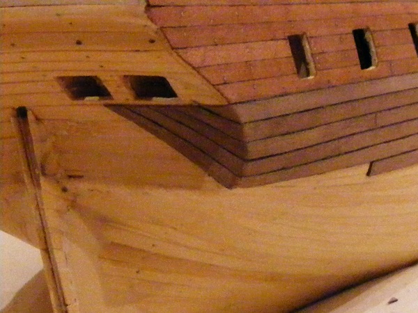

Well second planking continuing and I thought all was going well but now not so sure, especially with regards to the stern.... The bow is working out fine so don't really have any concerns there. The stern also appeared to be going well, managing to get the sharp bend in the planks and following the way the planks want to lie, but the next plank is just going to lay straight over the top of the planks in place after it has taken the bend.... Mad Mad .. May be quiet for a while until I can work out the best way to tackle this, the magazine instructions are a little vague in this area..... Confused Confused .. Hoping Mr T can give us a close up Pic of his stern area so at least I can see what we are really trying to achieve....Cool Cool
#1063 Posted : 02 June 2013 23:29:35
Now thinking perhaps to continue but cut the end of the planks along the last plank laid up the stern, giving me a herringbone effect.... May be unauthordox but would possibly solve the problem..... Would be a shame to have to remove what I've done so far.... Cool Cool .. Thinking some more....Cool Cool .. Stern is a lot more trickier than you may think...Blink Blink

Hi Alan.
I see what you mean about that stern in your photos. To be honest I think on the real ship the section below the aft gunports would be completely separate to the hull planks. The Grimsby was very similar in that area, the stern was planked first and sanded flush to the sides and then the side hull planks were cut flush to the ends of the first ones (if you can understand that!)
Getting those planks to turn that sharp a corner is a real tribute to your skills!

Thanks Robin, I see what you mean.... Am trying to follow the instructions in the mag but as I said they are a little vague as to how to achieve the turn under the hull.... The next plank really wants to rise right on top of most of the planks laid on the stern.... Huh Huh .. Thanks again....

Hi Nigel, think it's a great idea and I appreciate the effort of the diagram....BigGrin BigGrin .. Thing is, am not too sure this would work either, the next plank want to go over the top of most of the stern planks, the rise I think is too steep for your solution to work..... Cool Cool .. Thanks again, your input is invaluable.... BigGrin BigGrin .. Oh, and in addition, the planks already in situ have a slight taper from the sharp bend onwards..... Really need a close up view of Mr T's official build to see how he tackled this area....Cool Cool

Robin, just wanted to add how I achieved the sharp bend on the Walnut... First I soaked the planks in boiling water throughout the course of the day, changing the water every 30 mins or so.... When starting to fit I would apply the steam from the kettle, bend a little in situ, then back to steam and progressivly the bend would reach the point I wanted.... Key here is take time with it and be patient, bend to much and it will splinter..tease it round... Blink Blink .. Hope this helps..
#1069 Posted : 03 June 2013 09:31:47
Hi Alan, unfortunately an image of my stern won't help as the hull has been painted.
If you closely look at the step 7 image and particularly step 8 of issue 37, you'll notice that the side planking for the first 5 planks has been cut at the corner rather than bent around it. The rest of the planking runs uncut down onto the transom.
As Nigel has said, as a normal rule the planks coming round the corner need tapering to produce a fan effect. What you have at the moment is too steep an angle which will look odd once you start to lay the planking at the opposite end which is only a slight angle.

Thanks Mr T, appreciate your guidance on this one and now think I am back on track.... BigGrin BigGrin

Ok, dealing with my stern problem and a huge thanks to Mr T for pointing out a step I missed and where the instructions were a little unclear....Cool Cool .. What I didn't see until it was pointed out is that the first 5 planks are cut at the edge, they are not bent round as I had it...Blushing Blushing .. When I put the optivisors on and took a closer look at the mag it stood out a mile....Glare Glare .. Here is where we were....
#1072 Posted : 03 June 2013 22:50:07
First thing I did was to cut of the planks that bent round the stern.... all that hard work and effort for nothing but hey, another lesson learnt... Cool Cool .. The 5 offending planks round the stern area were removed and the area cleaned up with fine sandpaper..BigGrin BigGrin ..
Then laid the 6th plank, wet of course and bent it round the transom, ensuring I let the plank lay where it wanted to go.... Pinned in place until dry... Then glued in place using alphatic....Cool Cool
Think now it is looking a lot better and have the planks coming down the transom at a much better angle....BigGrin BigGrin
Correct me if any of my terminology is wrong....Blink Blink
#1073 Posted : 03 June 2013 22:57:05
Next I cut planks to start filling the gap, in order for it to look authentic I decided I wanted to fill in with 5 planks to match the planks along the side.. Glued everything in place and when dry used a very fine sanding block to round off the joined edges, giving the appearance the planks are actuall bending round the transom rather than having been cut.... BigGrin BigGrin .. Think the pics give a clearer idea of what was done....BigGrin BigGrin
Planks from here on will all have slight tapers to ensure a shallower angle as we get closer to the keel..... BigGrin BigGrin .. Think it has turned out very well and feel I am now back on track....Cool Cool Still have to trim up the plank ends but will do that when I have more added...

Very,very impressive work AlanBigGrin .This looks infinitely better than the other options available.It is a worthwhile check just to wet the sanded corner just to make sure the wood is not too thin that it has become translucent.Sometimes varnish can show this up.I would use white spirit but as you used marker for your caulking I would stick to a little water on a
