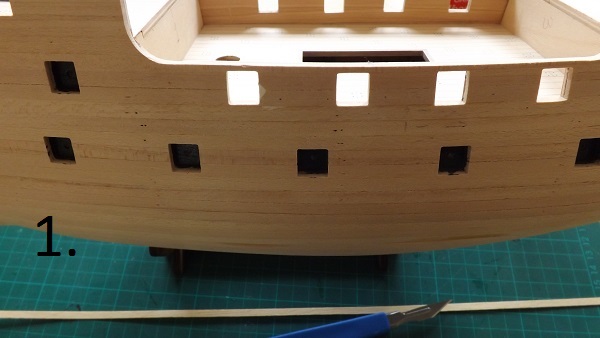

1. The first task for today (and looking at the kit instructions) is to complete
the black paint lining of the gun ports. For this I have used one of the
excellent Admiralty paints from my Victory paint set.

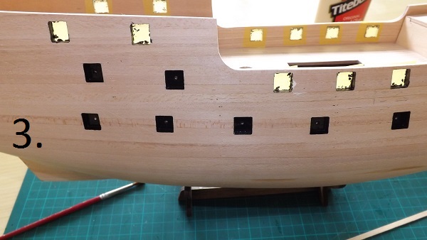

2. To try and reduce the amount of overpainting on the main deck gun ports I backed
each with a small tab of Tamiya masking tape. Bit of a waste of a decent product
but my cheap and cheerful masking tape seems to have gone missing.

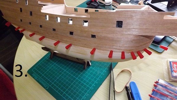

3. This picture shows the fully painted gun ports with the Tamiya tape still in
place.

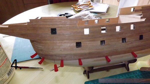

4. And this picture with the tape removed. Overall it all looks fairly neat but
will need some touching in after the second planking layer gets completed.

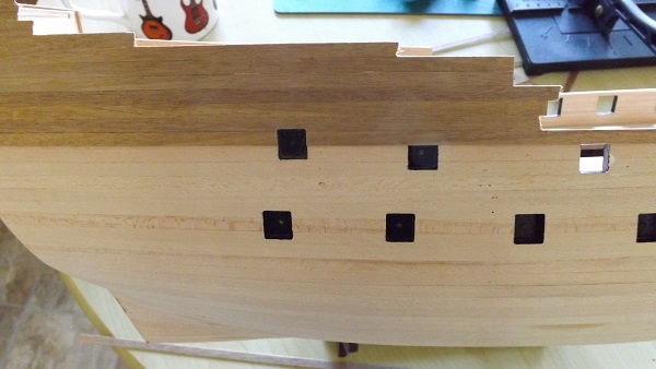

5. At the Bow end I needed to add in just one additional piece of strip wood to
even up this part of the build ready for the second planking to be applied.

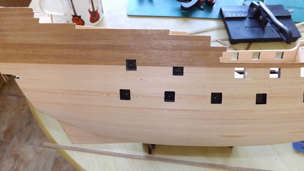

6. And here we go with the start of the second planking layer. The kit supplies
sapele strips for this and they are perfectly acceptable but for me I am not
keen on the colour. A personal choice but I find it too "red" looking and prefer
to use Walnut strip. To be honest the sapele strip would be easier to use as
its less prone to splintering were as the Walnut strip is very brittle.

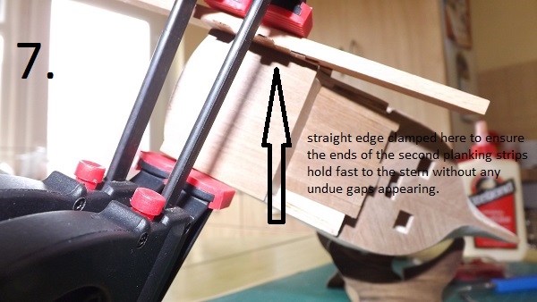

7. To ensure that the second planking strips hold fast against the very edge of the
stern have clamped a piece of scrap wood across the tops of the edge to ensure
they are glued down nice and tight.

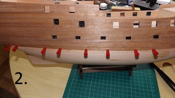

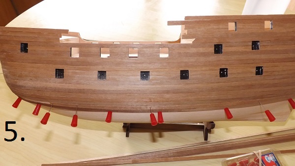

The process has been slow because of my lack of skills in this area (a case of sitting, thinking and trying to plan ahead each piece). I have then had to soak a plank, pin it in position, let it dry (as they shrink back somewhat when dried out), removing the pins, gluing the plank and then re-fitting.
That said I have now completed around 2 thirds of the hull so feel quite pleased about that.
Here are some of the latest pictures:
Pictures 1 through 5 - just some general views of the planking in process
Picture 6. They do tell you to try and avoid putting pin holes into the second planking layer. While these "grip pins" I am using have allowed that in many cases there have been a couple of times the plank has tried to curl so I have had to resort to pinning into it to keep it flat.
One thing I have found is that if you put just a dot of water over the pin hole it will swell the wood fibres back and makes the pinhole just about invisible.

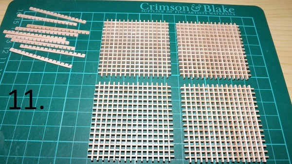

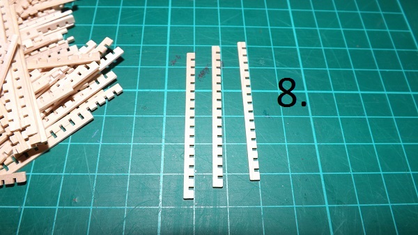

Pictures 7 through 11. To break the monotony of the planking I had a quick look to see what else I could have a "play" with without doing anything major that might cause me issues later in the build.
The only thing safe to play with at this stage is the grating strip supplied in the kit.
While there are some issues with some of the kit supplied parts in terms of quality and fit I do have to admit that the grating strips are some of the best I have ever seen. They are very smooth and evenly cut and not a single strip in my set had any damage you sometimes see with the "teeth" having broken for instance.
While I have not glued these together as yet (they will be dunked into a water/glue bath to lock the strips in place) I must say the fit is excellent and they are held together nice and tight.
From the kit supplied parts I have managed to make 4 x 5.5 cm square gratings which at a later date will be cut down to the sizes required in the model. I was left with 9 strips spare so well impressed with this part of the model.
