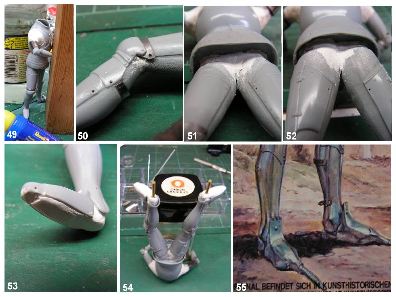

In Photo 49 Frederick is finally standing on his own two feet! As you can see here, he is wedged in between a block of wood and my jam jar of water. This was the only way to keep him upright – as although the pegs at the top of the leg assemblies were a good tight fit whilst dry, as soon as I had applied the Contacta liquid poly adhesive the joints became very slack as the glue melted the plastic, meaning a) he kept falling over, and b) the legs kept falling off!Blink
My initial intention here was to glue those pegs in place with his feet in the correct orientation and then, once the glue was set, to ‘fine tune’ the leg position using the built in pivots at the top of the thighs. Fortunately I made sure the legs were roughly correct as well because there was a slight ‘boo boo’ with this stage. The following day when I released Frederick from his prison, I discovered that the peg on the right ‘bent’ leg had dribble the glue down inside the open pivot and consequently, the right leg was firmly glued tight! As I said, the positioning of the legs was pretty much ok anyway and I was able to still move the left leg to get the best stance before putting some liquid poly down inside the joint to fix it securely. The next day I could start to fill in some of the gaps, as shown on the right knee in Photo 50, and also to blend the tops of the legs into the bottom of the torso as seen in Photos 51 and 52. These shots show the initial applications, I did a little more smoothing in later! In theory I could have got away without doing the leg blending, the actual joints in the basic kit construction are hidden up under the bottom plates of the armour – but once this is finished, someone is bound to want to look up in under!Blink As well as the top of the legs, this was also the time to sort out the other end, namely those feet. As shown previously, the armoured tops of the Sabaton simply slot into grooves in the inner sections. Having now determined the final positions of the legs and feet it was now necessary to add Milliput to those areas as well to build up the leather (and later mail covered) boots over which the steel portions were fitted. This can be seen in Photo 53 and also in the very undignified Photo 54. As you can see here, the leather boot only extends just short of the toe section, I doubt if Frederick would have enjoyed having that iron bolt and wingnut through his foot! Once the feet had been modelled in and allowed to set fully, I was then able to drill a pilot hole up through the heel and into the now glued pivot joint above it and then to epoxy glue a couple of thick brass rods up inside to act as fixing rods to the eventual wooden base and groundwork. Strangely, although both feet were made from the same batch of Milliput, one was set hard whilst the other was decidedly still soft!Confused Finally for this instalment, (the rest of my photos are for the next stage which isn’t really about re-modelling the legs!) The final Photo 55 is a close up of the box top art – if you look really closely at the feet you can see those wingnuts and also, on the heel of the left foot (his left) what I think is a hint of the mail which covers the heel on the real armour.

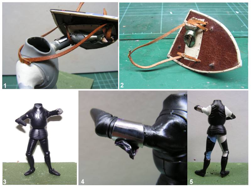

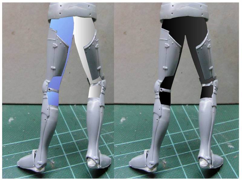

The first photo which is un-numbered shows my little ‘artist’s impression’ of the two possible colour schemes for Frederick’s legs. I’ve watched a couple of Youtube videos of a ‘knight’ being made ready for battle (and very interesting they are too!) Mostly they are wearing a plain black pair of tight fitting trousers or pantaloons I think they might be called as shown in the right hand picture (these were made using the Corel PrintHouse program and the hand drawing tool superimposed over the original photo). It was also fairly common however for knights and soldiers during this period to wear pantaloons of different colours to match in with the main colours of their coats of arms or banners. In the case of Frederick’s arms, they were quartered designs with a pair of golden lions on a black background opposite a design of blue and white diamonds. So, just to add a little more colour to what is mainly a metallic silver model, I chose the design on the left with one leg light blue and the other plain white. Hopefully by the time the legs are covered in mail, you’ll still be able to see some of that colour underneath!Blink
At the same time I had to decide on the base colour for the arms and shoulders. This was also a choice as the ‘Arming Jacket’, a padded garment worn beneath the mail and plate could be almost any colour from white through to black. For this one I decided on the most common form of the Arming Jacket which was composed of unbleached linen which is an almost white with a touch of light ochre in it.
Before the painting can commence however, there was one task which needed to be completed – the shoulder strap on Frederick’s shield. The last time this was seen it was still in two halves, secured to each side of the shield. As you can see in Photo 1, it is now finally joined together through a brass buckle with a tiny brass tip to the loose end. This is where Mum’s tight leather shoes remedy came in handy – I sprayed a little of the aerosol leather softener I got for her shoes into a little container (actually it was the top of one of the tuna tins!) and using an old small paintbrush, I painted the now complete shield strap with the clear liquid. This immediately softened the leather, allowing it to droop nicely and to take up the shape of the armour around the neck and shoulders as seen in this pic. As you can see in Photo 2, once the softener has dried out, the leather remains in the position it was in when wet, preserving the curves for when the arm is finally fitted to the silver leafed and blue-grey washed armoured finish.
With that done I could finally begin the painting (although I’ll need to do some leather manipulating later with his sword belt!) Photo 3 shows the ‘eadless Frederick after a first coat of matt black Poundshop car spray. Before this of course I had painted over his glued on upper arm plate and the new metal greave tops with Humbrol Maskol. This is shown being peeled off again in Photo 4, now for a ‘Matt Black’ aerosol paint, this has a decided sheen to it!BigGrin
After a good 24 hours to dry, I began the colour painting by giving both legs and the shoulders/arms two coats of Revell Aqua Colour Matt White, painting up to the armour with a very fine brush and then ‘slopping it on’ with a bigger softer one, as with most makes of acrylic light colours, covering power is not its best attribute! After another day’s drying, Frederick’s right leg received a final third coat of white whilst his left leg received two coats of Vallejo Model Colour 70.943 Grey Blue (as used in the Messines diorama for the Germans trousers) that Vallejo lasts for ages! The shoulders and arms then had an off-white mixture composed of the Revell white with a touch of Admiralty Yellow Ochre. When all was dry I gave a little shadowing to the legs behind the knees with a well thinned down Citadel Dark Blue ink and a little highlighting with a grey-blue and white mix, dry brushed on. The off white shoulders also had a pure white dry brushing although most of that will disappear under the steel armour! Also note in the final photo, one Maskol-ed greave top has been peeled off, the other is still under the black spray!

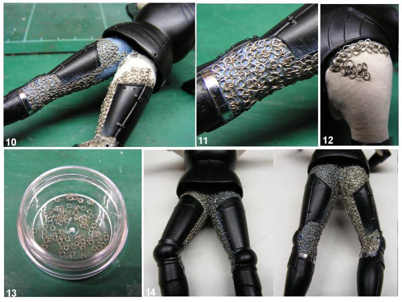

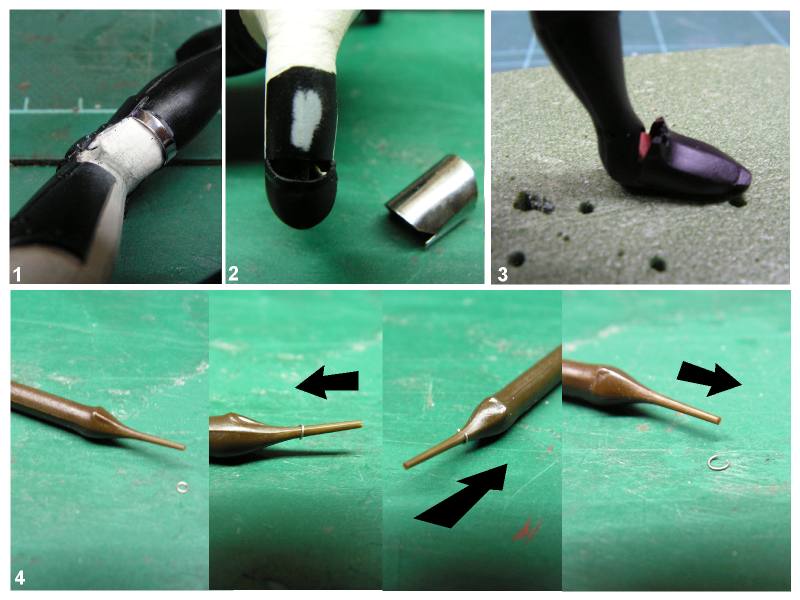

Before starting the epic saga of applying Frederick’s ring mail to the model, there were a couple of loose ends to finish off. Photo 1 shows the ‘white leg’ with the Humbrol Maskol removed from the polished tin greave tops. These will be left in the polished metal effect and later varnished over with the overall Humbrol Blue-Grey Enamel Wash which will be applied to both the metal new parts and the silver leafed plastic original sections. This shot also shows some of the shadowing applied with the Citadel Ink washes behind the knee (not that you can see much of this once the mail is in place!) Photo 2 illustrates Frederick’s upper arm, showing the black spray paint sanded off from the section where his new metal plate will fit, the one seen on the floor below. You can also see the off-white colour of his arming jacket, which was painted on over the matt black primer coat. Finally in Photo 3, we have a glimpse of the Vallejo Red Leather ‘boot’ visible under one of his Sabatons. This is only apparent on one of the feet as the other is positioned ‘closed up’, hiding the interior. Both do have the heels and soles painted in the red leather too however.
With this completed, the nightmare begins!
First of all, meet yet another innovative new tool – Mr Spready! This was so easy to produce – its actually the waste part from a piece of stretched sprue which, I think was probably from the wicker work fencing made up in the Messines diorama. I was using cocktail sticks for this process but after a few goes they were wearing down so this little chap does a much more uniform job of splitting open the previously closed up wire rings to create the ‘joiner’ ring. Maybe I should have called this my Sauron tool (“One ring to bind them all etc etc”!) The composite Photo 4 illustrates the process, simply slip the closed ring over the tip, push it down the widening shaft until the ring is forced to open up and then slip it off as in the final shot. It does also require a quick press with the bottom of the aluminium knife handle to flatten it down at the end.

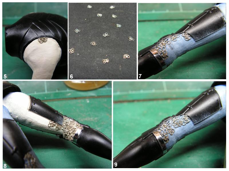

At this point I have to make a confession – although I stated earlier that I had decided on making the ring sections in groups of 3 in 1 (three soldered rings attached to a forth joiner) as the ring production progressed I got better at it!Blushing In the end I went back to the groups of five rings as you can see in Photo 6. The intention was to begin with the legs, but as I mentioned earlier again, the way these sections of mail are applied, sticking (excuse the pun!) to just the legs was not possible and so at the same time, I’m also adding some sections to the shoulders and arms whenever the situation demands. The first of the shoulder sections is shown in Photo 5, as you can see here, this is the 5 group type. Now what should happen is the soldered and flattened groups as seen in Photo 6 again should remain pressed together in a solid bunch so that I can gently pick them up on the tip of the tiny varnish holding paintbrush and apply them straight on to the varnish painted area on the model. Note I say should! What actually happens is that about 50% of them behave themselves and do that, the other half either fold up into a nasty little pile of joined rings as I pick them up, or else allow themselves to be moved to Frederick and then become a varnish covered ball of rings! Either way, it just means they have to be re-arranged back into the ‘butterfly’ shape and re-flattened (not as easily as the first time with all that sticky varnish on them!) It’s frustrating and time consuming but I haven’t had to waste any ‘fivers’ yet – although one did go AWOL off the worktop after I’d re-worked the darned thing for the third time and out of pure spite I refused to go looking for it!Flapper
Photos 7 to 10 illustrates the long, time consuming procedure under way. For example, the difference between Photos 9 and 10 represents about ten hours of work! The ring groups have to be applied as far away from each other as possible, getting anywhere near a set previously applied before the varnish has dried completely is fatal as I discovered on the other knight used as a test bed for the procedure, an accidental touch with the paintbrush (now covered in rapidly ‘sticky-fying’ varnish is almost guaranteed to pull the first group off again.Cursing The technique therefore was to do a group here, do the next at the opposite end of the leg, do the next on the other leg, turn Frederick over (avoiding all the groups like the plague – didn’t always work though!) and then apply to the other side of the legs, finally sticking a few isolated groups up on the shoulders when all the leg positions were occupied (see Photo 12). Photo 11 shows the back of the knee area in more close up illustrating how the eventually joining up groups give the impression of a complete set of mail. I eventually found that the secret to speeding up the process was mass production. Instead of making up a few sets of rings at a time, it was better to put up with the boredom (and the eye strain) and mass produce as many soldered rings as I could. Then I could carry on and make up the fiver groups by the dozen. The pot of ready rings in Photo 13 was the result of one such forced work session, in actual fact I then went on to treble the amount seen here for a final assault on the leg sections which were finally completed today.BigGrin Cool As I’ve been working through this stage I’ve been having strange ‘fluttering’ sensations in my eyes, not painful at all but just annoying. I had a fairly good idea what it was and what was causing it and fortunately I took Mum into the Royal Eye Infirmary for her annual check up on Friday and was able to get a crafty ‘consultation’ from the Optician! As I thought the fluttering sensation was tired eye muscles – nothing at all to worry about, the Optician told me. In a few days I’ll be past the mail completely – my eyes can rest then!Blink
Finally, in Photo 14 we have the completed leg section (the flags are out!) I now just have the rest of the shoulders and arms to finish, but with the legs done I can also begin to add the metal plates at the bottom of the skirt and start the process of silver leafing the leg armour at last.
