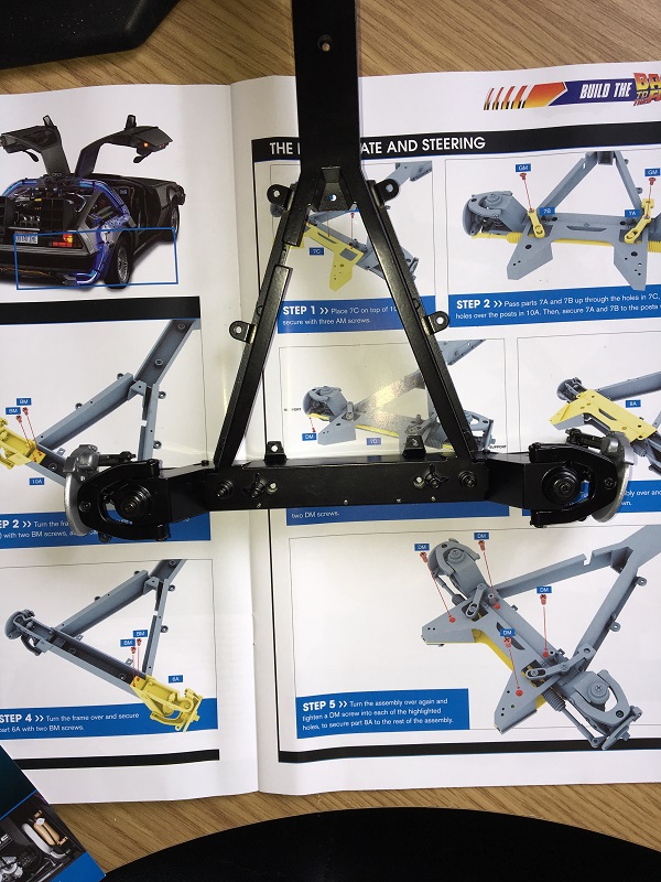

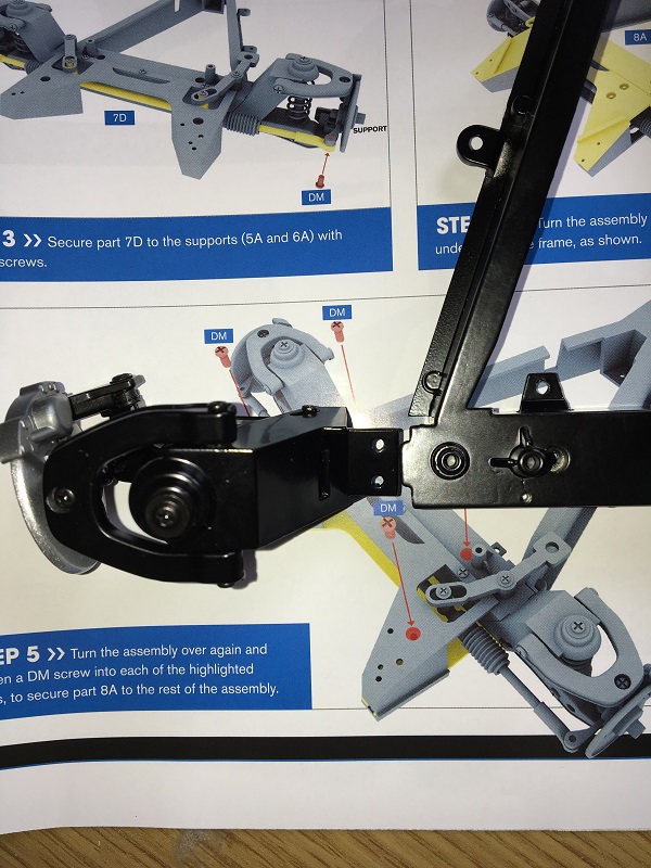

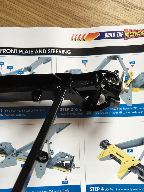

Issue 10
Parts -
Frame
4x AP Screws
4x GM Screws
6x DM Screws
4x BM Screws
3x AM Screws
Screwdriver
spike attached the following image(s):
Building - Suzuki GSX 1300R, Hummer, Ford Mustang, R2D2 Droid, Delorean.
Finished Builds - Nissan GTR, Millennium Falcon.
Other model kit builds - Tamiya RC Trucks, Tamiya RC cars
Thanks for looking.
Duane
spike
#117 Posted : 08 March 2017 18:03:32
Joined: 04/07/2016
Posts: 297
Points: 897
Fit the assembled wheel hub and suspension (Left) into the underside of the front of the frame aligning the screw holes on both parts. Turn the frame over and add 2 BM screws. Do the same for the right assembled wheel hub and suspension.

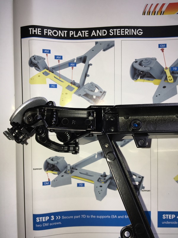

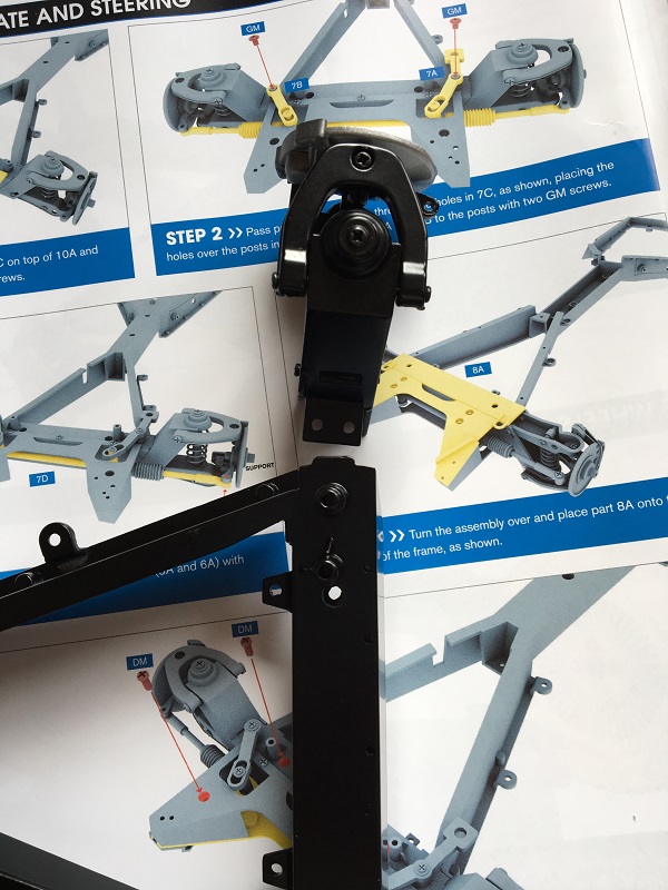

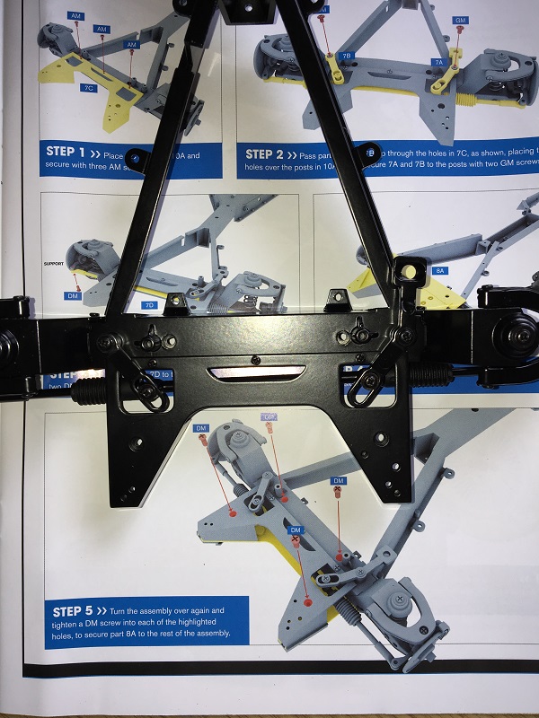

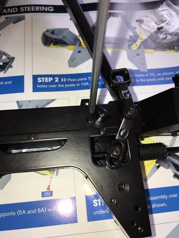

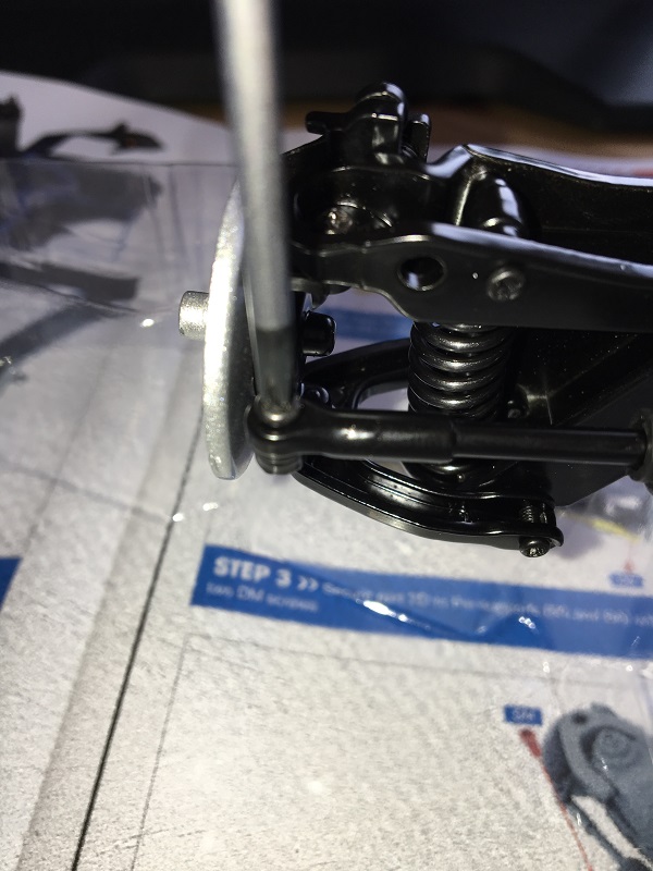

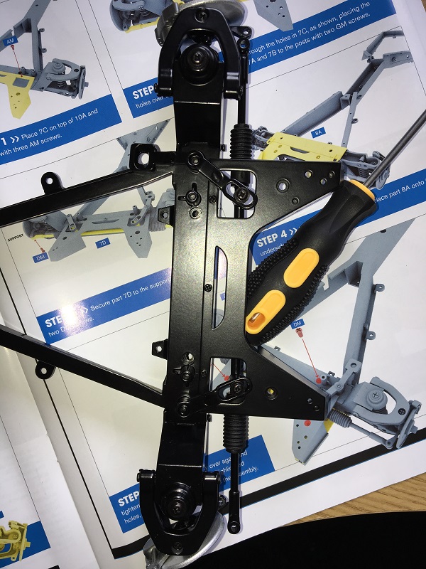

Place the top front plate on top of the frame and secure with 3 AM screws. Pass the Pinion and pull rod up through the holes in the top plate, them place the holes on the pinion and pull rod onto the posts on the top plate. Then add 2 GM Screws. Secure the wheel hubs to the steering rack with 2 DM screws. Check that the steering rack and wheel hubs move freely, if you have any problems try flipping the pull rod the other way. Turn the frame over and add the bottom plate. Turn the frame back over and add 4 DM screws.

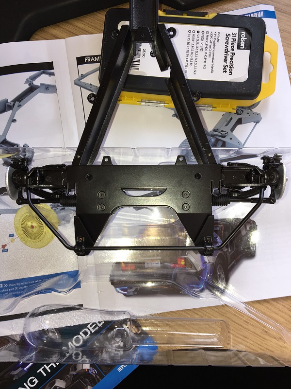

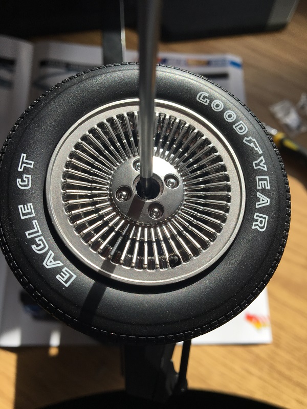

Place the ends of the anti-roll bar through the holes in the suspension assembly's then secure the two brackets to the right and left anti-roll bar base with 4 AP screws. Take the hub cap and washer out of the wheel and place the wheel on to the drake disk. place the washer back into the hole and add 1 GM screw then push the hub cap back in place. Do the same for the other wheel.
