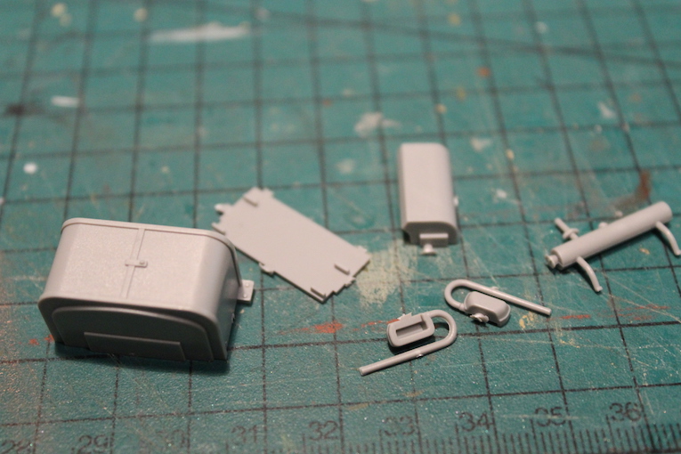

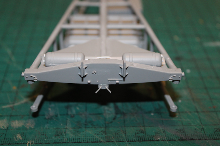

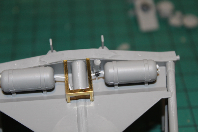

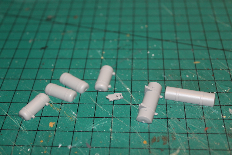

next up are some gas tanks one slung under the front end of the trailer the other two small ones go on the rear platform.
The large one was made-up first. I modified the strap by cutting some aways a small section, drilling a small hole through the tab and adding a fine pice of wire to replicate the fastening system. I think it looks ok once mounted on the trailer frame.
on the smaller tanks I removed the fastening tab in its entirety as its over size and I could not se any on my reference material. again using my rivet tool some plumbing detail was added to the tanks. before fitting.
the two tanks needed connecting with some pipe work. I used evergreen rod for this task. the thicker pipe used as a 't' joint actually is break cable that I had left over from a motorbike kit I made in the late 1980s, never throw anything away, you just never know LOL LOL BigGrin
more Soon
jase attached the following image(s):

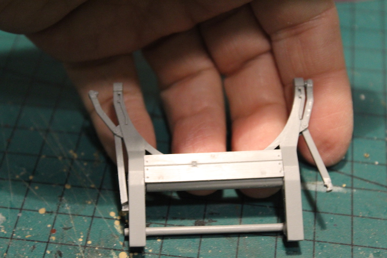

#102 Posted : 09 May 2018 22:37:24
The build continues with the base for the hydraulics that lift the launch tower into position.
A small amount of cleanup on the seams after assembly of the base cylinders but everything fits together well and fit to the trailer is positive.
I jumped ahead of the instructions slightly at this point to put the rear bulkhead in place. I needed to do this early to allow me to do some scratch building in that area.

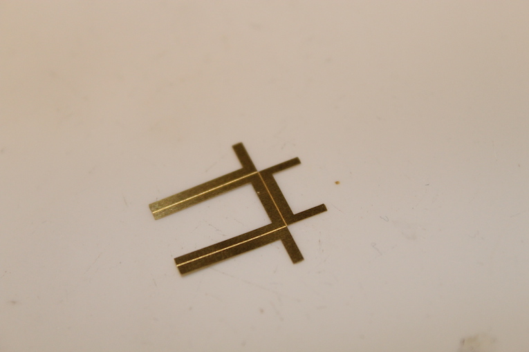

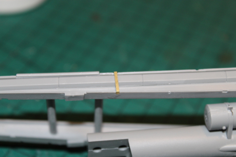

IMPORTANT BUILD NOTE: The kit instructions have you place the etch part way before this part is fitted, I strongly recommend you don't do that as it needs to butt up to it.
The kit supplied etch is and folds easily, getting the joint gap free is a challenge, CA is not going to cut it so I solders mine and filed/sanded it smooth after. just a note on the soldering I use a liquid brush on flux it aids adhesion and there is no need to clean the etch. the whole process takes just a few moments.
more scratch building nextCool

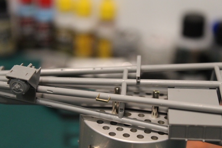

#103 Posted : 13 May 2018 22:54:56

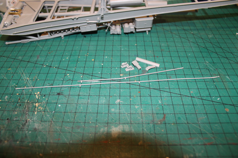

I used some sprue shaped with a needle file along with some plastic card and copper wire to add the next bit of scratch building

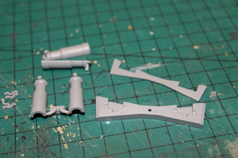

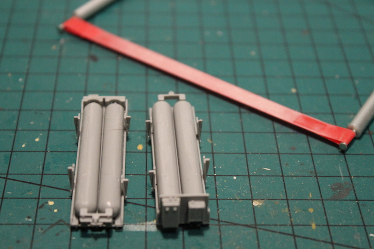

#105 Posted : 19 May 2018 12:23:27

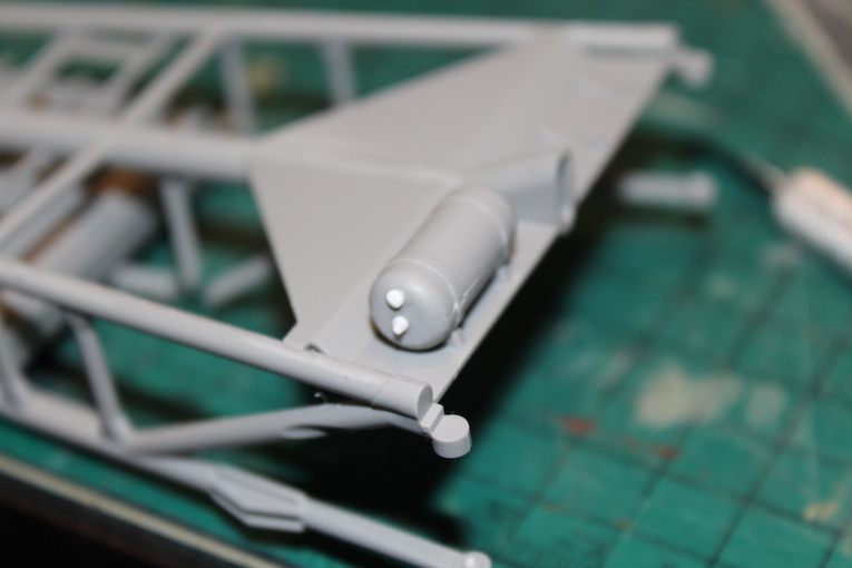

Construction continues with cradles for more gas tanks. Ordination of the parts needs care are they are different to accommodate correct positioning on the frame.
The two sets of gas tanks look the part when assembled. once placed on the trailer it really makes it look busy.

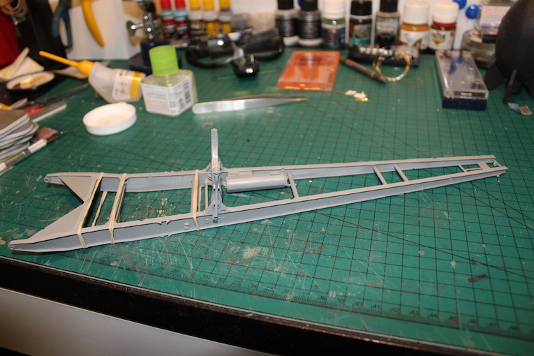

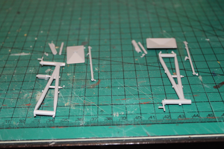

#106 Posted : 19 May 2018 17:07:55

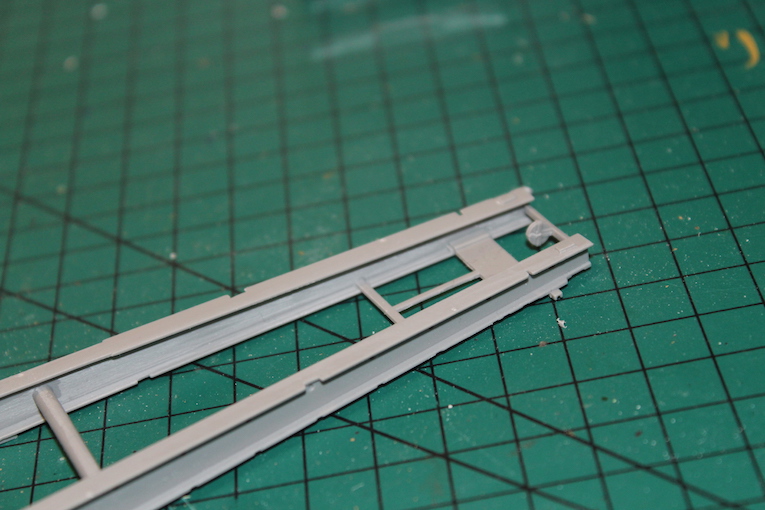

The launch frame is the next part of the builders quite a complex structure and the frame sides needed quite a bit of clean up.

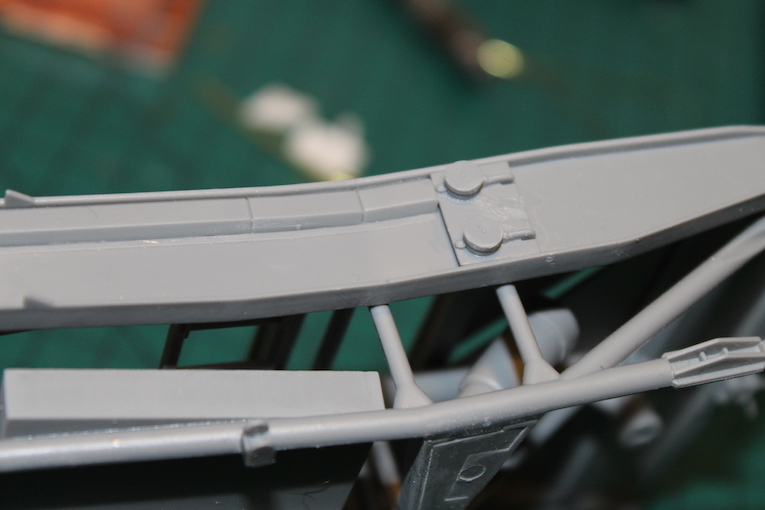

The launch frame is a fair bit longer than the trailer bed. once it is attached the build continues with various bits of pipework, a ladder a winch and some ducting to protect more pipework.
no issues of fit at this stage.

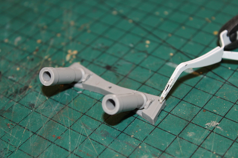

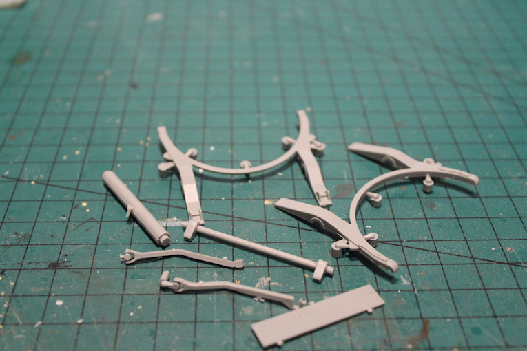

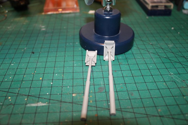

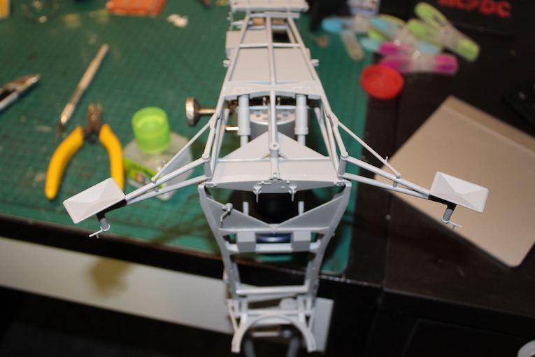

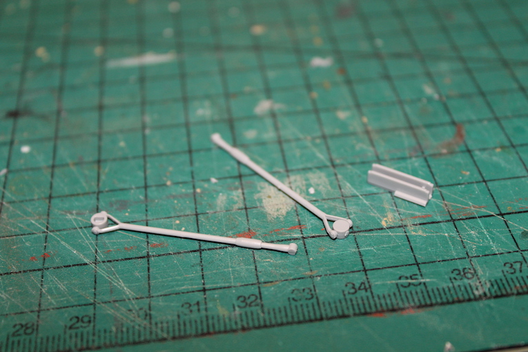

The hydraulic rams for lifting the rocket into launch position are next and they are huge things taller than a person. once glued into the launch frame the base of the rams is pushed into the housings and the launch frame put in place.
You can model the launch frame upright ready for launch or dropped into transport position. I want to show it in launch position as in travel configuration much of it gets hidden. with the launch frame attched the model suddenly becomes hugeBlink Love Love
the next assembly is the two stabilisation outriggers. These swing out to steady the trailer when in launch position and can be modelled open or closed, mine are open as we are going for launch. without thinking I glued the foot pads in the stowed positionCursing I will correct this later once the wheels are on!Mellow
next up is the wheel bogies

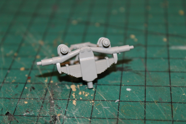

#120 Posted : 30 May 2018 06:11:25
The rear wheel assembly is made up of 24 parts. No fit issues hear and the tyres are easy to push on and off. Clean up is minimal the most attention required on the leaf springs. These are just dry fitted ahead of painting.
The front set is considerably more complex with the inclusion of two sets of axels the tow hook and a rest for the launch frame. Again other than removing seams there is not much clean up on most parts, however the frame support needed filling to remove a gap on the top surface.
In real life the trailer had two interchangeable tow arm a vehicle one and a manual one, the kit only supplies the vehicle version.
the assembly for the frame rest is quite complex and is on a pivot to allow for up hill movement
On part that needed modification was the number plate and lights arrangement that is not correct. I used the plate from the Hannomag etch set to improve this.
One piece of advice is to not build up the wheel hubs as the instructions suggest, its a simple process that Tacom have managed to make almost impossible. leave the rear rim half until last which gives you much better access to the centre hub parts construction which allows the wheels to freely rotate. I also found the fit of one of the hub parts impossible and had to file out the centre to widen the hole to allow assembly to fit correctly; even then one of the parts split while trying to get it in place.
