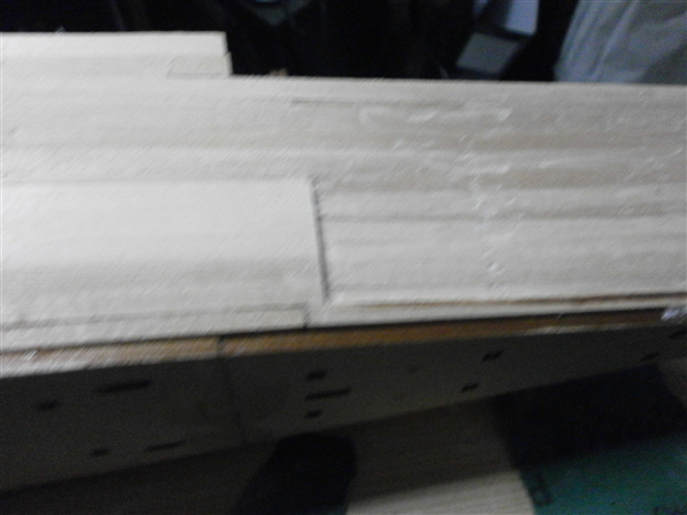

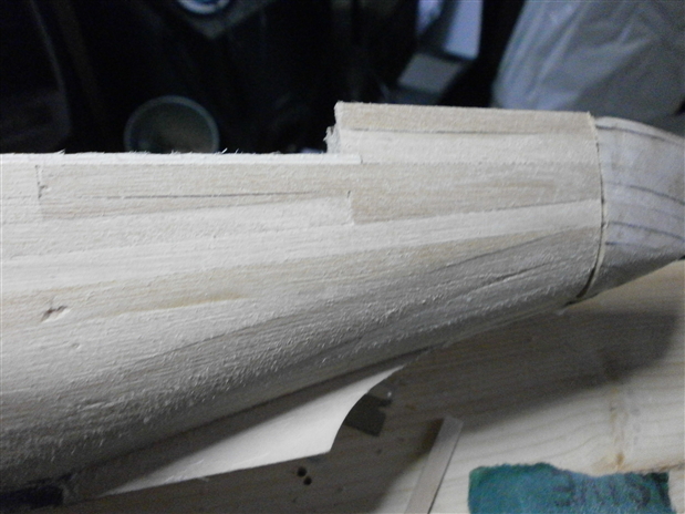

Planking came out very well, am going to start mine tomorrow, hope that it looks as good as yours,LOL
#102 Posted : 04 February 2012 10:40:48

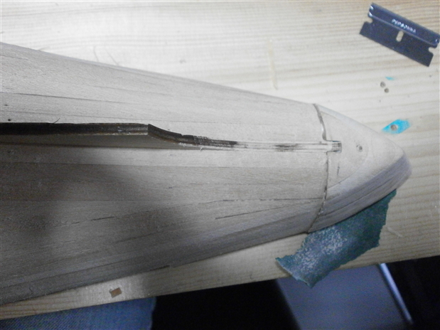

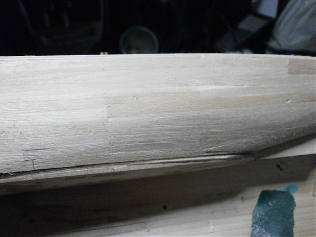

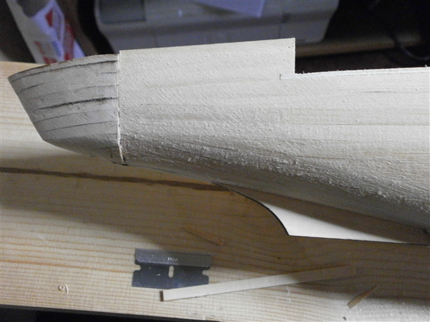

BigGrin Thanks very much for the comment Ger il be posting more pics of the hull sanded back shortly
#103 Posted : 04 February 2012 14:54:29

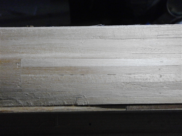

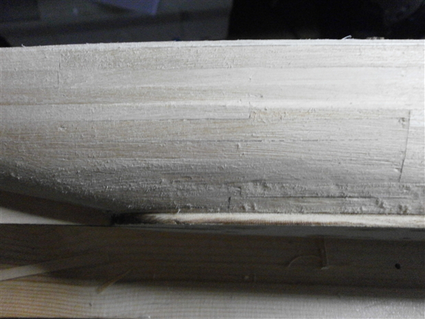

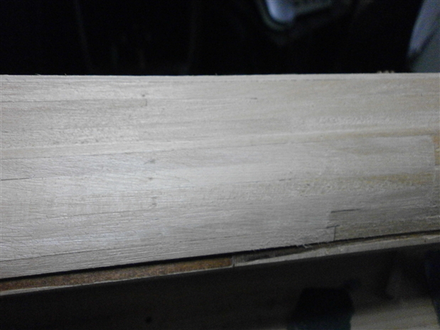

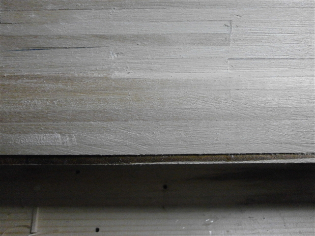

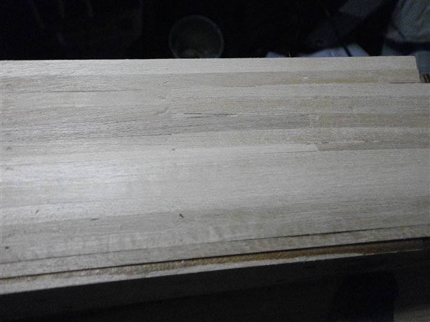

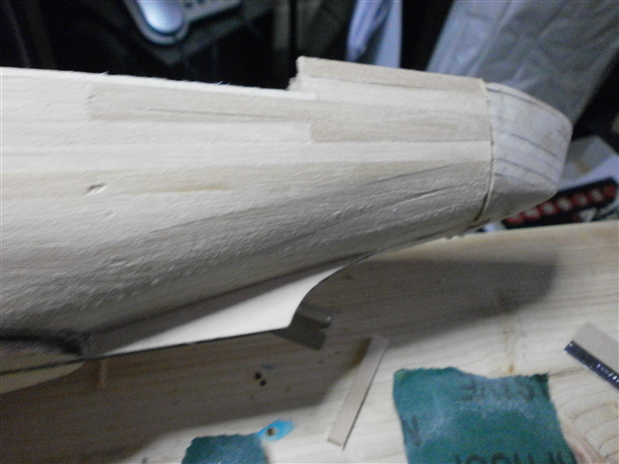

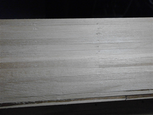

the rough sanding of the hull is more or less compleat just some finishing off around the stern[only just glued it onLOL ]and bow,still needs a good final sanding but cant do that till i get the measurments to go on the base [next issue i think].As ussual all comments are welcome

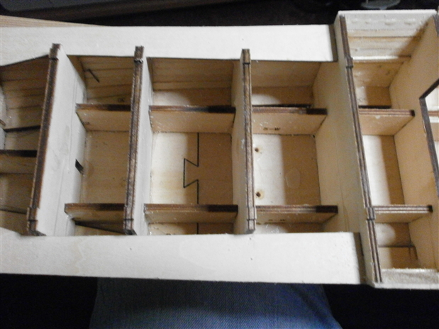

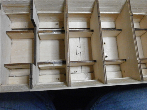

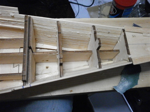

#104 Posted : 04 February 2012 15:05:54

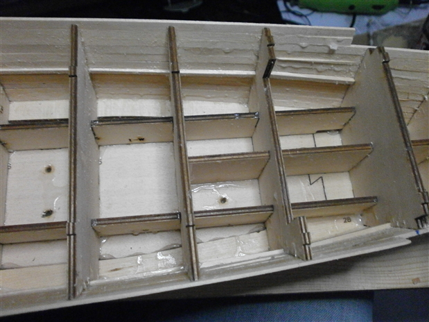

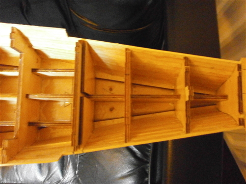

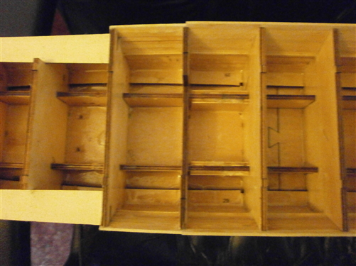

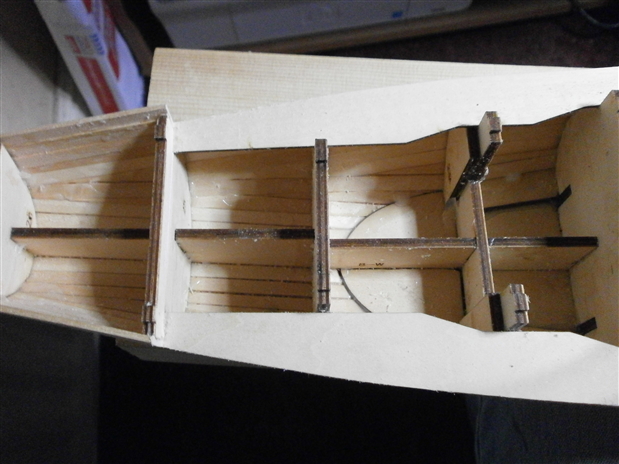

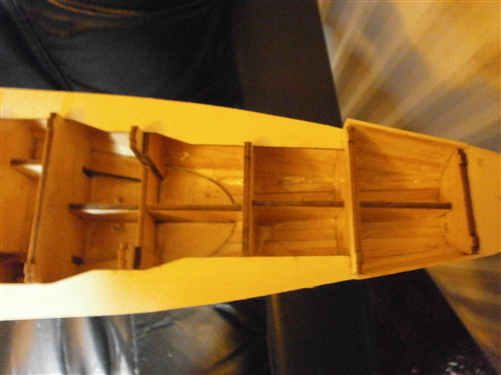

BigGrin Thought i would include here a few pics of the internal structure after planking as this might benefit /help novices doing there 1st or 2nd builds, as a guide on how it should look inside [note this is before iv epoxyed the inside of the model]

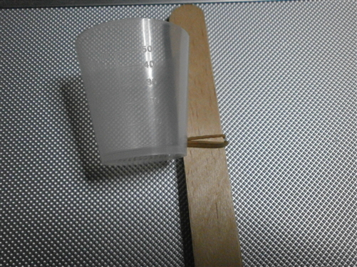

The epoxy i use is by Pacer[there are other brands on the market]and comes in two 6oz bottles,i find it mixes easily and has a good coverage, 60ml did the inside of the Yamato,you will also need some mixing cups and wooden spatulas but any old wood will do as long as its clean and last of all the cheapest brushes u can buy as they are of no use once the epoxys gone off, quarter to half inch wide is ok . Also it sands easily and can be painted over,im still contemplating using this as a base coat on the outer hull before painting as it will give a smooth glass like finish that when painted will more resemble a steel hull. Hope this helpsCool

Thanks for the info, and the suggestion of using it on the outside is a stroke of geniusThumpUp , i was pulling my hair out ( Whats left of itLOL ), trying to work out how to smooth the ouer hull properly so i can paint it.

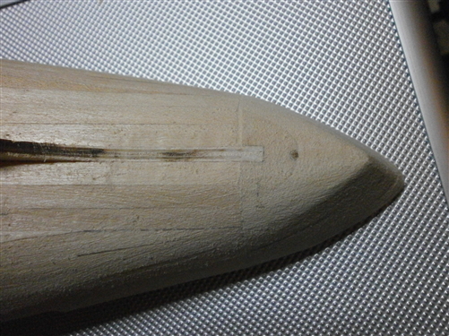

#109 Posted : 04 February 2012 19:25:12

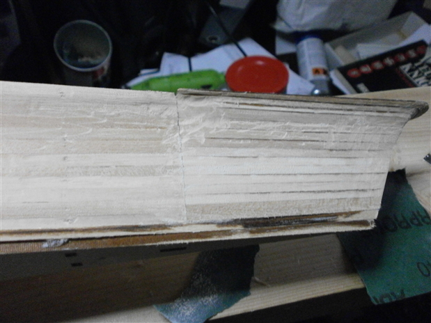

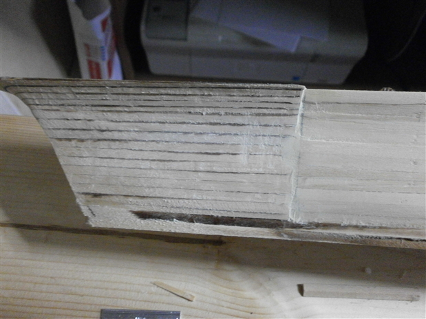

BigGrin heres the stern finished to a rough sanding and thats it for this month,as always all comments are appreciated/welcome

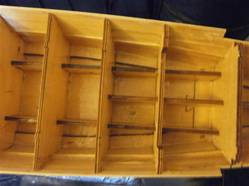

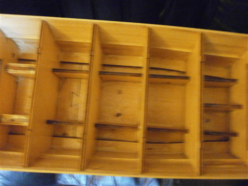

#112 Posted : 23 February 2012 20:17:33

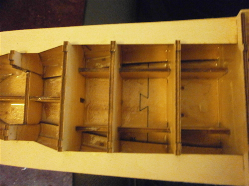

decided to epoxy coat the inner hull as it will be more difficult to get to all the nooks and crannys soon as more things are added to the hull. As usual all comments are welcome

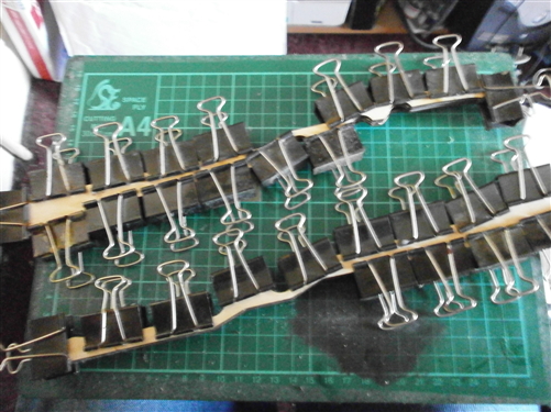

#120 Posted : 25 February 2012 13:37:00

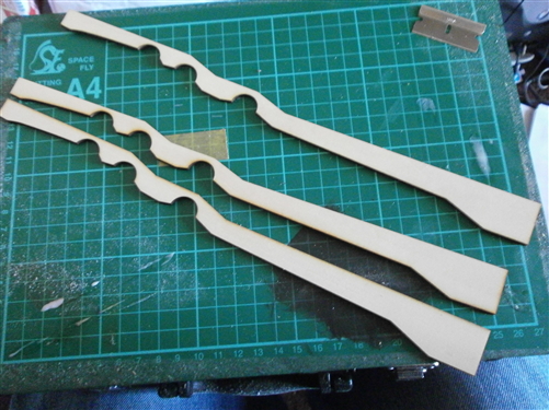

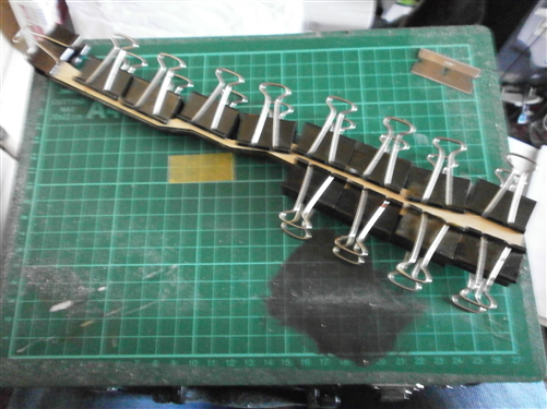

Pack 7 arived this morning so cracked on with the build and assembled the stern framesCool,just a note here some of the facings to the 3 stern frames had marks/digs on them so just ensure that when you assemble them you have a good face on the top and bottom and double check the alignment as you clamp them up.As ussual all comments are welcome more pics to follow
