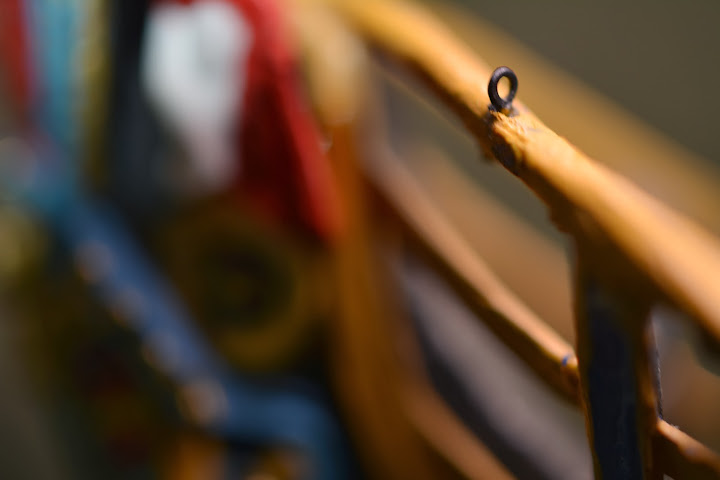

Up next was the beak head netting. There are a couple of schools of thought here as to how it was supported, on ropes or on iron rods.
I wasn't about at the time of Trafalgar (I'm not that old BigGrin ), so can't really say how it was then, but the photos below show that iron rail is used nowadays.
After checking out several photos I made some measurements and fitted the small 1mm photo etch eyebolts into the beak rail, one adjacent to the round houses coming out on a horizontal plane.
Another in the foreword end of the beak rail was fixed in and the "eye" bent up to a vertical plane.
A small hole was then drilled into the base of the beak rail to take the vertical support rod.
I then cut and shaped some 0.5mm brass micro tubing.
After careful measurement, I soldered the support rail onto the main bar and after a bit of cleaning up test fitted.
The rods are fitted by first inserting the straight end into the foreword eyebolt.
Then lowering and locating the bent end into the eyebolt adjacent to the round house.
With a slight lift in the centre the support rod can be located into the hole made earlier.
Once I was happy with the fit, the assembly was painted matt black.
The beauty of this method is, that if needed, the whole assembly can be removed for access behind it.

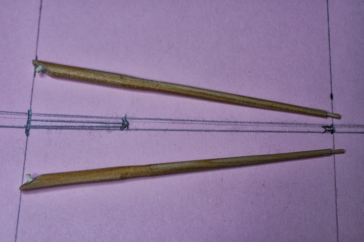

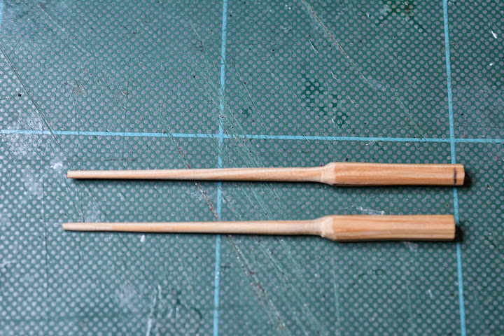

Another little update. As I was working on the beak head area I decided to have a go at the bumkins or boomkins whatever you wish to call them.
These are the small spars that are attached to the knight head posts and protrude out and at a downward angle through the beak head netting, and rest on the curved shape of the beak rail, I think they are tied down there as well. They are there to hold down and spread the the tack (lower angle) of the fore sail. Below is a photo of the starboard side of the real ship.
Although round in profile and tapering toward the outer end like a spar, at the point they attach to the knight head posts they are octagonal in shape as seen below.
So here is my attempt to make them. After getting some scale measurements
which shows them to be about 3mm at the knight head end, tapering to about 1.75mm at the farthest point. I started with two pieces of 5mm square profile timber.
I chose the square profile because I thought it might be easier to make the octagonal shape but as it turned out I had to file so much down I might have done as well with round profile, but anyway, I marked off some reference points and turned them in a drill chuck, while filing, to get the basic shape below.
Some more thinning down with small files and sanding pads got me to the next stage.
I then roughly calculated and filed the angle that they come away from the knight head posts and after some adjustments I was happy with the fit. I then drilled and fixed some small locating pegs made from filed down cocktail sticks that will locate into holes drilled in the sides of the knight head posts. A bit of final shaping to arrive at the finished items.
Below are some shots of them temporarily fitted in place.
Its not a perfect octagon but at this size it gives the impression of one.
If you look at the first photo of the real ship, they seem to have a slight downward bow in them and I'm pondering whether I should soak them in water and leave them to dry with some weight on them to achieve this, or just leave well alone in case I do more harm than good and just paint them black and be done. Whatever I decide, I won't be permanently fitting them for a while until they are needed, as little pointy out things tend to get broken off BigGrin
