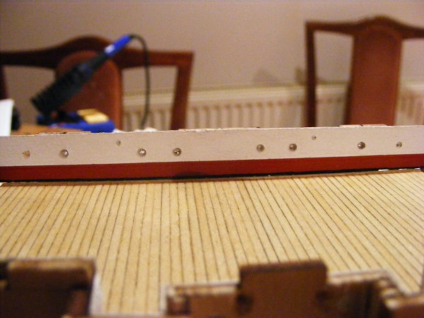

#108 Posted : 22 December 2013 20:54:31

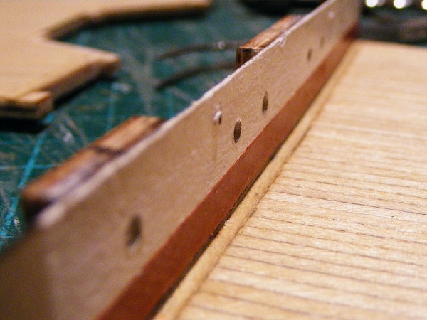

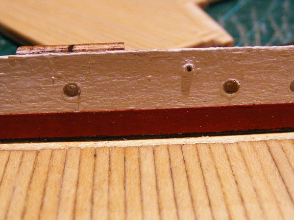

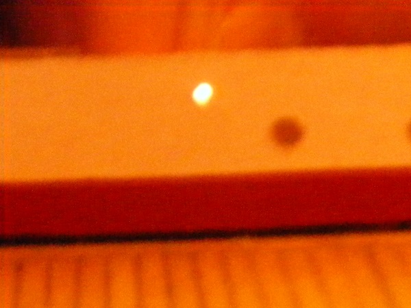

Have been experimenting a little on how to produce the bulkhead lights on the well decks and possibly the roof lights for the promenade... Think I have come across a method that looks very acceptable to me.... Cool Cool Started by using 0.5mm eyelets and simply cut the stem off, .5mm meant it didn't look out of scale.. Drilled .4mm holes into the bulkhead and using a little CA glued the eyelet over the hole and left to dry ... Blink Blink Gave the eyelets a coat primer followed by a couple of coats of matt white... Finally, applied Krystal Klear to give the impression of glass.... As I haven't yet ordered led's and fibre optics yet I had to resort to using one of the fibre optics from the xmas tree to see what the effect would be... think I am quite happy with it so far...Cool Cool Sorry for the last photos being a little out of focus, difficult to operate the camera on macro and hold a fibre optic in place.....
Happy building all...

Thanks Steve, have just now ordered all the led's, resistors, wiring etc to start lighting this kit. Feel the model would come to life if I can get bulkhead, wall and ceiling lights to light up and fibre optics I believe is the way to go.... time will tell whether it will be a success or not, if not I can always leave the lights switched off.....BigGrin BigGrin BigGrin

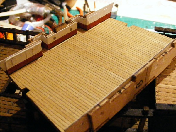

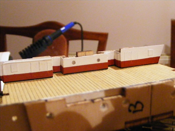

#117 Posted : 05 January 2014 00:03:09

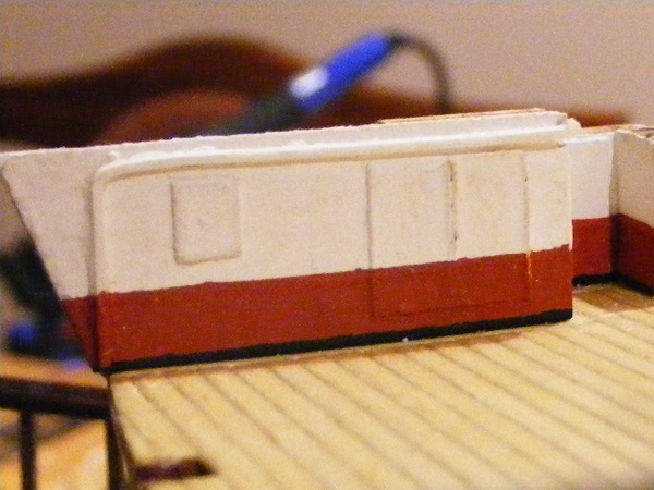

Have finally finished the forward well deck and there were a number of changes than needed to be made.... On the forward bulkhead needed to add the two portholes, add the pipework above the doors on the portside, add two watertight hatchdoors and change the watertight doors from single to doubles. On the rear bulkhead, add all the portholes and the two bulkhead lighting units.... The instructions leave these bulkheads blank with the exception of doors which were all in the wrong place....Cool Cool .. Have also come to the conclusion I hate working with white paint, too easily marked for my liking but am sure technique will improve the more I use it..... Am waiting now for the arrival of some matt clear varnish to protect the bulkheads... Cool Cool .. Tomorrow I hope to have the forward well deck fitted and do some testing on lighting the portholes with FO.... then onto the aft well deck Cool Cool...
In regards to the lighting I have had to consider some key changes to the build sequences... Instructions say to fit all the decks in place before moving onto the planking stage. If I do this then I will not have any access to modify any lighting arrangements should it be needed so have decided that I will simply pin the decks in place so they can be removed once the planking is complete.... Also on some of the tests I have done, the amount of light coming through the portholes on the bulkheads appeared to be very limited and I put this down to the thickness of the bulkheads and it will be the same for the hull when planked as she is double skinned..... I think my only option here is to use fibre optics throughout together with leds on their own... By being selective on the portholes this means I can have some lit with FO, some showing dull ambient light and some not lit at all, am hoping this will give me the correct balanced look.... Time will tell.....Cool Cool

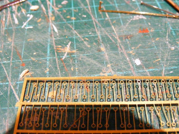

Hi Derek, thanks for looking in and your kind comments.. Cool Cool . I have been looking at the Minibras etch sets and although pricy they are impressive but have also noticed some of the doors are the wrong kind and some watertight hatches are in the wrong position.... That said, the etch supplied with the kit is also very good even though it is made of thin ply rather than brass, the ply is very flexible and remarkably strong.. Will post some close up photo's this evening to give you and idea of the detail.... The only thing I am not too keen on is the railings and stairways so minibras railings could very much be on the wish list, stairways will have to be thought about ....Cool Cool ... Thanks again......Cool Cool

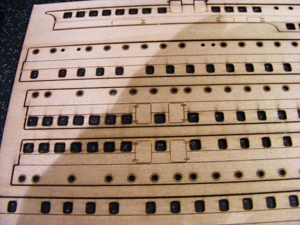

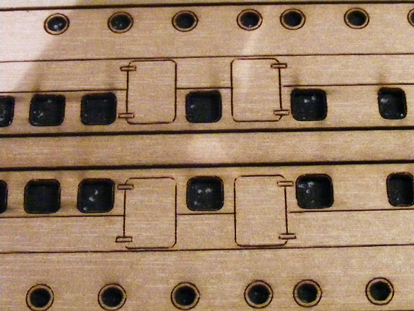

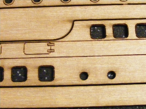

#120 Posted : 05 January 2014 17:45:07
As promised, here is a couple of close up pics of the supplied ply etch.... Most of it will be used but think the railings will be left out.... Cool Cool
