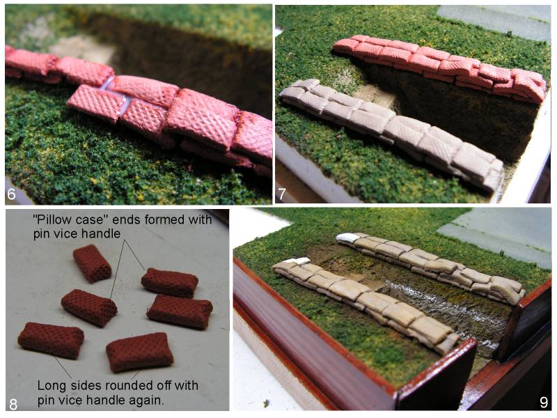

Where was I? Oh yes, after the chalkie memories I needed to give the impression that the trenches had been dug quite recently (as most of them were at that time) so I muddied up the surrounding area using two of the Carr’s Mud Powders left over from Messine’s. Instead of the usual fingertip or sponge application I used a cheapie ‘The Works’ ¼” quite stiff natural bristle brush to vigorously rub the powder into the grass and turf. I did try my fingertip first but once the scenic cement had dried, that turf was like sandpaper! The results of the brushing in can be seen in Photo 2, together with the two packets of powder used. The next task was to make the two rows of sandbags, which line both sides of the slit trench. Although I’m showing this now, I’d actually begun this before the turf went on as you can probably see, lurking in the right hand background in this same photo!Blink
Now came the most laborious task of the groundwork – sandbags! I was going to say the most laborious task of the whole diorama, but then I remembered the brick built Dispatch Hut!Crying If you remember the Messines diary, I made the sandbags in that one out of Milliput epoxy putty, for this one however I decided to try out a different medium since, as strange as it sounds, there are about five or six times more sandbags in this WW2 scene than there were in the WW1 trench diorama! (Most of the trench sides were corrugated sheets or wicker-work panels with just a topping of sandbags.) Milliput is a brilliant material for making things out of, but it’s really messy if, like me you dislike getting your fingers all sticky, and on top of that, it’s not exactly cheap either! In Photos 3 and 4, we have the basic material out of which the sandbags were created: DAS air hardening clay. I’ll have to admit here that I was ‘slightly’ mislead by the packaging of the clay (obtained from Hobbycraft by the way), I read the word “Pasta” on the pack and thought that it was ‘pasta’ coloured – ie, a sandy brown perfect for the base colour of sandbags. It was only when I opened up the pack a few weeks later that I realised that whatever language it was (Italian I think) pasta simply meant ‘clay’! Ah well, at least it wasn’t Day-Glo Orange (and they do that one too!)Blushing On some Youtube videos, DAS clay is refered to as ‘Paper-Clay’ and if you look closely at Photo 4, you can see tiny little paper fibres sticking to the edge of the plastic knife edge. I believe it is these little fibres which bind the clay together and prevent it from cracking up as it dries. The only other tools required to make any amount or scale of sandbag is a good long kitchen knife (sorry Mum!), a roller of some kind (I used the sprung tube/axle from a toilet roll dispenser!) and the ever useful Pin Vice as shown in Photo 3. You will also need a jar of clean water as I’ll show later. The first task is to cut off a thin slice of the clay from the main block and roll it out to about 3mm thickness (1/72 scale, probably 5mm or so for 1/35), preferably on a sheet of suitable glass, this keeps it flat and makes it easier to remove. Then, taking the pin vice roll it over the flattened clay to produce the imprinted ‘hessian sack’ pattern shown in Photo 3 again. Once this is done, using the long knife blade cut the patterned clay into parallel strips about the width of the bags and then, (easier with a safety razor blade) cut the strip into individual sandbags. (I found wetting the knife blade makes cutting this stuff easier). Using the razor blade again, pick up the sandbag and then use the thinner handle of the pin vice to round off the longer sides of the bag before adding a concave to each end (like a pillow case), again with the pin vice handle. You’ll see the effect clearer in the later photos but the first set I made is shown in Photo 5. This is where I hit a little snag in the construction process. I had a nice little row of sandbags all right but the next day, after drying out overnight I found I had a nice little row of completely separate sandbags! The only solution was to replace them in position one by one in their original places brushing PVA in between the joins to glue them back together as shown in Photo 6. I later found the solution to this was far easier than gluing with PVA, all that is required is to liberally brush over the bags as they were pressed down into position with a brush-full of water. Keeping the clay wet as the bags are built up literally welds them together, the semi-liquid clay (or ‘slip’) which fills the gaps between the bags, acts as all the glue you need. Photo 7 illustrates the two rows of sandbags completed. The foreground one has been given an undercoat of the Docrafts All Purpose Acrylic Paint – Sand, the same one I used for the Messines sandbags, the far row still in it’s natural terracotta (and not pasta) was put together with the water brushing method and is a single entity once dried. The advantage of making up the bags in situ is that they can be pressed down into the ground work, taking up the contours in a natural manner, something you can never quite get with pre-formed plastic commercial sandbags. The individual bags shown in Photo 8 show the procedure I mentioned earlier, rolling the pin vice handle along the longer sides to round them out and also that concave ‘dimple’ in the shorter ends. You can also notice that in this state the bags are fatter than they eventually end up, the act of pushing them down into place flattens them out slightly, back to the ‘floppy sack’ appearance required. Finally in Photo 9, we have the finished rows, the sand undercoat has been given a thinned down wash of Citadel Skaven Brown Ink to accentuate the joints and shadows, and once the wash was dry, a dry brushing of Admiralty Yellow Ochre to give them a slightly more hessian sack finish, followed by a final Admiralty White drybrush to pick out the edges and highlights. The white was also used to paint the inner, end sandbags as per the movie where those particular sandbags were whitewashed to mark the slit trench entrances. In this photo you can also see the spruce side panels and the top of the pine board have been given the first few coats of Ronseal Quick Drying Teak Varnish.

Excellent stuff as always Robin, I'm learning so much from you about making dioramas and all the extra little tricks that are involved in producing various items that look so realistic - well done and a big thanks to you for all your hard work in posting these builds. It's been said before that you should write a book on the subject and I really think you should - I'd buy it, so that's one copy sold already!! Love Drool Cool ThumpUp
Love the chalk seams in the trench, looks almost as tasty as the chocolate and vanilla cream sponge cake that my wife makes and the muddy grass along the edges is a super touch, very convincing. That's what's so fascinating about your models, in that you don't miss a thing and I think that's what makes the difference between a good diorama and a great diorama. Ever thought of entering one in the annual 'Euromilitaire' show in Folkestone every Septemeber? Might be worth considering?

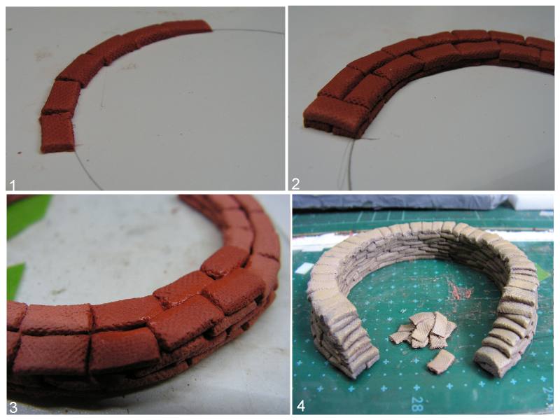

And so, on with the Bofors Gun Position!
The first step in creating the Bofors Gun emplacement was to measure the actual gun and work out how big the ring or wall of sandbags would need to be. The completed model was placed on an offcut of Upvc, the sort of lengths used in the Soffit and Conservatory building trades of which I have a (large) store in the garage, all of which I got for free from a very nice man who used to deliver ‘recycle-bound’ reject lengths to my old place of work, a Devon wildlife park! I eventually decided on a 65mm diameter which was duly pencilled on to the Upvc as seen in Photo 1. The sandbags were then created exactly as seen in the last instalment, beginning with a single row as also seen in that photo. There was no gluing involved, the stickiness of the DAS clay was enough to fix it onto the plastic surface where it remained (mostly)Blink until the sandbag position was completed when it could be gently prised off the plastic again for painting. Once the inner ring was completed, another outer ring was then added to create a double wall and once this was also finished, the ends which formed the single entrance, were joined by a cross-wise bag to finish off. This bag began the second layer of sacks and also formed the ‘brick layer’ jointing. Theoretically every bag should have been placed over the join of the two below it, but slight variations in the size of the individual sacks (plus differences in how hard they were pushed down in place) meant that they didn’t always line up that way! On the other hand, those differences make the whole thing look more ‘hand made’ and less ‘artificially regular’ (and this is a really useful excuse for future projects too!) Having learnt the ‘keep ‘em damp’ trick in the trench sandbags, again, no glue is needed to ‘weld’ the bags together. The first two rows are illustrated in Photo 2.
After that it was just a question of adding row after row of sacks, each time beginning and ending at the entrance with a cross-ways sack, and with each one set back a little to create a stepped end to the wall. In Photo 3 you can see the third row going on, note the darker sandbags in the centre, these have just been soaked with a brush full of water to weld them together. It is also necessary to brush over the completed lower row when adding the next on top, this way you don’t have to complete a row in one operation, you can add the next ones after the lower row has dried out simply by wetting it again. The higher the wall went, the greater was the urge to fill it up with red coated members of the 24th Foot – maybe another time!BigGrin The completed ring is shown in Photo 4 after the multiple coats of paint and inks as laid out in the preceding instalment. Also shown here is an after-thought I had to use up some of the clay from the final set of sandbags – empty sacks. These were simply rolled out thinner, imprinted with the pin vice and then cut into flat sacks to make an untidy pile near the entrance, as can be seen in the finished shot in Photo 5. The green ammunition crates stacked around the inside were made from the Costa coffee wooden stirrers, two glued together for double thickness, sawn into individual lengths, sanded smooth and given a pair of encasing strengthening ribs from Plastruct styrene strip super glued in place and then painted with Vallejo Medium Olive 70.850.

Nice work Robin, I think the higher stack of sandbags around the Bofors than was around the trench looks even more impressive and certainly very realistic. Great touch to make some empty sandbags as well, just another example of your great eye for detail!! Cool ThumpUp

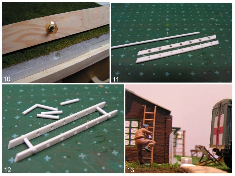

With the cover now complete, apart from some cosmetic sanding to be carried out in the future I can return to the construction of the various ‘accessories’ around the diorama. The first one is the ‘Painter’s Table’ which I included as part of the ‘work in progress’ in camouflaging the Dispatch Hut. There are two ladders along with the table, one of which is the twin of the access ladder holding up the Hurricane, the other is a standard wooden ladder of which more later. The painter’s table is the type of collapsible ‘bench’ still used today for wall papering etc. Try as I might, I couldn’t find any references on the web for 1940’s era RAF painting accessories. I know Dad had one of these tables for donkey’s years so I hope and pray they were around back then too! The components of the table can be seen coming together in Photo 6. The table top is a fairly thin offcut of plasticard with the under framework and the folding legs cut from strips of 0.5 x 0.8mm Plastruct. After the two leg frames were glued in place, the locking arms were cut from some thin stretched sprue. The tins of paint were made from suitably sized aluminium tubing, cut into length by razor saw and the open ends then counter-sunk to thin down the thickness of the tubing to a more life-like thickness. I also needed some tin lids, one for the un-opened tin and another two to lay on the table top. These were formed from the DecraLed strip using a multi-diameter leather punch to punch out tiny little disks as illustrated in Photo 7. I didn’t bother with bottoms for the tins, they were just super glued onto the table top after the plastic miniature had been primed and painted with Revell Wood Brown 382 (and also after the plasticard hinge in the middle had been added on too). Once the glue was dry I used thin brushes to dribble the Revell Dark Green and Dark Earth camouflage paint into the tins along with some thinned down ‘stains’ on the work surface (backed up with some Revell Sky for good measure). The almost complete table which sits comfortably on the proverbial penny (although I must have forgotten to take a penny shot) can be seen in Photo 8. The paint in the tins did shrink a little as it dried so I added some more and also dunked in a couple of stretched sprue stirring sticks for extra effect together with some dustcloth/rags formed from rolled out thinner lead sheet as seen in situ in Photo 9 (alongside that other access step ladder).
Before the second ladder, here’s that captive nut epoxied to the inside face of the wooden side panel I forgot to put in earlier! The hole was drilled through the wood and the M3 Brass bolt inserted through with this nut tightened up on the inside before applying epoxy glue around it. The hole into which both the nut and the brass bolt fits can be seen in the foam board just below. (Photo 10)
The common type ladder shown in Photo 11 was very easy to make up, just two strips of 0.8 x 2.5mm Plasticard (actually it’s four strips, they were doubled up for thickness making the bars 1.6mm thick) together with rungs of 1.1mm Plasticard rod. The holes were drilled into the sides for the rungs (drilling through both sides at once) and the ladder was started by fitting and gluing the first and last rung only as shown in Photo 12. By letting the ladder dry in this condition it’s far easier to add the remaining rungs without the whole thing wobbling around and going out of true. Once all the rungs were in and set, the protruding parts were sanded down flush to the sides before the ladder was primed and painted wood brown. The finished item is seen in Photo 13 with the ‘painter’ hurriedly ‘knocking off’!BigGrin

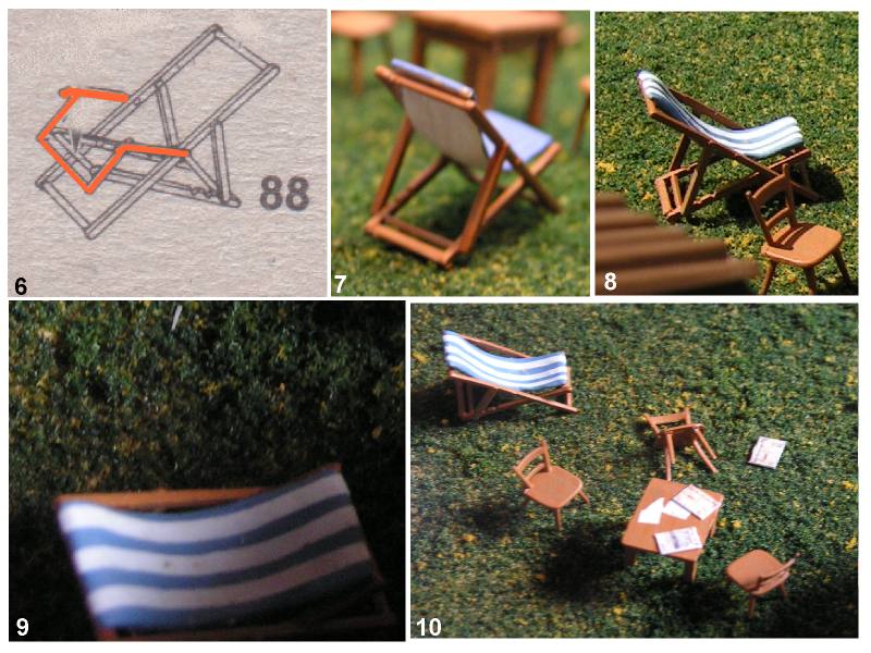

This instalment has been quite a difficult one for me to put together! Unlike nearly all the others which involves a good deal of scratch building and converting, with the attendant descriptions, this one is, apart from a couple of slight changes all about simply using items straight out of the box (and I’ve almost forgotten how to do that!)Blink Anyway, here goes!
Photo 1 is a composite of the table and chairs as supplied in the excellent Preiser Set No. 72508 (or Art No. as it is in German) “Pilots and ground crew. Luftwaffe. The German Reich 1935-45” Despite the new Revell RAF Personnel set (which is about as rare as Hen’s Teeth despite the Battle of Britain anniversary), this is about the best set of figures to make into the RAF as you can get. I did get a set of the old Airfix RAF Personnel which provided a few figures but there are surprisingly few useable poses in that set, especially in the ‘Scramble’ context. Although the Preiser set are actually the opposition, the differences between the British and German uniforms are so minor the figures can often be converted with no more than a change of paint scheme. Preiser really missed out on increased sales though by not bringing out a new set of RAF figures for the anniversary, there must be thousands of modelers out there who, (like me) would have snapped them up! The top part of Photo 1 is a scan of the inside of the Preiser box which contains painting tips and pictures of the sprues of parts. When I get to the main figures I’ll try to illustrate which parts went into which figure, the torsos are fairly easy but the many arms get very confusing! The set contains four chairs and actually two tables, the one shown here (Parts 86 and 87) are moulded in a light sandy brown plastic along with the chairs, there is also a second table attached to the main sprue, moulded in the German Grey plastic as well. The chairs are single mouldings, very finely cast with incredibly thin legs, three of them were painted with the Revell Wood Brown for use out on the grass with one of the tables, the last one was painted in Vallejo Mahogany to fit in with the scratch built desk inside the Hut (more on that one in a later instalment). The tables are moulded with playing cards arranged on top and also a leather flying helmet in one corner. I chose to sand off these details to replace them with some newspapers and sheets of paper instead. The newspapers were authentic front pages from the Battle of Britain period, downloaded from various royalty free websites as shown in Photo 2 and then reduced down and down until they reached scale size. At the same time I also obtained various posters which were also scaled down for the interior of the Hut, and the whole batch was put together using my Corel PrintHouse graphics program and printed off on the thinnest photo paper I had available (though it still looks like a full thickness newspaper once printed!) In theory, if you could get down close enough you should be able to read the things on the model – probably not in 300dpi though! (Photos 3 and 4).
There are two deckchairs provided in the set, Parts 88 and 89, and they can be made up in two versions – occupied or empty. Part 69 on the main sprue is a reclining German pilot relaxing on the material part of the deckchair which he is moulded to. He can either be dropped onto the delicate moulded wooden frame as in Photo 5, or the empty canvas part can be used instead. As all my pilots are running for their aircraft (mostly out of shot) I used both the deckchairs empty. You can see in Photo 5 that the wooden frame includes arm rests. Although this type would have been around over here, those features are more ‘continental’ than your typical British beach version so the arm rests were cut away as depicted in Photo 6. Now came the slight, er, mistake! Somehow I convinced myself that the deckchairs featured in the movie were all single coloured ones, which is how I painted them to begin with (Photo 7). However, a final viewing of the DVD revealed that they were actually the stripey variety so it was necessary to do a little more work on them. I went for a nice blue and white stripe although I think the film ones were actually triple striped – blue, white and red! The canvas seats were first painted in Vallejo Grey Blue 70.943 (the colour of the German’s trousers in the Messines diorama). I then tried painting the white stripes on which looked horrible, both my white acrylics, Citadel and Admiralty are getting too thick with age, thinning them down with water helps but they’re still not ‘as good as new’ so to make things easier (and after a second coat of blue!) I put the white stripes on using the white based inkjet transfer paper that I used for the ambulance red crosses. I simply sliced a thin strip off the top of the sheet, cut it into lengths a little longer than the canvas and dipped them into the Humbrol DecalFix. Once the strip began to loosen on the backing paper I slid it off into position, bending the excess length around both ends onto the underside. This was a little more difficult than it sounds, again I should have applied a varnish or lacquer over the white decal and didn’t, which made the thing very difficult to keep straight. Eventually I got the stripes on and left them to set before cutting shorter lengths to join up the underside ends into a continuous stripe. Overall, it came out really well with nice straight, even edges as can be seen in Photos 8 and 9 with the overall shot showing the deckchairs, table and chairs with dropped newspapers in Photo 10. It's a pity nobody makes 1/72 scale tea sets though!BigGrin

Oooh, I enjoyed that Robin, especially like the paint pots with their stirring sticks and the collapsible table in the previous instalment post and those deckchairs and newspapers are sublimely modelled, very well done mate!! Drool Love Cool ThumpUp
Great attention to detail as always and already looking forward to the next one, so keep 'em coming Robin?! Cool Cool Cool

Thanks for that Kev! Blushing The deckchairs and seats are beautiful little castings in that Preiser set (as are the figures as you should be able to see soon!)What I like especially is the quality of the plastic, not the cheap and cheerful polythene of the Airfix and all sets, just a little bit softer than the standard plastic kit material. Easy to convert and to glue together!Cool

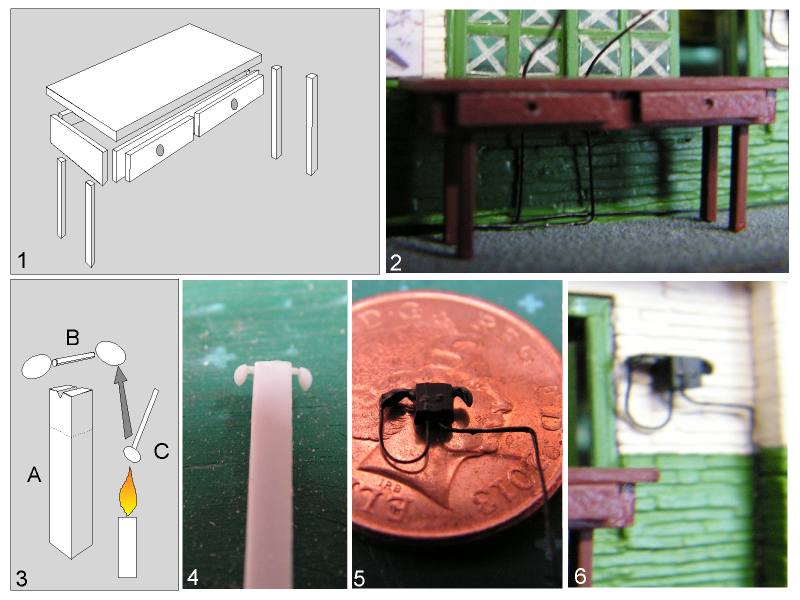

This instalment is necessarily ‘heavy’ in graphics I’m afraid, most of the items featured were scratch built in plasticard and once that process starts with all the gluing and cutting, it’s difficult to stop mid-process to take photos! The first item on the list is the wooden desk/table occupied by “Arnold” the Dispatch Officer (who will be covered fully in the next instalment). Diagram 1 illustrates the component parts of the desk, all cut from thin sheet plasticard with the legs from Plastruct styrene strip. There were 11 parts altogether including the two false drawer fronts. The completed desk is shown in Photo 2 after a coat of spray primer, followed by Vallejo Mahogany Brown 70.846. Note the telephone wires running along the floor behind the desk. There are three altogether, two for the telephones on the desk top and a third which runs further along the ground then up the wall to the wall mounted ‘phone shown in Photo 6. The wires are made from single strands of 6/.2mm electric wire painted matt black with Citadel Chaos Black to give a 1940’s black rubber appearance.
Of the three telephones, the wall mounted ‘intercom’ is the smallest and most basic, as shown in Diagram 3. The main body is a strip of plasticard cut from the edge of one of my thickest sheets, probably about 3mm or so, (A). A ‘V’ slot was filed into the end of the strip to take a receiver handle made from stretched sprue (B) and the receiver ‘cups’ were from the Riko Plastic Rod, heated over a candle flame to produce a dished end, which was then sliced off and glued to each end of the handle (C). Once this was dry, as shown in Photo 4, the strip was sawn off with the razor saw and any rough edges sanded smooth. Gripping the body of the telephone in a pair of long nosed pliers, two 0.5mm (or maybe smaller) holes were drilled into the base of the body, one to take the telephone wire mentioned previously and the other for a shorter length of the same wire looped from the receiver to the base. As you can see from Photo 5, I actually did this procedure in reverse, the telephone was made first and the wires added in with super glue. Once painted black, the ‘phone was super glued to the wall and the long wire then bent to shape to fit the wall and floor. The two ‘buttons’ on the front of the body were an attempt to add coloured buttons which didn’t look right so I painted them over black!Blink That is the standard penny shot in Photo 5 with the finished set up complete with wires in Photo 6.
The second telephone is basically a typical bakelite telephone of the time, the same design found in millions of homes and offices before, during and for many years after the war. Again, a very similar construction using the same plasticard strip (A), a little more complicated filing to obtain the body shape (B), with a virtually identical receiver. The only addition being a disk sliced from a round offcut of sprue to form the dialling disk (C). Getting that sprue to slice off evenly was a right old job! The finished telephone is shown in the insert, I did try to add the dialling holes but just couldn’t get them looking even enough so like the intercom buttons, the dialling disk ended up painted over too! (Diagram 7)
The third telephone is not only the most complicated, it’s also the only one that gets used in the movie! In Photo 8 we have the Field Telephone, Set D MkV. This was a very clever little machine, only about half the size of the field telephone I made for the German bunker in the Messines diorama (and therefore twice as difficult to make!Crying ) This machine was not only designed to be linked to the ‘other end’ by a dedicated cable like a true Field Telephone but it could also be plugged into any civilian telephone system and used as a normal telephone. On top of that, it also comes with a morse code key so that encrypted messages could be sent down unguarded lines in morse.Cool Apparently, when using a civilian network you had to tap the morse key at the end of the call to disconnect! One of the references I came across referred to an Army Signals operator who ‘unofficially’ plugged one of these into the remains of the German telephone network a short time after VE Day and spent his cold winter’s evenings chatting happily to his wife back in ‘Blighty’!BigGrin Diagram 9 illustrates the 14 separate bits, all plasticard apart from the bell ringer which is again heated plastic rod, whilst Photo 10 shows the completed machine held in a pair of spring tweezers before it’s painting up. There is no receiver on this one of course as this will be held in Arnold’s hand linked by a length of cable. Finally in Photo 11 we have all three telephones glued into position on the wall and desk together with another mini newspaper and some more sheets of paper made up at the same time as the last lot.

Amazing detail, amazing scratch-building and amazing skill. Well done Robin - amazing!! Drool BigGrin
Love the flattened sprue blob for the phone ends, great stuff and some interesting info about the field telephone there too. I had to laugh at the story of the Army Signals guy phoning home at Jerry's expense, that did make me chuckle so thanks for that little gem!! LOL LOL

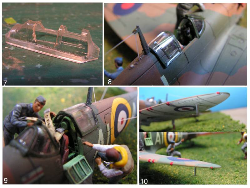

As promised, here's the final Spitfire installment!
In Photo 1 we have the Spitfire as she was in the last ‘Spit’ installment, all painted up, just waiting for the canopy and a last few details to go on. As you might remember, the intention was to have both the Spitfires with their canopies slid back awaiting their respective pilots. Photo 2 is a previous pic illustrating the great fit of the clear canopy to the fuselage, really a ‘clip together’ fitting, you could really get away with no glue at all here!Cool Unfortunately in my case, the clip together option went right out the window as I would have to cut apart the canopy into its three components as seen in Photo 3, (note the bit of Maskol still clinging to the front frame!). Again, unfortunately, even using the Exacto Razor saw, it is impossible to cut the forward windshield away from the sliding ‘bubble’ without removing the thickness of either the windshield’s rear frame, or the bubble’s front one. One or the other would have to be scratch built and the best option I think is to save the bubble and re-do the front windshield as you can see in Photo 4. The new frame section is made up from the Decraled lead sheet, sliced into a thin strip, bent around the end of the windshield until the curve was just right and then glued into place. I glued it with Micro Kristal Klear at first but this came away as I trimmed off the excess lead at the bottom so it was re-attached after painting with a tiny amount of super glue gel and lots of ventilation to avoid fogging the canopy plastic. The smaller rear canopy also loses it’s front frame in this process but unlike the windshield this is not a problem, simply painting the edge of the clear moulding is enough to create the missing frame, no lead strip is needed.
This is where things went a little pear shaped! Having painted the frames on the front and rear sections and PVA-ing them into place, I only then discovered a little problem with the sliding bubble part – it wouldn’t fit!Blushing It fits perfectly in the closed position but the moulding is way thicker than it would be in real life and can’t be ‘slid back’ over the rails (seen in Photo 1). There were three options – sand away the fuselage to accept the over thick canopy (and ruin the paint job in the process!) – sand down the interior of the bubble to fit the fuselage (and hope the sanded clear plastic can be made completely transparent again) or make a new thinner clear bubble to replace the kit part entirely. The first and second options meant a lot of extra work and the second one couldn’t be guaranteed to succeed so I decided to attempt to create a new canopy by heat forming a clear acetate sheet. This could have worked if I’d made a new bubble former out of hardwood or even a tough plastic, unfortunately I decided the most accurate former to create a new canopy with, was the existing kit one! Bad mistake! I never thought the heat softened acetate would be hot enough to affect the thick clear polystyrene original but boy it really did! The acetate did in fact form a nice looking bubble for a few seconds but then the heat transferred to the actual canopy which promptly distorted all out of shape. The result was no new canopy and an unusable old one as well!Blink The ‘poorly’ original is shown in Photo 5, although in this shot it doesn’t look that bad it’s actually far worse than it looks here! There was only one option left, I’d have to try and get a couple of third party replacements. Ebay to the rescue once again and a quick search turned up a pair of vac-formed Spitfire canopies designed for the Airfix kit by Paula Models, namely item number V-72-87 as shown in Photo 6. As you can see in this photo, I’ve already cut out the central section whilst in Photo 7 I’ve also cut away the rear piece as well. I was just curious to see what it looked like on the second aircraft, I was already going to use the cut off rear section from the kit part as I did on the first one of course. The fact that I was going to be using these vac-formed canopies actually made cutting up the second kit canopy a little easier because without needing to use the bubble section, I could saw off the front windscreen keeping it’s frame intact. Spit No.2 therefore didn’t need the lead strip frame like No.1. Photos 8 and 9 illustrate the new canopies cut out, sanded smooth along the frames, painted and finally glued into position. As you can see, the ‘canopy within the canopy’ effect once the bubble is slid back is quite striking once complete! Also added at this stage and visible here were the four radio antennas made up from stretched sprue, the HF aerial from the tail fin back to the radio mast on top of the fuselage with the return section going down into the fuselage itself from the mast and another two which run from the outer edge of the tailplanes back to the fuselage sides, (this is the IFF or Identification Friend or Foe transmitter array). You can also just make out the tiny little plasticard rear view mirrors in place on the top of the front windshield frames.
The final addition to finish off both the Spitfires was to replace the pitot tubes which had been broken off during the masking and painting process with stretched sprue again as shown in Photo 10.
Once all that was dried and set, the two aircraft were gently fixed into the grass base by pushing down the brass rods drilled and glued into their wheels until just a few mm above the grass when a drop of PVA was cocktail stick-ed onto the rods which were then pushed down flat.
