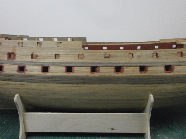

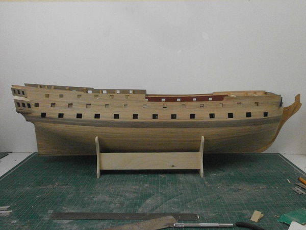

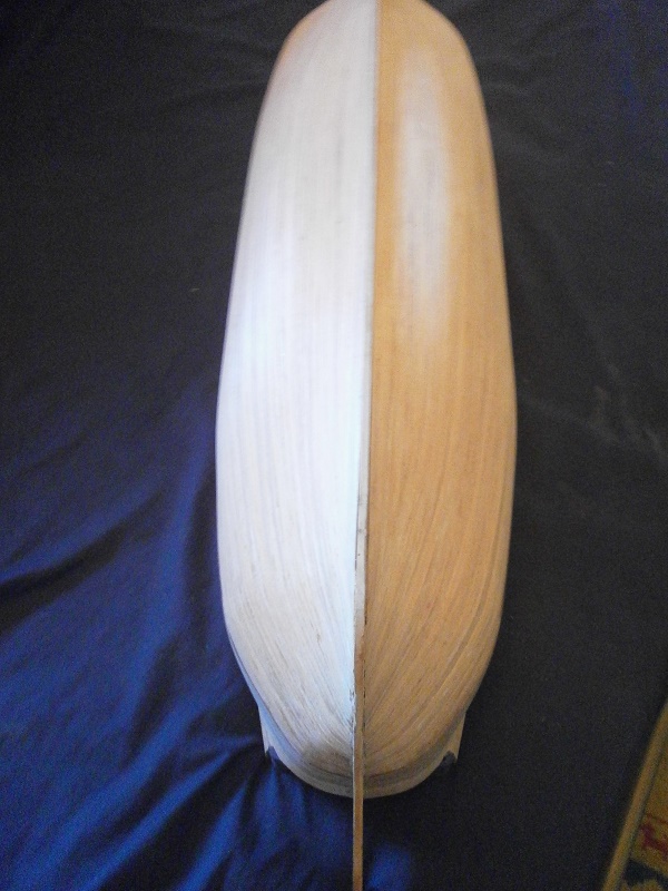

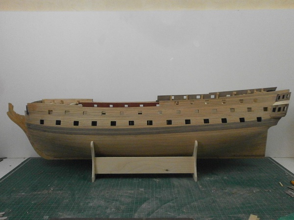

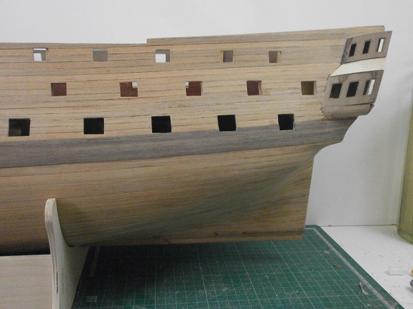

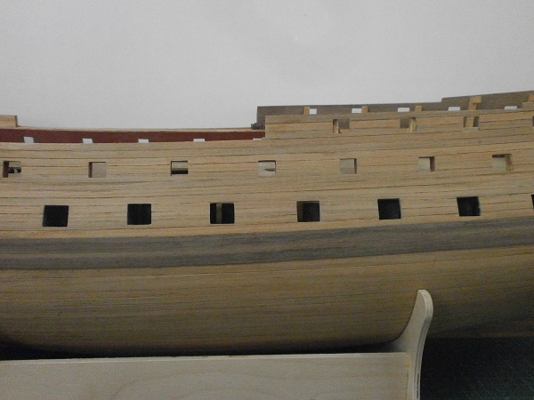

The second layer of planking is now finished and sanded back. I have also added the lower main wale but followed Kieth Juliers recommendation of only using six planks instead of the seven recommended in the instructions, this is because the planks are of varying widths of around 3mm and six planks therefore give the correct size wale. Next its finishing off the gun port linings and adding the upper wale, More soon.

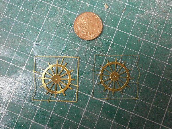

Another addition to the Aggy. The ships wheels as provided are rather nice etch versions but to my eye a little 2D and not 3D as I wanted. They measure at aprox 26mm across and I initially wanted to replace them in wood but the sizes were either 20 mm or 30 mm so too big or too smallCursing Cursing Cursing but I then found some nice brass ones at 27 mmDrool Drool on CMB not perfect size wise but close enough I think.

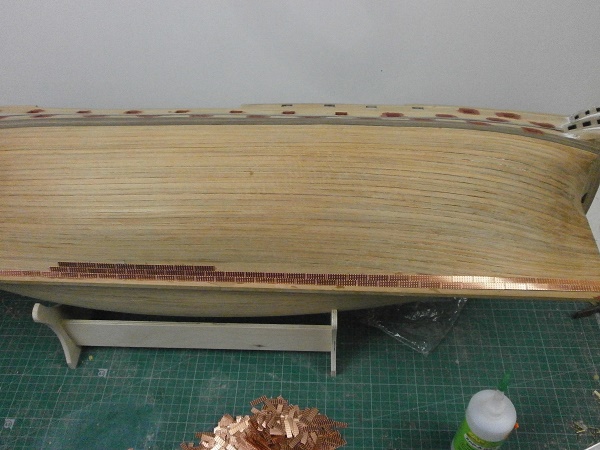

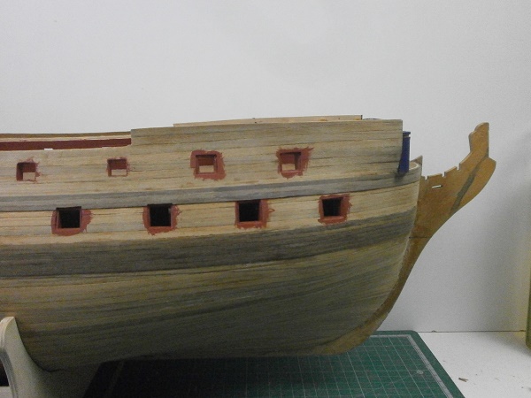

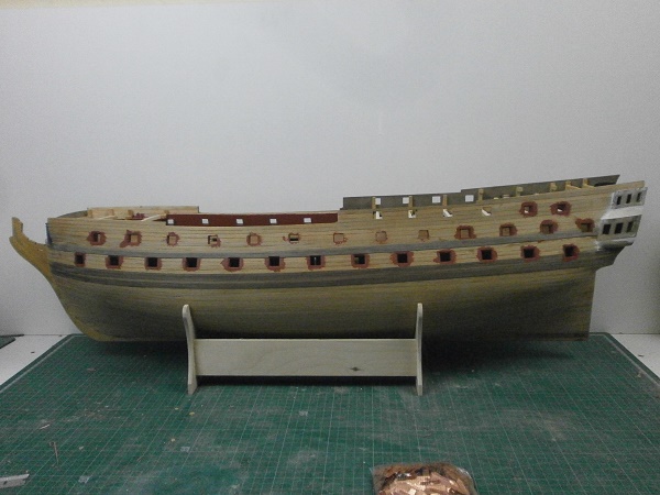

More progress, The upper wale has now been added and all the gun ports that need lining have been lined and painted Red Ochre although this leaves 8 ports on the upper rear deck without liners I plan to thicken the hull in this area anyway when the deck goes on. The quarter gallery's have been tidyed up with a little filler.
The start of the copper tiling now begins and a few have been added 1225 per side Blink Drool LOL. More soon.
