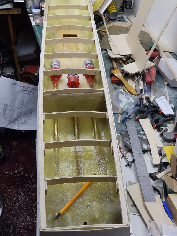

BigGrin Quick update the lower deck has been cut to size now its shaping and the inner access cutouts to work out.Cool

After cutting out the main deck it was marked out and cut to shape so it fitted in the 2mm gap above the side stringers and the hull sides. Once the deck fitted properly it was time to mark out the access hatches so I can get at the gear inside the hull then cut them out by hand.
The next thing I did was to set up the rudders for a three steer assembly from one servo , I could have waited until later to do this but there was more room without the deck being in place to get the set up right. Now it is set up it can still be removed but all that is needed now is some tweaking.
Next the cross beams were fitted in place along with the two rows of deck supports between them and four centre cross beam pieces removed for access. Then the deck was glued in place using 30 minute epoxy. Next its the forward deck then deck furniture. More soon.
