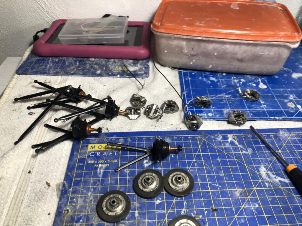

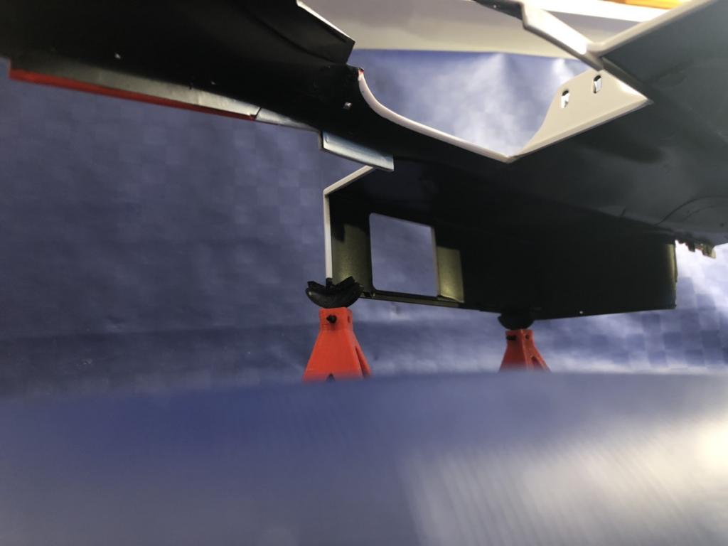

I'm just oredered the Museum COllection decal set for monocoque e e nose cone
I've dismantled without any damage the monocoque from the engine/gearbox.
I also took apart front suspension and rear side pods of gearbox.

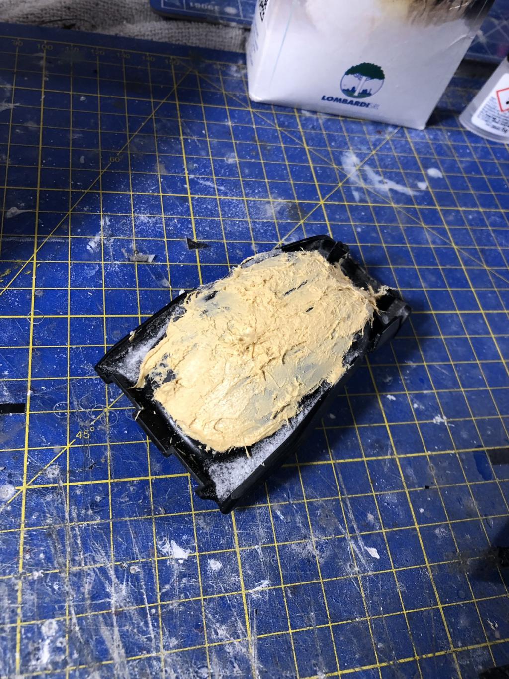

I started to fill the monocoque in the headrest zone and rear zone and i filled the nose cone
I sanded the iniecjton point on nose wing, front wing flap and rear gearbox pods.
My intention is to carbon cover all the monocoque and the inside of bodyshell.
frah2o
#123 Posted : 13 September 2019 08:26:37
Joined: 05/04/2016
Posts: 720
Points: 2,163
Location: Ferrara

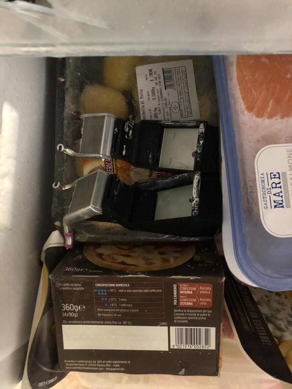

I've tried for the first time the ciano degluing with freezer. I separated interccoler and radiator from ducts without damege. So i can carbon the duct free of any other parts

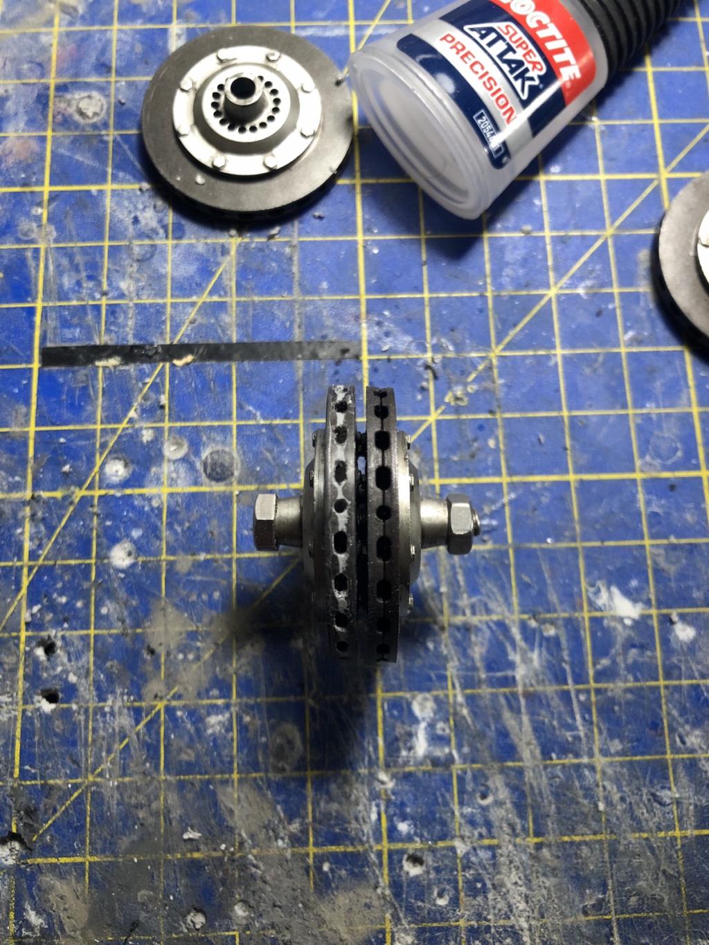

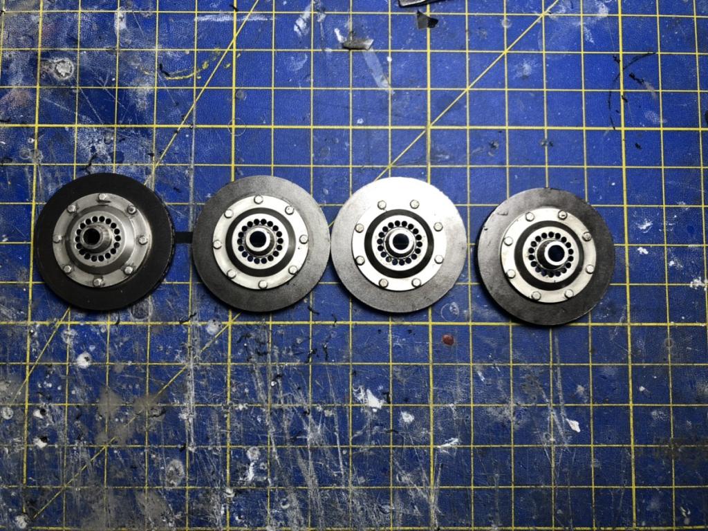

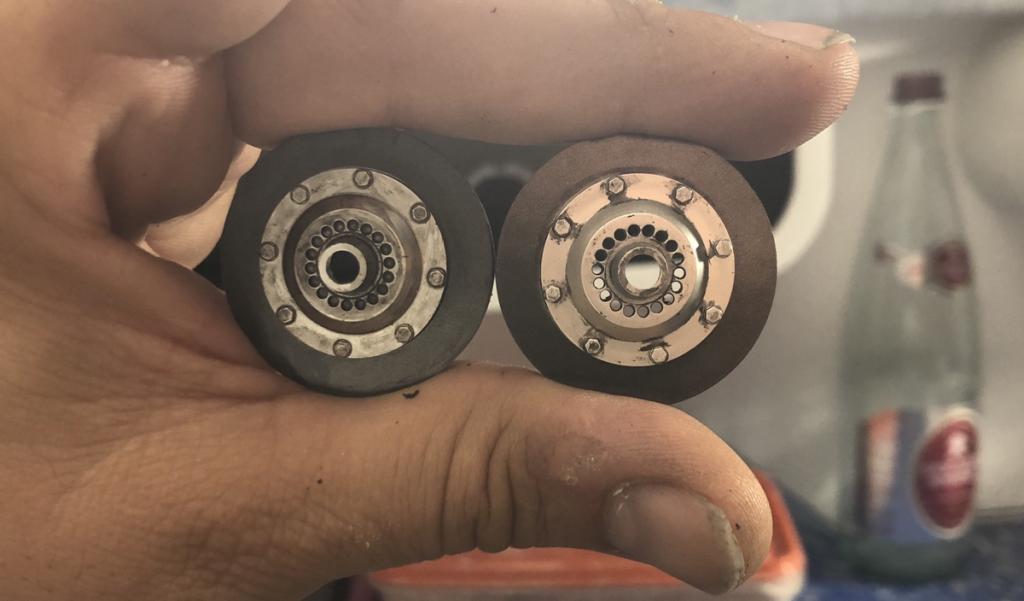

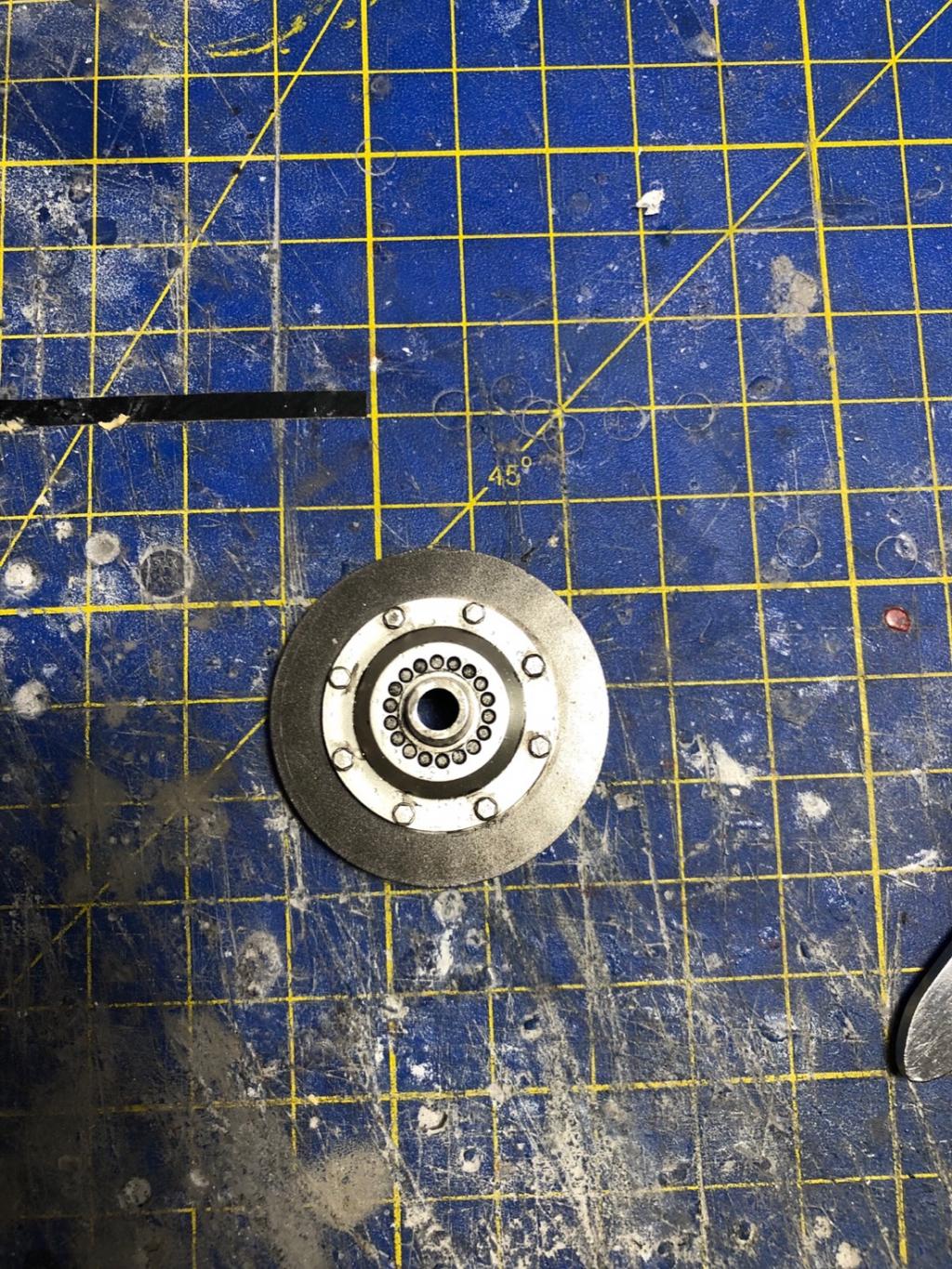

Once i have disassmbled the caliper, i stated to work on discs.
I holed the central hub and started to filling the disc
I'm also traying to harden the rubber seat for futur carbon

Iìve finished the work on brake disc (all filled)

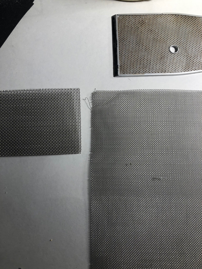

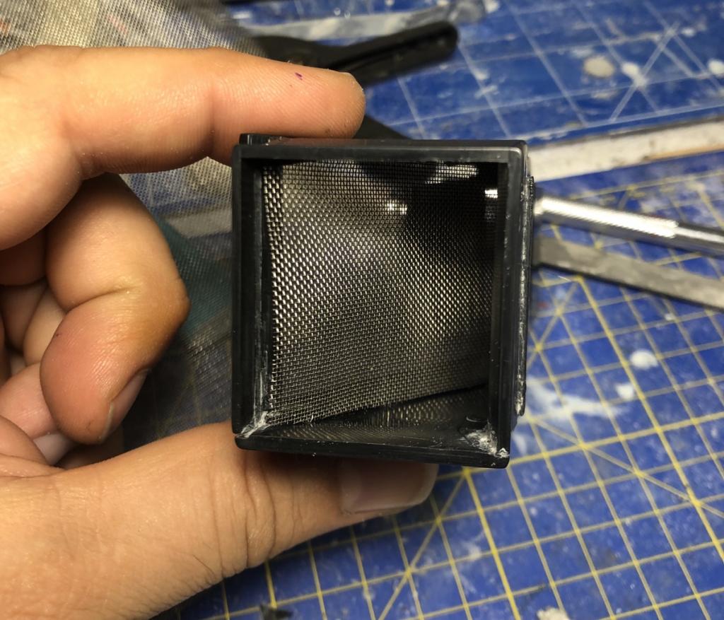

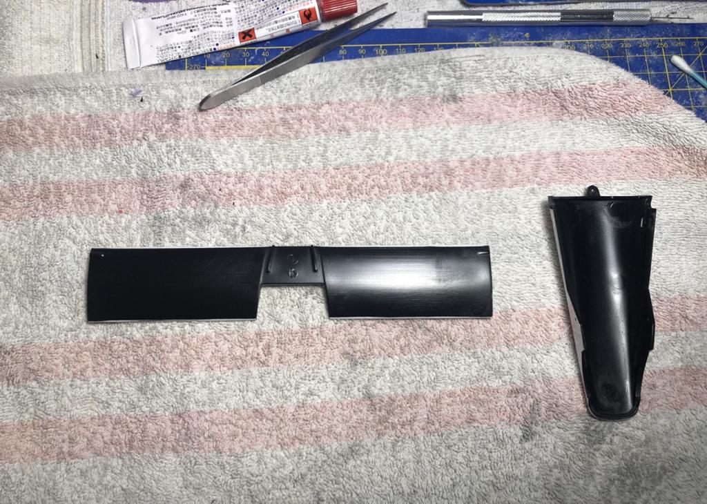

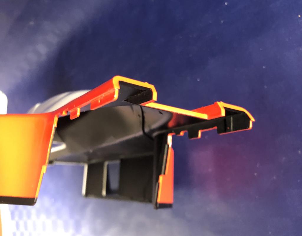

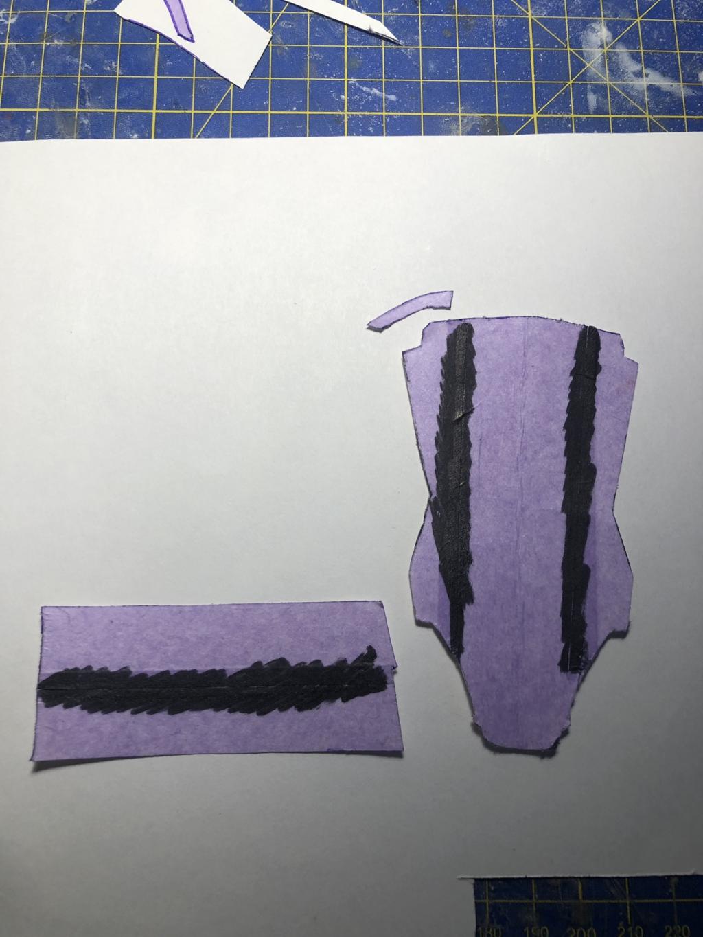

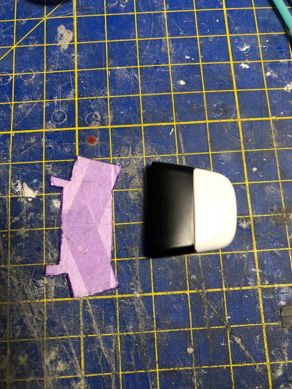

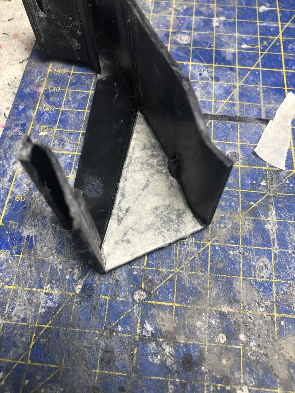

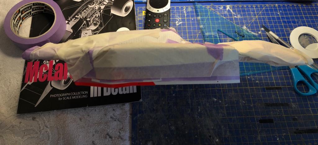

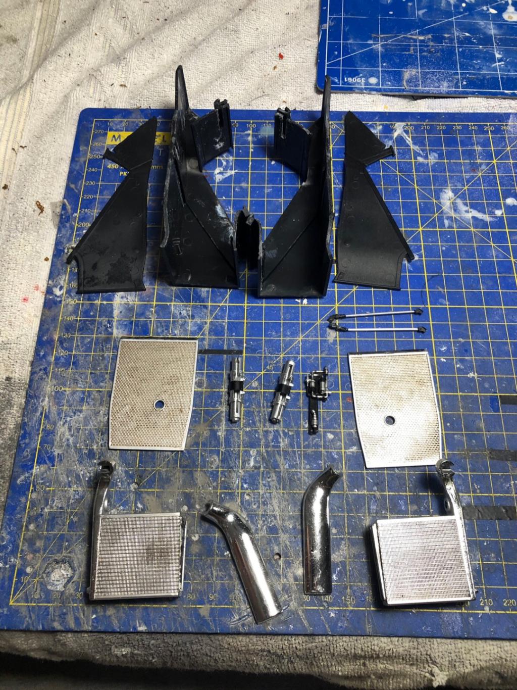

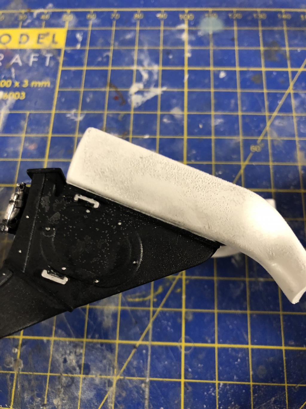

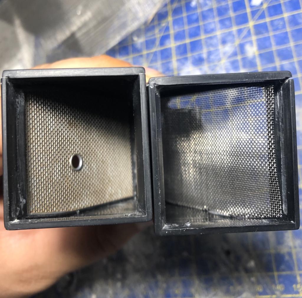

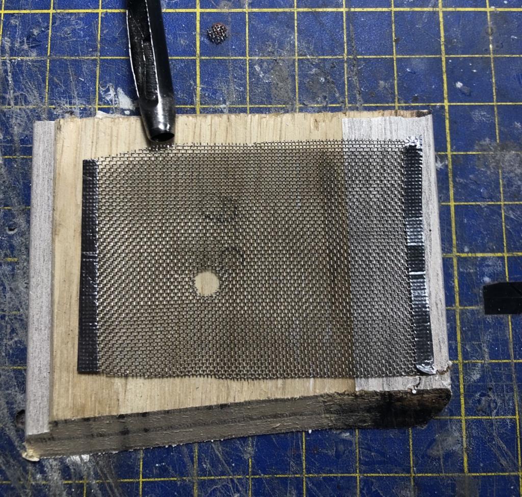

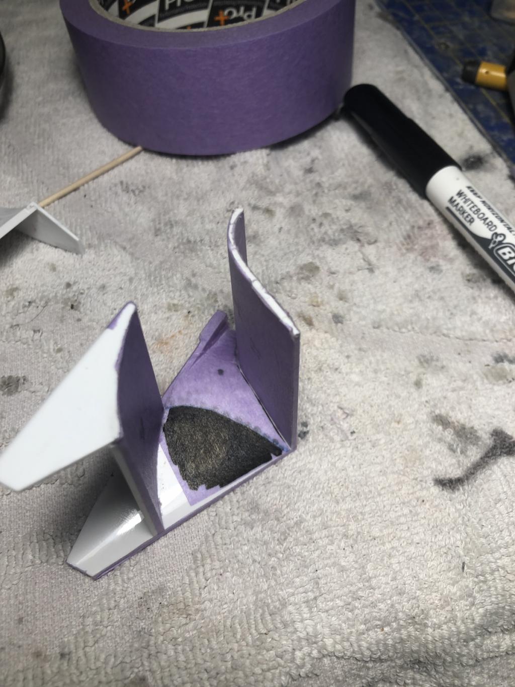

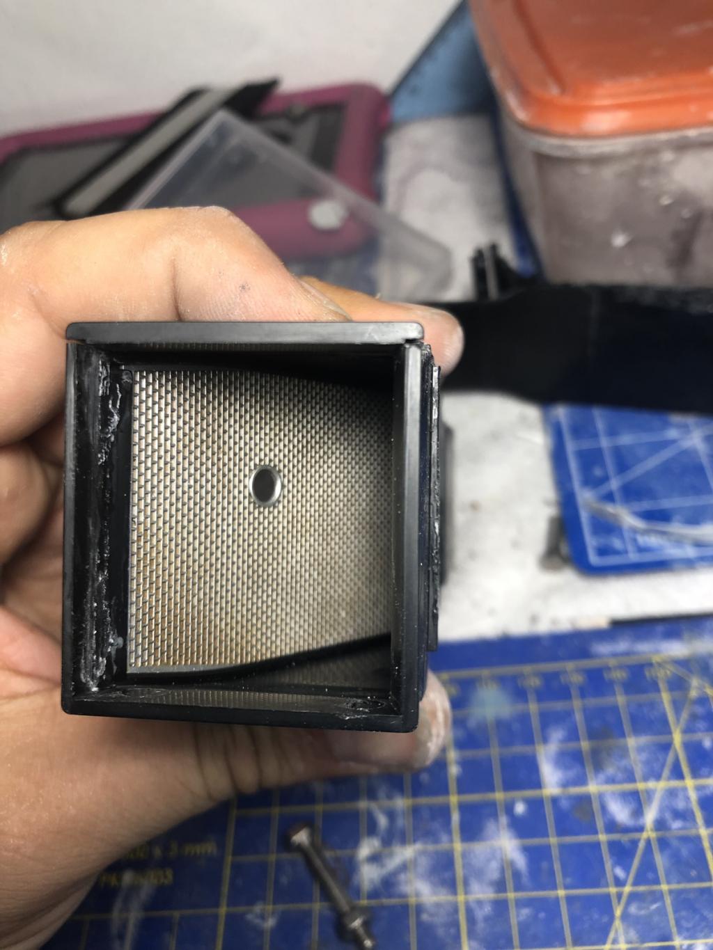

Then i stated to work on radiator side pods. They're in 2 parts, but i wanted it "monolithic"

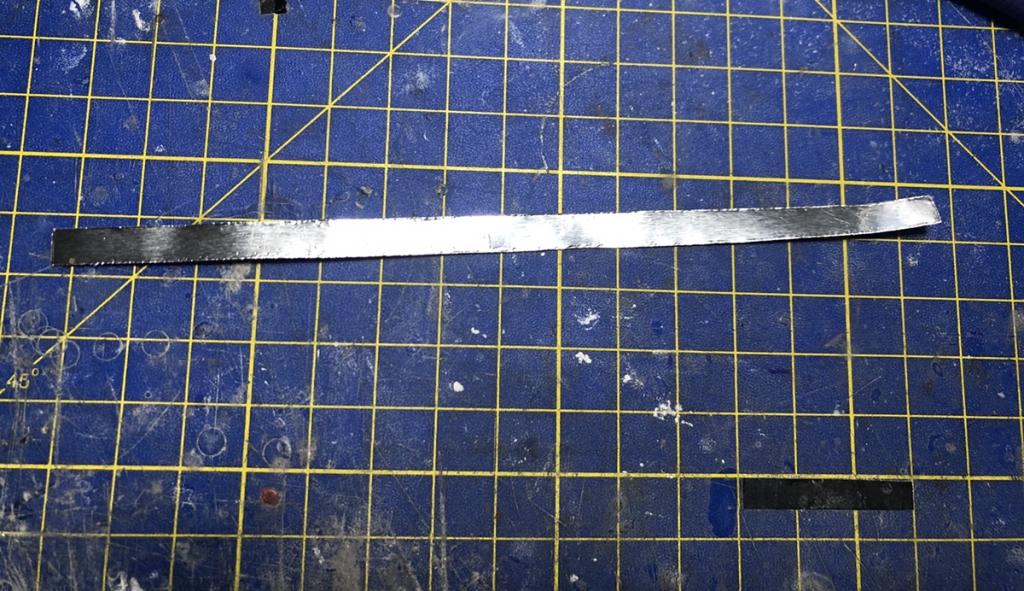

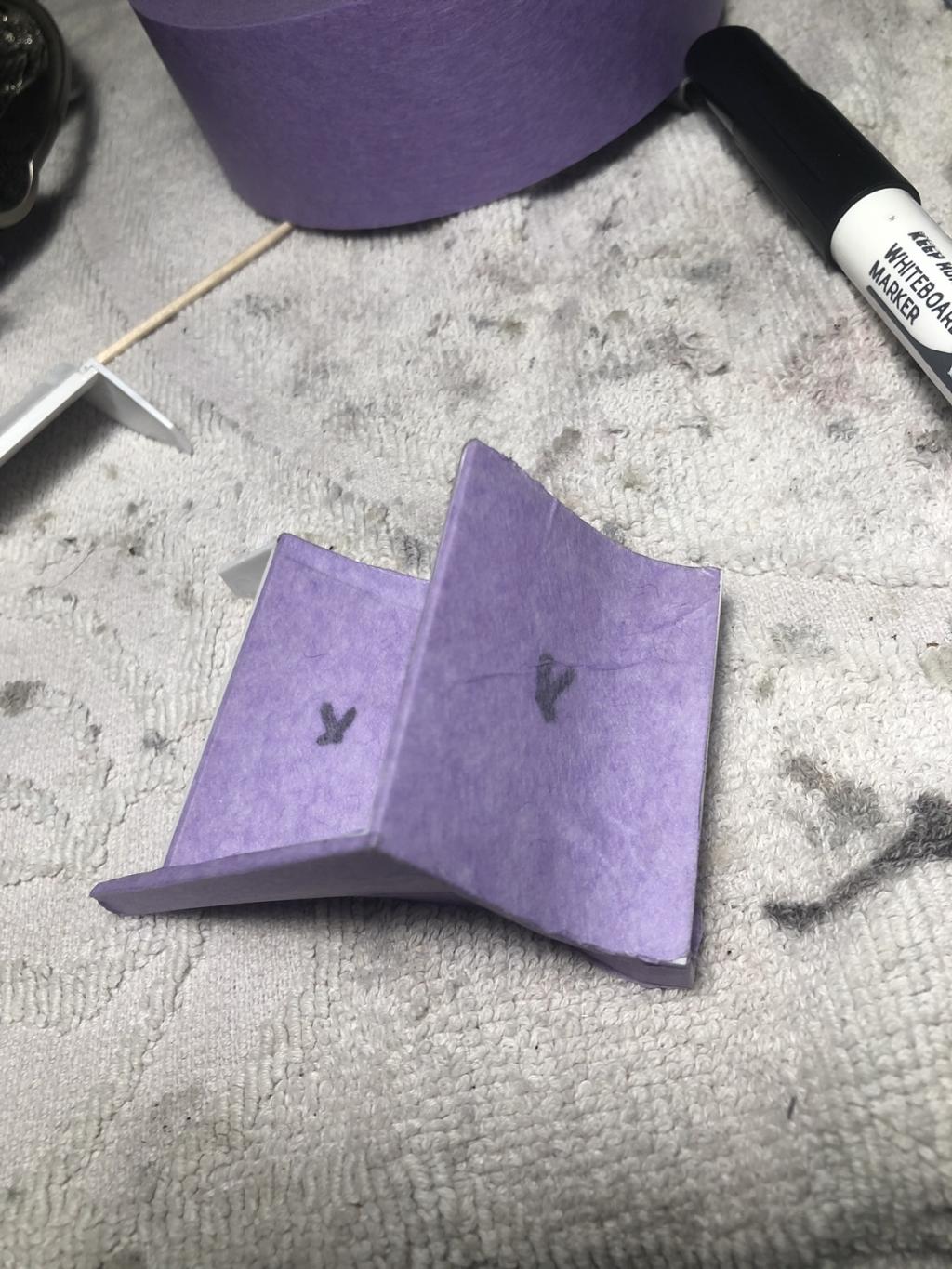

Before to "weld" them i made the self template for future inner carbon decal, the i glued with ciano and fixxed.

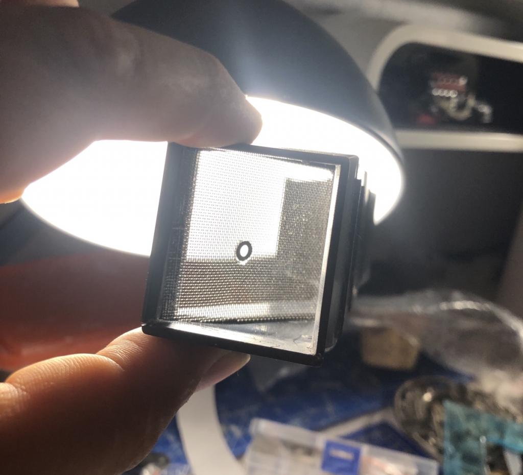

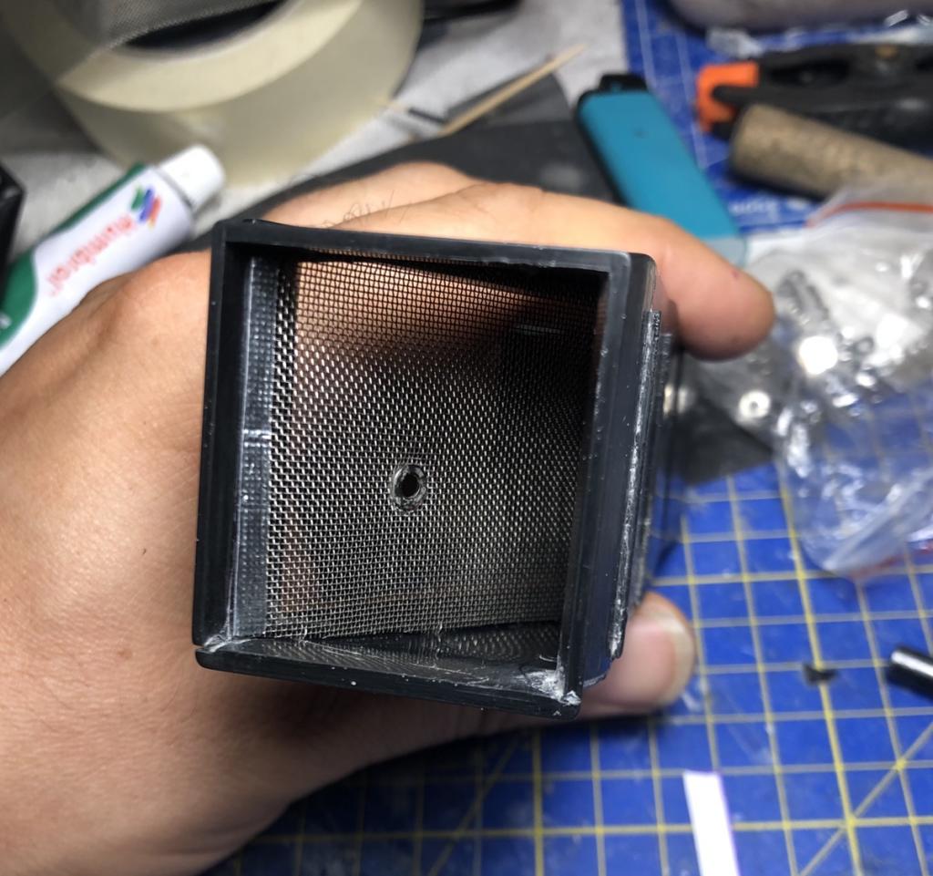

The problem to of this job is the plastic blanked mesh.

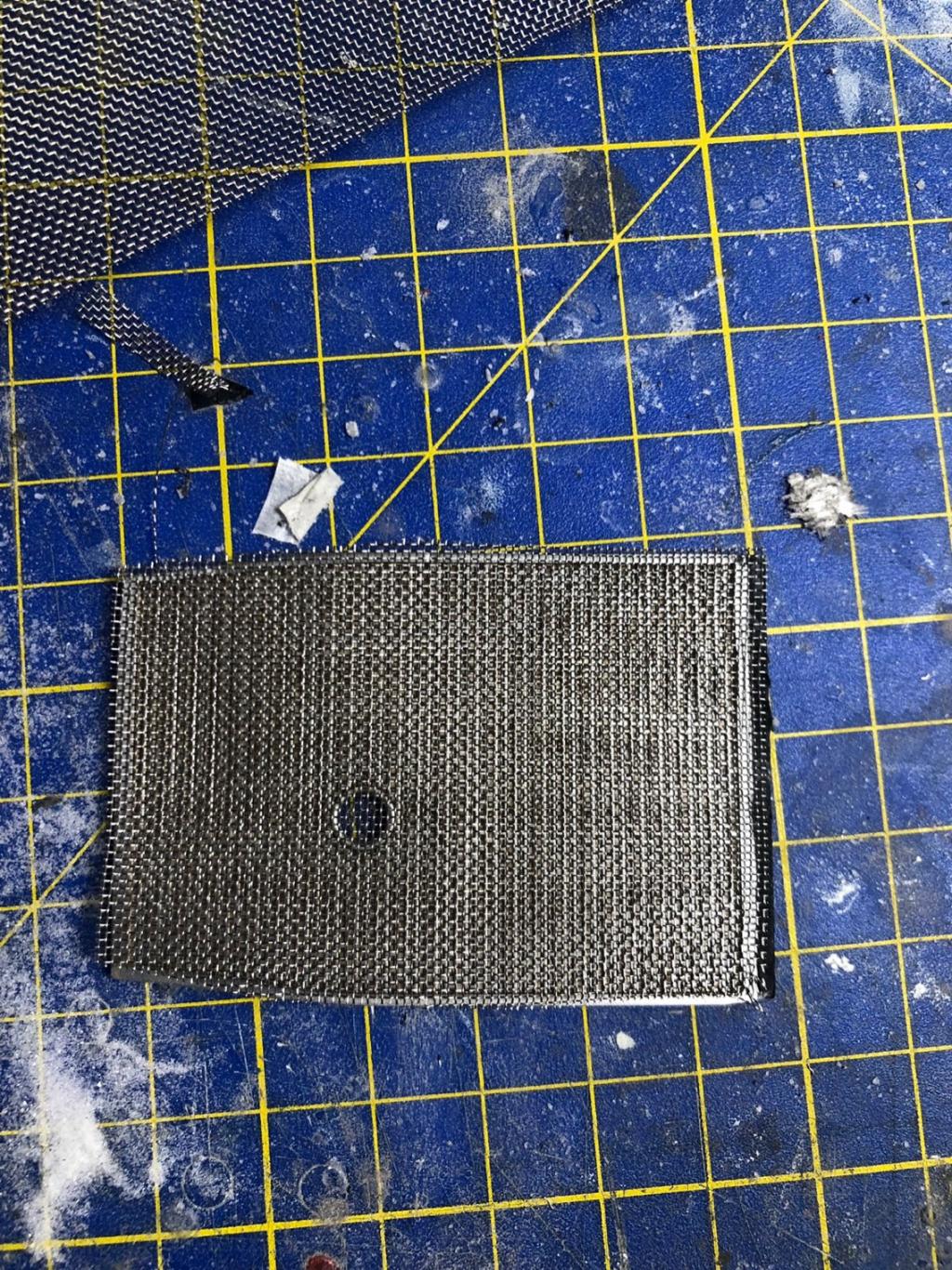

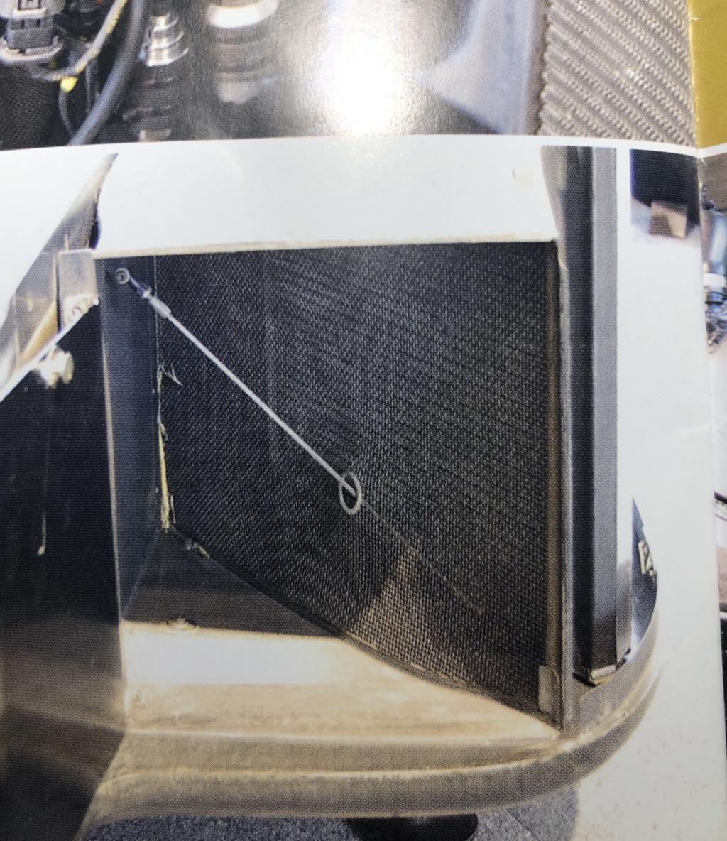

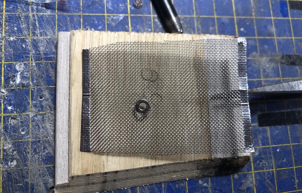

As I seen on references and R1M (Malc) Diary i tried to selfmade the metel mesh as 1:1 MP4/4
I made template and i cut the shape on metal mesh. I added bare metal on mopunting side, i made hole and added a washer for the fitting of tie rod.
I think that is a better view tan original plastic mesh

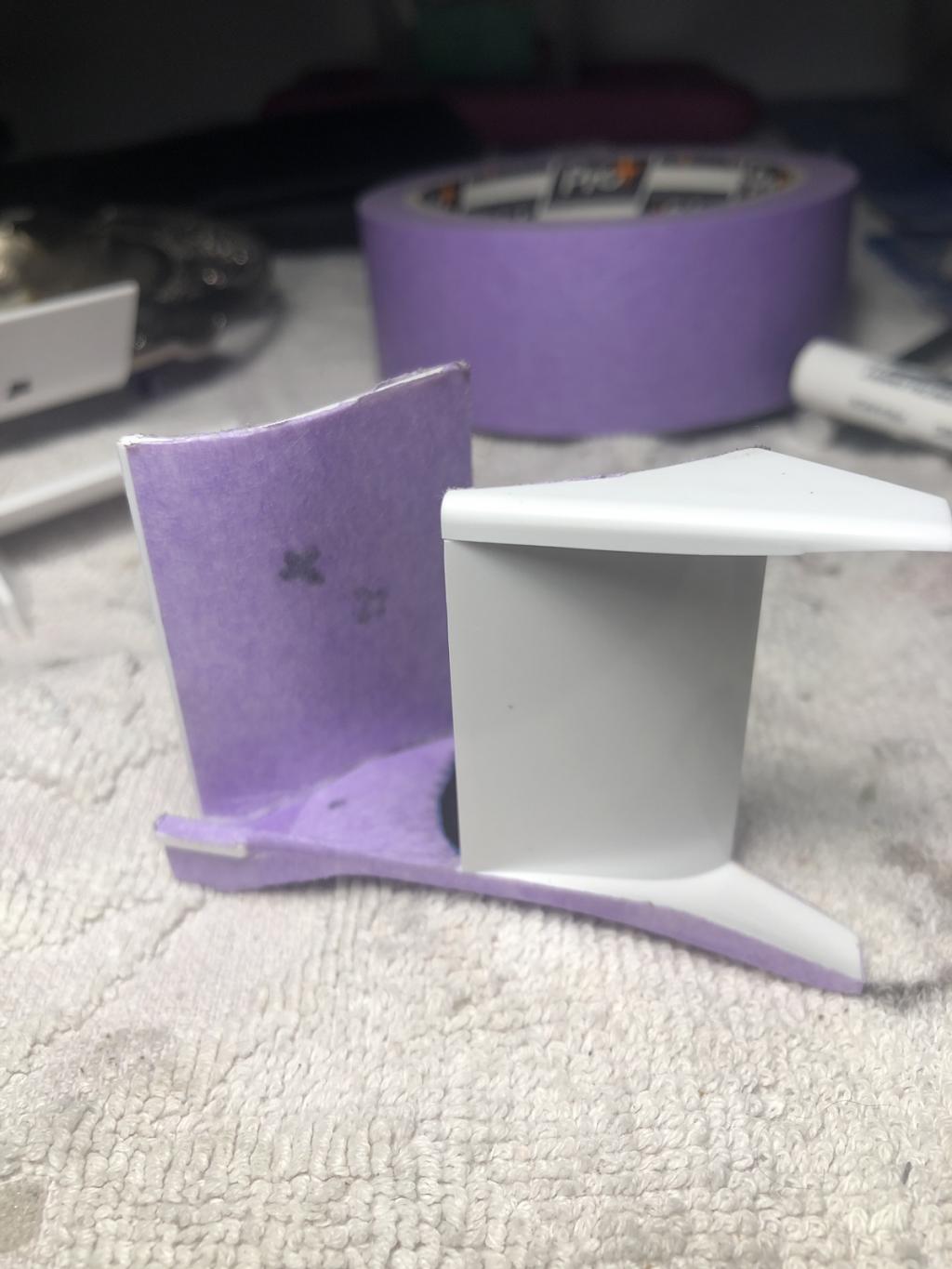

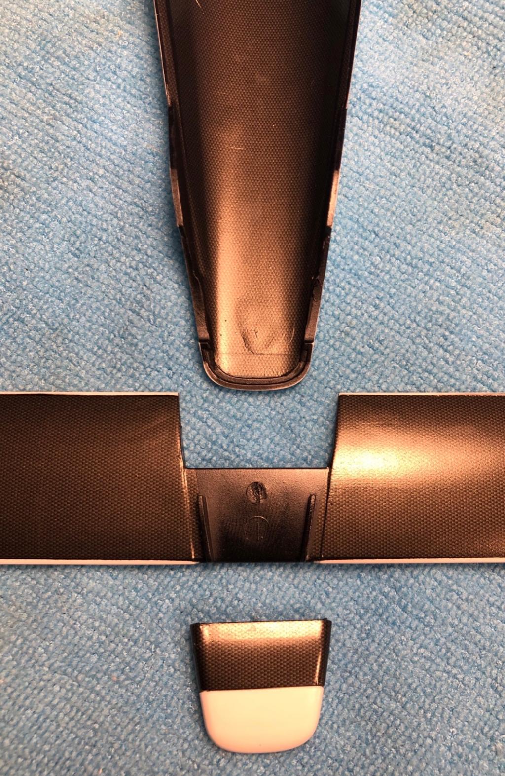

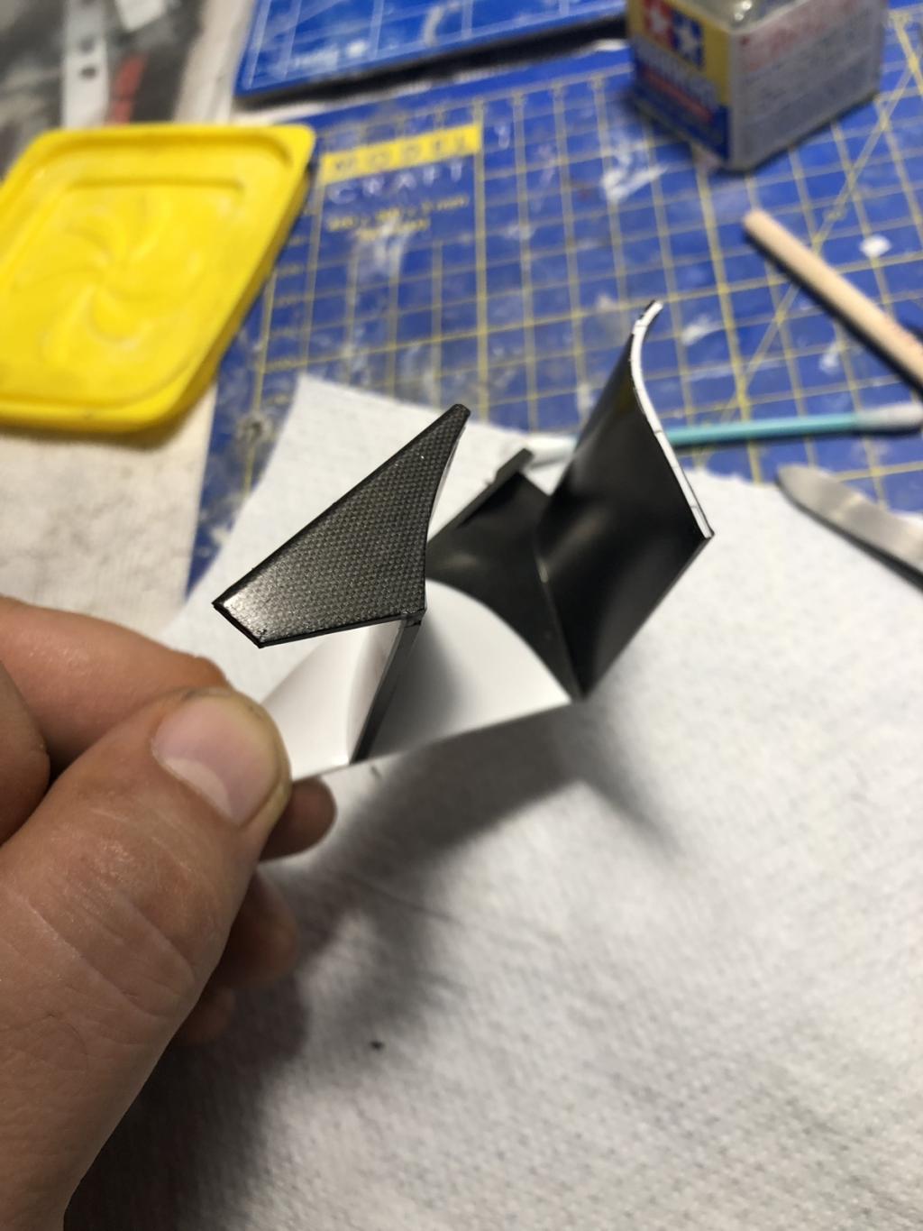

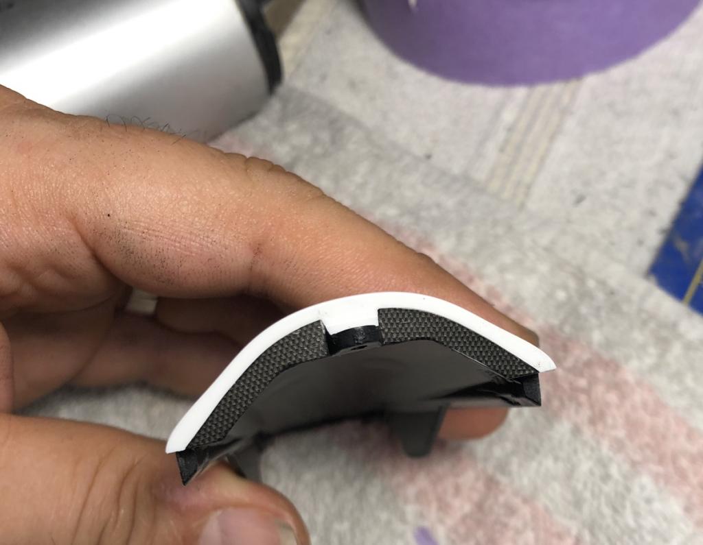

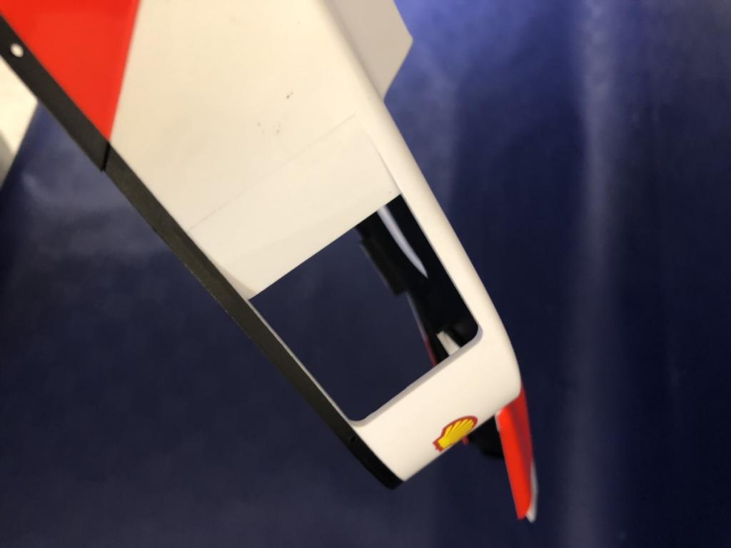

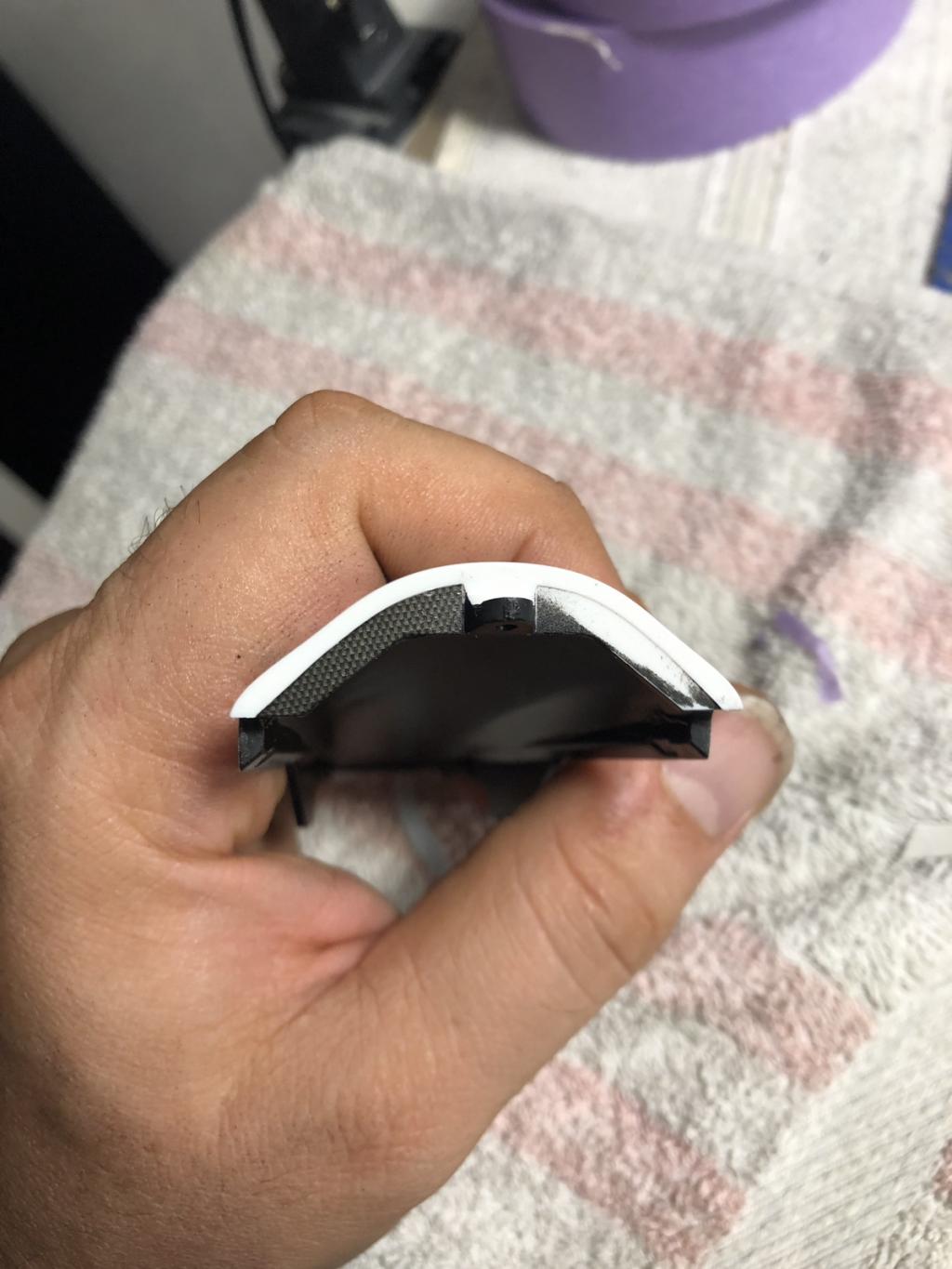

I've statrted the carbon work on front nose.
When I tryed the fitting I saw a mistake. I forgot some carbon in the central pillar of dront wing.
I've just added the missing decal (I'll made a pics in the next post)

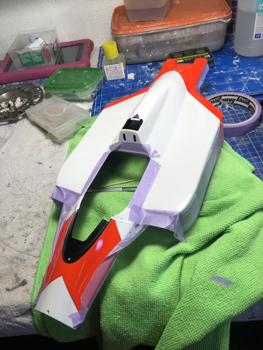

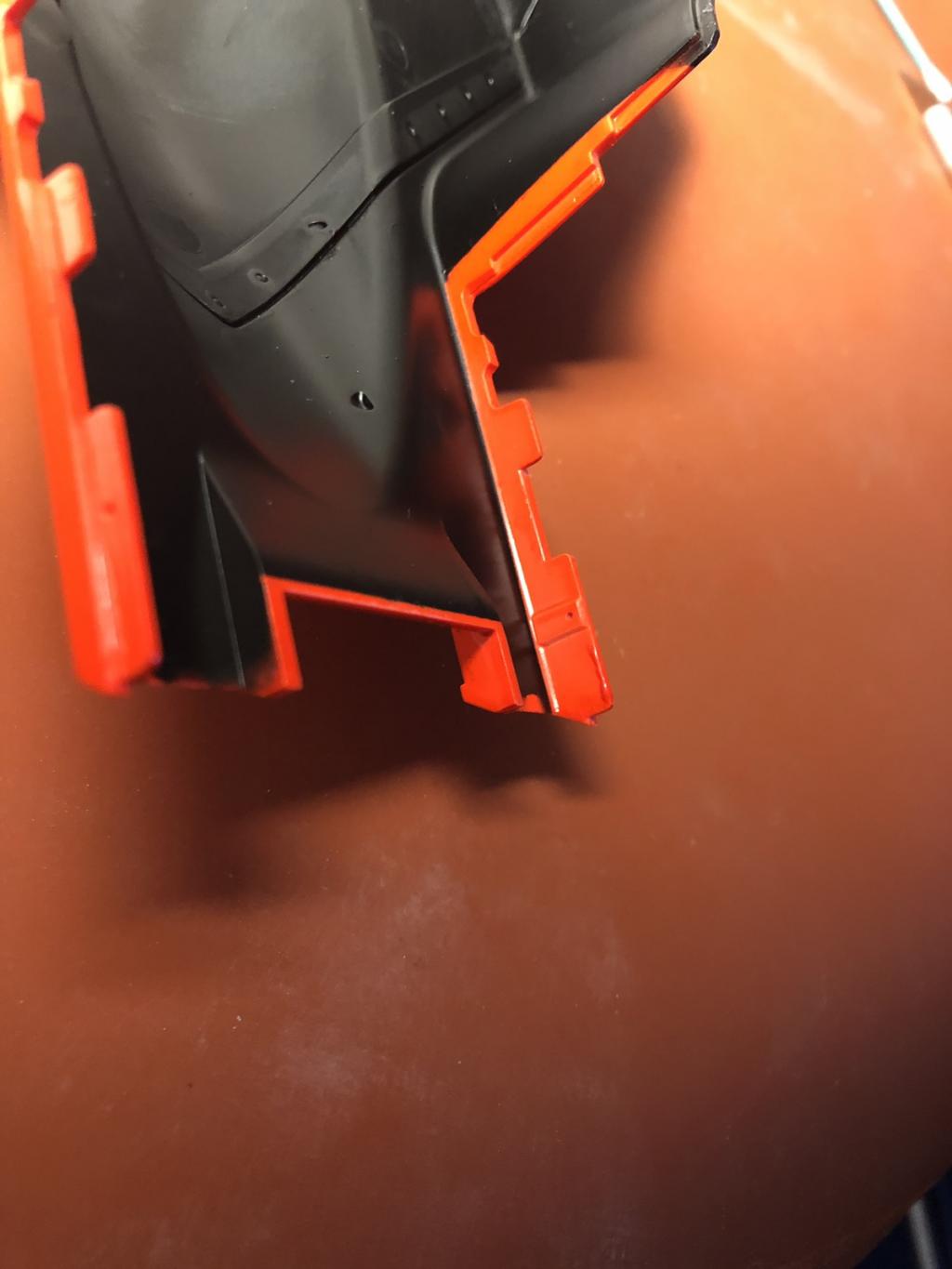

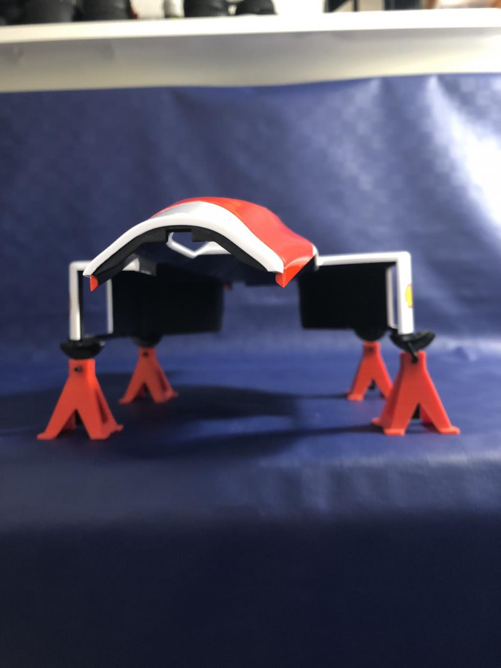

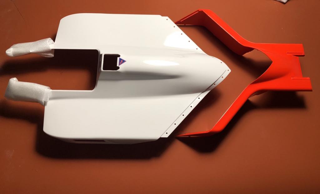

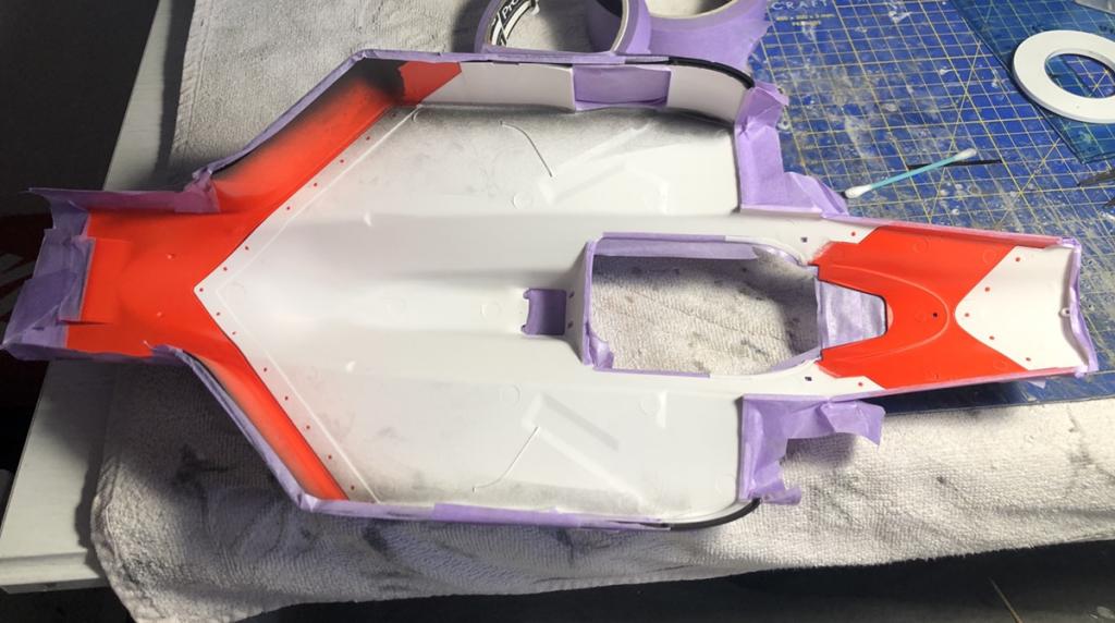

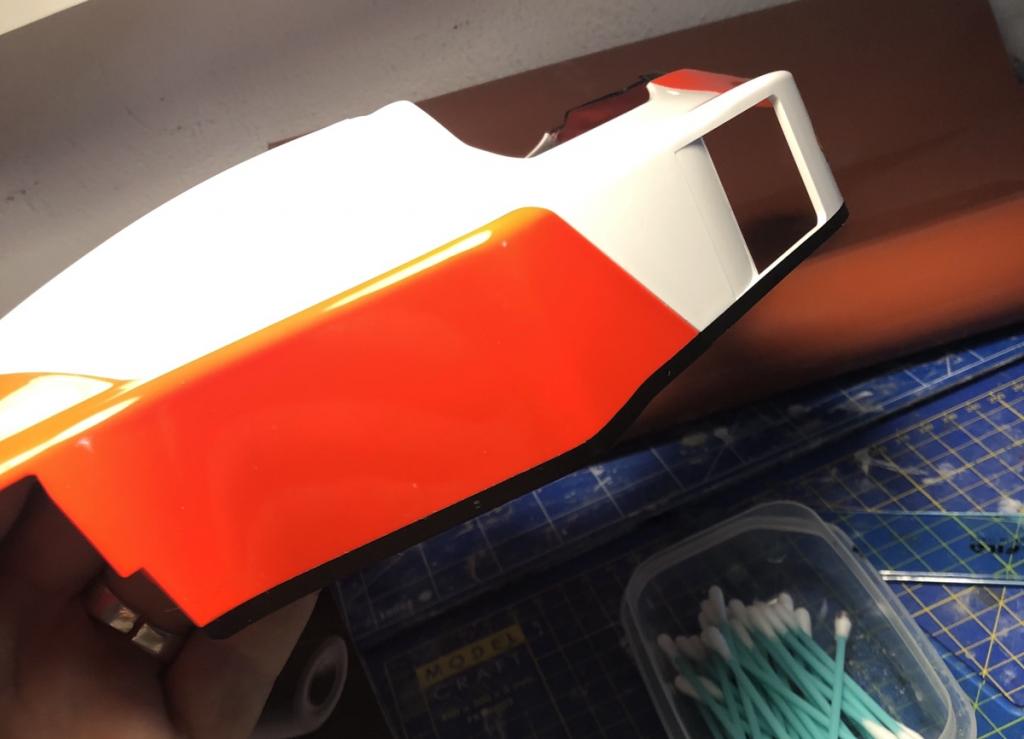

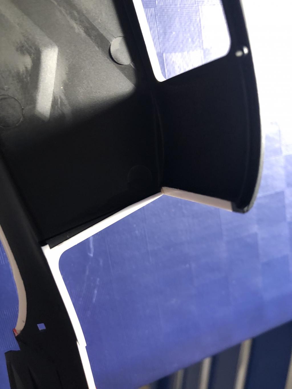

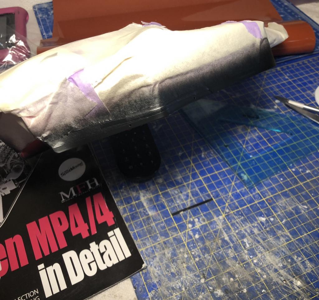

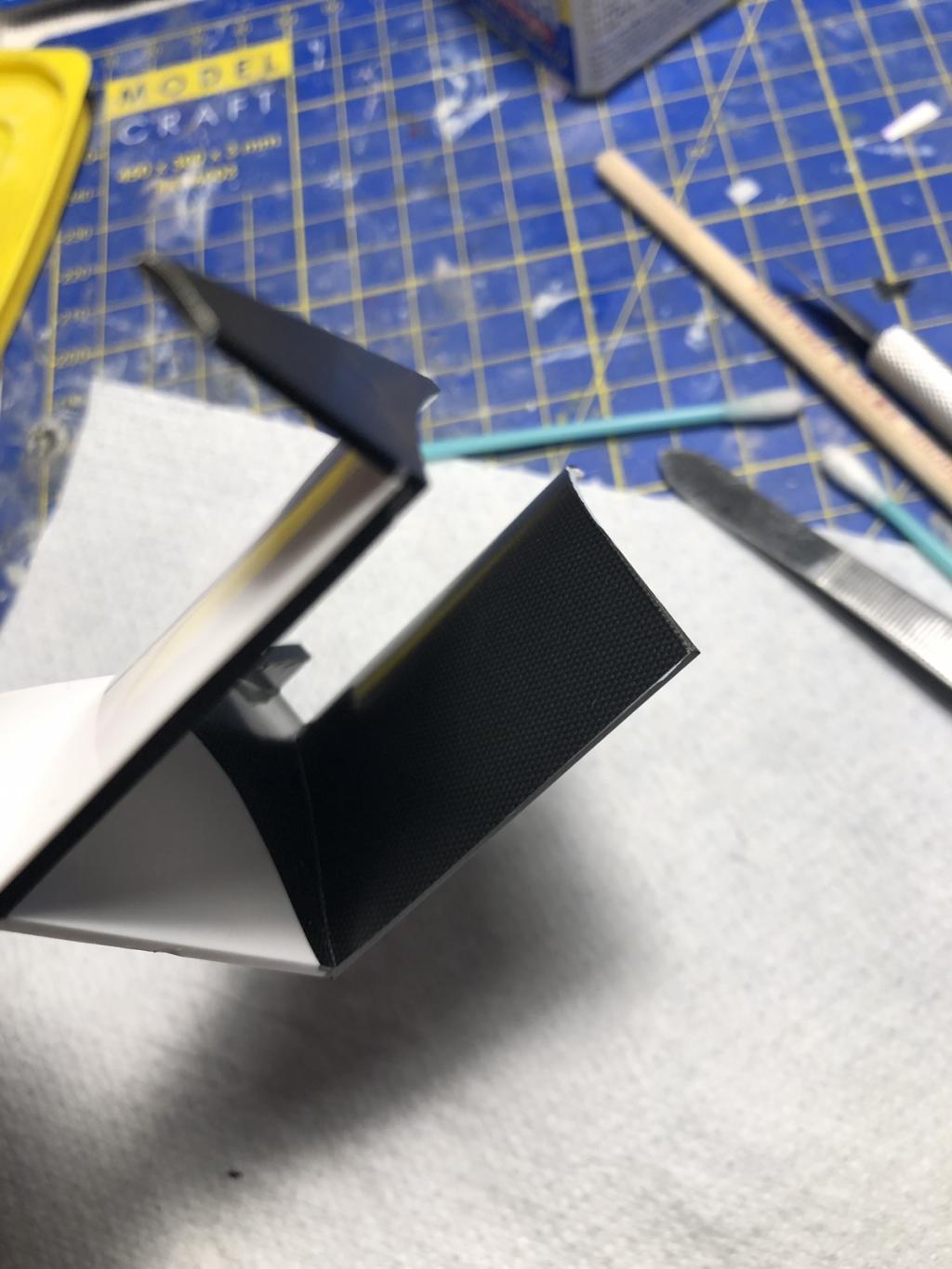

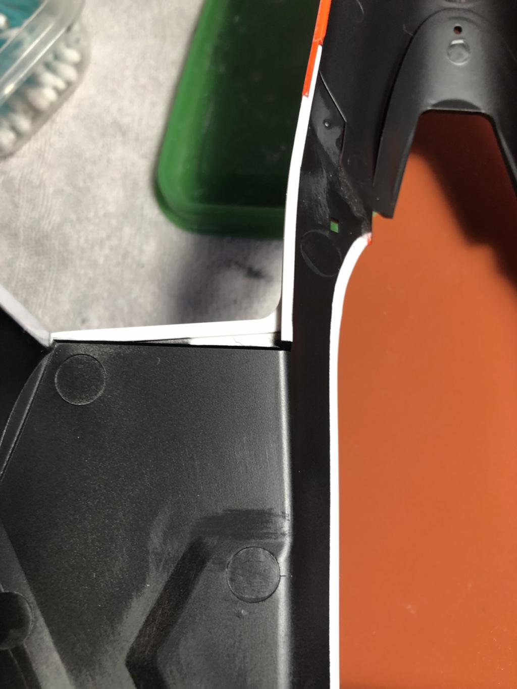

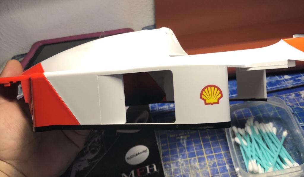

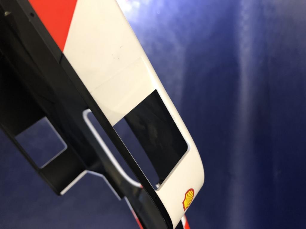

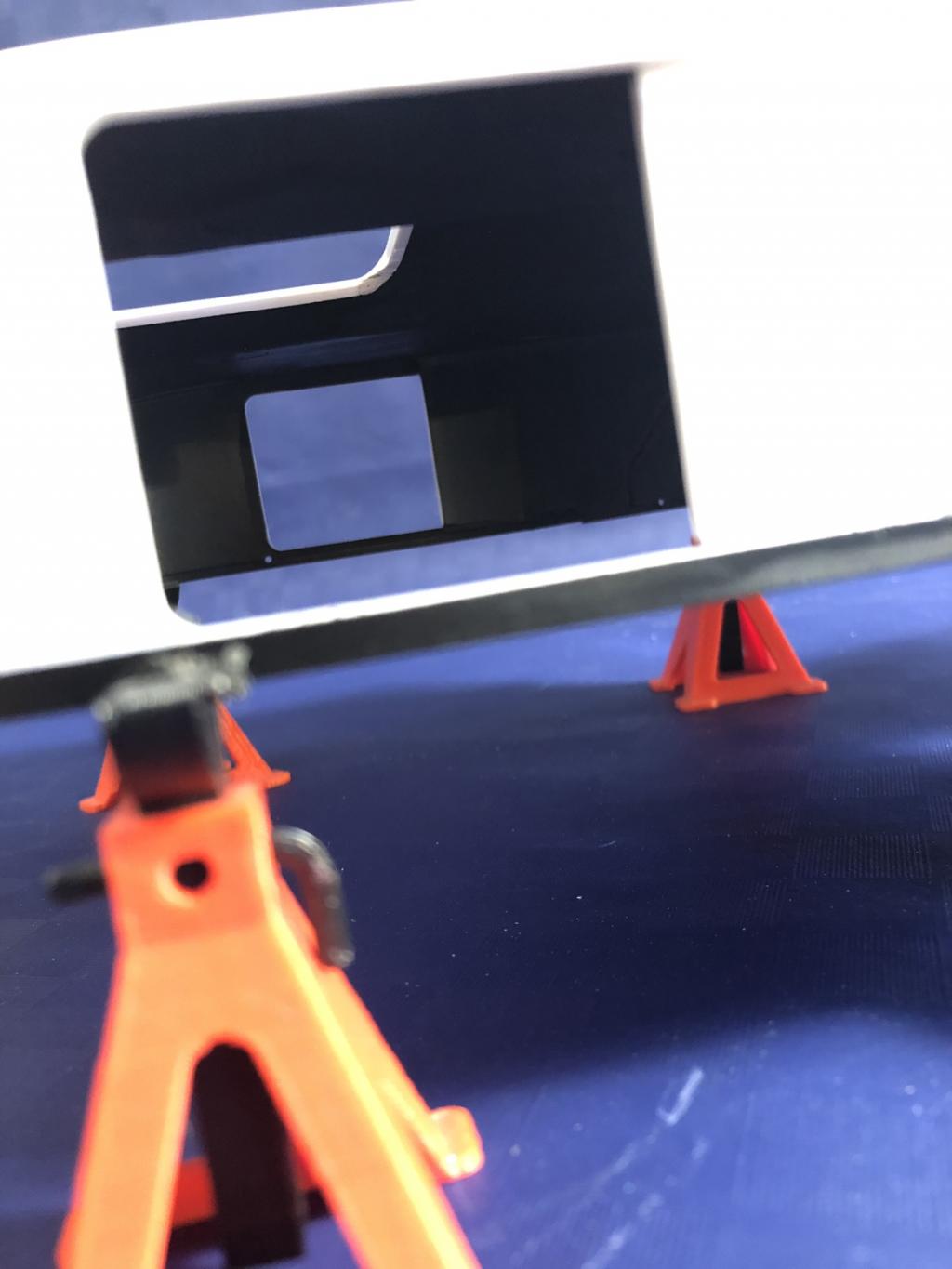

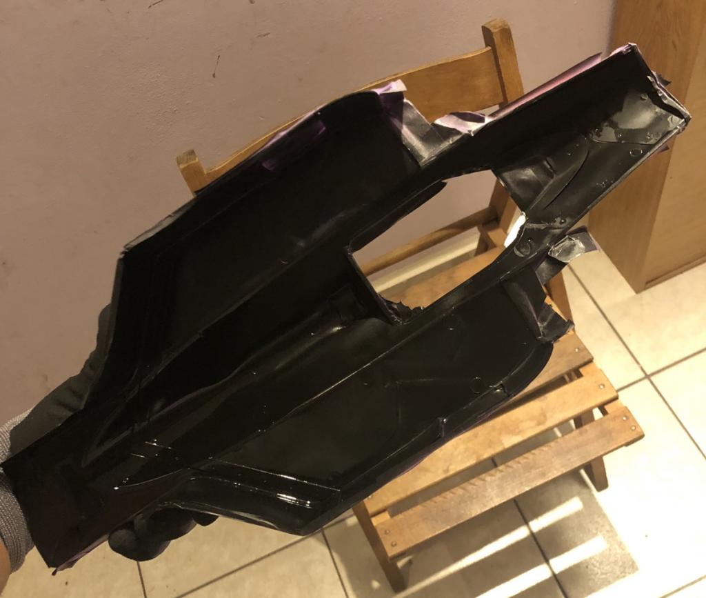

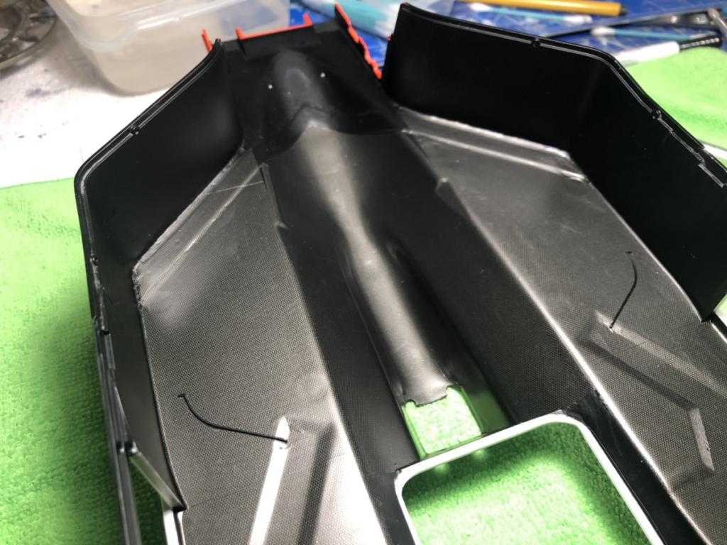

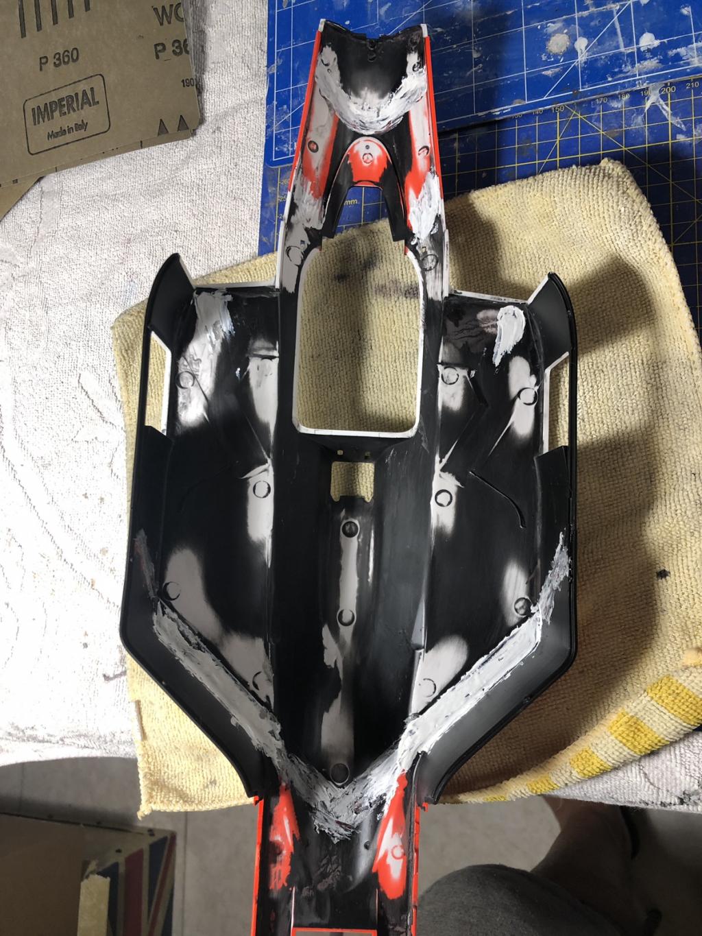

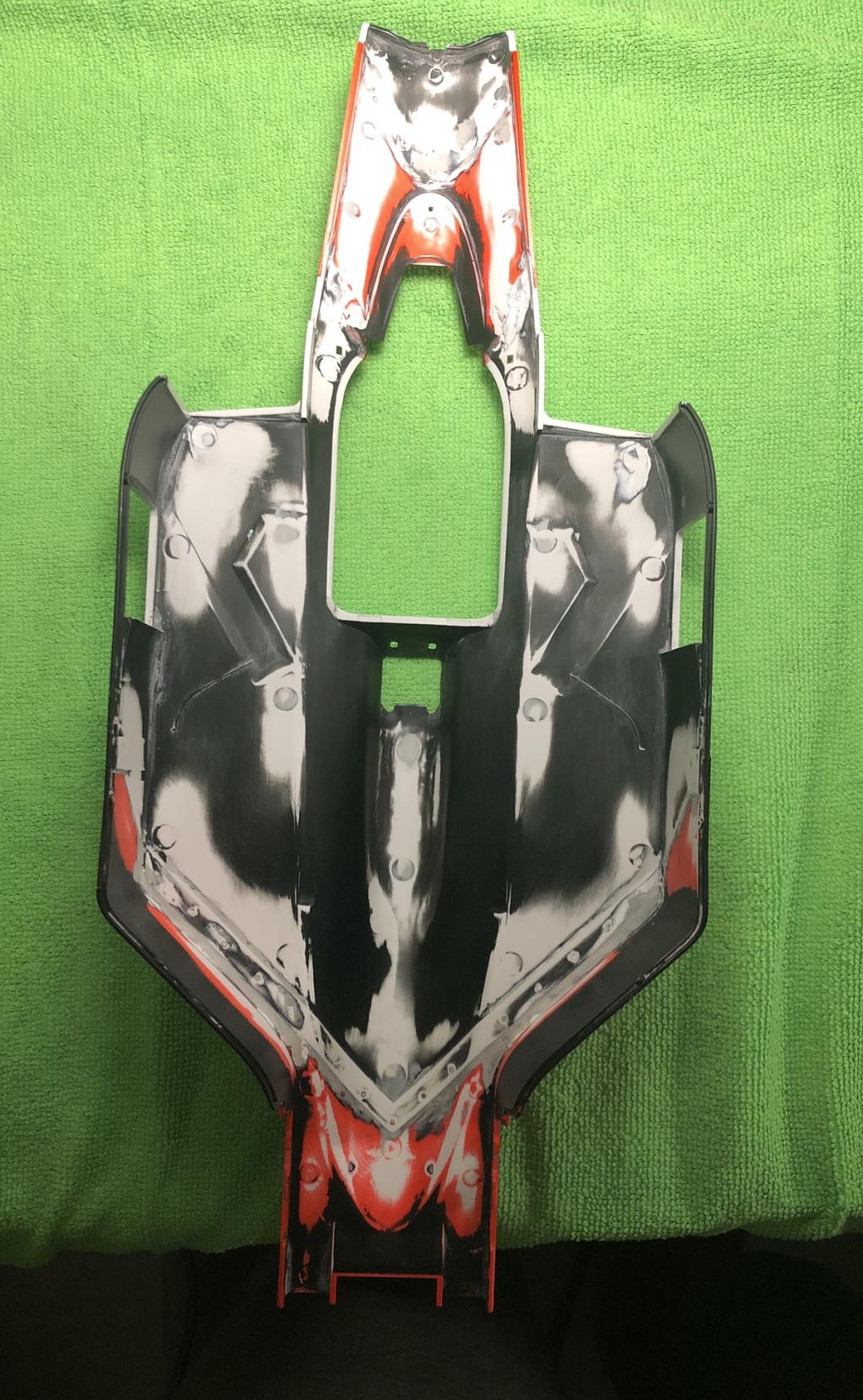

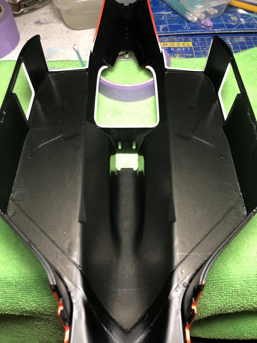

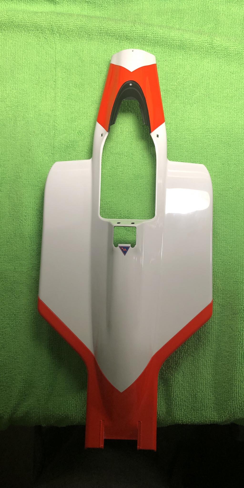

While i'm waiting the decal from Autograph, i've started to work on bodyshell.
First work is to piant the under outside black stripe.
I'also paint the inside of bodyshell in balck matt to have a future color base for carbon coating.

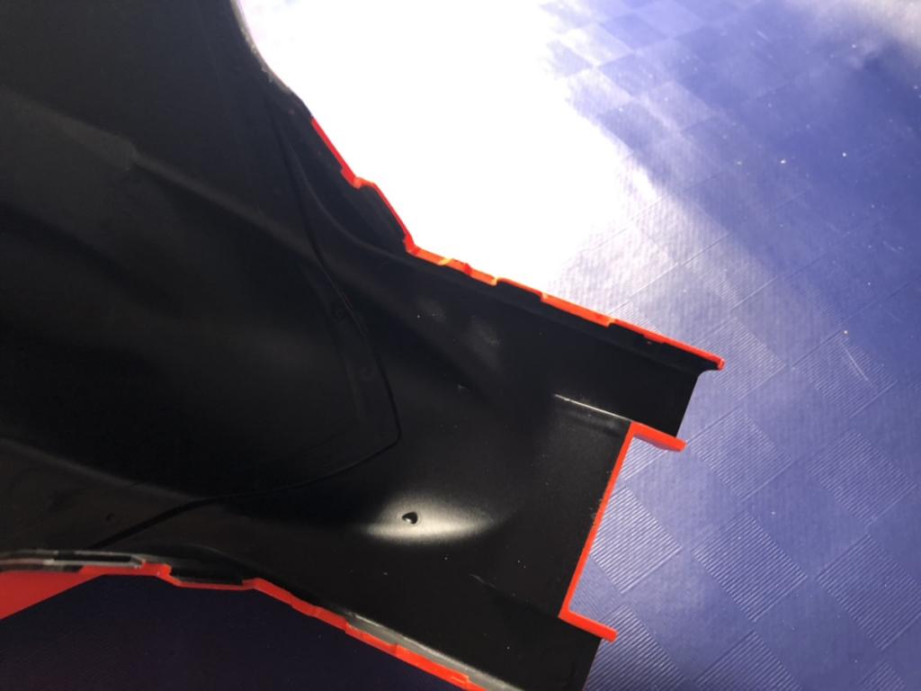

At the aend of the work i was not satisfied for to much visible injection point and the junction point of the bodyshell.
So i started to sand and fill to remade a little bit smooth surface for carbon.
frah2o

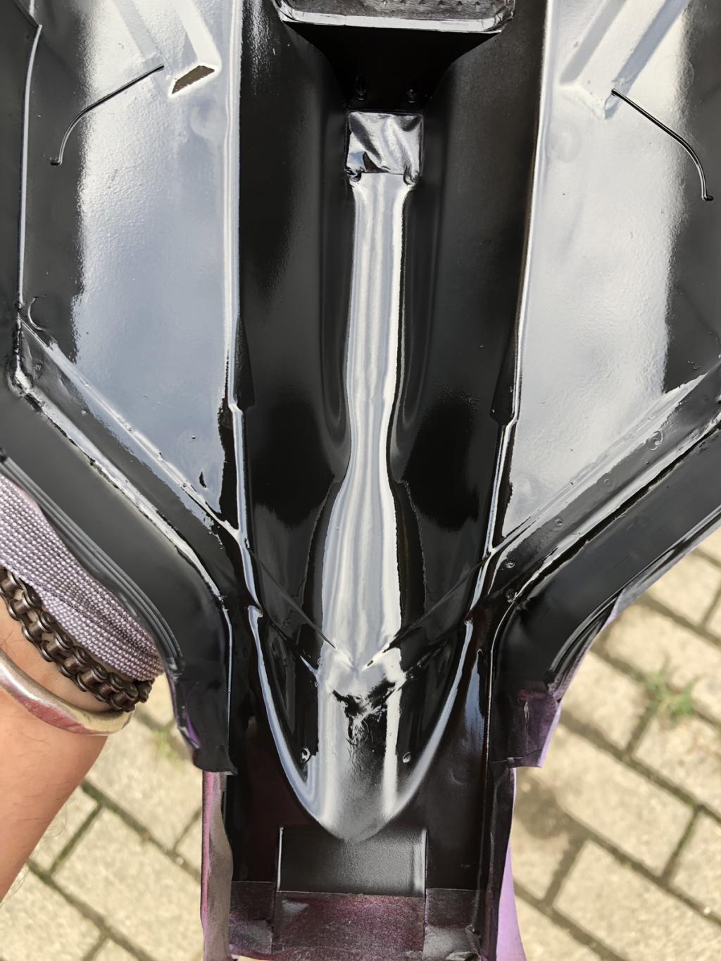

Re sanded and re filled the inside of bodyshell to reach a smoothier surface.
Fortunately the external of body is mint

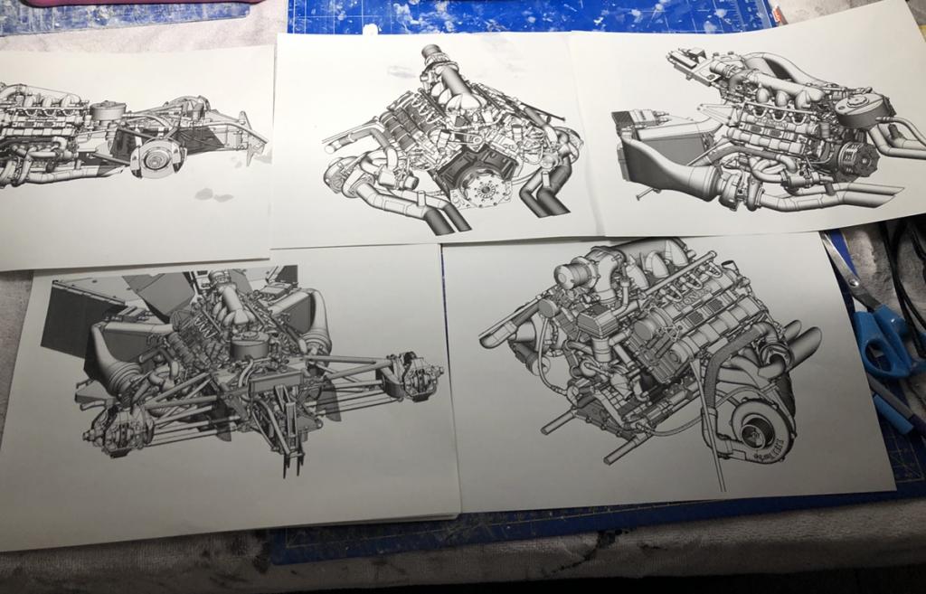

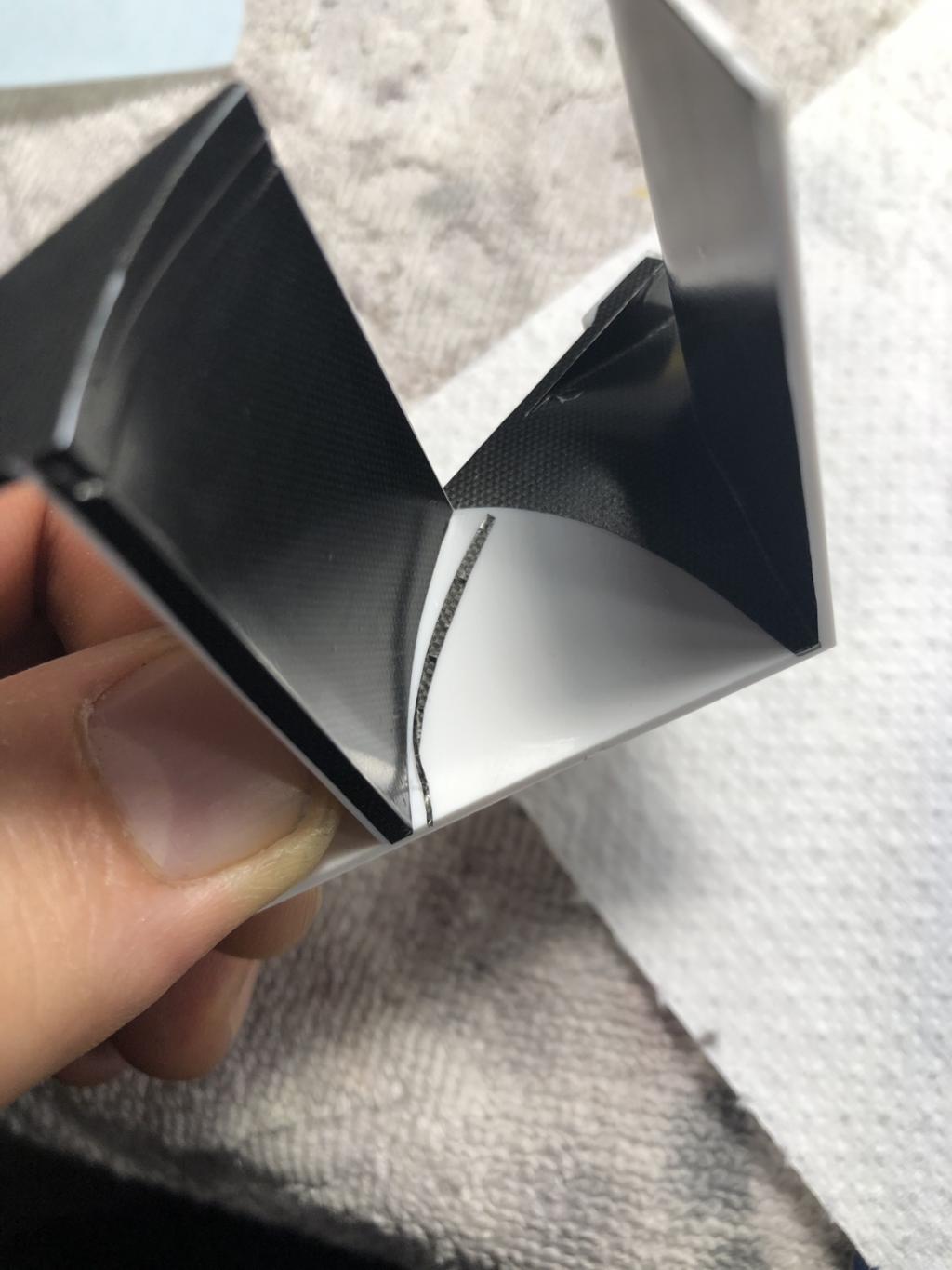

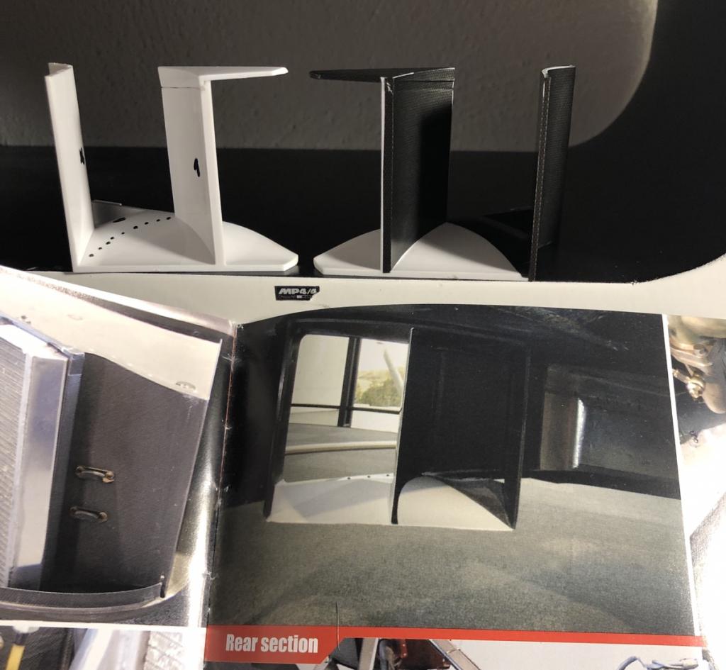

I started the carbon work on cooling body duct, i followed the refernces images on mfh book
I also took the Haynes mauals for Mp4 to have more refrences pics
I also find on the net the technical pics of MFH model, they'll help me with future lubrification and cooling system
Tratto dal mio libro references MFH
Da amazon.it

I started the carbon work on first body duct.
I took an 1/32 carbon decal to reach the extra fine effect on radiator duct on monocoque.....before to fit i'll made some expreiment with color base and final clear coat.

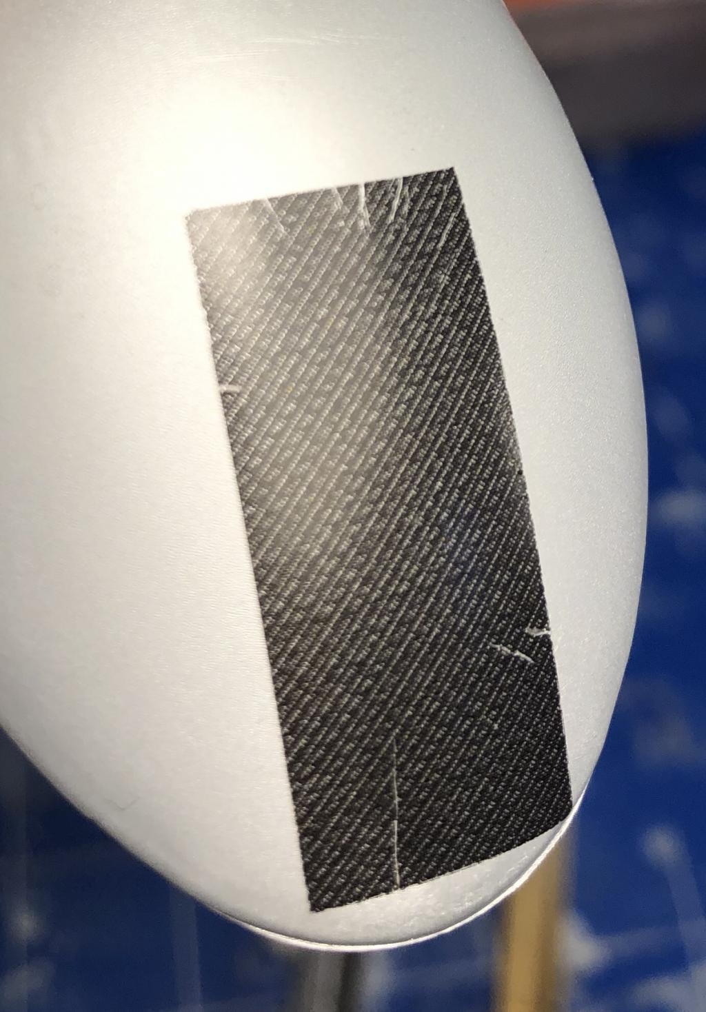

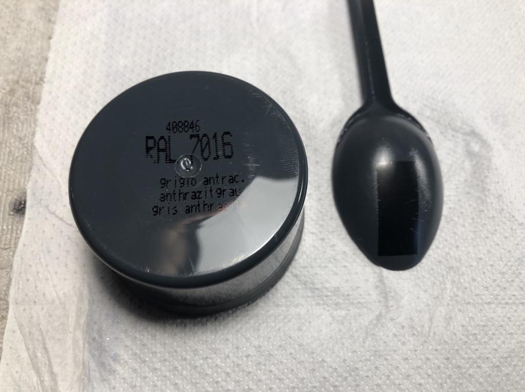

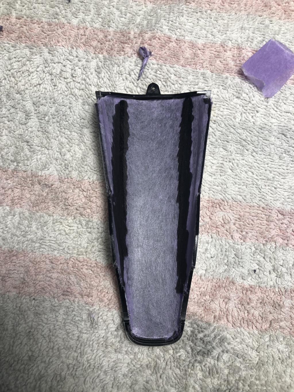

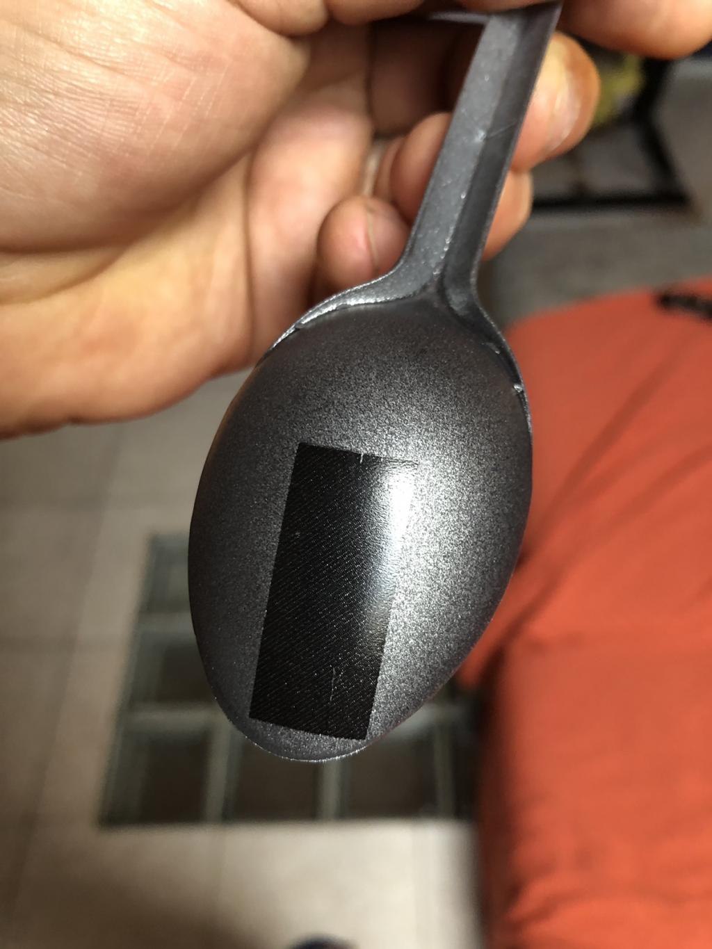

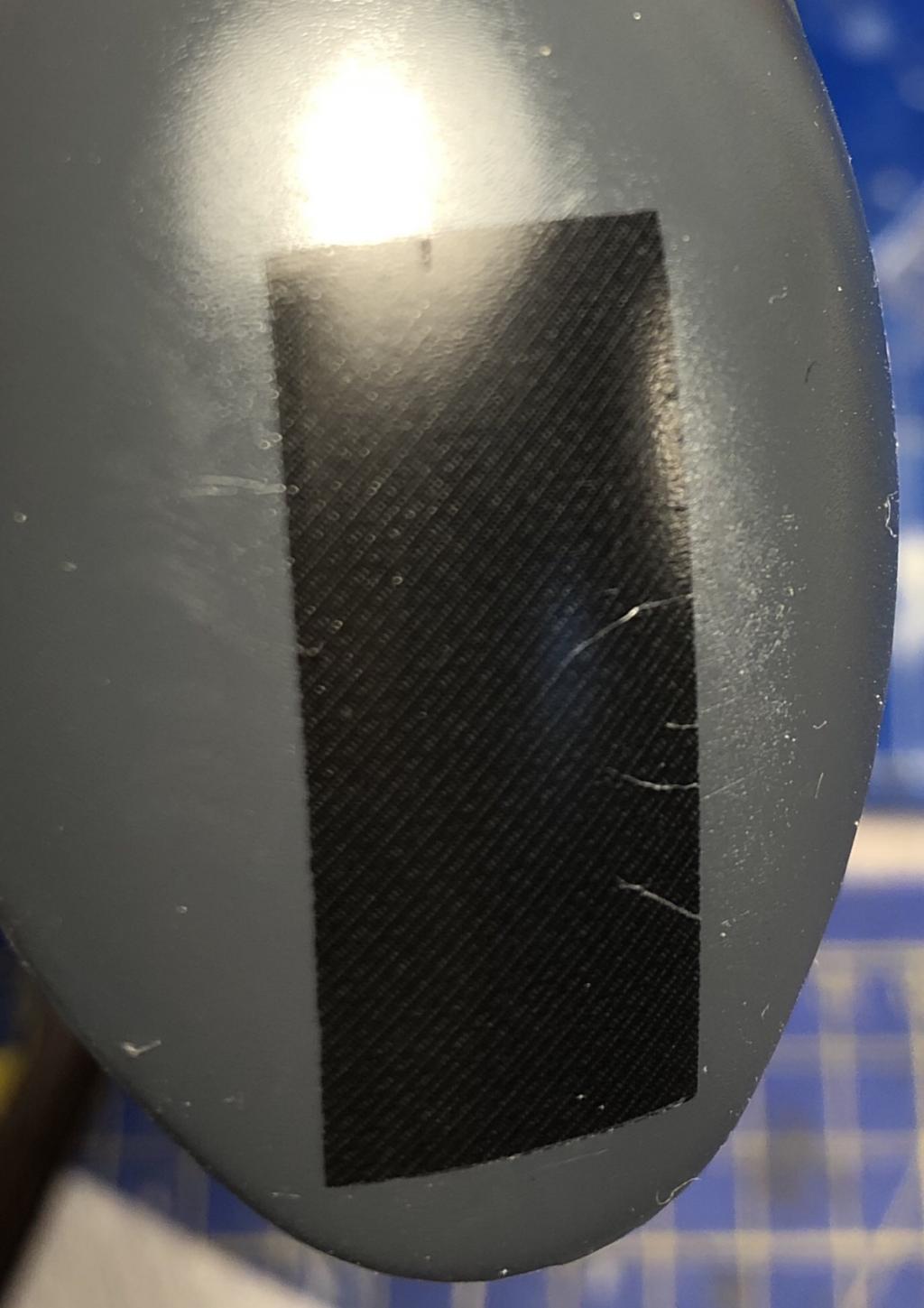

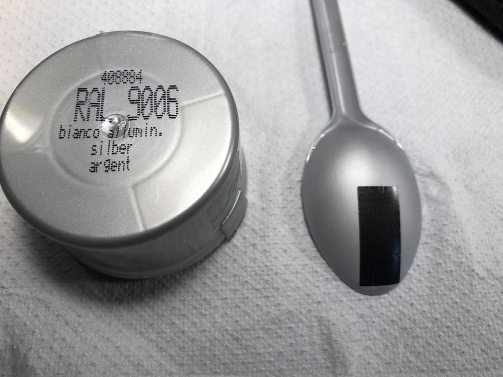

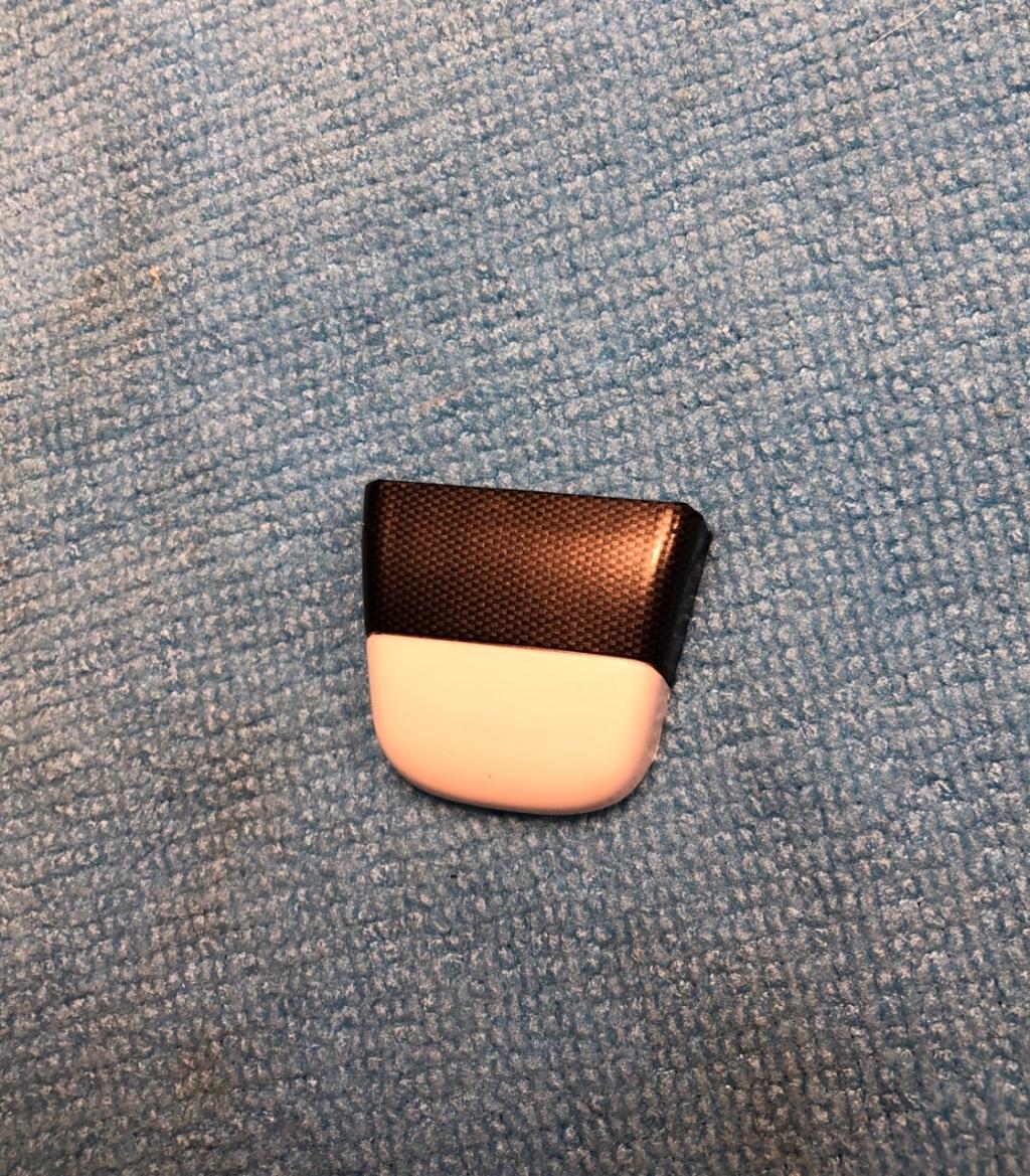

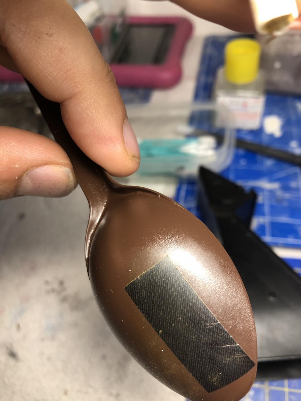

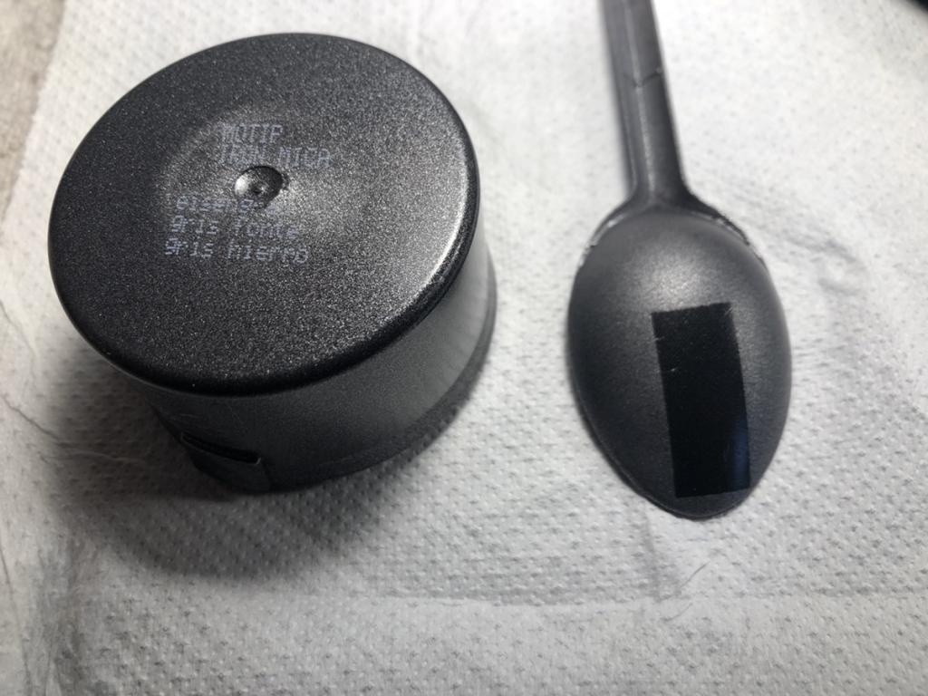

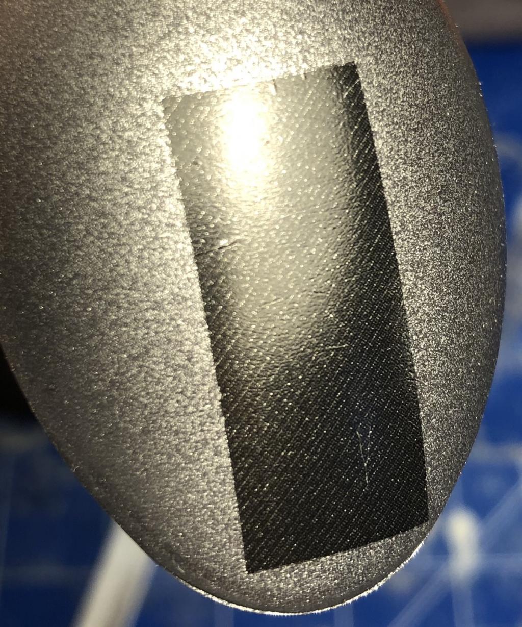

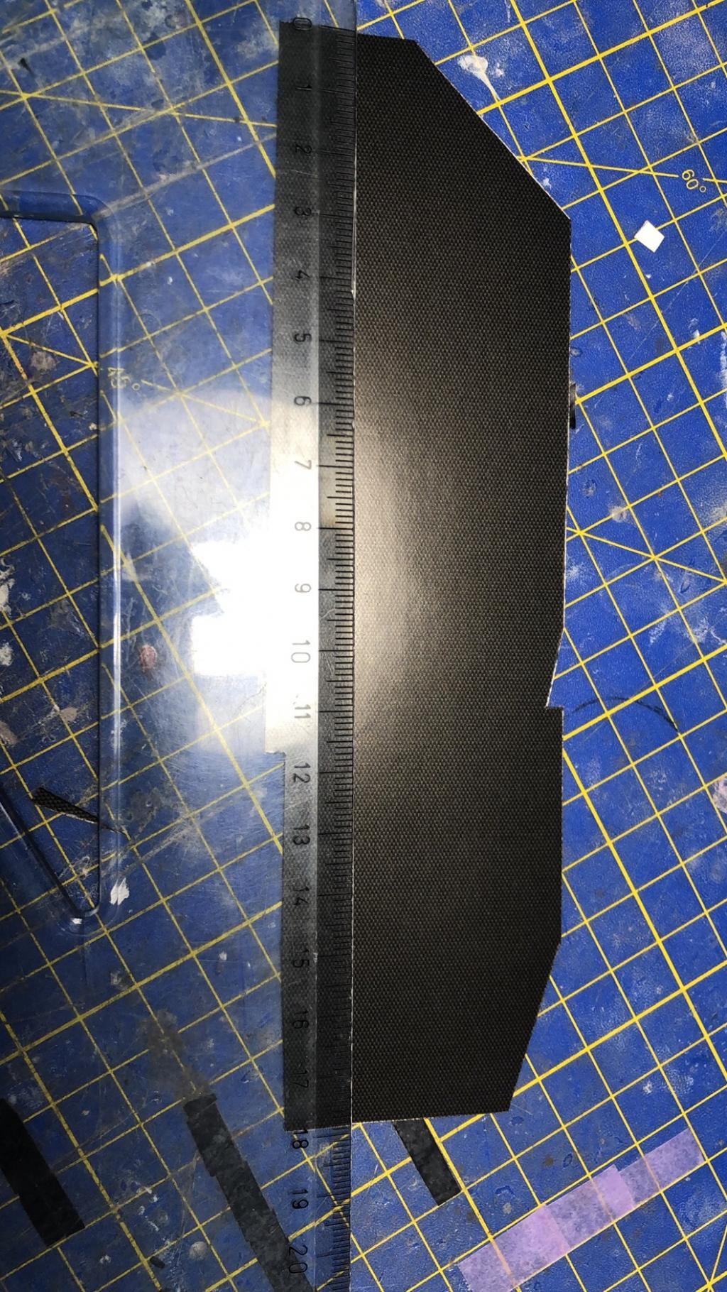

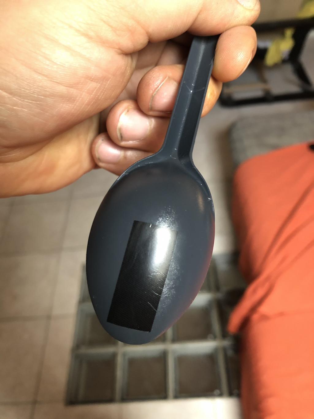

I started the test work with future carbon decal for radiator side pods o radiator housing.
I've doing dome test with color base and 1/32 carbon decal.
The carbon fiber on radiator housing (inside red area) is really extra fine.
I don't want to paint, i want to decal them to give a real carbon look
I also made some wheatering experiment.
This carbon is extra fine and rough and really matt.
So i think the best color base is graphite gray with a final clear matt coat.

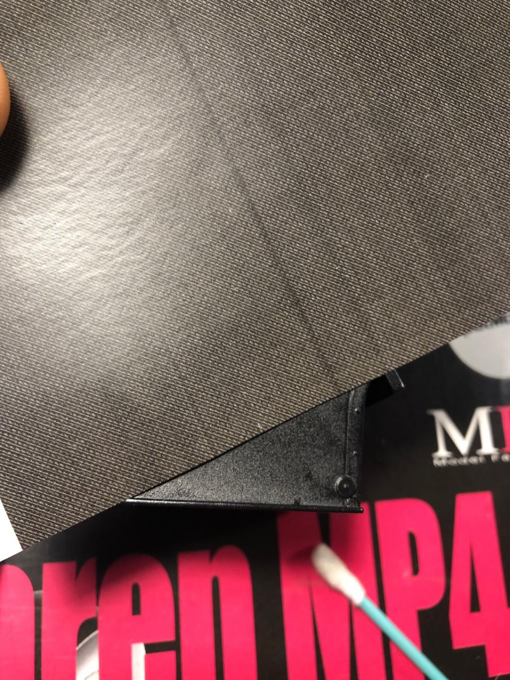

Points: 2,163

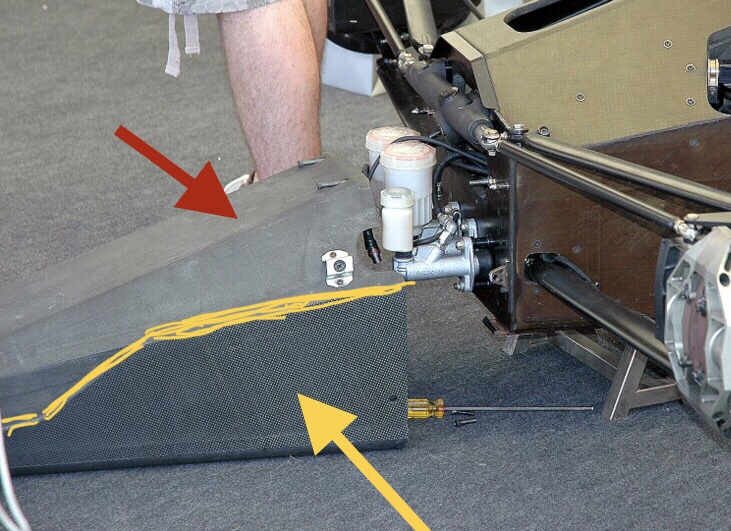

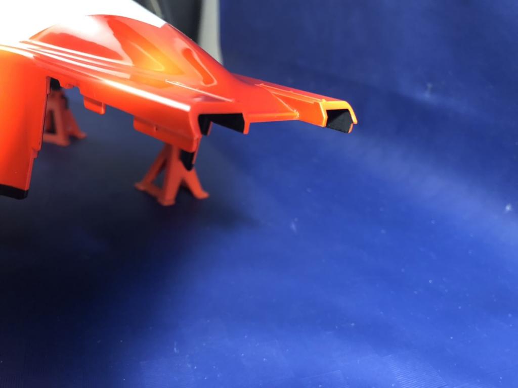

Every parts of this chassis ir really complicated with different carbon fiber
Nose cone has 2 different carbon
Red arrow is carbon extra fine area.
Yellow arrow is a little big carbon area

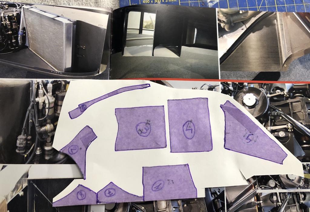

The better color base i think will be a light gun metal.
To reach the differences between the extra fine and fine carbon i think to do the upper with 1/32 and the side with museum collection
To have right template, I copied the Museum collection template
frah2o

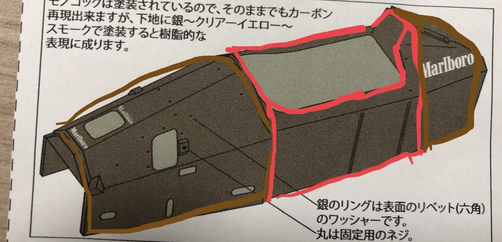

This part is very different color with many particular

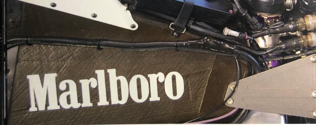

The monocoque is dividide in 3 different parts
The front parts like the rear parts where is fuel tank (brown area) is a bronze color (in other pics seems a brown green mixed) In some 1988 race pics it seems a dark bronze color
The central area (red zone) in some pics is black, in other is dark brown. This area is the middle of monocoque until the headrest and cockpit zone
I post some pics where the are some color differenc
Motegi Museum
Race season
Ogni foto frega....assume le tonalità più diverse. Scale motorport la fa bronzo, MFH la fa bronzo.....anche a me in gara e in alcune foto del museo appare bronzo.
The central area is very dark....is darker than carbon of radiator houding box
I think the best color base is dark brown for middle monocoque area and 1/32 carbon decal
Another particular is a different carbon plate where is the engine mount bracket.
frah2o

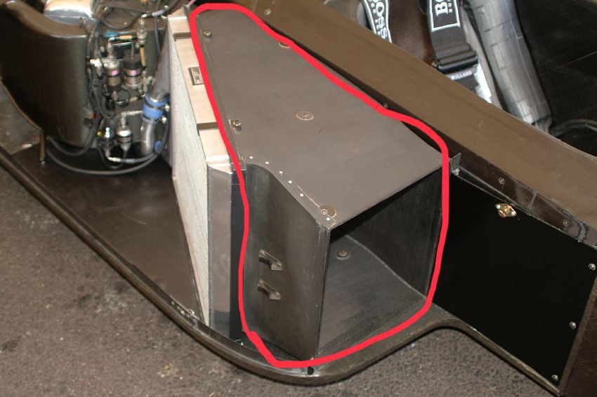

Radiator housing ducts or radiator box
They are really extra fine carbon....many people just leavein plastic or just paint them
THey're in carbon and i'll try to coat with 1/32 decal
I think the riaght base is graphite gray

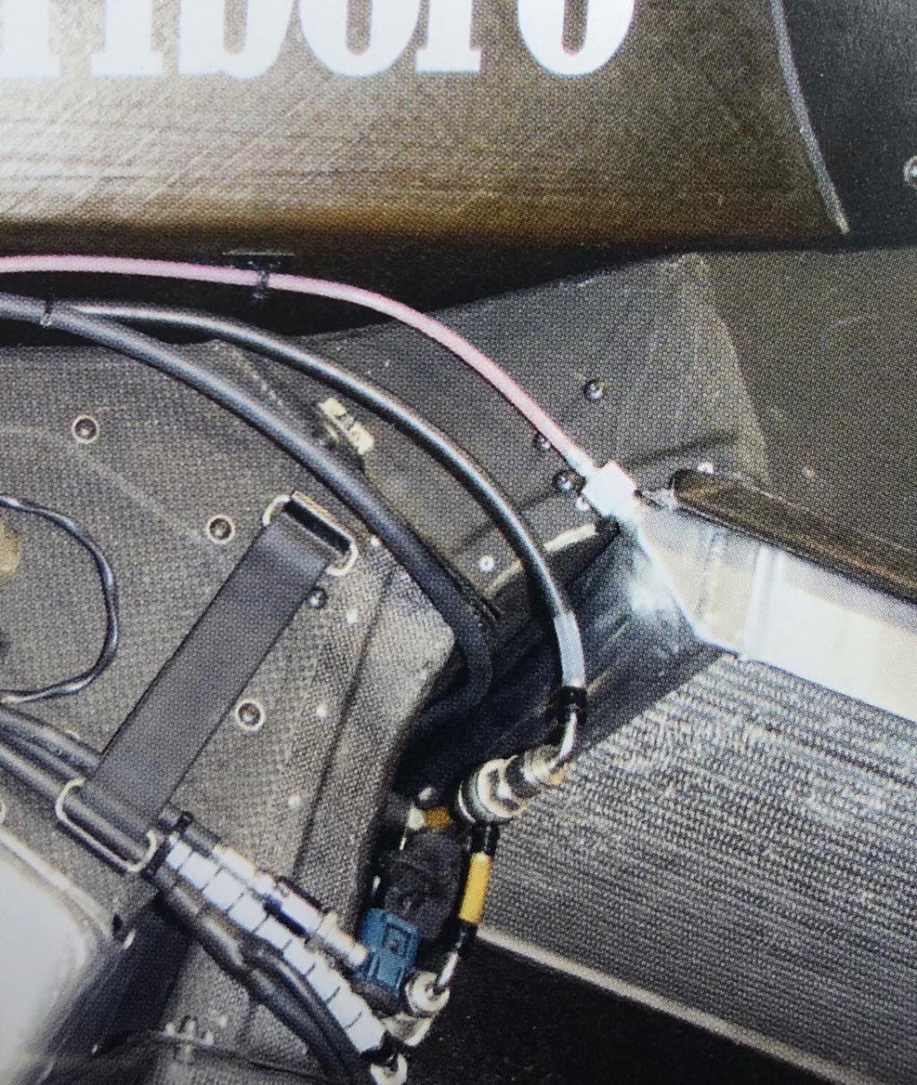

Another particular are the washer of rivets. These washer are maade with a a different color carbon
Other particular is the area with there are the control unit. In this area there's a bigger carbon compared to overrall radiator box
I hope with Haynes book to see more refernces pics

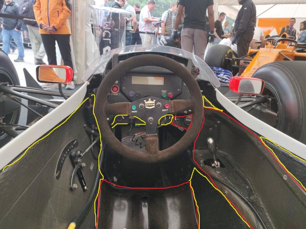

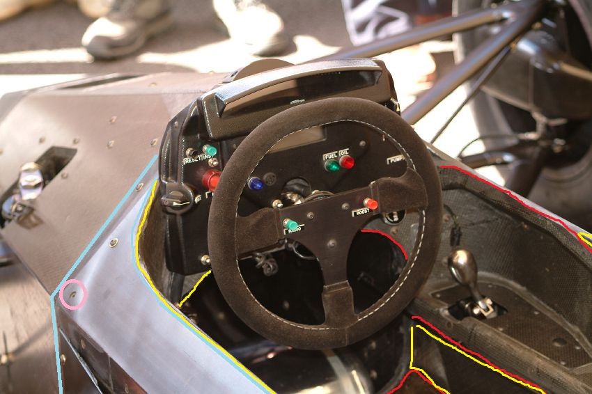

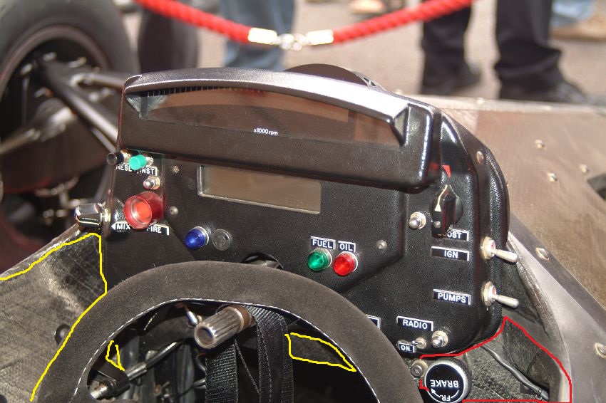

The last monocoque area to analyze is the inside.
I divided the carbon differences with some area circle.
- Yellow area is extra fine inside carbon
- Red area is bigger carbon
- Blue area is outside carbon
Inside the 2 types of carbon. Yellow extra fine and bigger.
The extra fine is the whole inside of cockpit. the bigger is for seat and armrest and gearknob cover until the lower right side of dash.
The blu area is the outside carbon of central monocoque
I saw particular that made me think
In this pics (I think motegi museum) is one screw missing.
I think that this chassis is restored.
In the 1988 season this section is really darker and rough...in the museum is like brown and very smooth. I think this carbon section is a possible replacement with a little bit light carbon
The dah board is plastic
The inside color base cockpit i think will be in light gray and outide i continued with drak brown.
This carbon on this car is a really nightmare. RollEyes

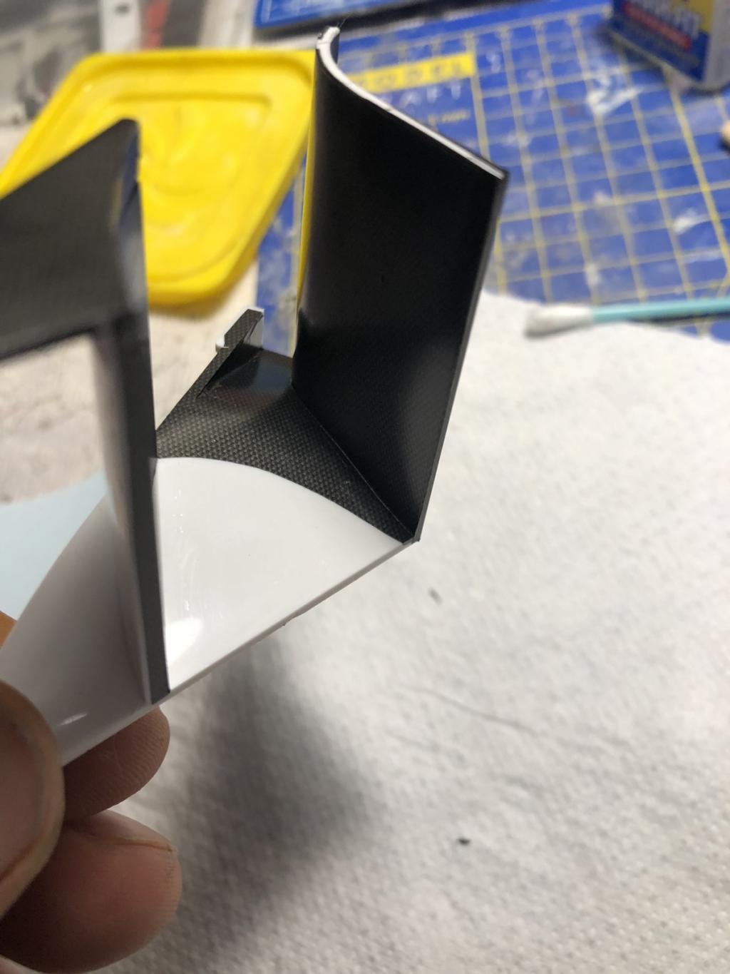

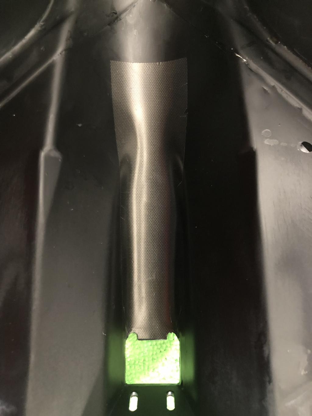

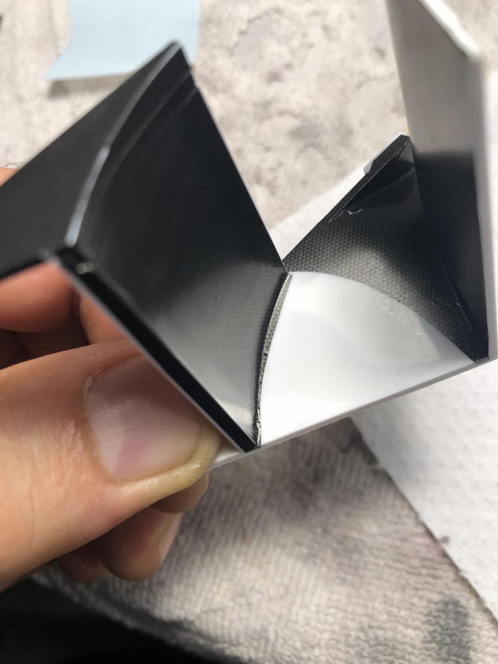

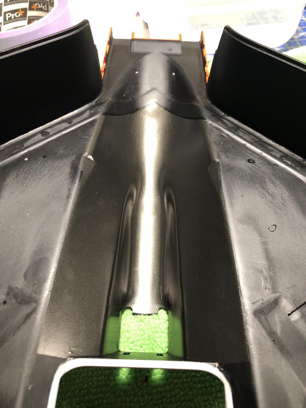

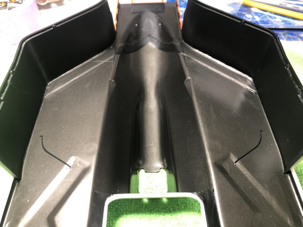

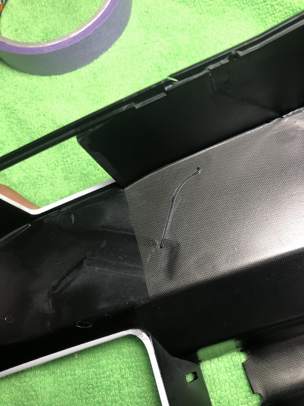

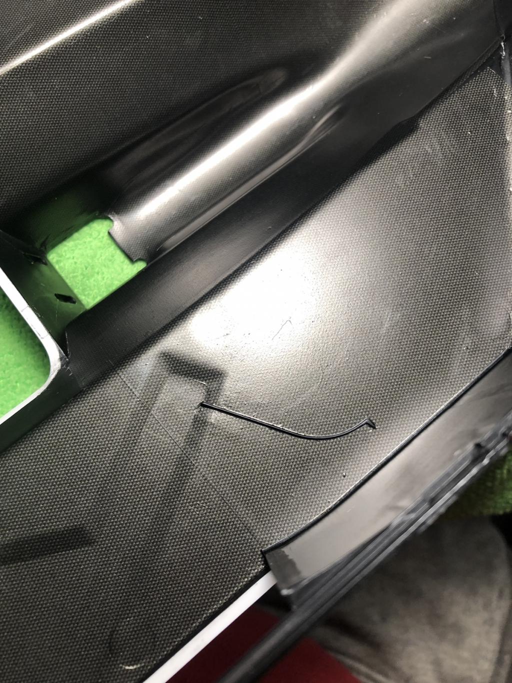

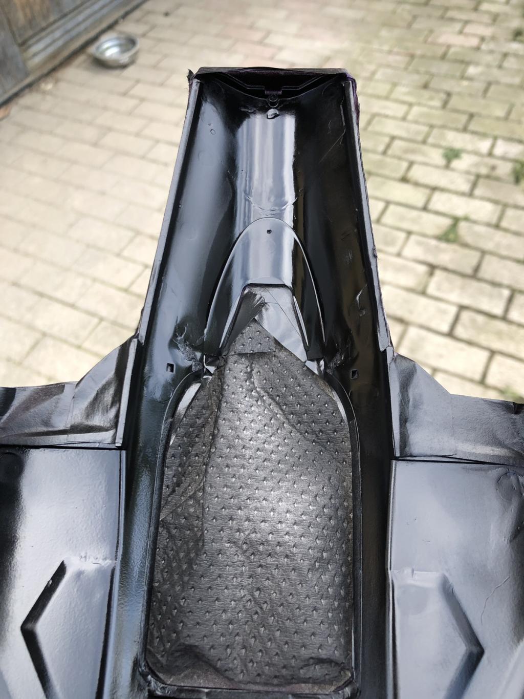

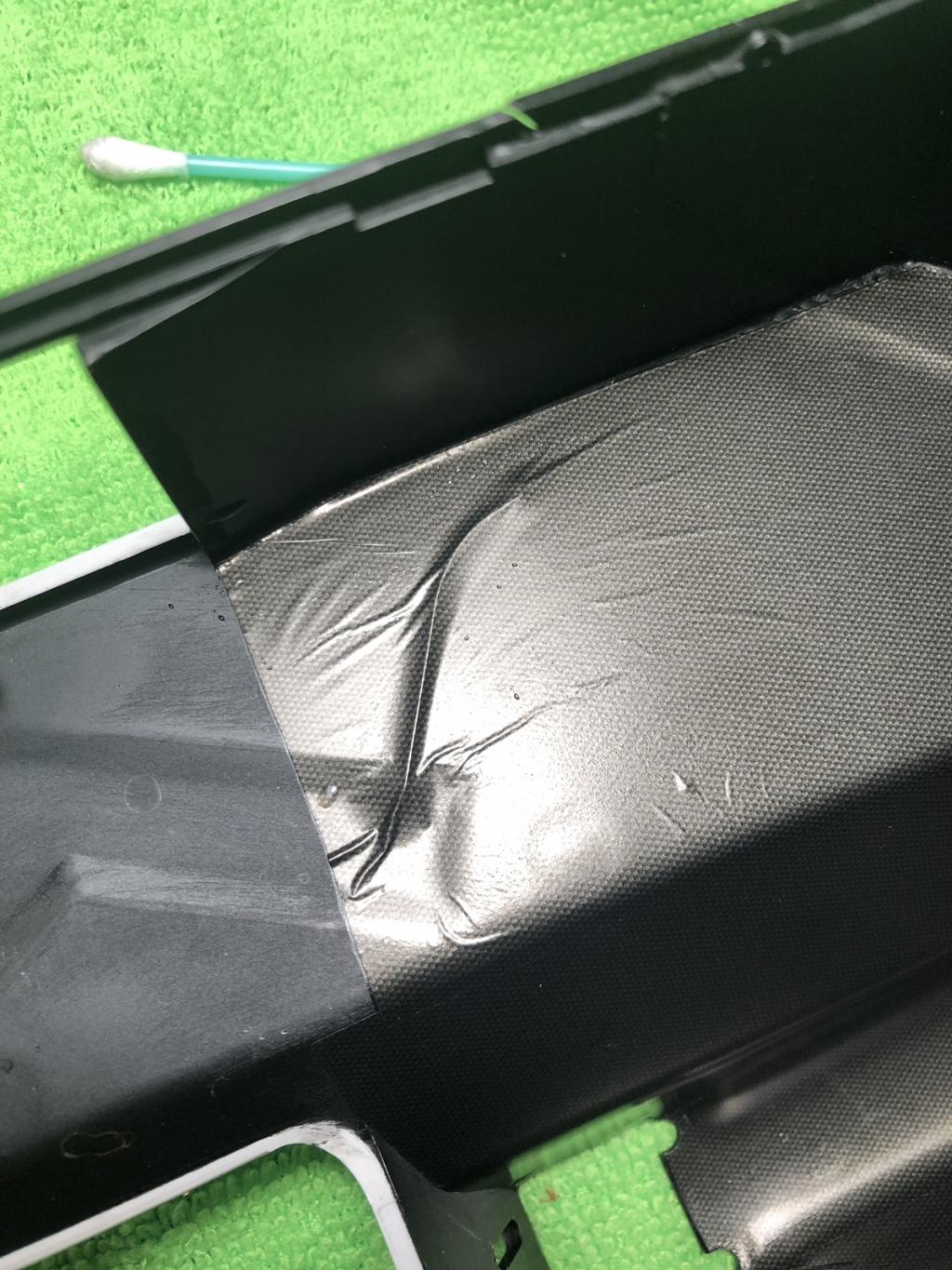

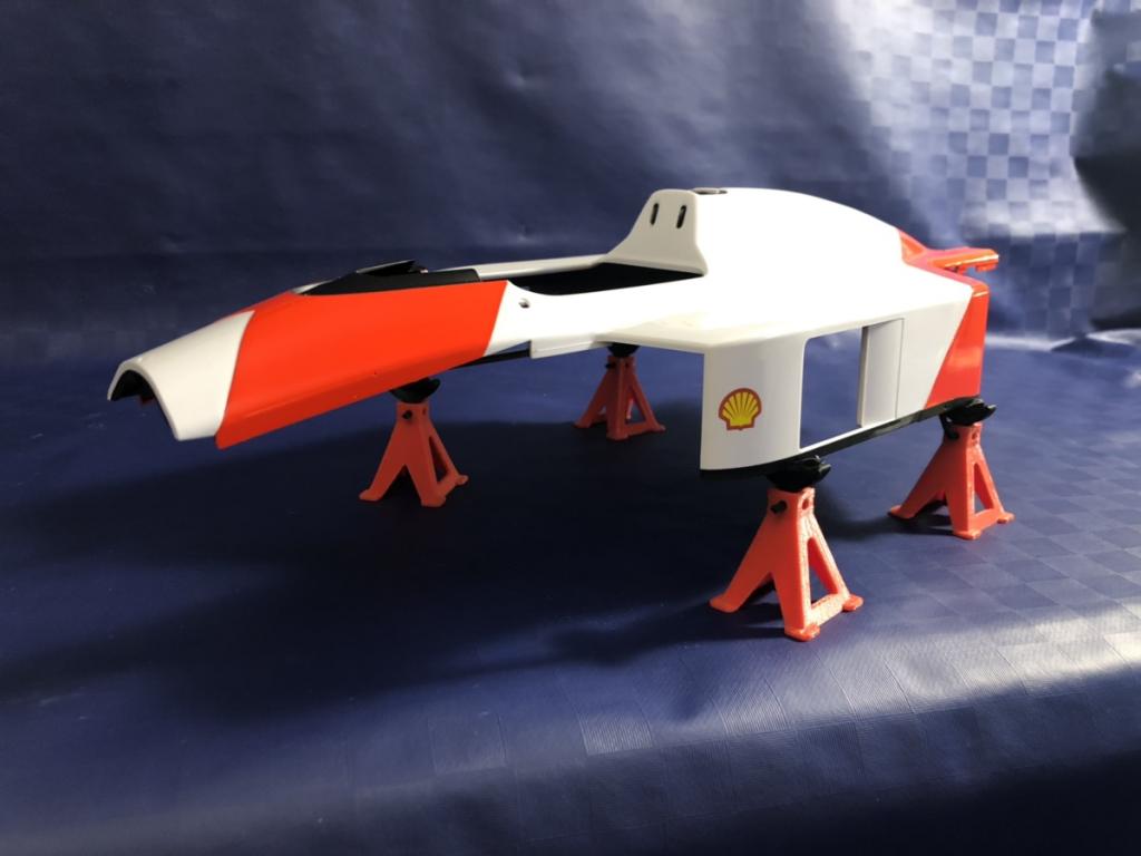

I started the carbon work on iside of bodyshell.....a big load of carbon decal...Blink
I hope to finish the bodyshell in this weekend.
I think the hardest part is completed: the hump (I don't know is it the right name)

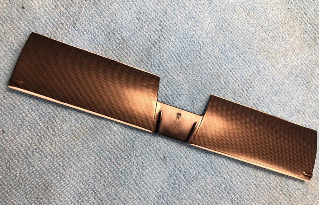

Hi Rich,for turbo inlets i uded a Cartograph chequered carbon (no twill) for 1/24 and I used and Museum Collection template, but i made some cut on decal while i've posed to eliminate the wrinkles.
I also used the scale motorsport (Kevlar for my Delta), but i notices that are harder and fragile then Cartograph.
I haven't use MC decal yet....i hope will be like Cartograph
