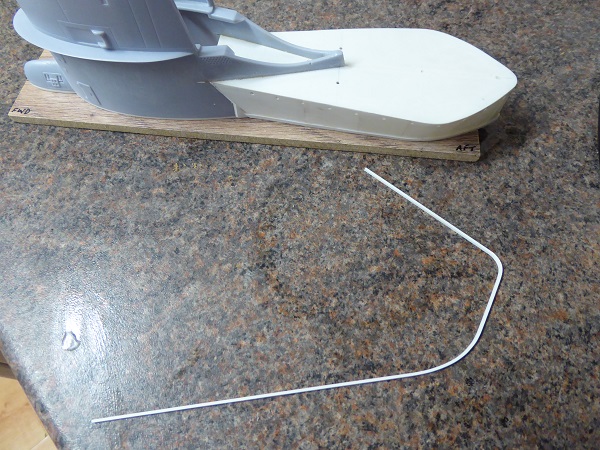

The next phase saw the addition of edging strip to the lower deck. This edging strip is where the guard rails will be fixed to at a later date. I chose 1.0mm x 1.5mm plastic strip for this job.
I couldn't make one strip to fit all the way round, so split it into two parts.
The attached photo shows the first section being bent by hand to suit the profile of the lower deck, I didn't want to just glue it without some bending as it would prove tricky to locate and have internal stresses.

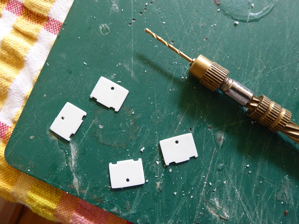

After measuring the donor models lockers, I scaled up the dimensions and cut out four pieces to simulate the lockers from 0.5mm thick plastic sheet, measuring 9mm x 12mm.
Sticky Wickett
#136 Posted : 13 September 2018 08:42:43
Joined: 20/10/2016
Posts: 4,504
Points: 13,548
I then carefully filed the cut outs for the hinges.
Sticky Wickett
#137 Posted : 13 September 2018 08:45:15
Joined: 20/10/2016
Posts: 4,504
Points: 13,548
I then marked out the location for locks.
Sticky Wickett
#138 Posted : 13 September 2018 08:46:08
Joined: 20/10/2016
Posts: 4,504
Points: 13,548
I drilled these out with a 1.2mm diameter drill.

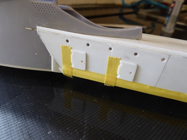

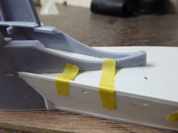

Using tape as a marker I proceeded to glue the lockers in their correct location.
Sticky Wickett
#140 Posted : 13 September 2018 08:49:06
Joined: 20/10/2016
Posts: 4,504
Points: 13,548
Port side showing tape in place and lockers located.
