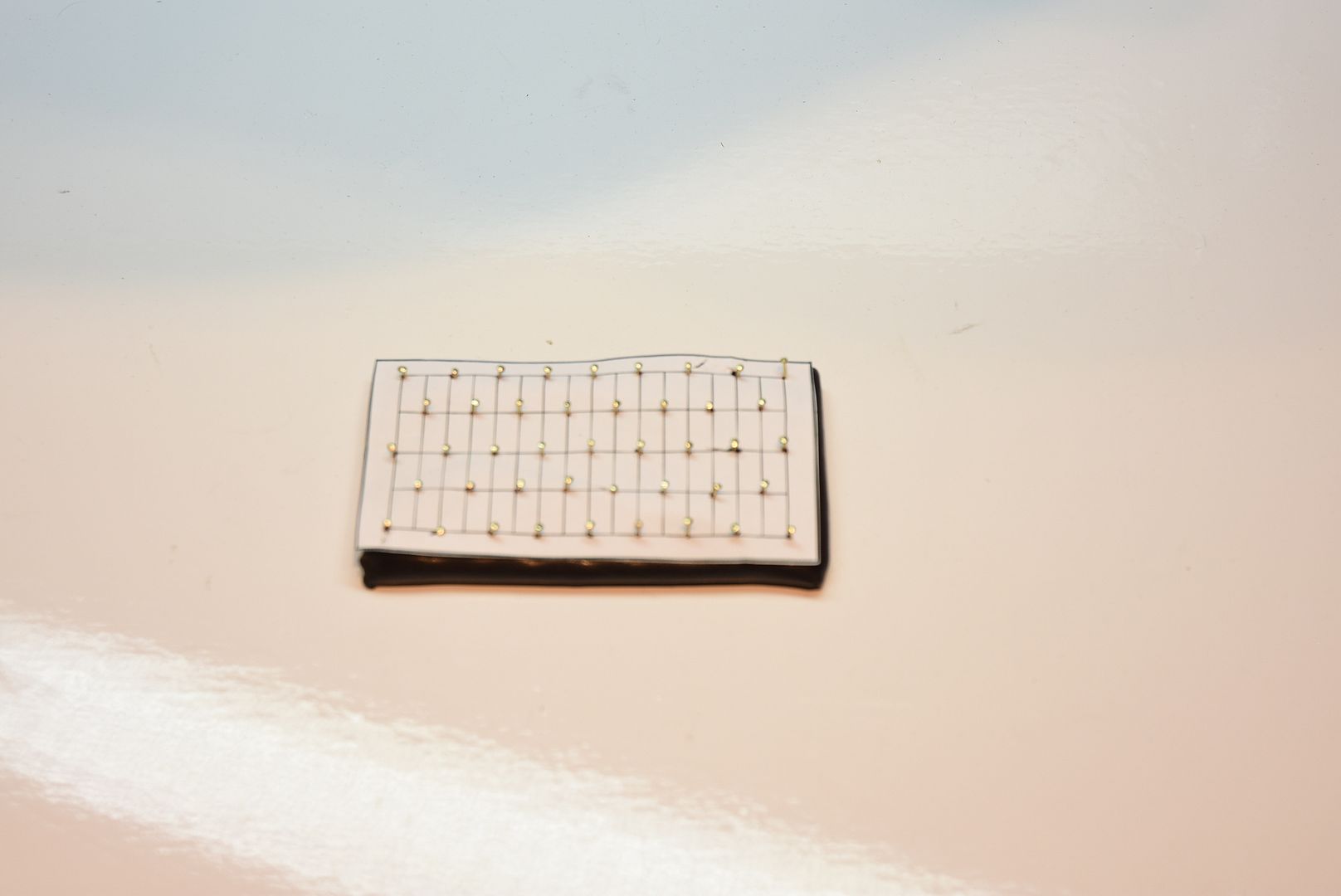

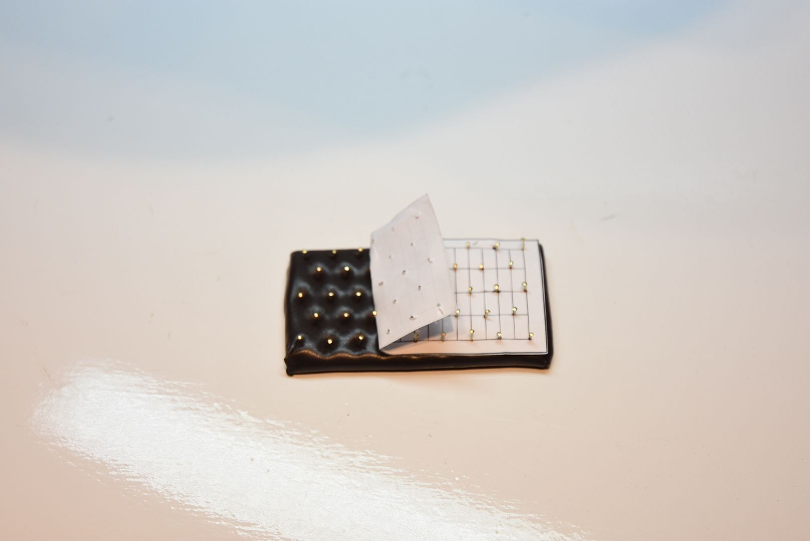

Well the doors have taken a lot longer than I thought, after sanding and shaping to match the curve of the coach body the next stage was to french polish and fit the leather upholstery to the in side of the doors.
First was to cut a thin piece of ply the the same size as the inner side of the door,this will make a good base to work with,I then trimed a piece of soft foam and glued it to the lower part of the door,after waiting for it to dry I then cut a piece of soft leather that was over sized folded the corners and glued.
Next part was to make a paper pattern showing squares then laying it over the soft leather and using 5mm pins pushed each one into each corner push through into the wood back as far as they would could go,then I turned and cut the back of the pins off then glued to make all secure
Thanks for looking more soon
Trev.
PS.Having trouble sizing pictures and posting get back soon.

Glad to see you sorted your picture posting issue.
Buttoned panels look really neat and what a smart way of producing these using the pins.
Gives a very realistic upholstered look to things.
Tony
