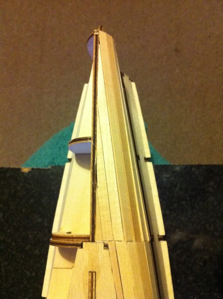

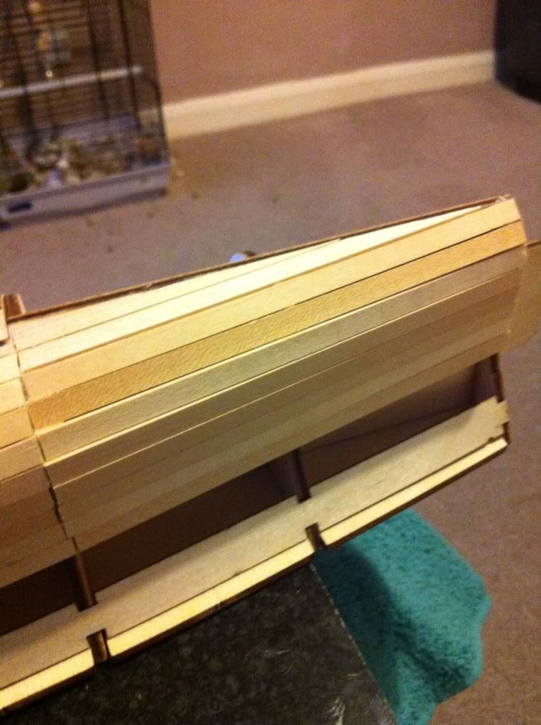

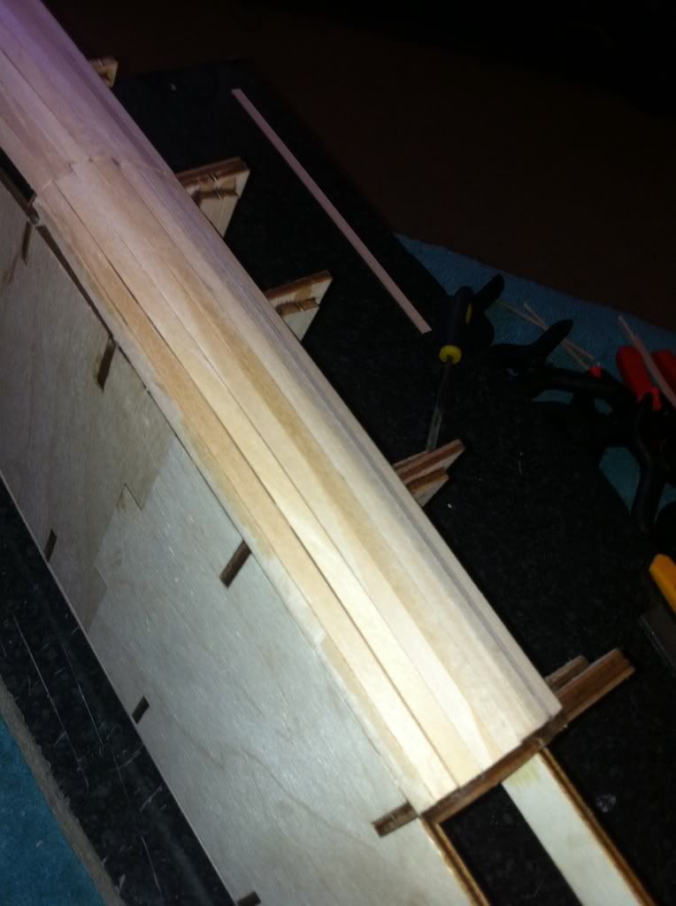

Issue 23
Finally managed to finish this one. I didn't realise how long planking takes but I'm getting there
I've got issue 24 I've not started it yet. I was thinking about using sawdust in PVA glue to fill in the little gaps in the planking once this layer is done so hopefully it will be nice an smooth once it's done.

#126 Posted : 16 February 2012 18:38:00
Hi Sean if it is anything like the Bizzy it will have some element of double planking, I will phone Hachette tomorrow and ask.
Your work looks greatBigGrin dont do anything serious untill I find out.

Location: Dagenham
Thx mike. I'm not able to pin the planks into position cause I don't have any so I'm using clamps. Its taking a bit longer but has the same effect I think lol. Sorry ta hear about ur latest issue it's got 41planks (I think) and also contains the missing parts from a previous issue tho u already made ya own. It's wierd cause although it's giving ya all these planks it's only giving the instructions for 20 of them. Hope this helps

BigGrin Hi Sean the extra planks will be used in future ISSUESBigGrin put them safe.
You could nip into a Hobbycraft and get some train track pinsBigGrin Regards MikeBigGrin

hi sean how about trieing this with elestic bands put around oppisit frame under the plank your fitting up and back to the same frame crossing the frame it pulls the plank in and up agenest the other plank at the same time the pice off 3x3 is to kept the joints flush as possible to each other not nedded all the time p.s. if you do use this idear the top plank only needs to be clamped or held some way to stop it ridding up the frame till the glue dries

Cheers mike. Thats a good idea willie il give it a go cheers.

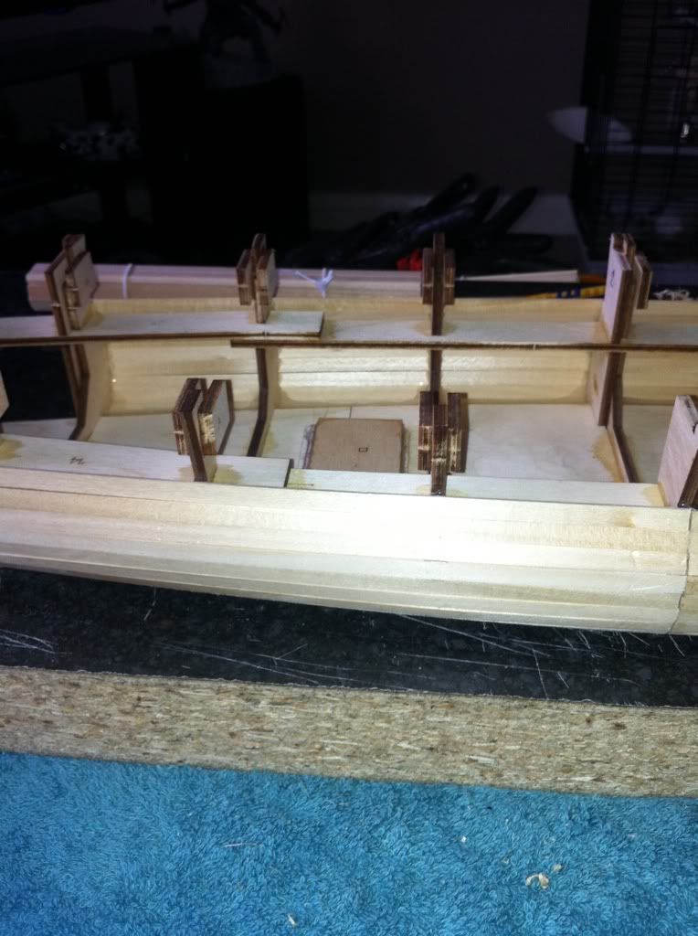

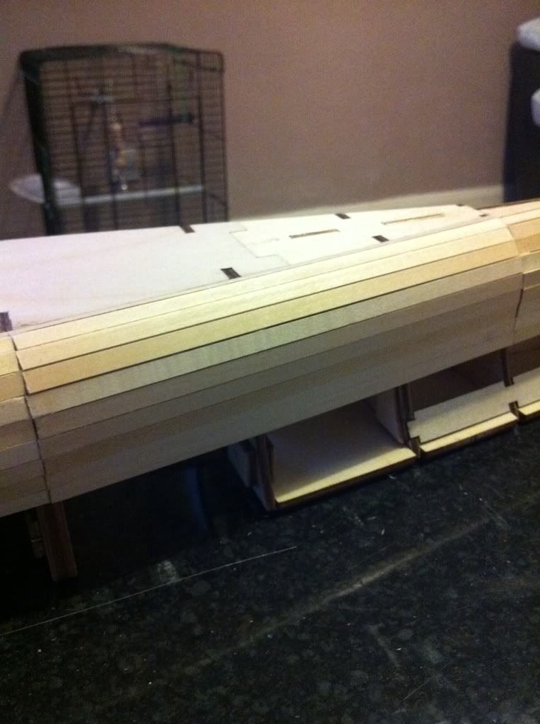

Issue 24

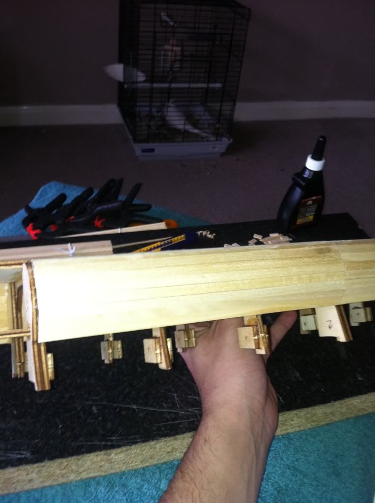

looking good SEAN have you try the rubber bands for holding the planks
S2ksean
#134 Posted : 27 February 2012 18:27:45
Joined: 11/05/2011
Posts: 766
Points: 2,128
Location: Dagenham
Cheers willie and yeah I tried it and it's came in handy for a few of the planks so thank u for the advice

when doing the last plank with the bands put it right around the hull and pack the bands with off cuts so you pull only on the plank you are fixing watch you dont glue the off cuts as well

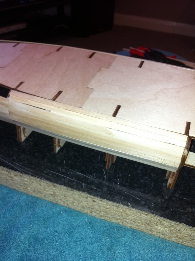

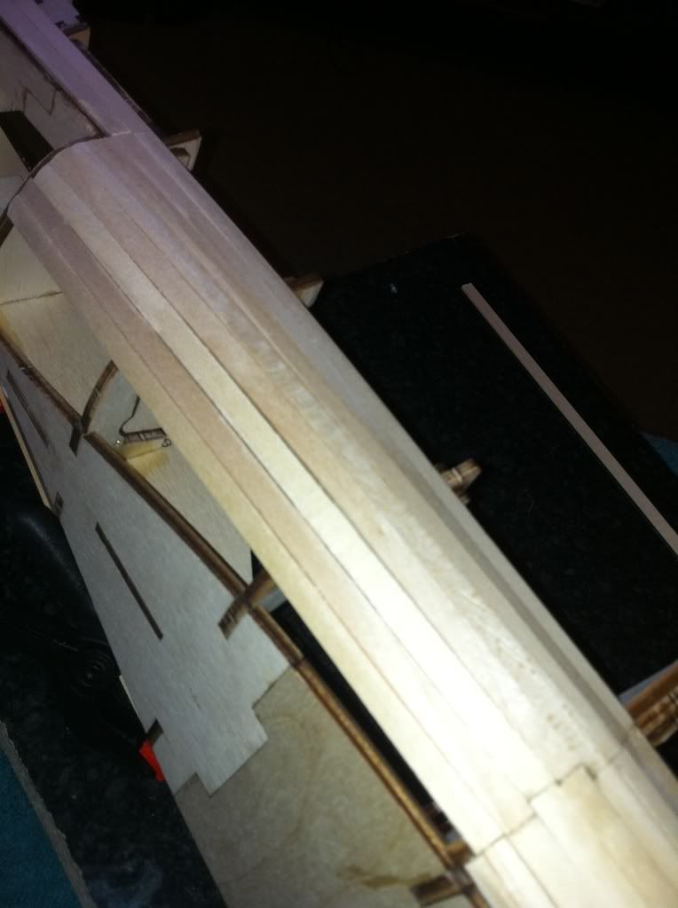

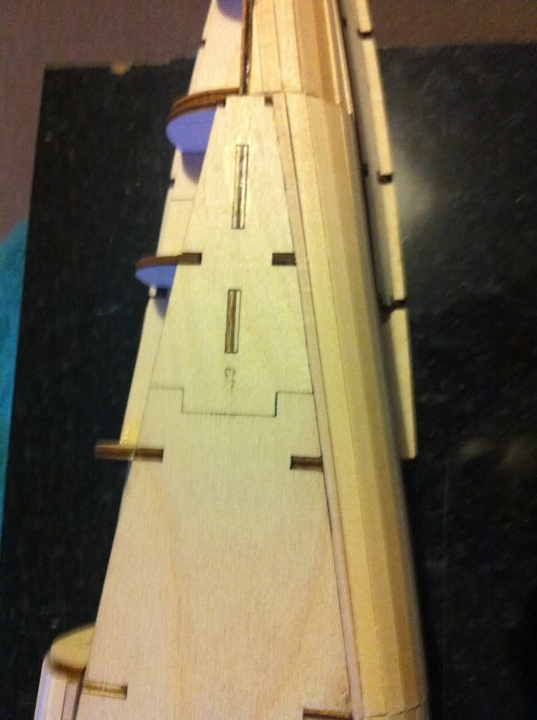

Issue 25 (part 1)
Only managed to do half of 25 today but I'm now waiting for glue to dry on the last couple of planks then il hopefully start the over side in the next few days.
Comments welcome
