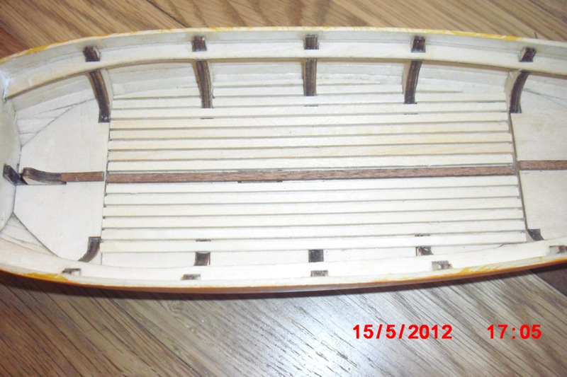

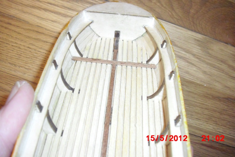

COMPLETING THE WELL BOARDS
Hi Team I decided to deviate from the instructions and complete the Boards before finishing the second sheathing, this way I will have more room inside the boat to work before I fit the gunnals etc.
The first job was to identify the wood ( bass wood 2 x 3 mm)
I then raided my scrap wood to find some 1mm thick pieces to act as spacers.
I fitted sapele 2 x 3mm down the centre of the well of the boat, and fitted some strips of bass wood along side, using the spacers:-
#128 Posted : 15 May 2012 22:26:53
And then it was just a question of cutting and fixing untill the job was finished:-
#129 Posted : 15 May 2012 22:31:38
At this point I did not use bass wood for the two cross members as called for in the instructions, I had some scrap pieces of Mahogany and fitted these and I feel they look much better:-

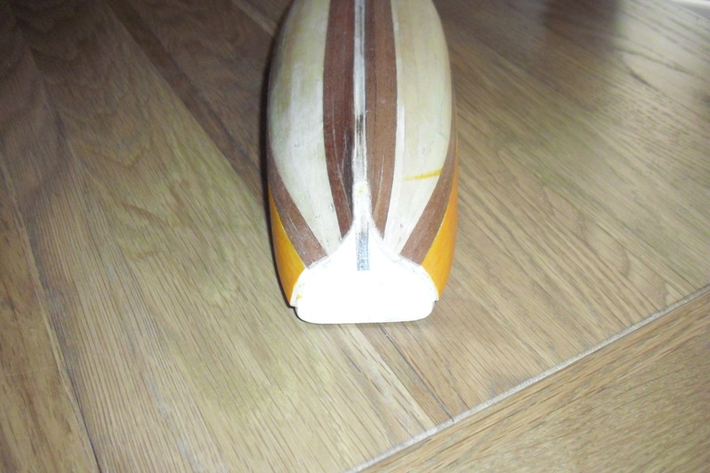

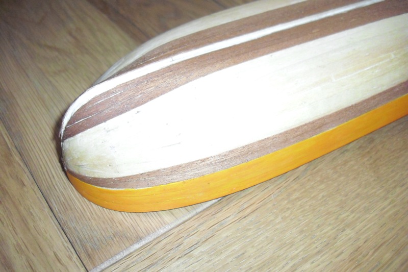

SECOND SHEATHING
To day I continued with the second layer of planking, I used PVA adhesive and fitted the gardboard planking, plus a couple of fillets on the stern hull and prepared the keel and stem channelsBigGrin
Comments and Questions welcomeBigGrin Regards Mike

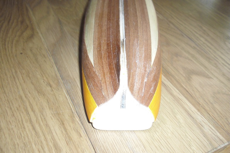

SECOND SHEATHING
Well team it has been aweek since I posted a report, but I slowly carried on........................

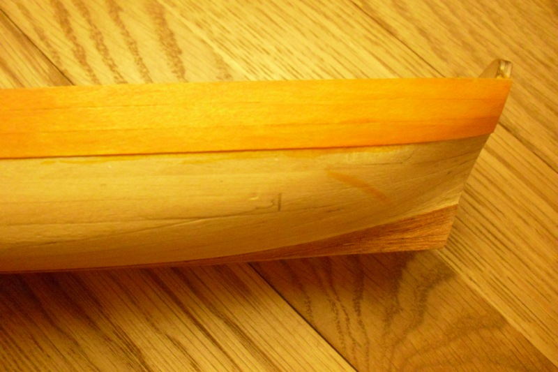

#140 Posted : 28 May 2012 18:54:16
SECOND SHEATHING
And I carried on........................................
