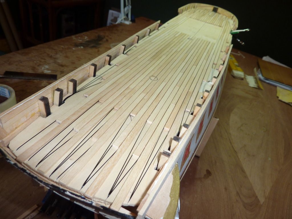

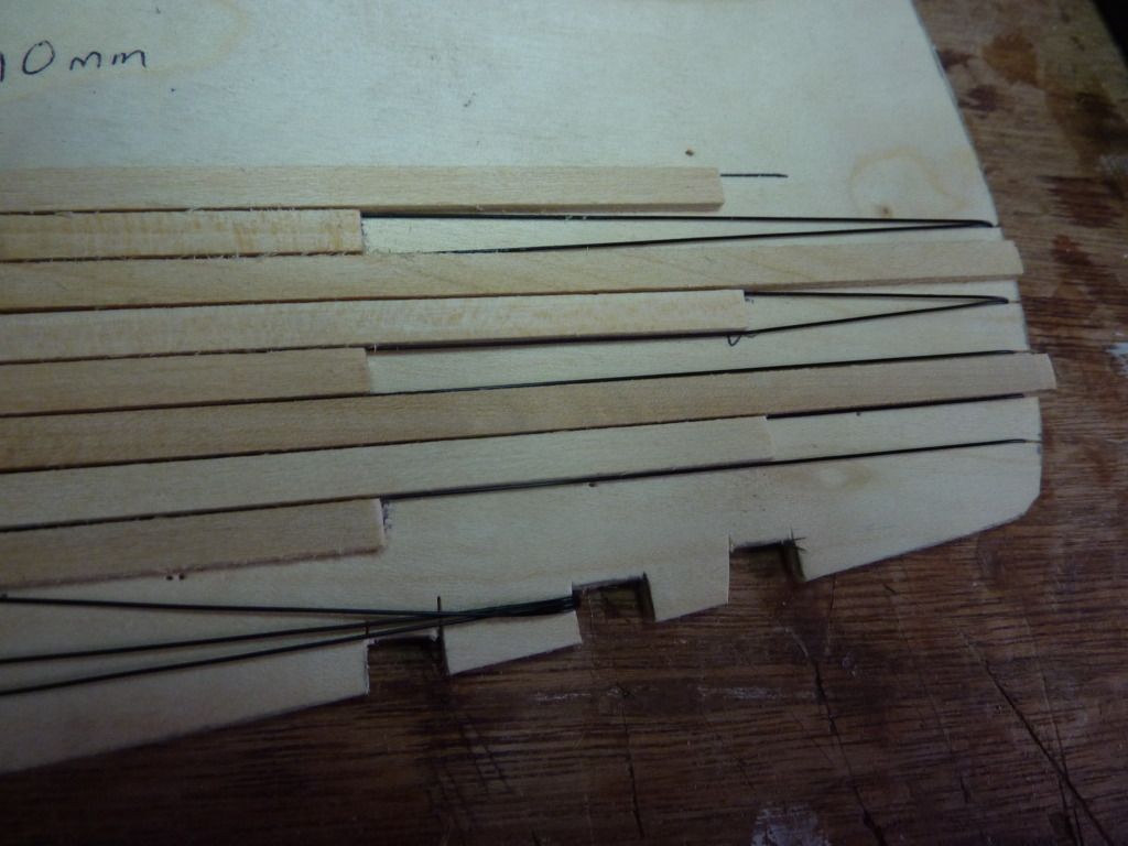

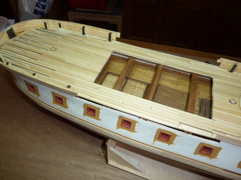

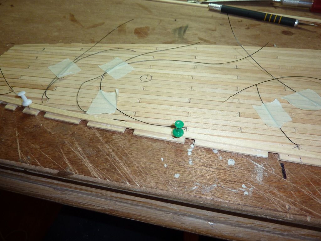

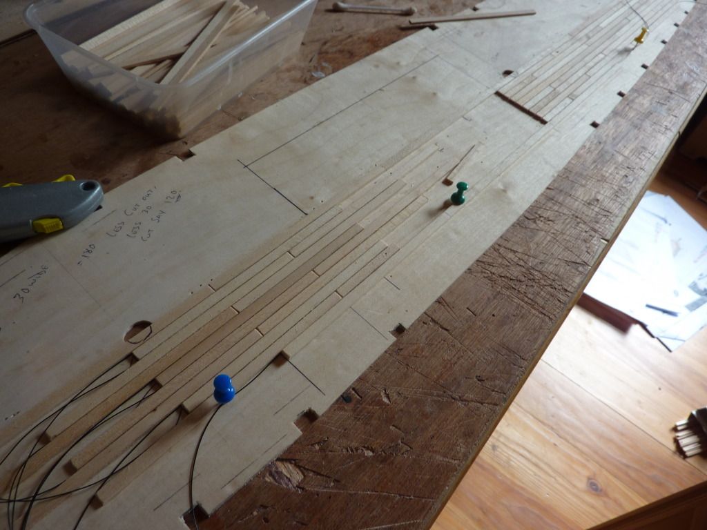

Still on the top deck planking.I have lifted the planking that was in the wrong place, and have now come up the side of the opening. this determines the lengths of the planks at the bow end of the opening.
I have not taken the planks to the end of the ply deck, the last planks with have to be done after the deck is fitted to the hull frames, this will allow for a tidy finish at the bulwarks..
I have put a few saw cuts in the ends of the plywood, I have then pulled the fish line tight and passed through the saw cut, and taped on to the back of the ply, This will keep everything tidy, and there won't be a lot of loose ends of line.
I am trying to do post regularly, as it takes quite a while for the pictures to load to photo bucket. Thanks again for all the help and encouragement, Would not have got this far with out your help and this forum

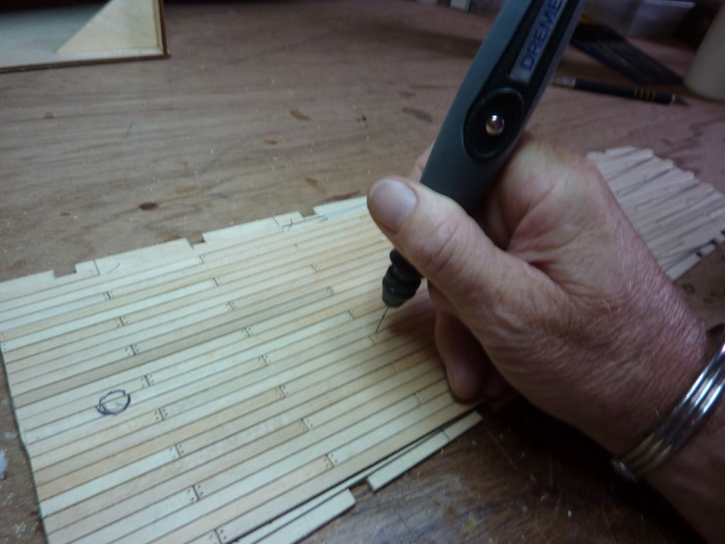

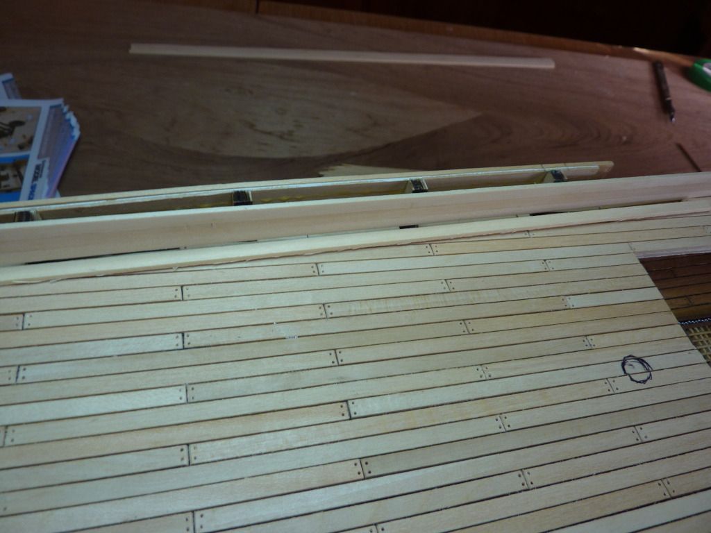

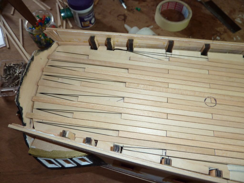

got all the upper deck planked now, apart from the final planks that will have to be done after the deck is fitted, but before I do the inside bulwarks.
I have now also cut out the opening in the top deck.
I am also taking this opertunity to do the drilling of the holes for the fish line, to form the tree nailing detail.

Nice and neat bit of decking there Mo, I will be interested to see how you tackle going round the ribs or are you not fitting a border plank and just letting the walls cover itBigGrin

Meh. Yes I would like a border plank, I may have glued some decking to close to the edge, what's done is done, and I will cross that bridge when I get to it,

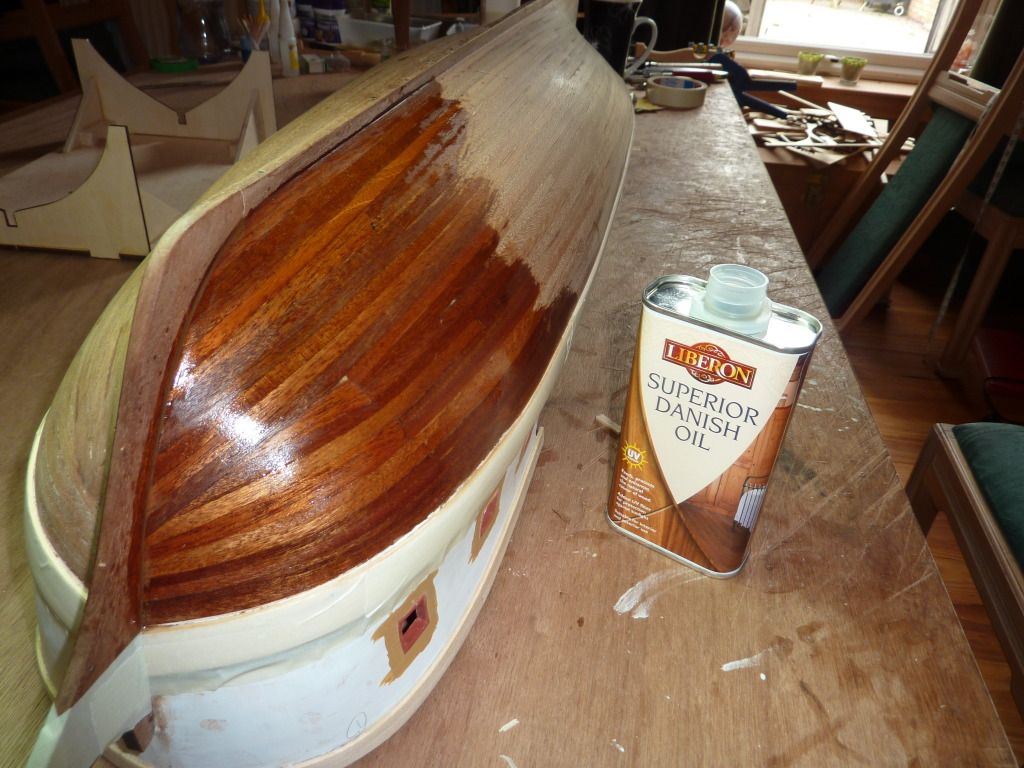

Been getting quite a lot done on my build the last few weeks, But I now have a few jobs to do, work wise, so I can see a little less getting done from Monday onwards,

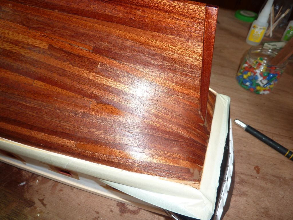

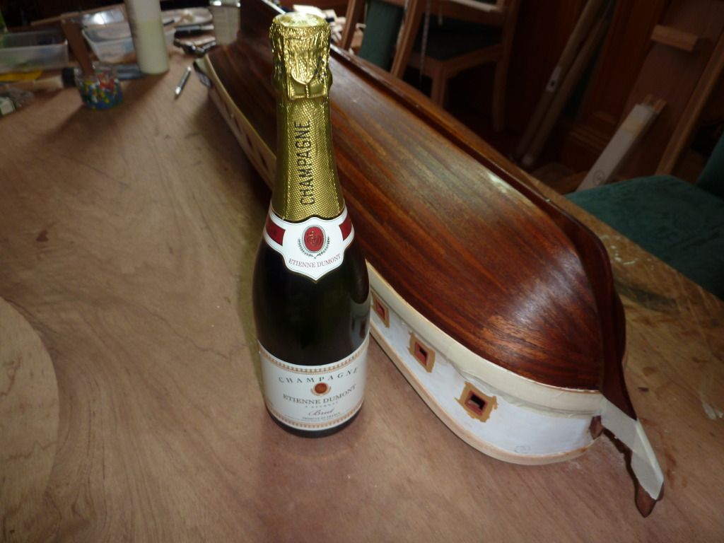

I have now given the hull 3 coats of Danish Oil, as the instructions say, 3 coats, 5 hours apart, paint on and let soak into the grain for 5 to 10 min's, then wipe dry with a lint free cloth, Very happy again with the way it is looking,
Just thought I needed to celebrate the hull being finished, I thought I would never get there.

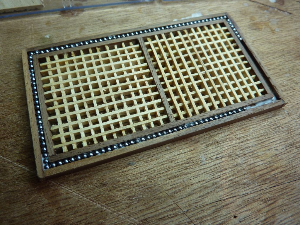

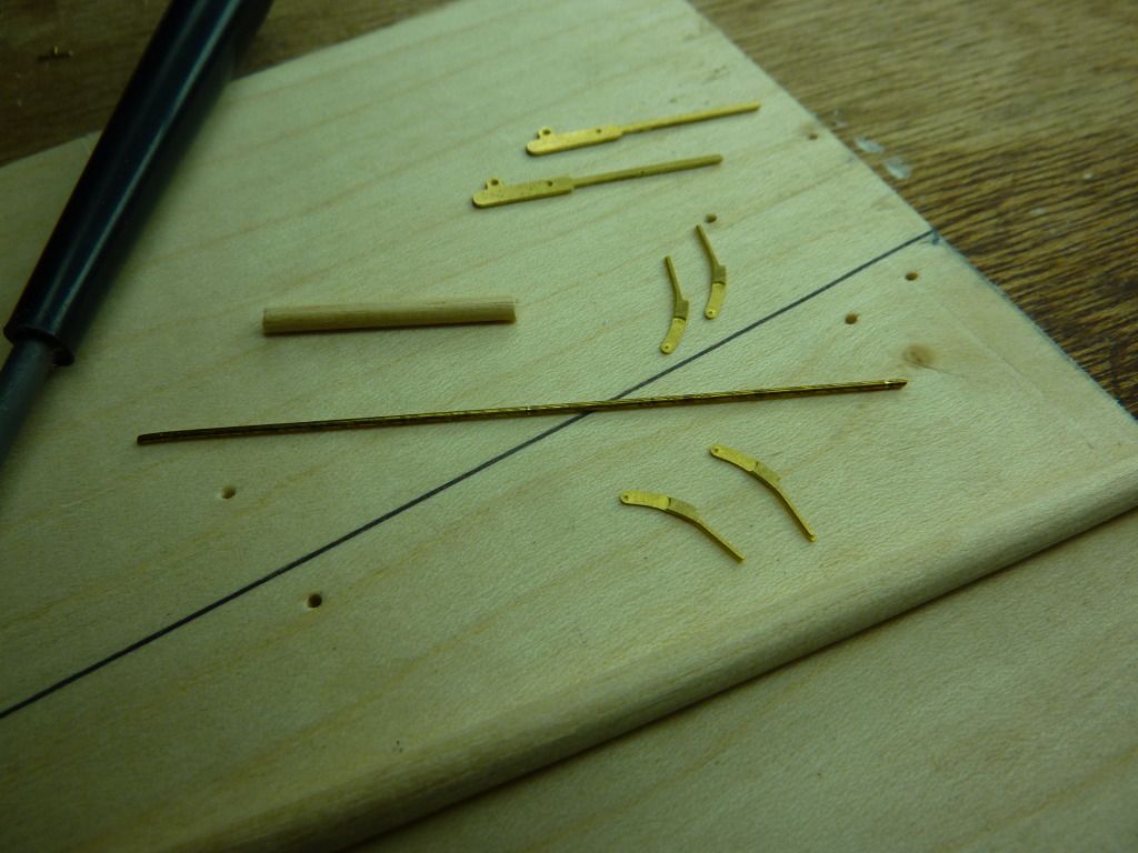

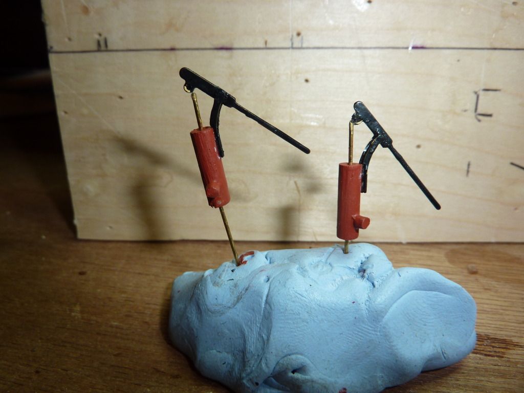

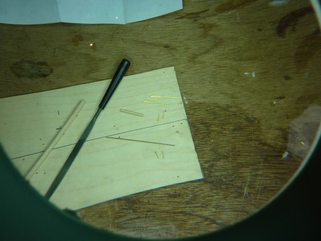

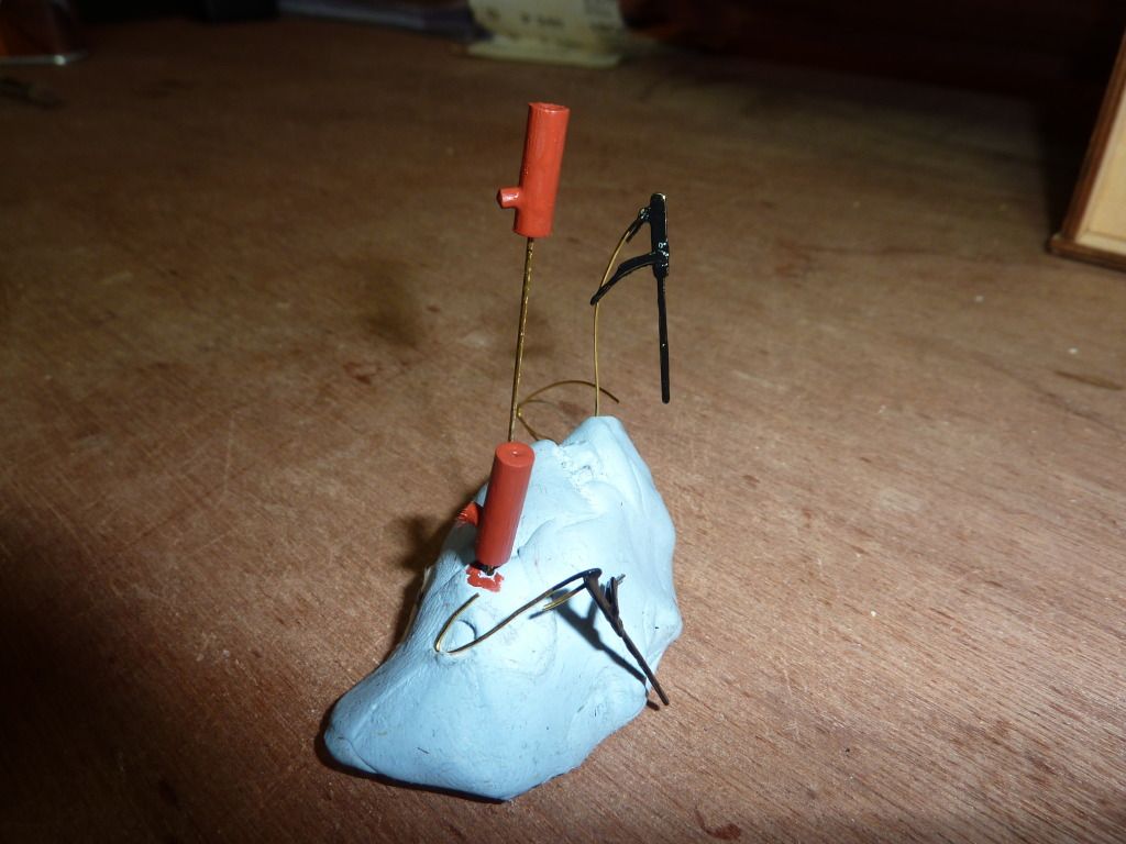

I bought 2 elm tree pumps, and I am now in the process of trying to get these made up, to look like something half decent.
Also glueing in the cannon ball's to the rack's.

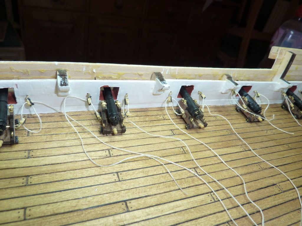

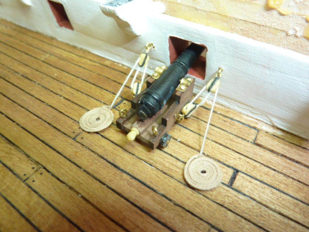

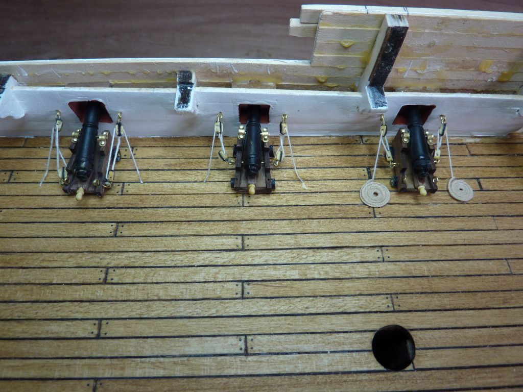

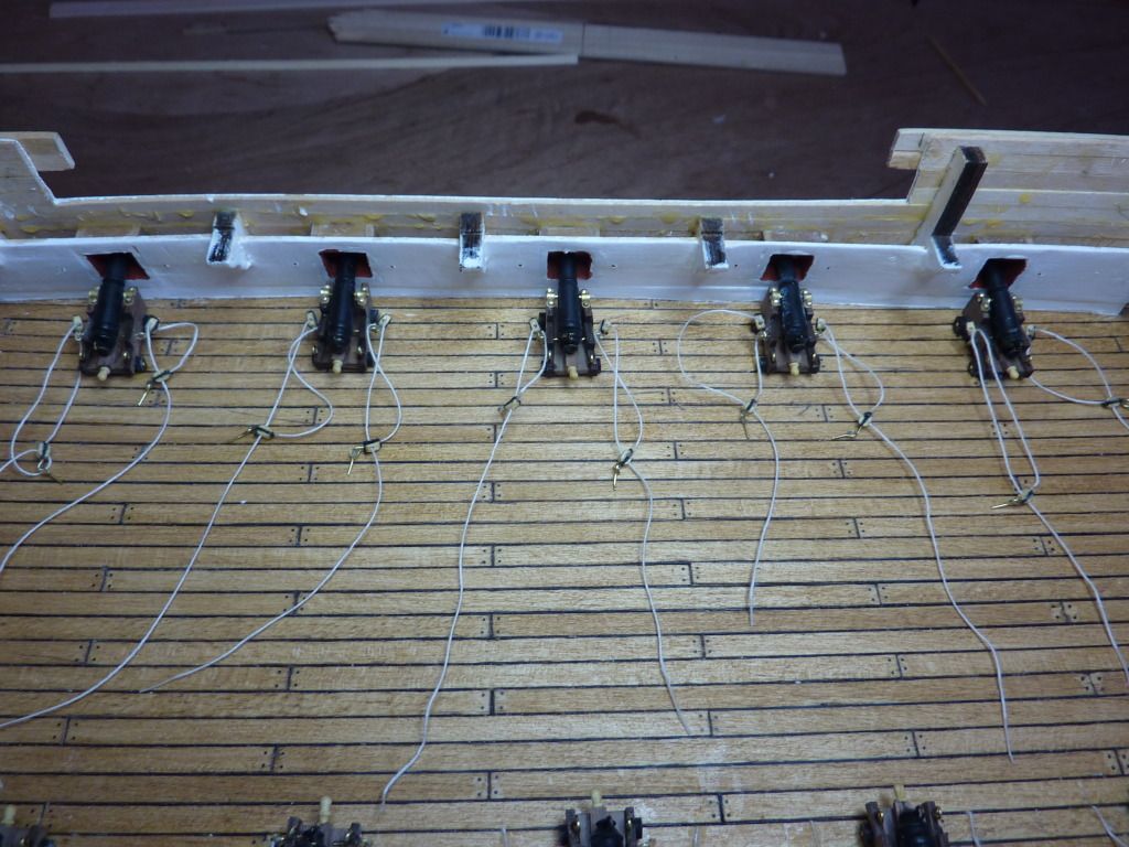

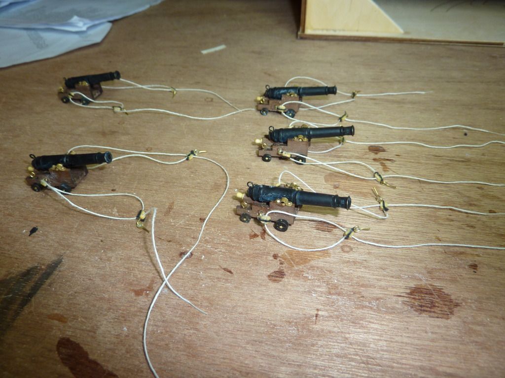

My next job has been the positioning and rigging of the cannons, Quite a lot of fiddly work here, I got most of my tips from "son of bulwarks " build on the Victory builds, I have fixed 3 cannons and got them rigged with the block and tackles, I am happy at my first ever attempt to do this, It took me abou 4 hours to do the first one, but now I am doing them quicker,
I had previously made rope coils, to put at the cannon sides, but the rope I used was to thick to go through the blocks, I have done one cannon with them, but as this cannon is hidden under the deck I am going to leave it and try to make coils out of the same material, Hope to get a lot better at this before I do the top deck cannons.

I have now got one side of cannons fitted and rigged with blocks and rope, But I still have to get a rope put through the eyes at the back of the cannon rig, that's the rope that goes through the eye on the cannon barrel, I will attempt this in due course,

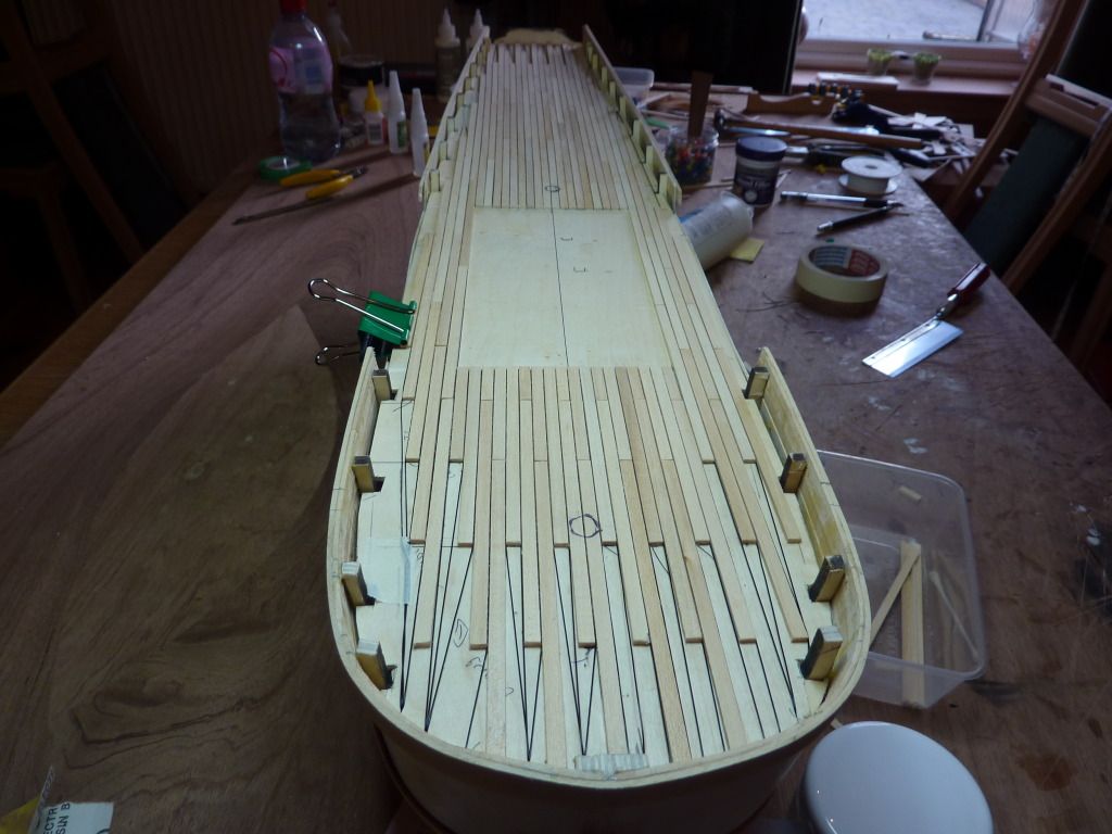

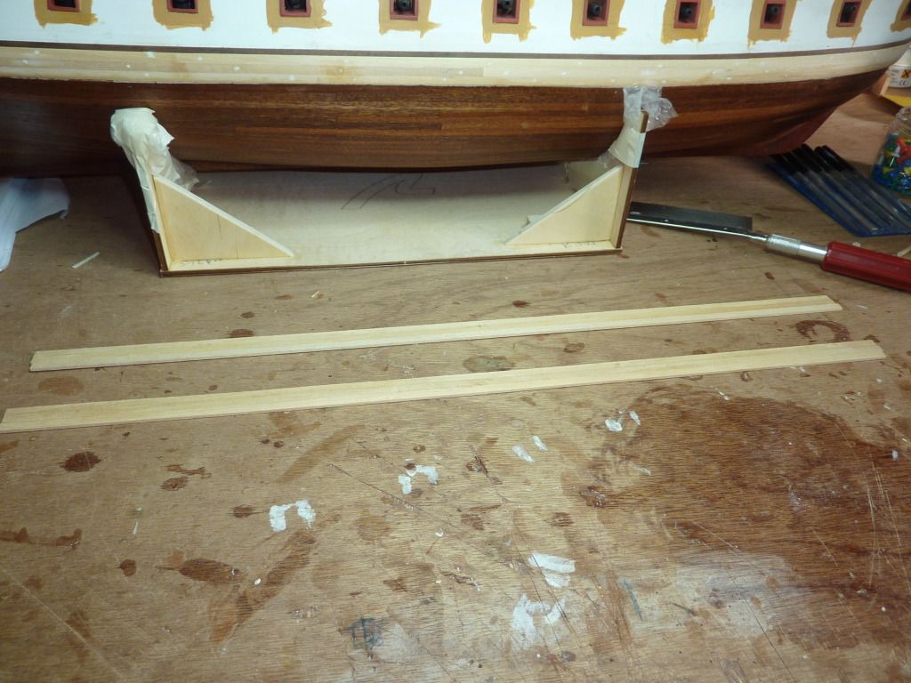

Harty asked me if I was putting a border plank round the top deck, And to be honest I had not really thought about that, I have glued 3 planks together to form the bulwarks for the top deck. I am going to put the ply deck in place, place the border plank round the sides, and mark its position on the partially planked deck. I will then plank to the lineto the line of the border plank before fitting the deck. Which really means the top deck will be fully planked, inc the border plank before fitting, and after it is fitted all I have to do is fit the bulwarks wich has been pre formed, sounds ok, but we will se what happens in reallity.
The pre formed bulkarks 3 planks wide.
Sanded ready for use.
I will work away at this in between fitting the last 6 cannons.

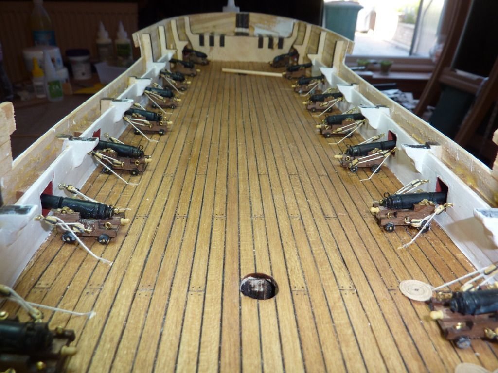

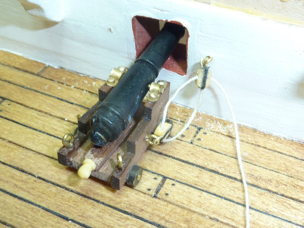

Making a bit of progress now, I have now got all the cannons fitted to the lower deck, It took me ages to do the first cannon rigging but the last 6 went in a treat.
I have also made the handrail for the hatch.
The pumps are also complete and painted.
and I am now in the process of completing the planking to the upper deck including the border detail.
