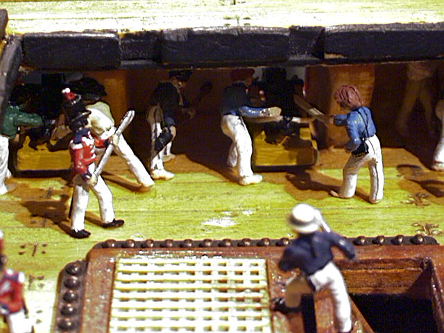

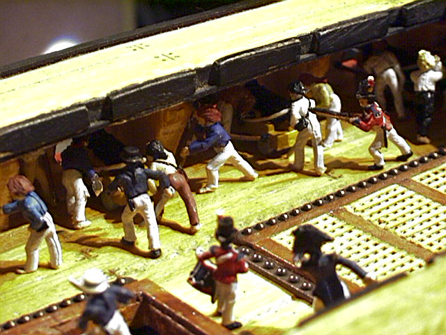

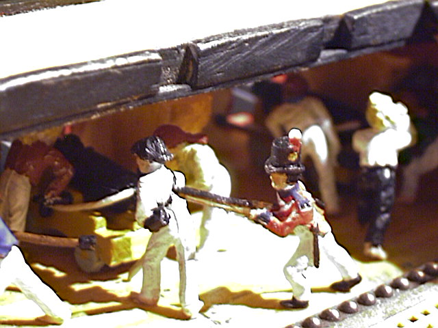

I think there are some issues with Minifigs at the moment, I bought in bulk some years back and although In have quite a few left I have run out of gun crews. With the re awakening of the project, I started looking again and it seems that they are only available from re-sellers at the moment, and no gun crews listed Crying
Here's a shot looking down into the upper gun deck (the only part to be manned at the moment)
and a few of shots at gun deck level (skid beams removeable)
