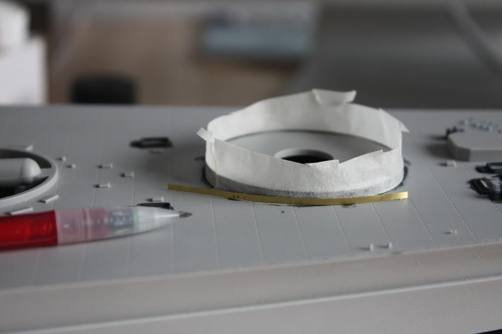

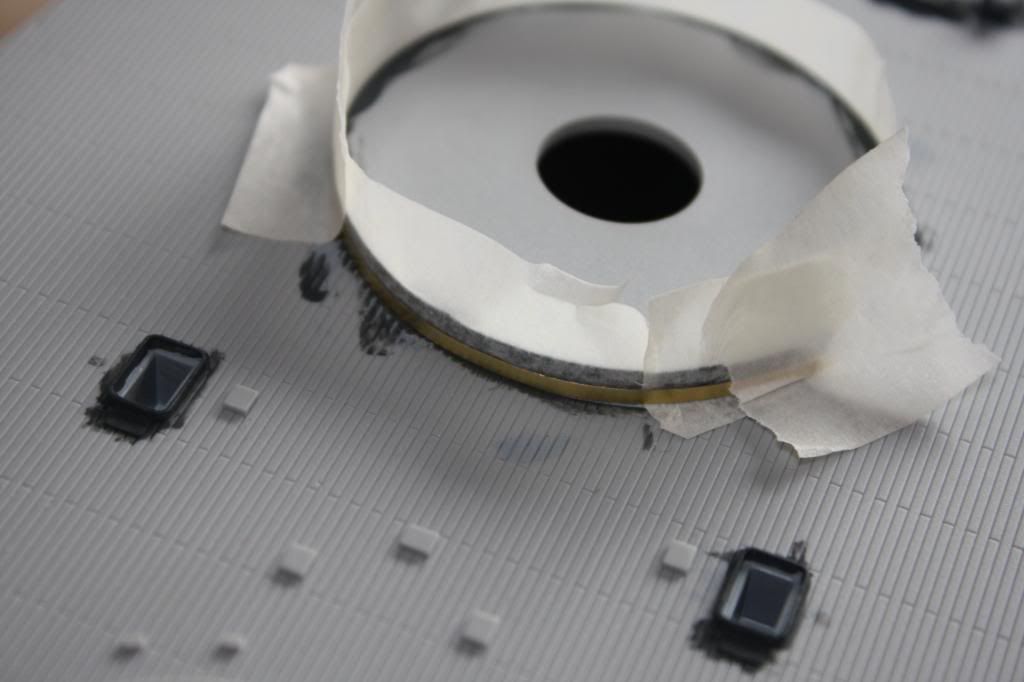

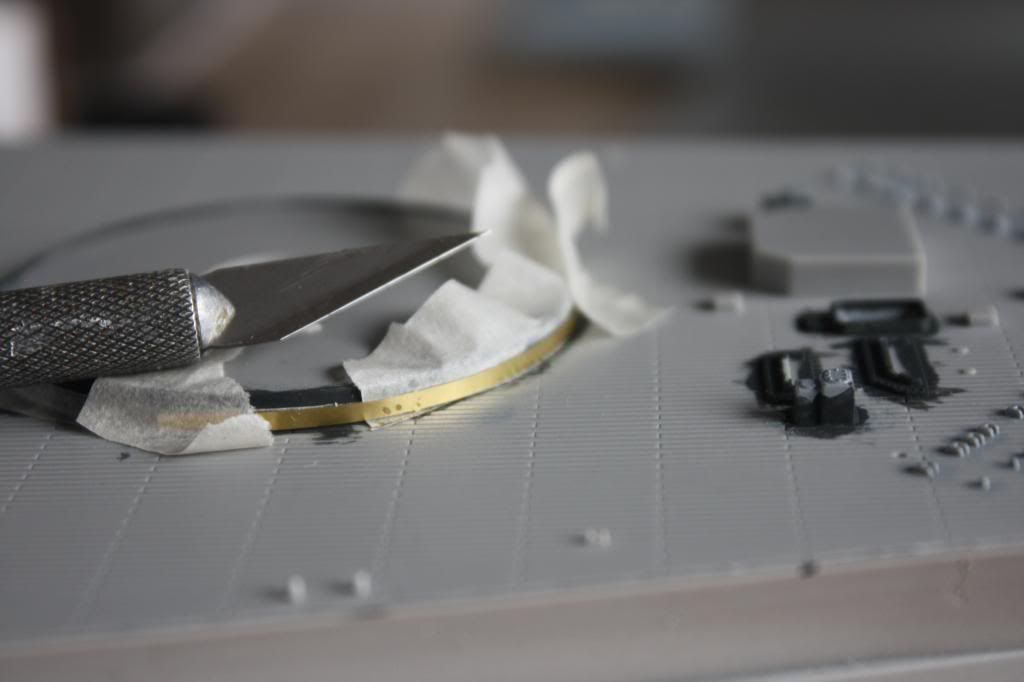

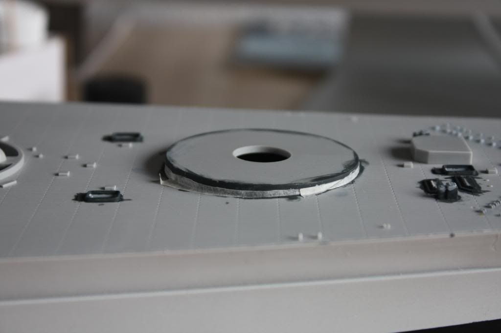

Painting the deck continued
Total build time 34 hours

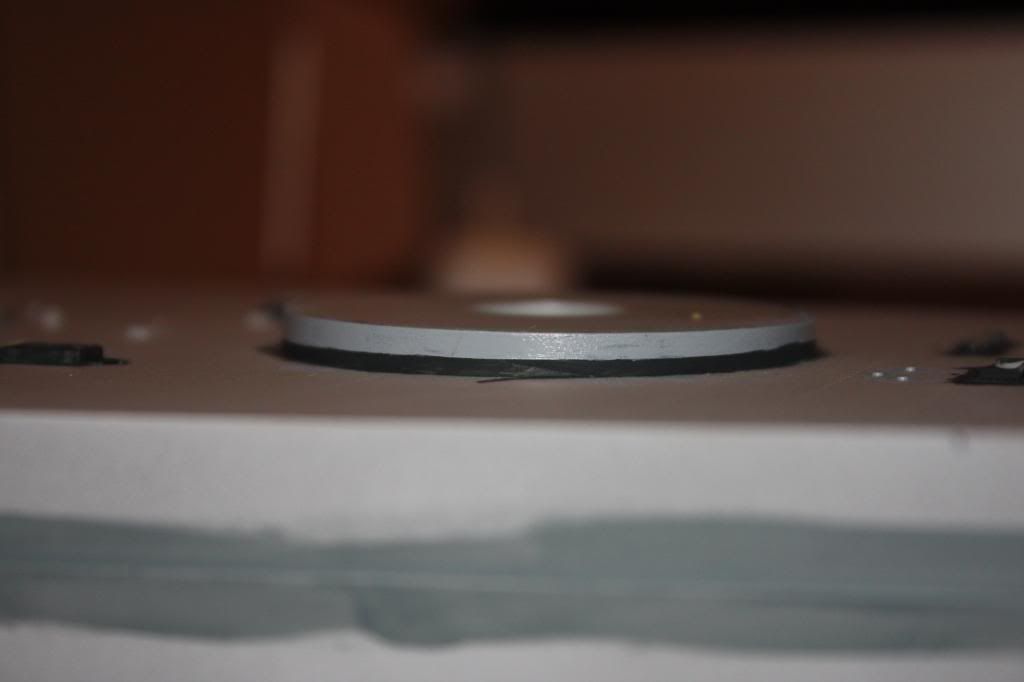

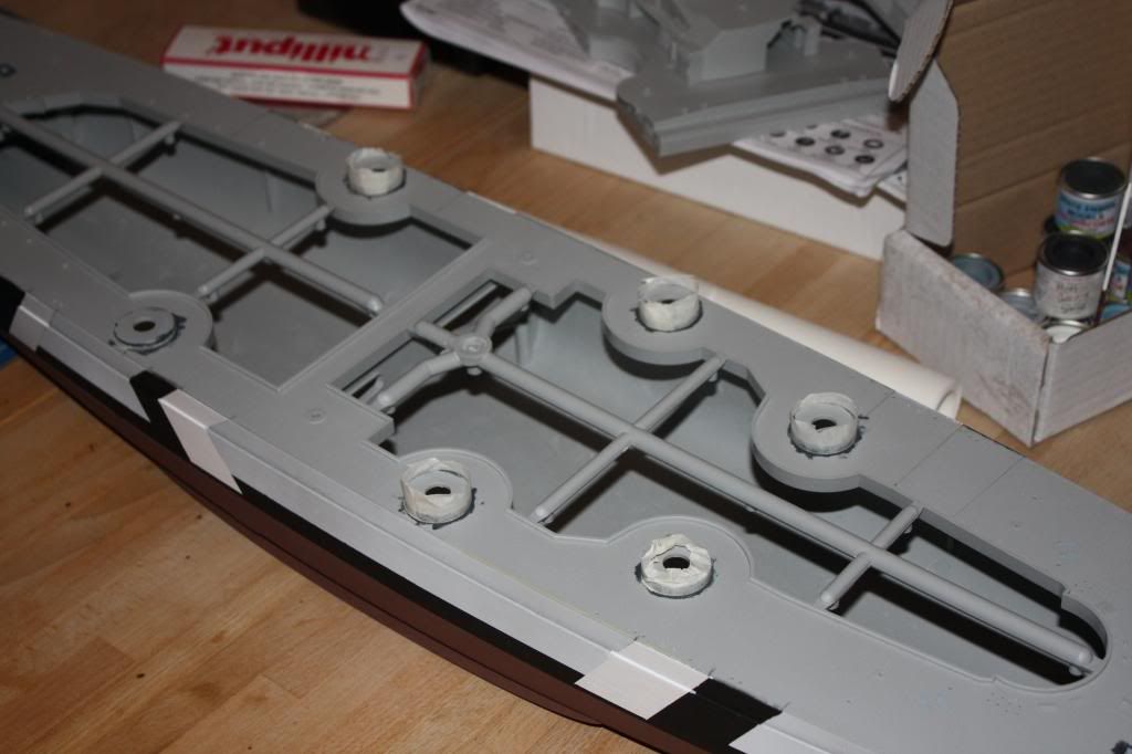

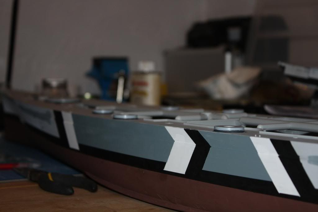

Today i have concentrated on the armament mounts. As described in my last build post these have a dark grey stripe at the bottom, so this is how I did it... First job was to mask the mounts off, that i painted dark grey yesterday, I have used low tack decorates tape but , make sure the tape is fully in contact with deck. I have estimated the stripe to be 1.5mm bearing in mind i will be overlaying the deck with a wood deck. I found a strip of scrap etch that was perfect for the job of creating a cutting edge, it is important to use something a sharp blade wont damage etch is perfect as it is flexible for the curves. Placing the brass strip against the mount and square with the deck i tacked the strip in place.
Using a new blade i carefully but firmly scribed along the cop of the brass strip to cut through the masking tape being carful not to damage the surface of the plastic. the length of my strip meant i had to position the strip twice for the secondary armament mounts and four times for the primary gun mounts. Once done i could remove the top part of the masking tape leaving a 1.5mm masked of strip at the bottom.
The mounts needed two coats of paint but once the masking was removed i think i got a reasonable finishRazz
As always any constructive comments most welcome.
J

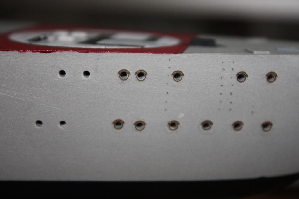

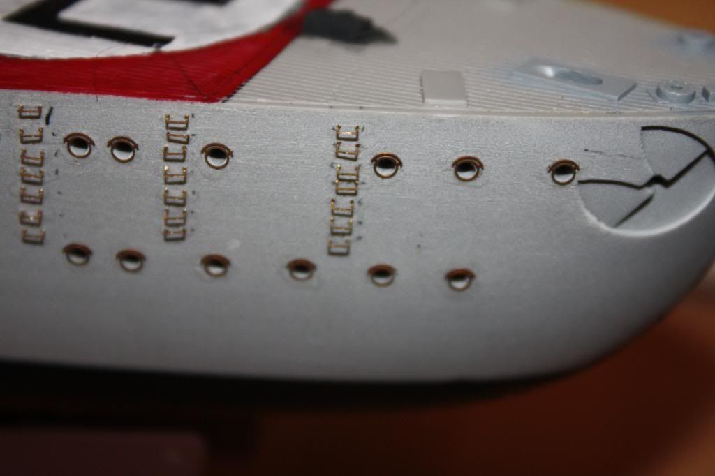

#128 Posted : 30 March 2013 23:56:02
Upgrading the hull.
Total build time 39 hours

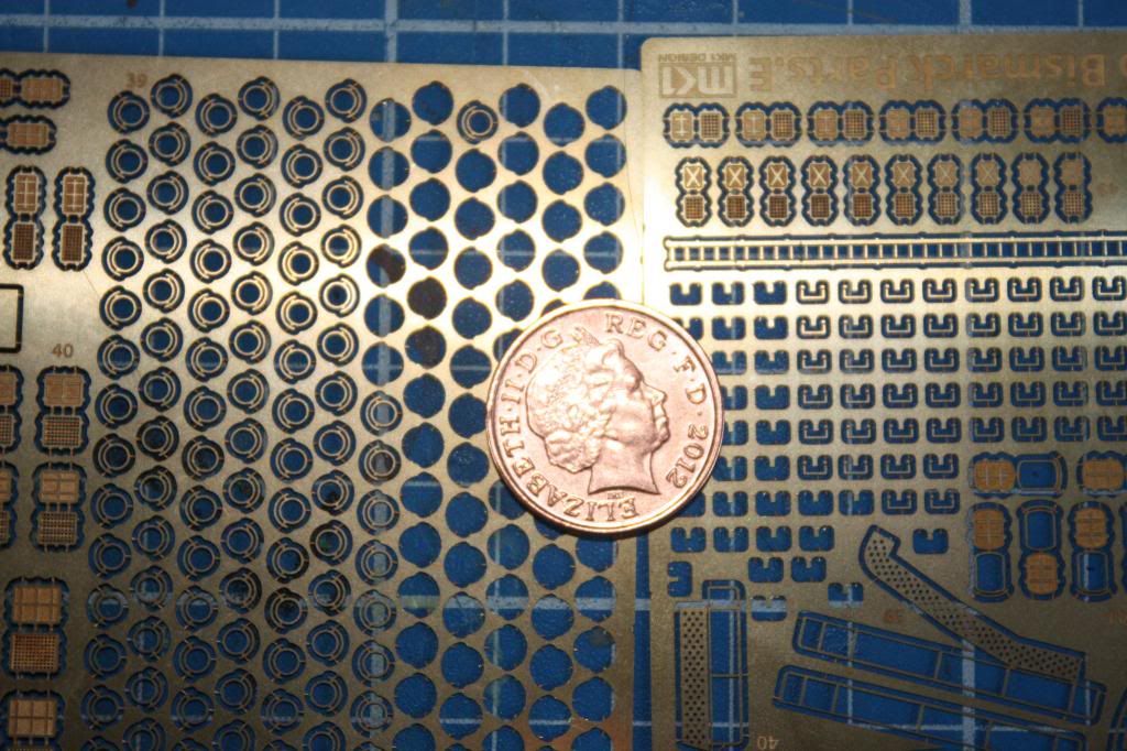

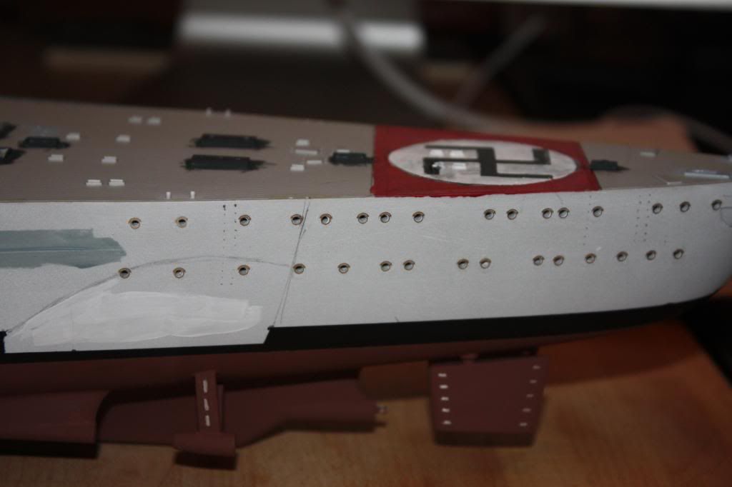

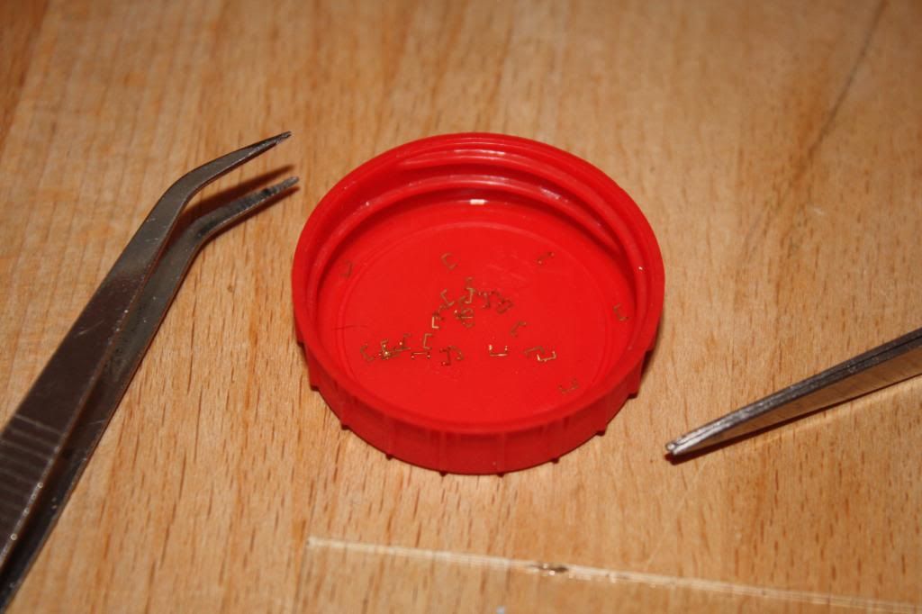

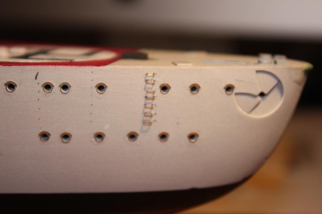

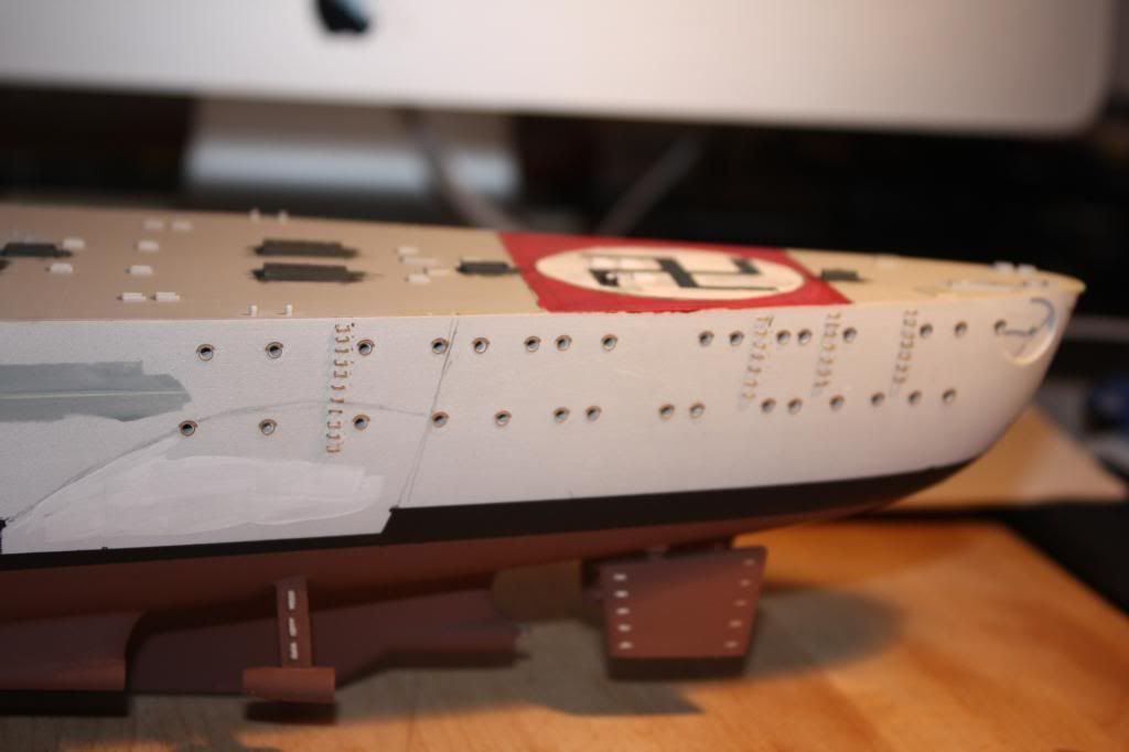

Started adding the MK1 Design etch to the hull. i have decided the best way to brake up the repetive work is to do the hull in sections so i have done both the scuttles and the hand irons on the port stern. The scuttles look splendid and when on really easy thanks to my new gem picker (thanks for the link TomicCool ) The hand irons a re a time consuming job I needed a magnifying glass to fold the ends but it does make them easier to fit in the long run. the irons should be 2mm apart i had marked this on a strip of card then marked up the hul in pencal as a guid when fixing the irons on. I have a brass propeller protection kit on order from Germany that i think is winging its way over strapped to the back of a snailHuh. Thats it for now.

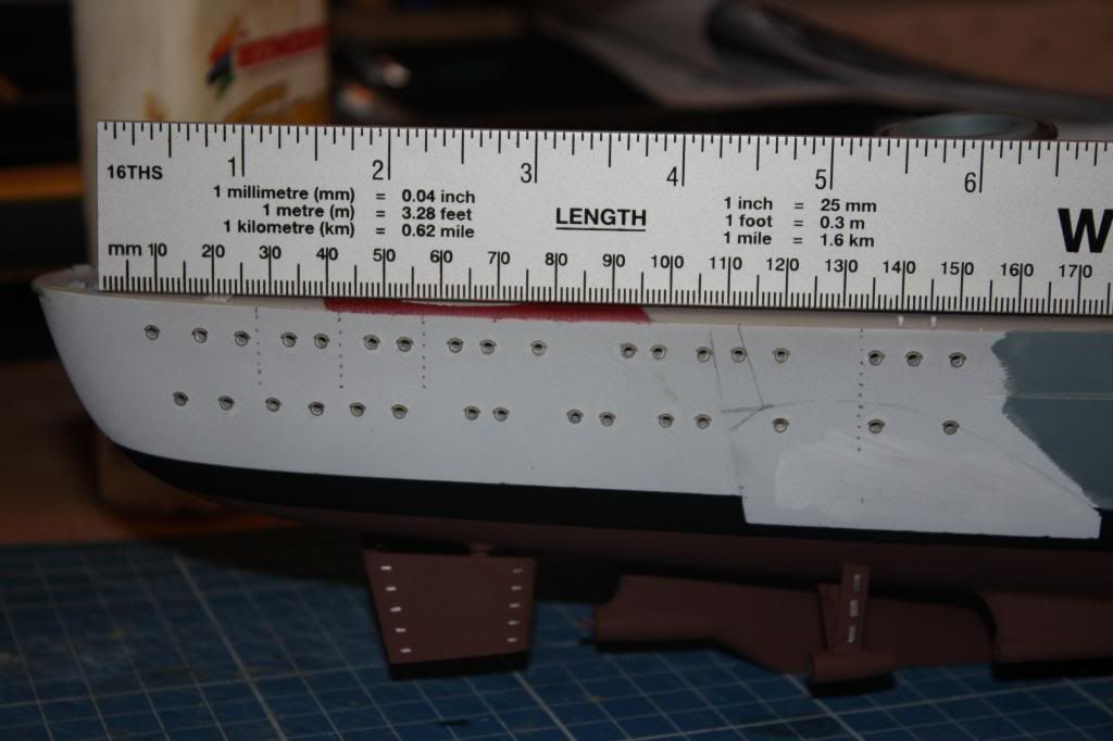

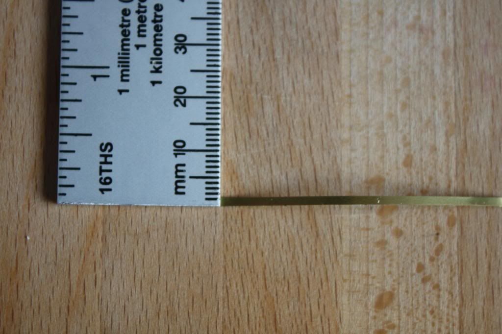

Just for you Steve,
The hand irons are 2mm across and there is a fold needed at each leg end. the overal ship length is 125cm or as my dad said blooming eck is it a canoe - which is i think an old engineering term for 125cm LOL
