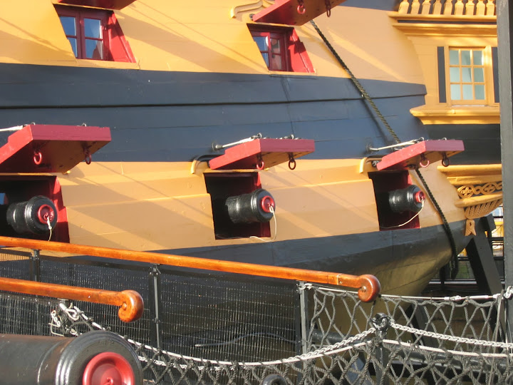

A small interim post concerning the gun port lids.
Again, after studying photos and plans I made a little template from brass sheet that can be placed into the gun port opening and the holes for the lid ropes drilled into the hull.
I noticed that not all the ropes exited the hull at the same height above the openings and a couple were closer to the centre than the others, hence the various holes in the template (also the need to clear some mouldings).
The ropes themselves were guided through the hull inside lead pipes, and on the outside of the hull was a leather gaiter to help keep the hole water tight.
To try to replicate this I am using small lengths of black heat shrink sleeving. My first idea was to fix the heat shrink into the hull, unshrunk, as it were, with the rope attached and then apply the heat so that it shrunk around the rope creating the cone effect in the photo above, but the smallest size I could find (1mm), looked too large, so the plan is to thread the rope through, shrink it around the rope, then glue the rope into it, all before fitting into the hull.
As for the port lids themselves, I am using the ones supplied with the Del Prado kit. I have searched for others but the sizes are not quite right. I have painted them black on the outside and red ochre on the inside, and used the small PE eyebolts to enhance them. I decided long ago not to use the supplied hinge pieces as they did not look accurate, and fitted brass rain drips of the correct shape over the gun port openings. The lids will just be glued into the gun port in an open or closed position. Below is a photo of a "test run" to see how it looked.
I will probably reduce the amount that the sleeving sticks out.
To prevent going crazy, I will do these in stages and only fit the port lids in place where it may be awkward later, like under the channels etc. to prevent snapping them off when handling the ship.
After doing the test run, I thought of another enhancement to drive me bonkers Blink
I made some small brass washers to tidy up the hole and hopefully give the look (when painted black) of the gaiters on the real ship seen in the photo above. Below is a dry fit in the hull.
These little blighters started life as the rings on some PE hooks, I had to drill out the hole to enlarge it then file up the edges once it was cut from the hook. Now that I have found enough to do the lot, I will paint them first and glue them to the sleeving before fitting into the hull, I can then use it as a sort of depth gauge to keep them all the same.

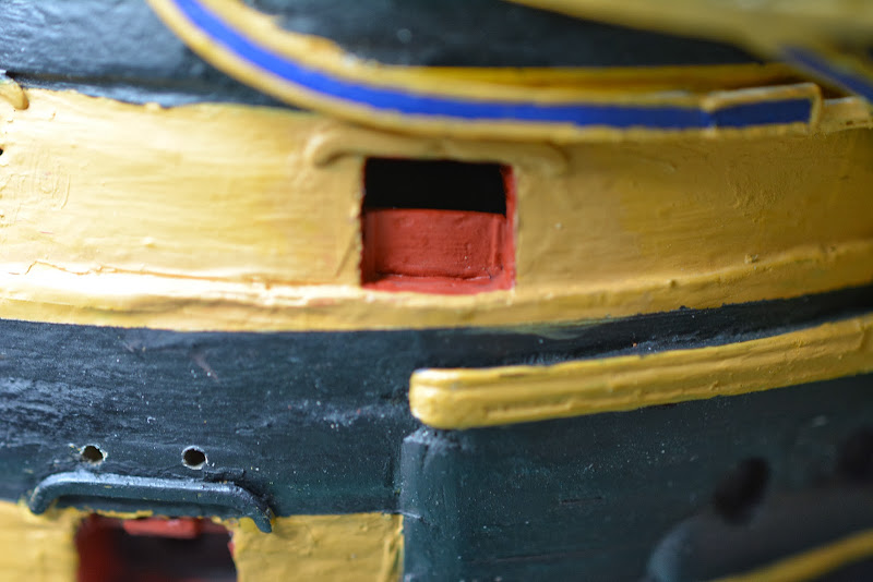

Well, here we go with another little update, not strictly the gun port lids as promised, but related.
While I was checking drawings etc relating to the gun ports, I was reminded (again) that I had not done anything about the sick bay windows on the middle gun deck at the bows.
These windows are a bit smaller than the gun ports, with side opening doors, there seems to be a removable board blocking the bottom half of the opening, I can only think this was to prevent too much wind and spray getting to the sick seamen.
Most kits I have seen depict these windows as closed, either moulded into the hull or a separate moulded part to fix to the hull, unless of course you are Del Prado, in which case, you don't bother to depict it at all Huh Mind you, they didn't even get the amount of actual gun ports right, so I suppose that was a bit too much to expect BigGrin
They did supply a set of moulded closed doors for the quarter deck gun port, and I considered cutting off the rain drip part and using them, but they were still too large. So me being me, decided to go for it.
I knew the hull construction was very thick in that area, that's why I had avoided doing anything before, but throwing caution to the wind, I marked out the openings and with Dremel in one hand and file in the other, got stuck in Blink
Using the aforementioned tools and a small chisel, I rebated a 7mm square X 7mm deep (or there about) opening in the hull on each side.
After cleaning up the edges and touching up the paintwork I made the "removable" boards by cutting aftermarket gun port lids, (more about those later) in half and filing off all the detail, then fixing a couple of pieces of 0.5mm X 0.25mm Evergreen strip down the sides.
These were then painted red ochre, and after painting the rear of the openings matt black,
they were fixed it place, along with the brass rain drips used on the other gun ports. There seems to be a lot more room in this area on the real ship than on my model, from looking at the photo's it seems the blue and yellow striped carving goes up at a steeper angle than I have done mine, leaving it all a bit cramped.
For all my fellow "rivet counters", notice I had a go at Dremeling the little hand grips in the board BigGrin
