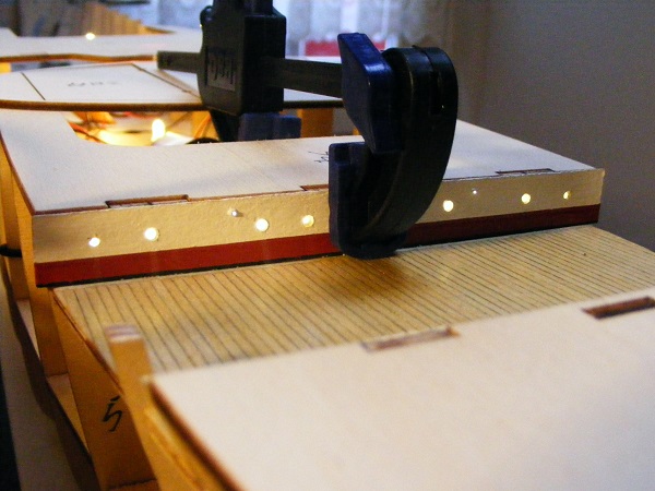

Today I got the bow well deck fitted in place and carried out some lighting tests using 2mm fibre optics.... Am quite pleased with the results of the tests while at the same time relieved.....Cool Cool .. Starting to work on the aft well deck now.....
Happy building all.
Tony C

Alan, That lighting looks very impressive. The whole ship lit up will be a sight well worth seeing.
Kind regards,
Tony.

Thanks for those kind comments Tony, much appreciated.... Cool Cool .. Lighting this one is going to be a project in its own right especially to get the effect I am after..... Cool.. Thanks again for looking in....

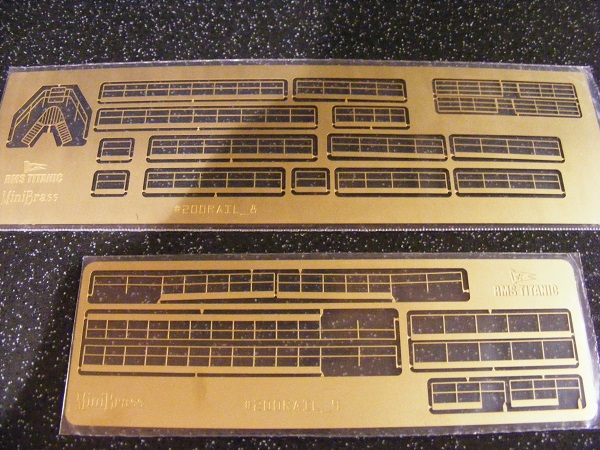

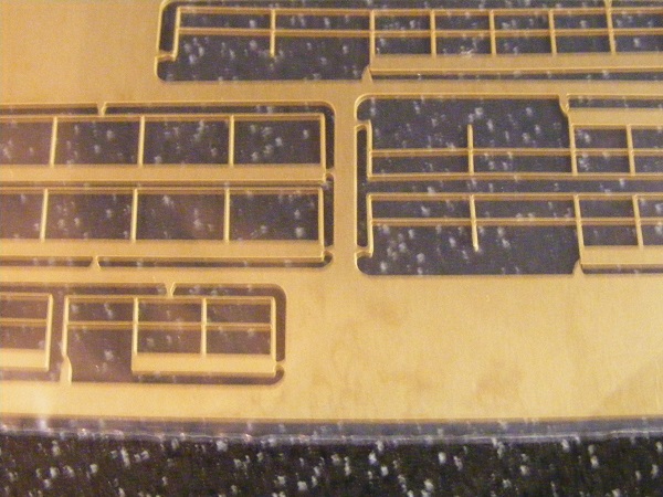

Hi all, MiniBrass etch I ordered arrived today which was a lot faster than I expected.... The first pic gives an idea of the ply etch railings supplied with the kit, following images show the Minibrass version. A little pricy but I think you will agree the Minibrass etch is far far superior and should make a big difference to the overall appearance..... Cool Cool Have never used brass etch before so if anyone has any tips on cutting, bending and painting then their tips would be most appreciated....Blink Blink

BigGrin Hi Alan
The etch will certainly make a big difference far more in scale than the wood parts. Here's a few tips that may be of help.
1/ Use diluted white vinegar to degrease the parts so there ready for painting
2/Use a fresh sharp blade to cut out the parts and cut out on a hard surface like a piece of glass or such like.
3/ Be carefull at all times when handling etch parts they can break and bend in all the wrong ways if your not vigilant, they will also be stolen by the carpet gremlins if your not careful aswell
4/ I have added the links below to some tools that may be helpful the cut out kit I would reccomend where as the hold-n-fold is more suited for someone who intends to use a lot of etch, although there are smaller versions available than the 5.5
http://forum.model-space...aspx?g=posts&t=8137
http://forum.model-space...aspx?g=posts&t=8138
Hope this is of help and good luck with the etch

Thanks Andy, had a feeling you would be the one to give advice to me due to the amount of etch you have worked with, your advice is so appreciated.... Am having a look at the 5.5 tool, but at the same time am trying to work out how it would be used.....Blushing Blushing Diluted vinegar tip is one I didn't know, I was thinking of cleaning using ammonia, not the nicest of fluids I agree but thought it would do the trick..... Cool Cool .. Don't have to worry too much about carpet gremlins as where I work is wooden flooring....LOL LOL .. Will now watch carefully on how the etch is handled, the etch received is to me quite thick and sturdy but will be careful all the same..... Cool,, Think you can see I have taken to his hobby in a big way and can seriously envisage using a lot more etch in the future so maybe the 5.5 will be an investment worth making....Cool Cool .. Thanks again, appreciate the assist as always...

BigGrin Hi Alan
The 5 x 5 tool is a good investment is top quality and will last for years, as to your question about its use, the black plate is the base and the aluminium top part is the bending aid all the sides can be utilised to shape etch parts it has has various arms to aid in bending and also cut outs where the etch can be shaped like the circular and off set shapes which are good for railings that curve.
How its used for general bends is the etch is placed between the bottom plate and top plate and the hand screws used to hold it in place then a blade is used to bend up the etch to the required form.
The other cut outs and off sets are for more complex bends that require a little more patience to fabricate but do work well with care.
I have found it to be a great aid and still wonder at times how I managed without it, if anything is still unclear please dont hesitate to ask

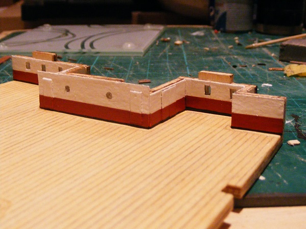

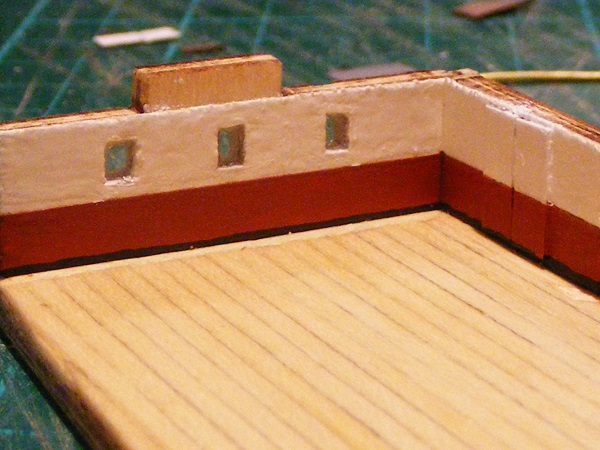

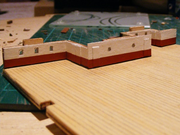

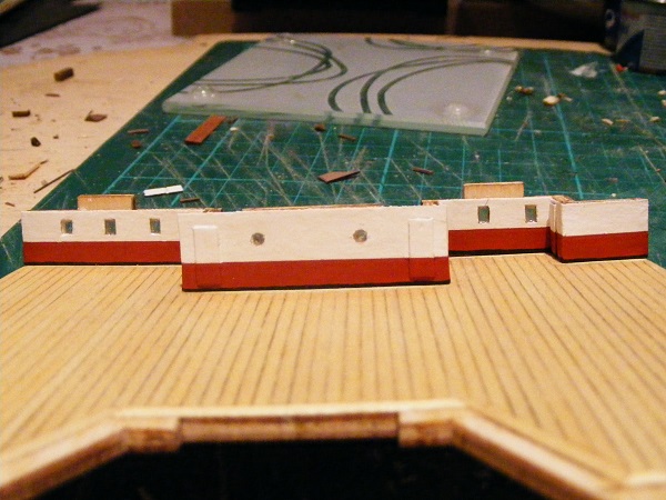

Progressed a little more by completing the rear most bulkhead on the aft Well Deck.....Cool A number of modifications here, all of the windows and portholes had to be measured and cut out, none of these appear on the instructions or plans. 4 of the inner doors also had to be made and attached, again not shown on the instructions.... Windows and portholes have had the glass added using Krystal Klear. Inside the alcoves it looks as if winches and pumps were fitted and it doesn't look as if these have been provided either so am doing some research to see if these can be scratch built.... I believe them to be important features and hopefully light from the windows will light up the alcoves so they can be seen..... Cool Cool Next up is to start on the other bulkhead....
Happy building all
