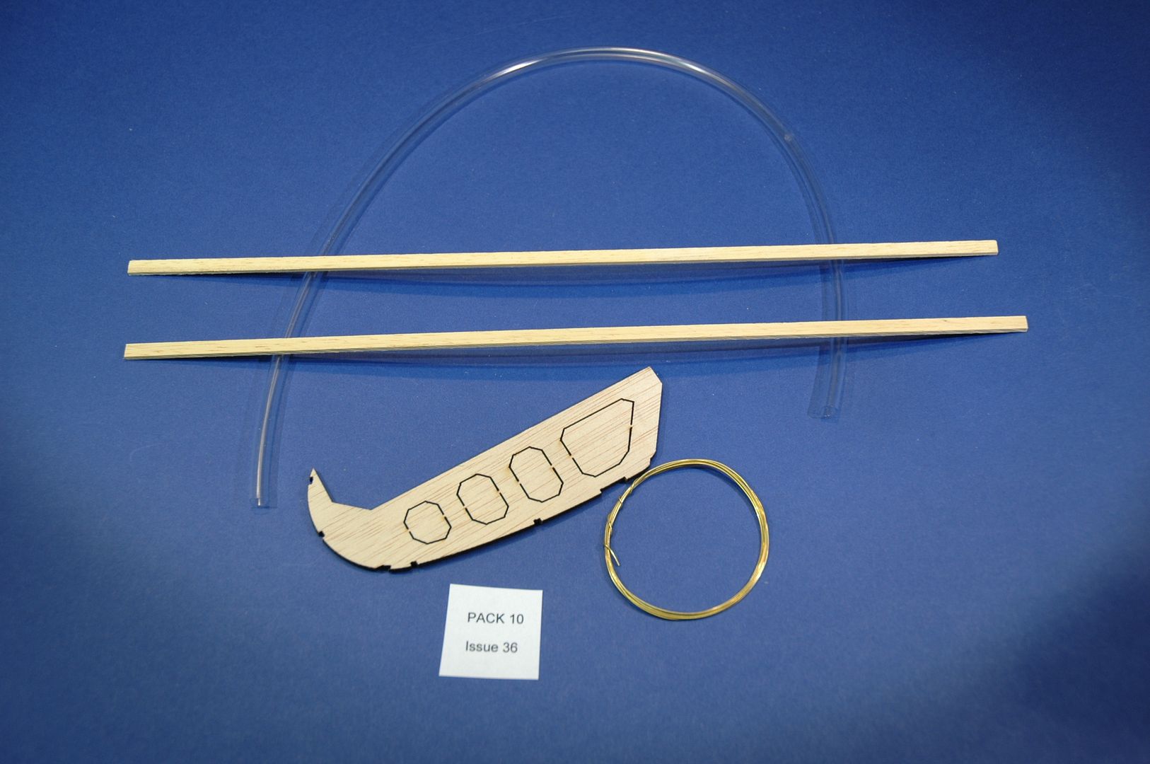

Issue 36.
Tail fin flap
Wooden strips 2x5 300mm
Brass wire 0.5 mm
Plastic tube

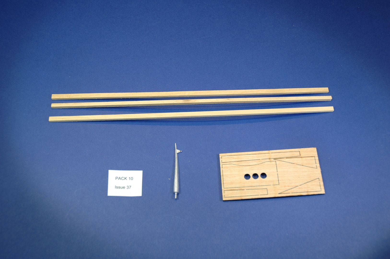

Issue 37.
Fuselage reinforcements fret
Wooden strips 3x3 300mm
Wooden strips 4x4 300mm
Antenna.

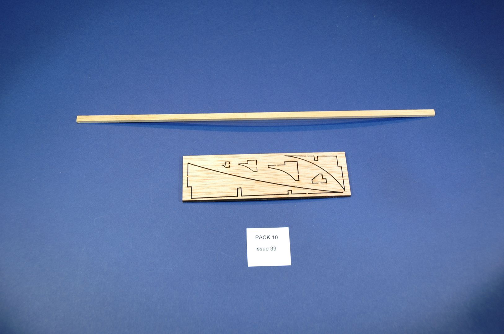

Issue 39.
Fuselage side reinforcements fret
Wooden strip 3x5 300mm

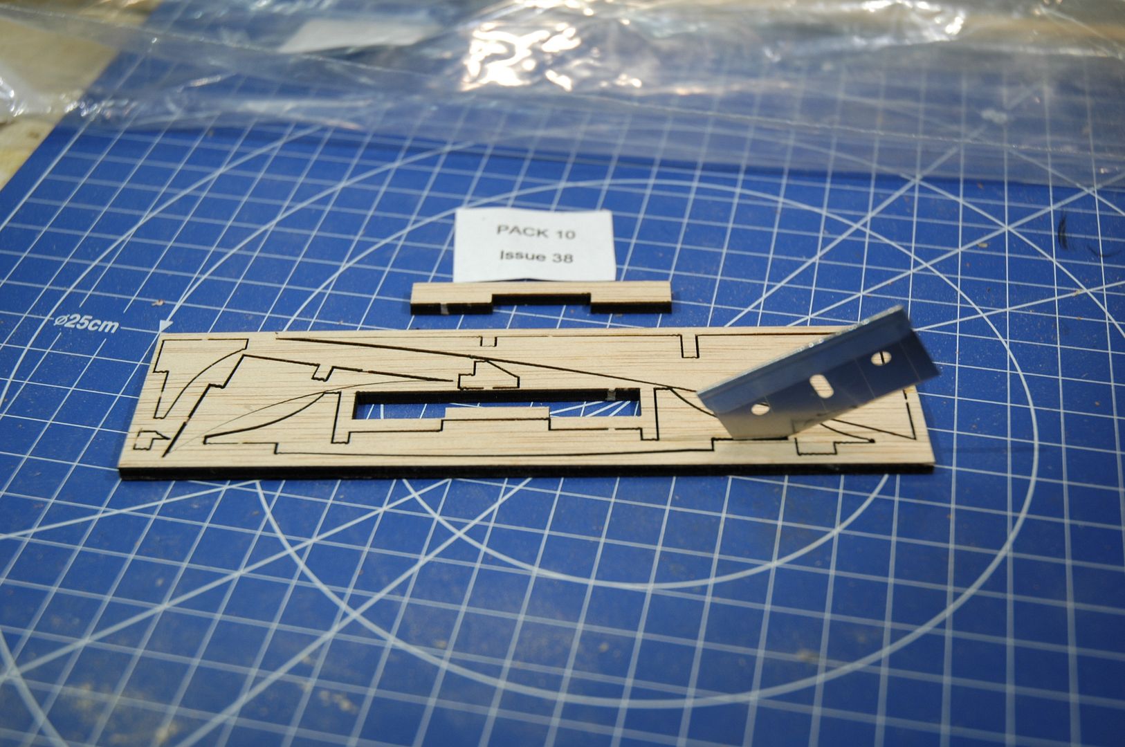

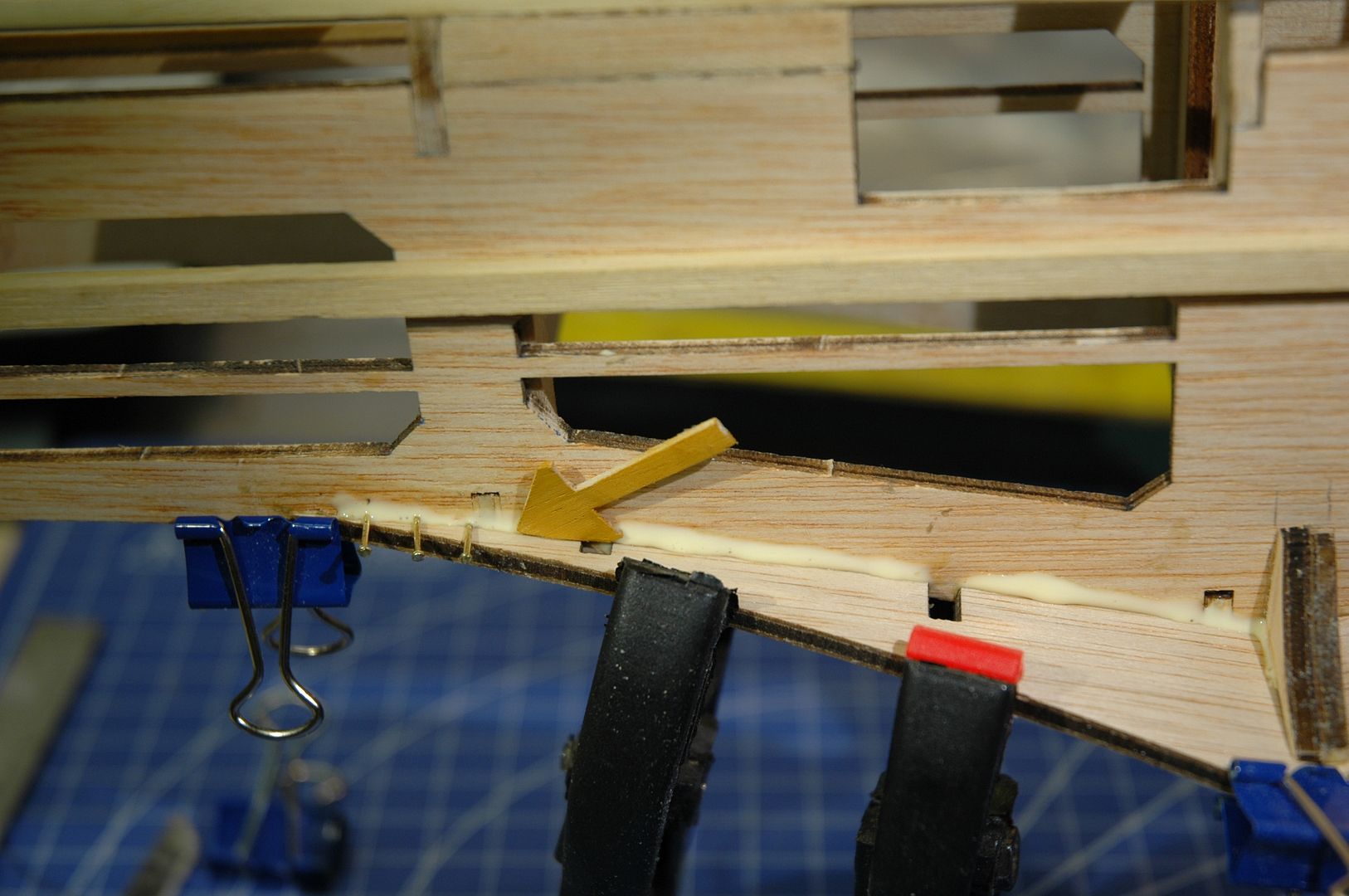

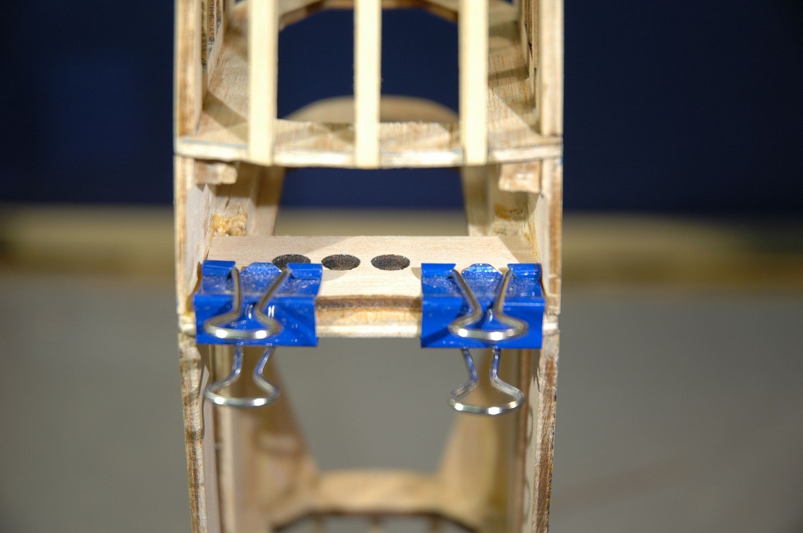

#123 Posted : 11 June 2014 18:55:46
Hi All,
Pack 10.
Stage 37.

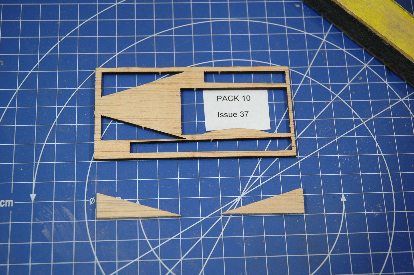

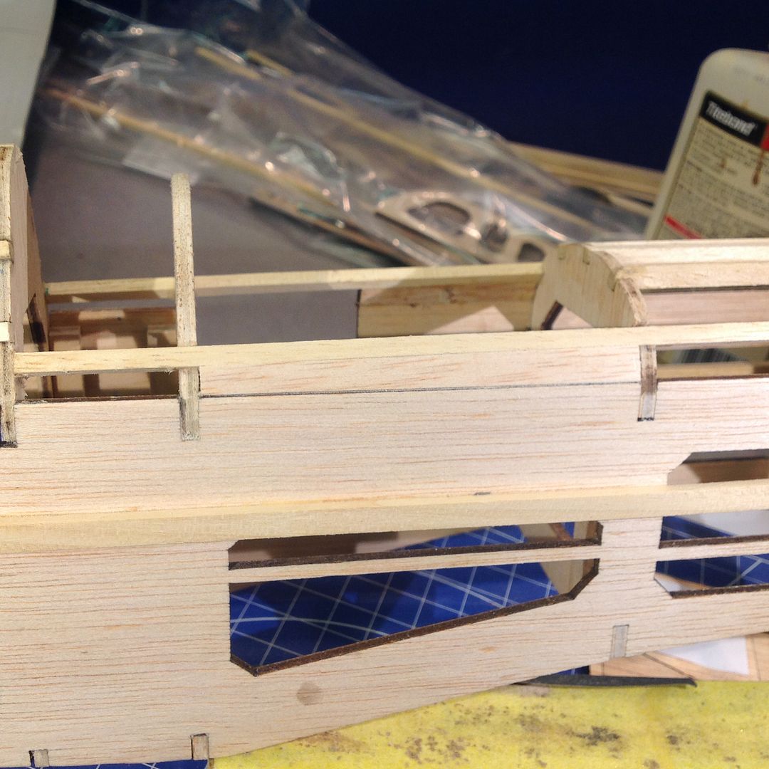

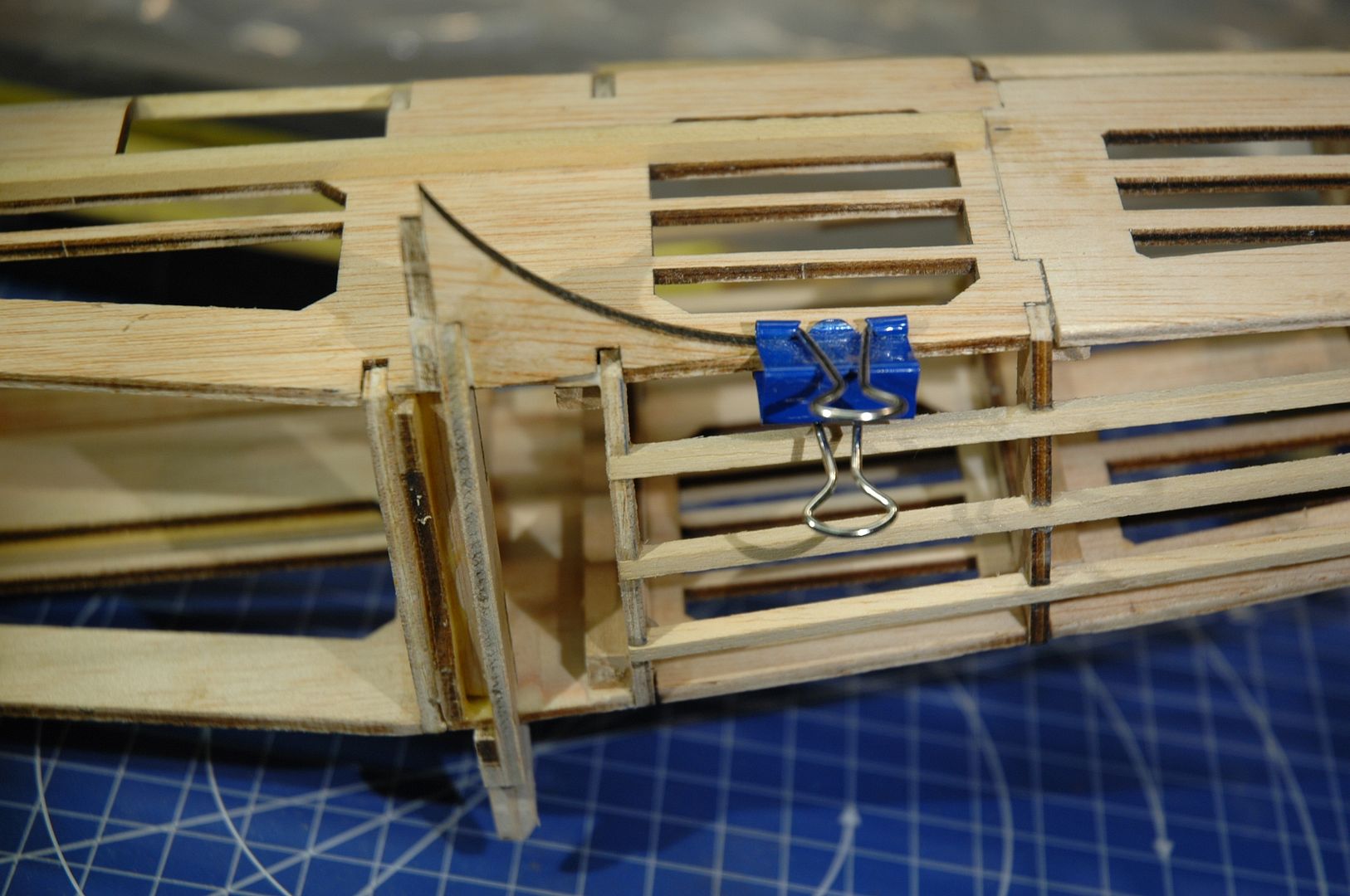

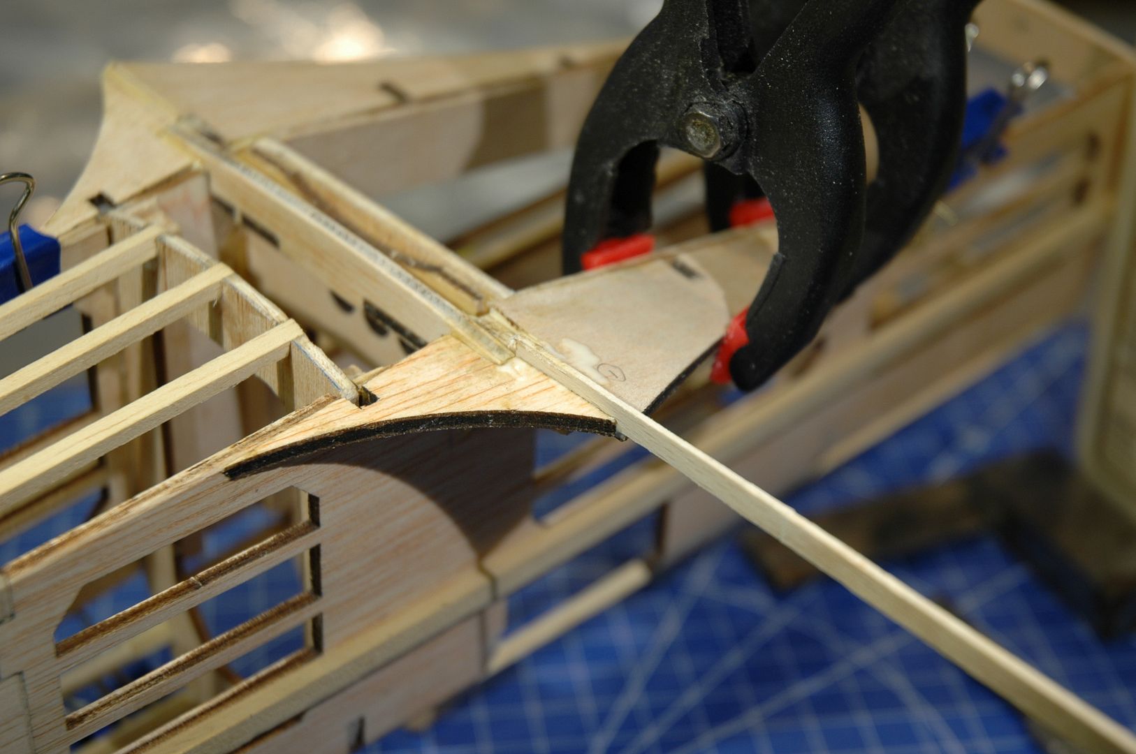

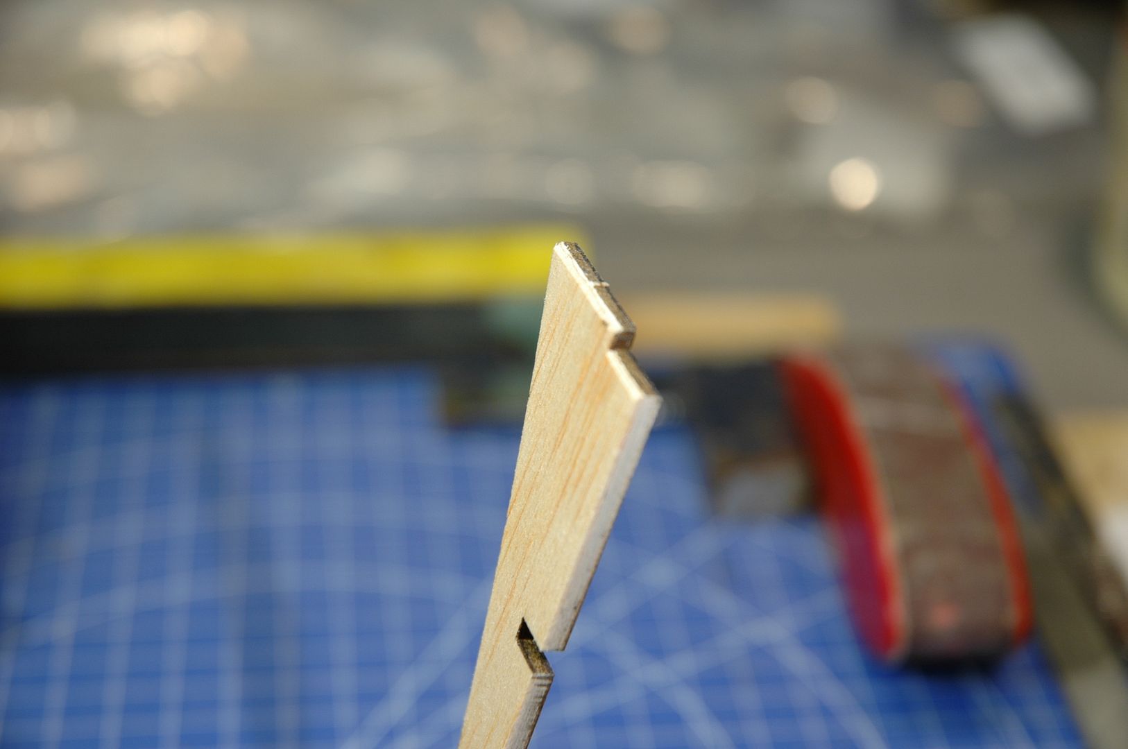

First job was to remove the piece with three holes from the fret and test fit before gluing, this was a good fit in my case and just need a light sanding and glued into place as shown in picture( 1 )what I did find it was that it made a better fit by filing a chamfer top and bottom much the same as you would planking a hull, as shown in picture 2.
This picture shows a file chamfering top and bottom as you would planking a hull.

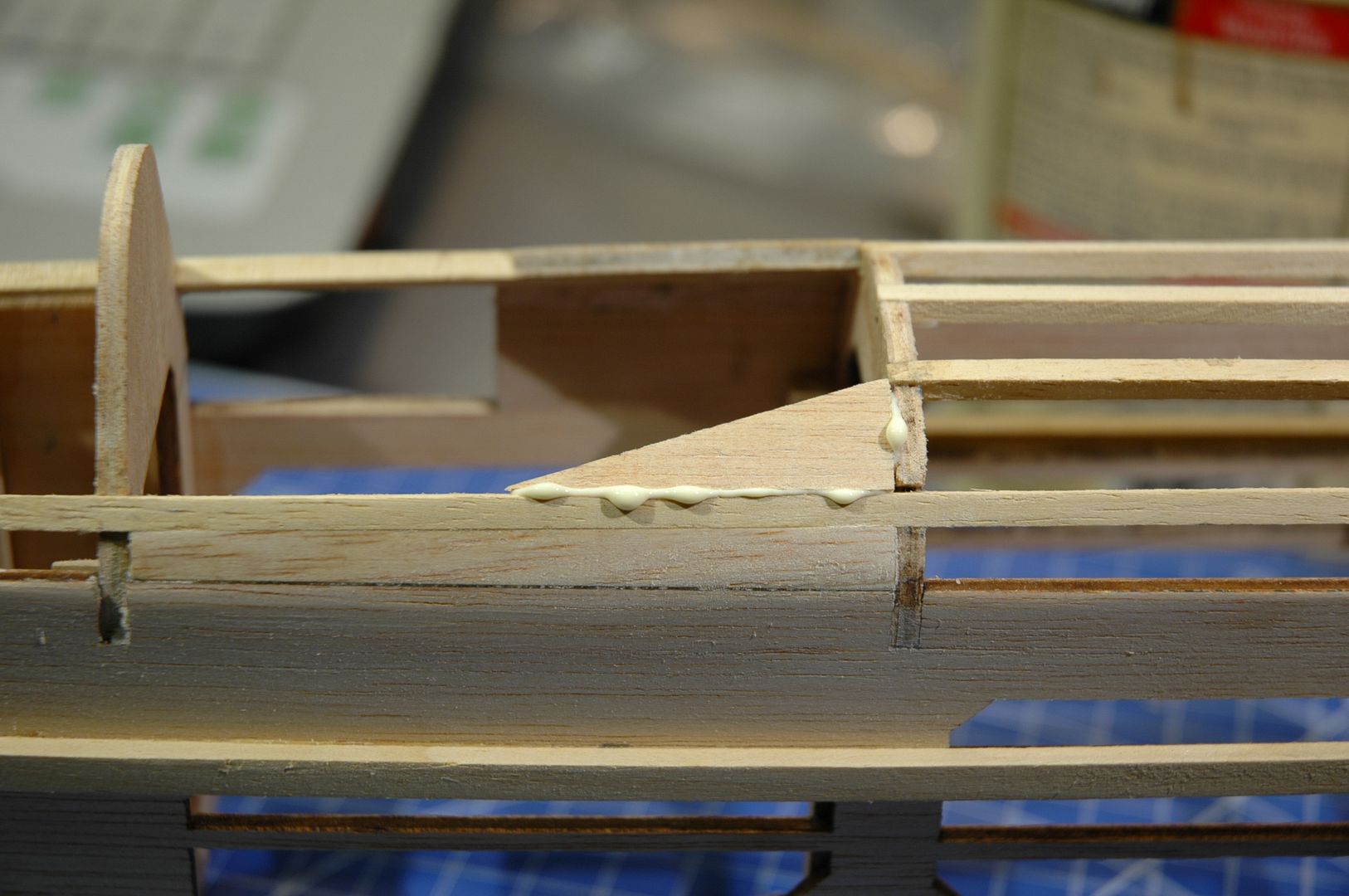

This picture shows the shorter piece glued and in place just slightly proud of the frame ready for sanding.
Next was to fit the longer piece, this was much the same as fitting the short fret, you may find that it is necessary to sand down to fit when your happy glue it in position. This fits on top of the wooden strip and the fuselage.

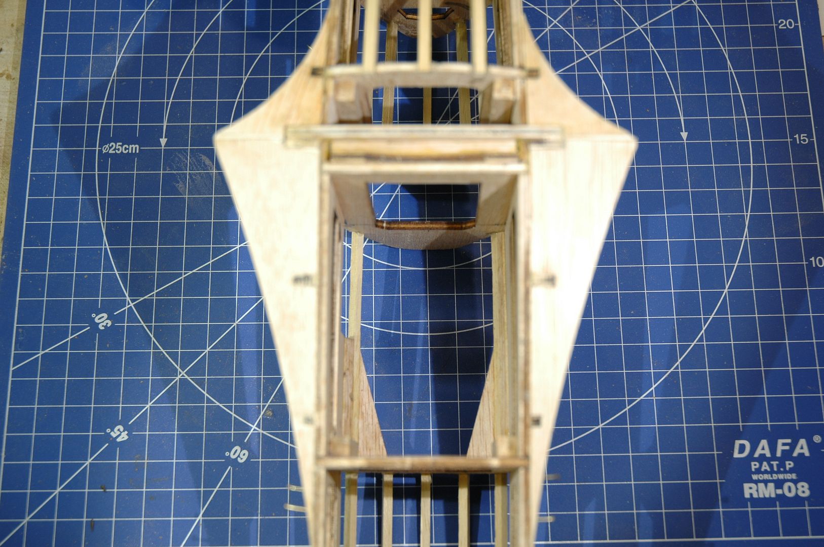

Next part was to remove the two fret parts and lightly sand them down.
[/URL
The first piece has to fit above the shorter reinforcement fret and against the main frame fuselage.

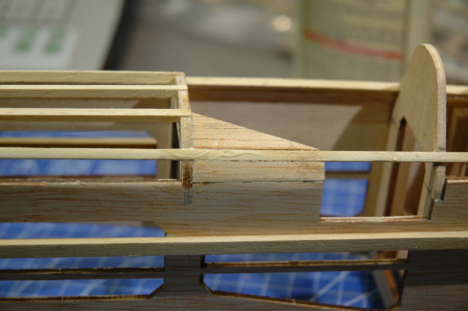

The last remaining piece has to fit over the longer piece of fret and up against the fuselage just proud ready for sanding.
This picture shows both pieces of fret in place.
[URL=http://s1134.photobucket.com/user/tf64/media/DSC_5794.jpg.html]
More to follow soon.
Regards to all,
Trev.

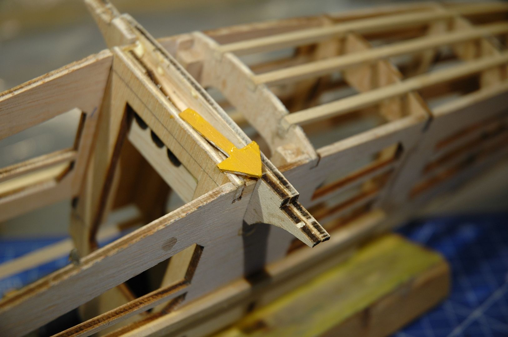

#130 Posted : 16 June 2014 21:47:49
Update Pack 10.
Stage 37.

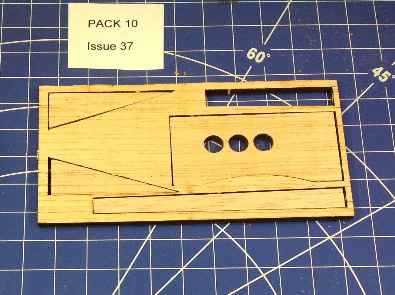

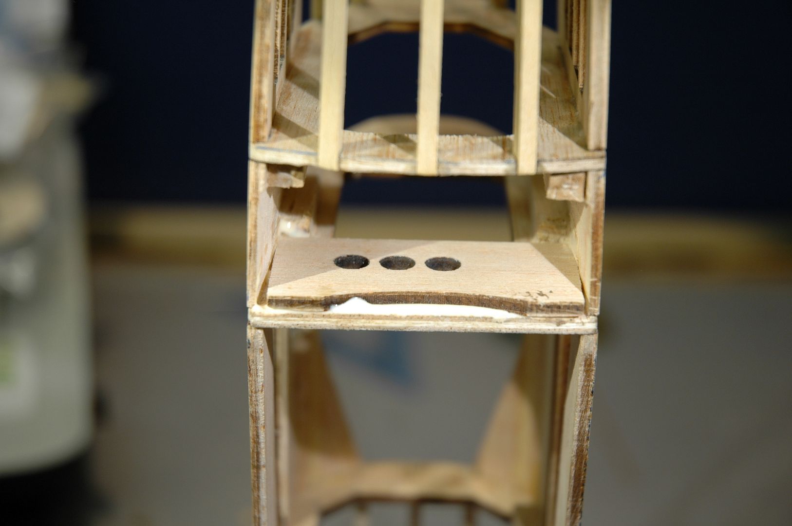

First job was to remove the fret with 3 holes, after sandpapering the ruff bits off I test fitted to the fuselage I found in my build very little had to be sanded off it was a good fit.
1st picture shows fret with 3 holes.
2nd picture shows fret in place.

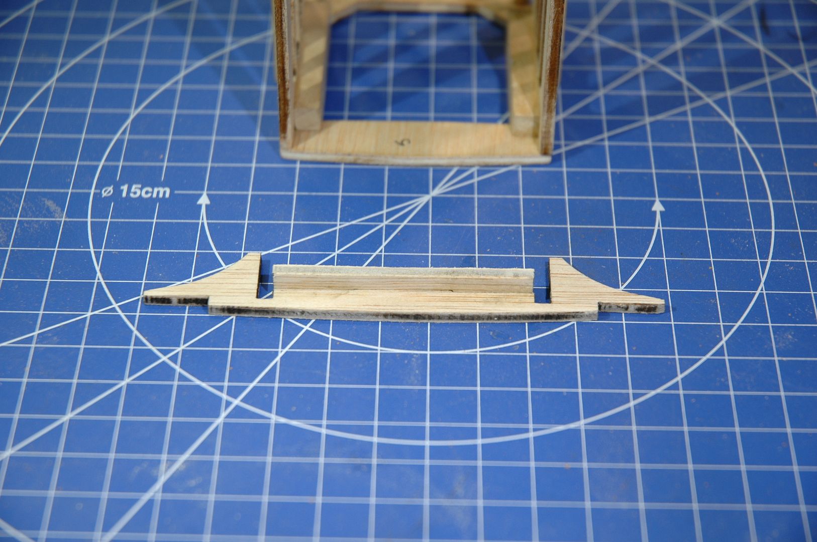

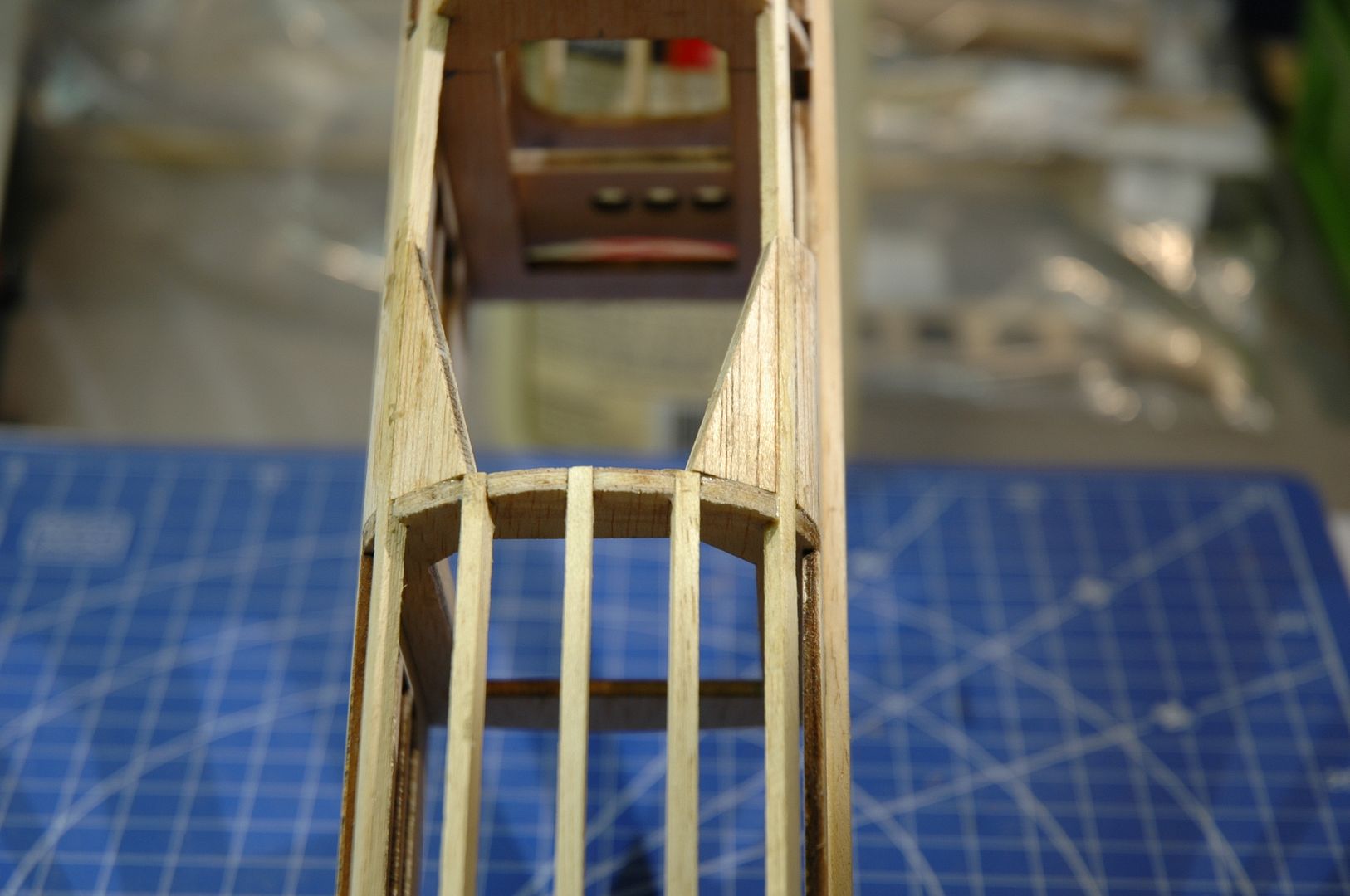

Stage 38.

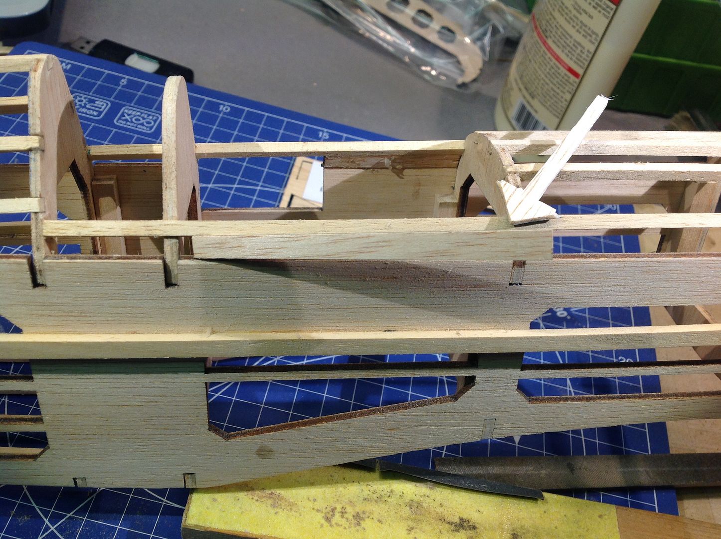

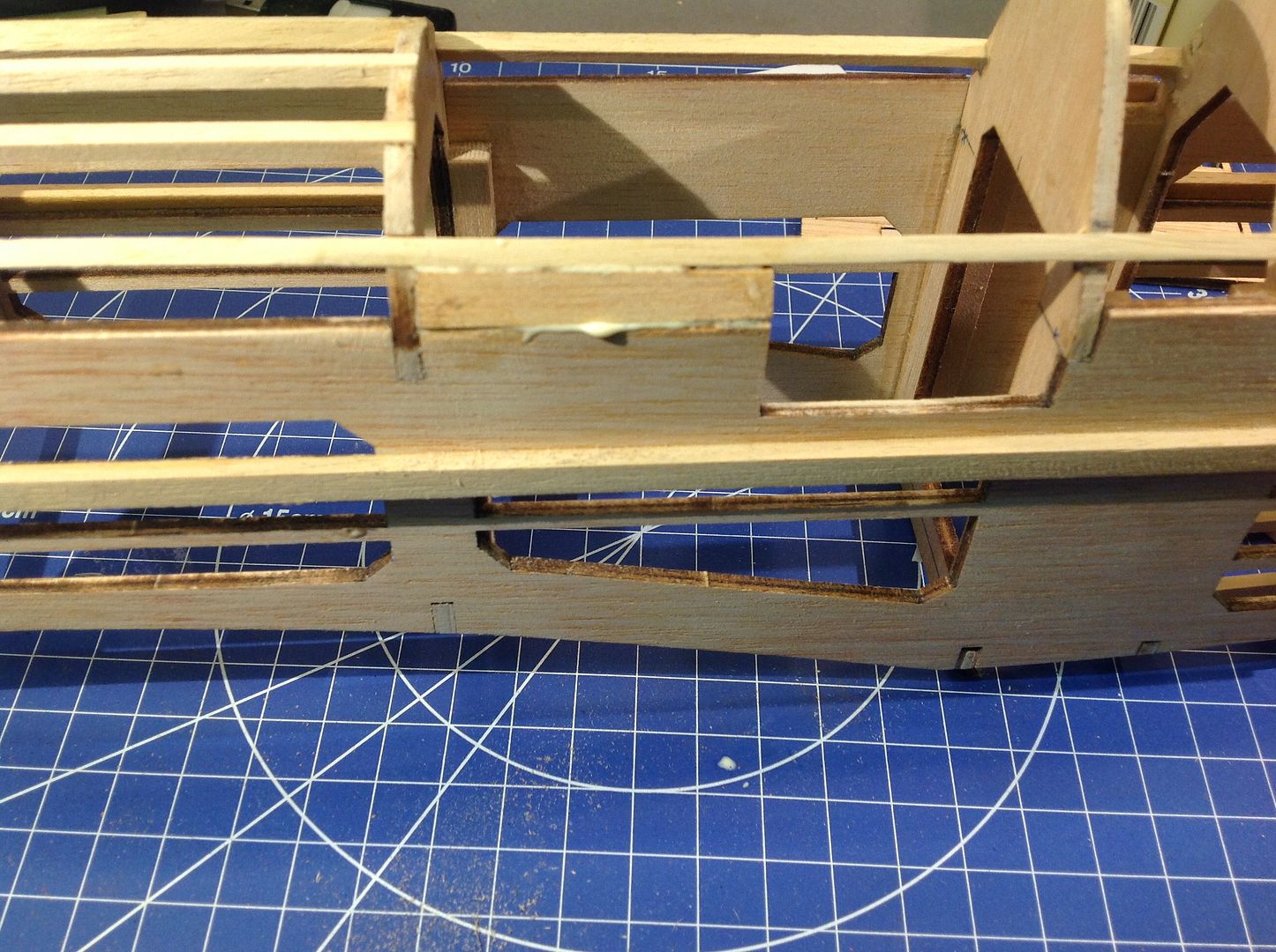

The next job was to remove the two pieces of fret that hold the small and large fairing then glue them together at 90then if all ok glue in place behind the piece with 3 holes.

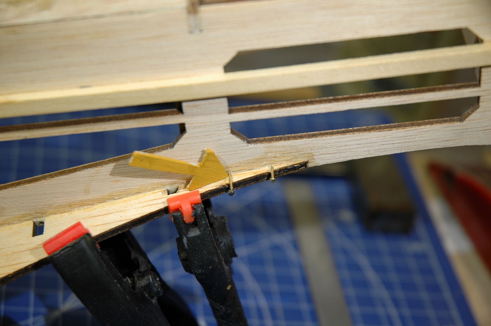

This picture shows a small piece of fret (yellow arrow ) this has to be glued Port and Starboard. This is to help with reinforcement, test and fit the small fret and glue in place.

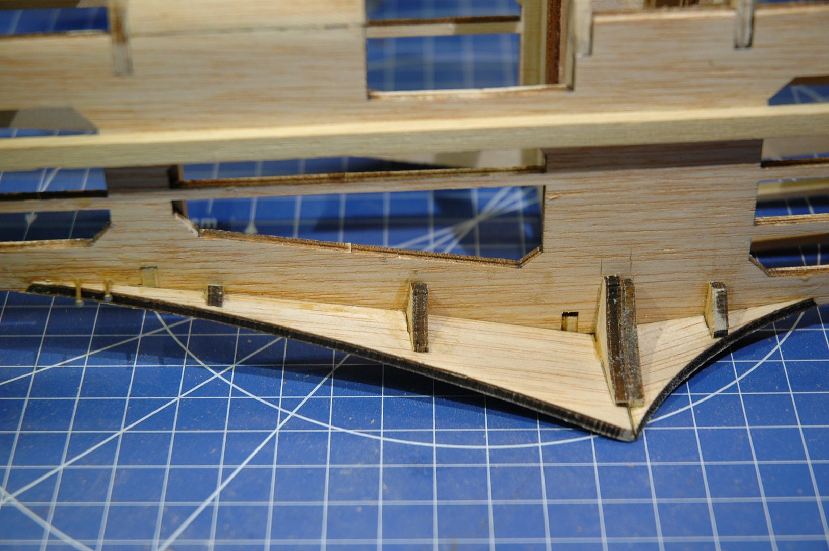

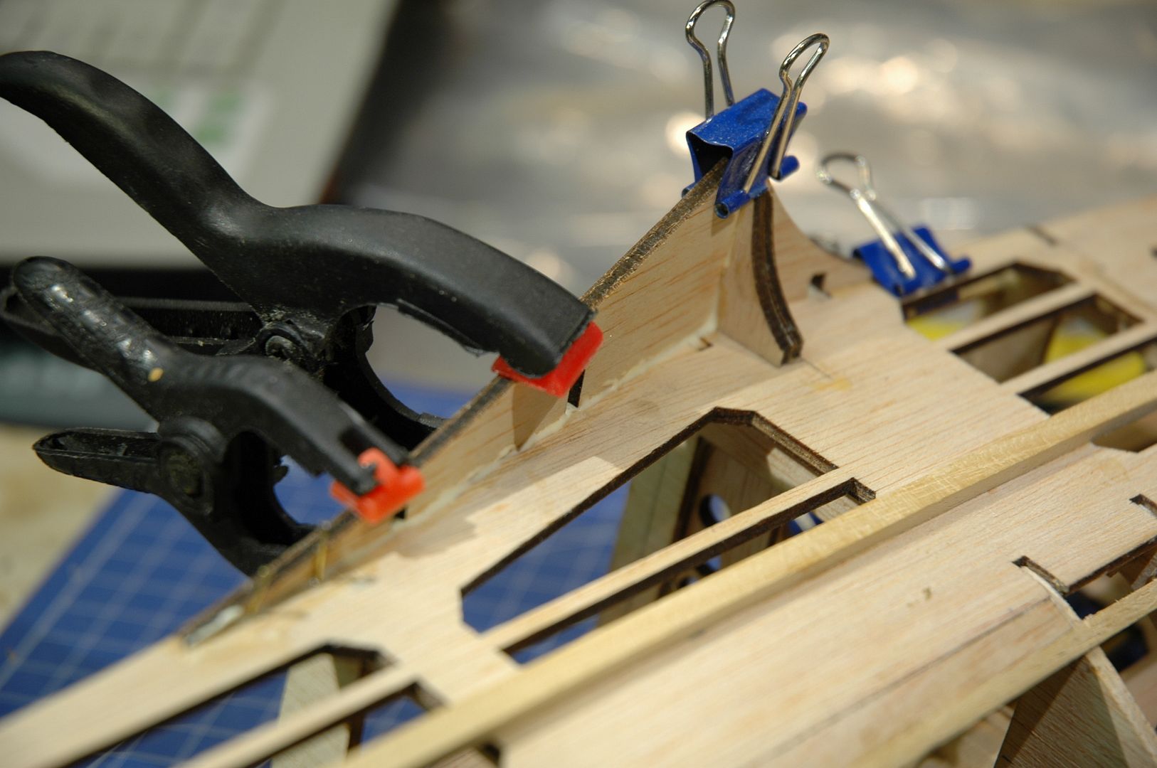

Next was to fit the large fairing (same side as the small piece)now this is the tricky bit, what you have to do is follow the curve of the fuselage, how I did it was to Glue and clamp the thick end and pin the thin end. You must take care with this part the pins I used were like the pins you get when you plank a hull.
What I did find I had to shape a small chamfer at the large end to get the correct angle this may be just my build but it left a small gap which I filled with left over fret.

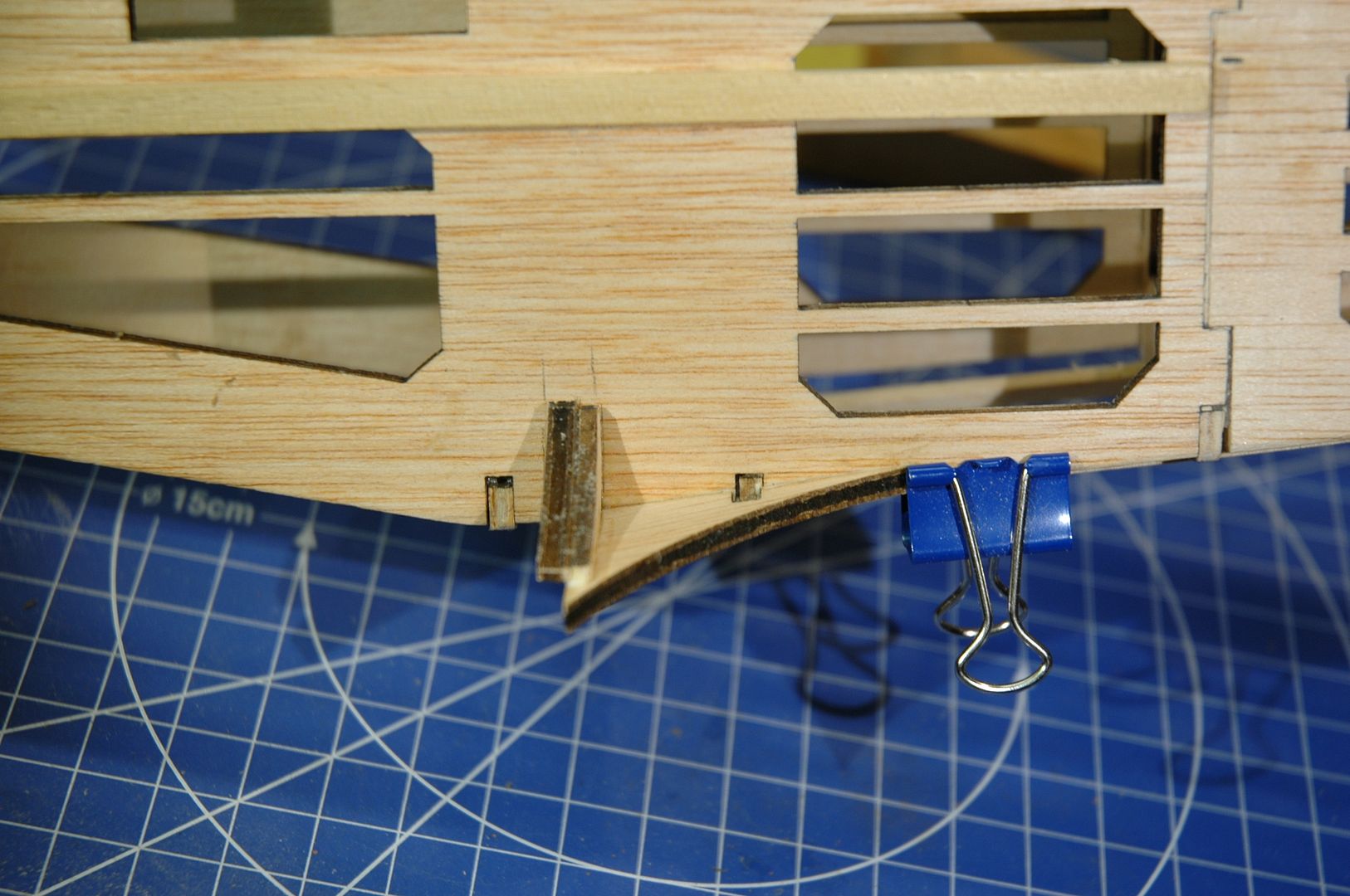

The next job was to fit the small fret very much the same as fitting the large, here are a few pictures to show.
Now to fit the 3 small pieces of fret to complete this stage, you may find that a little adjustment will be necessary if you can follow the angle of the Fairing in my case the holes were drilled at 90 so I will have to adjust at some point.
Well thank you for looking at my Spitfire build and the pictures, I do hope you find them as interesting as I find this build.
Kind Regards
Trev.
#131 Posted : 16 June 2014 23:11:46
BigGrin Hi Trev
That's a clever use of brass nails to get the curvature of the former to follow the line of the fuselage. Top work as always.
Andy Cool
#132 Posted : 17 June 2014 22:38:06
Hi Andy,
Do you know that fret was so hard I had to sharpen the pins up, so it is a solid old build, still it worked that's the main thing, and it may help others who are in this build, anyway up to date with the Spit now waiting for the next pack, I think things will start to move a bit now as I have a lot of bits waiting, so on to the Vic now.
Trev.
