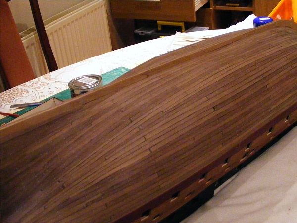

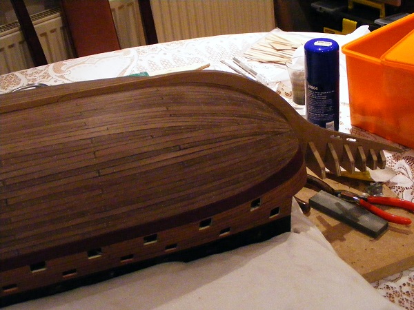

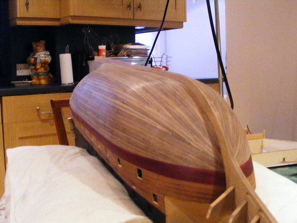

Tonight I finally finished the keel and to finish off the evenings work I painted black some of the bamboo strips ready for fitting the wales....Cool Cool .. Am going to darken the keel a little and am experimenting with various stains to get the effect I want... I do know I am not using walnut stain, makes it far too dark.....BigGrin BigGrin .. Issue 39 complete so no onto issue 40....Cool Cool

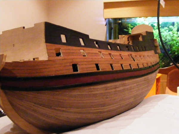

Finally, thought I would leave some pics of how she is now but the right way up....BigGrin BigGrin .. She is now sitting in the build cradle meant for the Vic, fits in there nicely... Thanks to Bernd for the tip....Cool Cool

She looks fabulous AlanCool Cool
Before comitting to stain the keel darker I would decide on what finish you are putting on.Because of the tint in varnish it will darken the keel but not the hull because it is dark already.I had the same problem with my build,the maple was much lighter in sheet form used on the keel,but the varnish has mellowed this right down.It is certainly worth trying it on offcuts of planking and keel material.

Thanks Nigel, it is exactly that that I am doing at present on offcuts of the sheet Walnut... I don't want to darken it too much but am looking for a bit of a better match... You are correct, the sheet walnut is lighter than the strips... So far, I have found giving the sheet walnut a coat of light oak stain gives a better colour match... but will continue to see what else I can come up with.... Cool Cool .. Am also experimenting with finishing the hull off with sanding sealer (Shellac) but with a very light fine sanding to finish it off, just to take the shine off....so far I quite like the look of that finish...Cool Cool .. Have to say though I am quite enjoying experimenting with the different materials, its fun....BigGrin BigGrin

I think it is a case of finding what works best for you with what equipment you have.For me it's ronseal mattcoat.But I spray it through an automotive touch up gun using a 2.5hp compressor and I appreciate not everybody has this equipment to hand.I will say though having tried just about everything,I can't better it.
