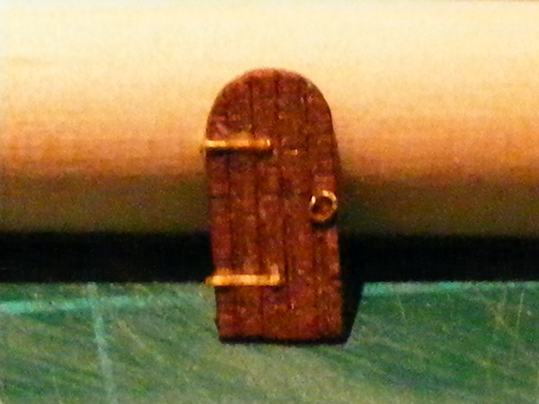

I really liked the doors than Nigel applied to his gallery so thought I would have a go at doing something similar.... Thanks for the tip Nigel...BigGrin BigGrin .. I first cut the basic door shape out of 1mm sheet walnut and finished off using a fine grade file... When happy with the shape I then scored in lines to simulate separate planks, did this using the wrong side of my modellers knife and of course being careful not to go too deep....Cool Cool .. Cool Applied a coat of medium oak stain and the stain really followed the score lines and darkened them more than the surrounds, was pleased how that turned out.... BigGrin BigGrin .. The door handle was from a .3mm eyelet, drilled a .3mm hole and fixed in place with superglue,,,, the hinges were from the stem of the eyelet.... All in all am pleased with the overall result..... Cool Cool

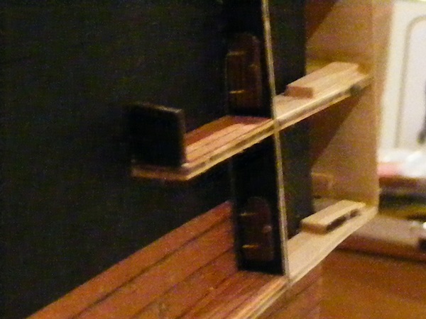

Finally today, fixed everything onto the stern and took the opportunity to apply additional brace pieces on the framing.... will finish the painting tomorrow and get to work on the other side.... BigGrin BigGrin

Thanks Nigel, I'm officially allergic to treenailing so this part won't be done..... BigGrin BigGrin

I can't keep up again AlanLOL LOL The doors look excellentCool and the mesh is a big improvement.

Thanks again Nigel, and no I can't slow down it is such a pleasure to be doing something else.... So pleased I followed your lead on the doors, just didn't seem right to have a gallery with no visible access to it, not unless I wanted my little sailors to climb over rails to get down there.... LOL LOL Flapper Flapper LOL LOL ..

Looking excellentDrool
Lovely little mod to set your model off further!

BigGrin Hi Alan stunning work' love the doors and the planking BigGrin Happy building rgd Martyn

Thanks Martyn, think it just adds that little personal touch.... Cool Cool

That said, I am amazed that the detail of the doors in the galleries is not part of the official build Confused, but hey ho looks I`m in for some door building in the near future( still second planking lower half, top half completed).

Thanks for the positive comments Derek, it is appreciated... Cool Cool . I think the doors just add a little extra detail and to be honest they were fun to make even if a little fiddly.... Cool Cool

Looking better all the time, it's those little 'add ons' like the doors that make so much difference and like the others said, the doors are so integral to the gallerys why on earth weren't they included in the build?
That brass mesh looks really fine (pardon the pun!) Do you know if on the actual ship they were simply a wooden trellis or were they actually leaded windows? If they were windows you might try going over them with the Micro Krystal Kleer (you can tell it's American can't you! LOL ) or the Humbrol equivalent to actually glaze the mesh. Easy peasy to apply and the effect is just like period glass. Of course if it's not a window just ignore everything I just said! BigGrin
Keep them coming, she's going to be a beautiful Lady!

Thanks Robin, have to agree with you, not having gallery doors seems a little odd but hey, they are there now... Cool Cool .. As for the windows, not sure whether they were leaded windows or not and although I have Krystal Kleer I didn't use it in this instant but maybe I should have.. Would have preferred to apply it from the inside as I wouldn't like to spoil it now... will experiment on some spare mesh to see how it looks. If it works out then I may apply it yet... Cool Cool
Thanks for the tip and for the very nice comments...
