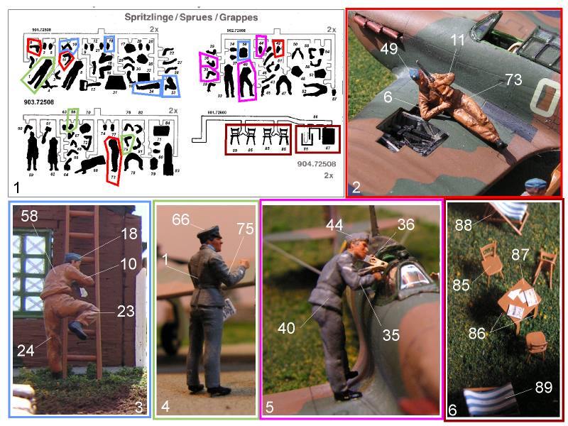

Carrying on from the Airfix figures in the last installment, we come to the first set of personnel constructed from the Preiser Luftwaffe Pilots and Groundcrew set. These are excellent little models with lovely detail and definition as you'll see below.
The first diagram in Photo 1 is a ‘cleaned up’ scan of the inside of the Preiser cardboard box which contains the Luftwaffe set Art. Nr. 72508. The original is printed on standard ‘cardboard brown’ so after scanning it into the Corel PrintHouse program I first carefully removed the box creases from the picture before then paint filling the background to turn it white, and then cleaned up the edges of the individual parts so they could be paint filled in black. Finally the part numbers which were a little indistinct in places were all removed as well and replaced with new added text ones. This took a little longer than anticipated as the ruddy graphics program crashed just as I was putting on the last couple of part numbers. Needless to say I hadn’t saved all that work during the process! Attempt number two was saved after every new addition!!Cursing
What I have done here is to illustrate the first four Preiser figures using the diagram with the relevant parts outlined in a coloured box which corresponds to the border around their photograph. If I remember rightly, I think Italierie used to employ the same system on their figure sets (this was at least thirty years ago mind!)Blink I’ve had to space out the figures into two instalments, as you can see on the diagram, the ‘2x’ refers to the fact that there are two duplicate sprues in the set giving seven sprues in total (that 2x in the bottom right actually refers to the deck chair mini sprues which I’ve erased on the photo), some figures are built up from identical parts which makes the coloured boxes a little difficult so the second figure will come in the next instalment.BigGrin
Photo 2 illustrates the Hurricane Armourer. The torso and legs (Part 73) is a dual purpose part which can be used either laid down as seen here or in a ‘leaning back’ pose which we’ll see next time. The one piece body is moulded in overalls, I chose the right arm (6) because it fitted nicely in the gap created by the open gun bay and the left arm (11) as it had a suitable tool – a large screwdriver! Of all the arms in this set, only three have any sort of tool, this one with the screwdriver, a right arm with a spanner (not bent enough unfortunately to fit in the gun bay) and the third one is holding a rag (see the next figure). The head may or may not be Part 49, to be honest almost all the forage capped heads look too similar to remember which one went where! No ‘surgery’ on this one, just a paint job to change him from Hans to Harry!
Photo 3 is the ‘Erk’ on paint duty. That rag holding right arm is used here, Part 10 and his legs are a two part assembly using Parts 23 and 24. Leg 24, the straight one will also fit to leg 15 as well to give a slightly different pose. The separate torso (58) is another one moulded in the loose overalls as you can see by the ‘baggy’ waist, others are moulded with tighter uniform tops and belts. The head is another of the standard forage cap types.
Photo 4 is Warrant Officer Warwick, seen a few times during the movie, usually using his well developed lungs to pass on helpful hints to the lower ranks (or to superior female officers about to light a calming ciggy whilst standing in the midst of bomb damaged gas mains!)Blink Mr Warwick’s legs and torso are Part number 1, the only slight alteration being the use of a safety razor blade to accentuate the parting in the rear of the tunic bottom and a little more definition to the bottom of the tunic where it meets the trousers. His right arm is a standard bent position, Part 75, whilst his left arm (which I forgot to put in the photo) is Part 61, the arm holding a report pad (or something like that!) Mr Warwick’s head is Part 66 wearing the peaked Officers Cap (a part he shares with AVM Keith Park to whom he is chatting).
Photo 5 is Squadron Leader Skipper’s ground crewman, standing on the wingroot of his Spitfire readying his seat straps. His torso and legs are Part 40 (which he shares with Arnold in the hut) with arms 35 and 36, selected to hold the straps at a realistic position and another forage cap head, Part 44. I’m pretty sure this is 44 as its one of the few with a decided turn to the right in the neck!
Finally in Photo 6 we have the selection of chairs and table provided in the Preiser set. There is only one of these sprues (more’s the pity) so you only get the four chairs but they are marvellous little mouldings, very fine and delicate as you can see in the photo. There are two tables however, one on this sprue and another on it’s own little mini sprue. Three of the chairs were used here and the fourth is in the hut with Arnold. The table tops are moulded with a pack of cards spread around and a leather flying helmet but I sanded these down to give a flat surface onto which was stuck some papers and a couple of authentic Battle of Britain period newspapers, reduced to scale size and printed onto inkjet decal paper. The deckchairs are also great little mouldings themselves. They come in two versions, the ones I’ve used here are Parts 88 and 89 – the deckchair frame and the canvas seat. The only thing I changed was to cut away the extra armrests from the frame to make them more ‘Brighton Beach’ and less ‘French Riviera’. The other version requires Part 69, 70, 71 and 72 (bottom left sprue) – this is a pair of flying booted legs attached to another canvas seat with a separate torso, head and a pair of arms clasped behind his head. This assembly fits onto the same frame to create a pilot dozing in the deckchair.Cool
In the next instalment, Keith Parks himself and some more Preiser ground crew figures.
